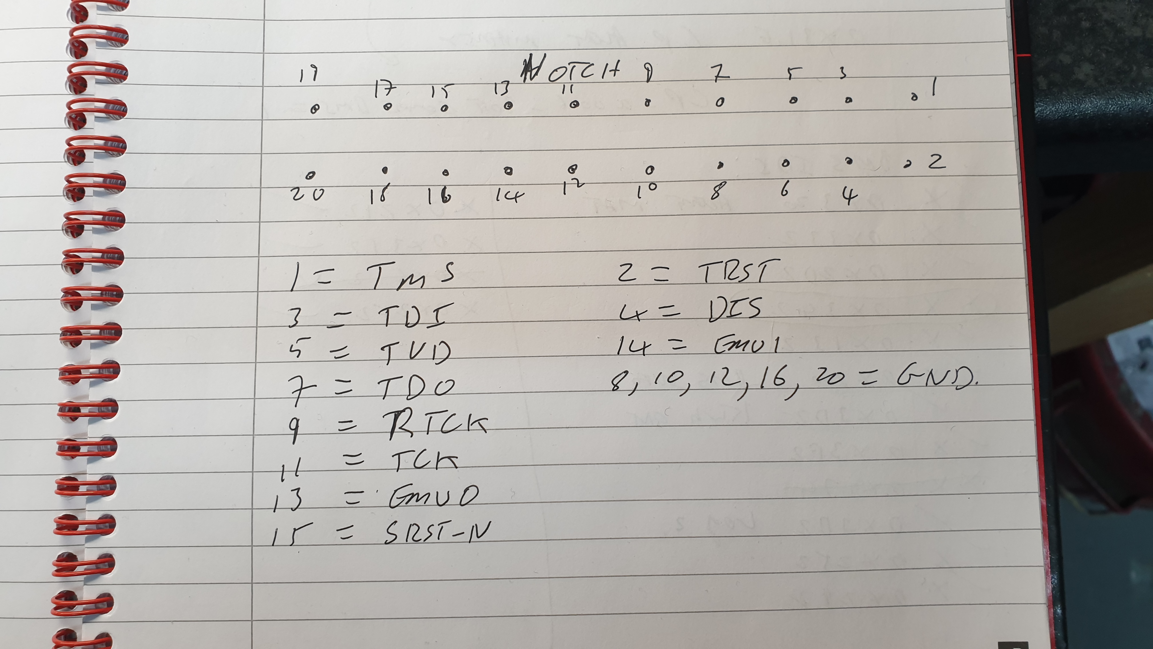

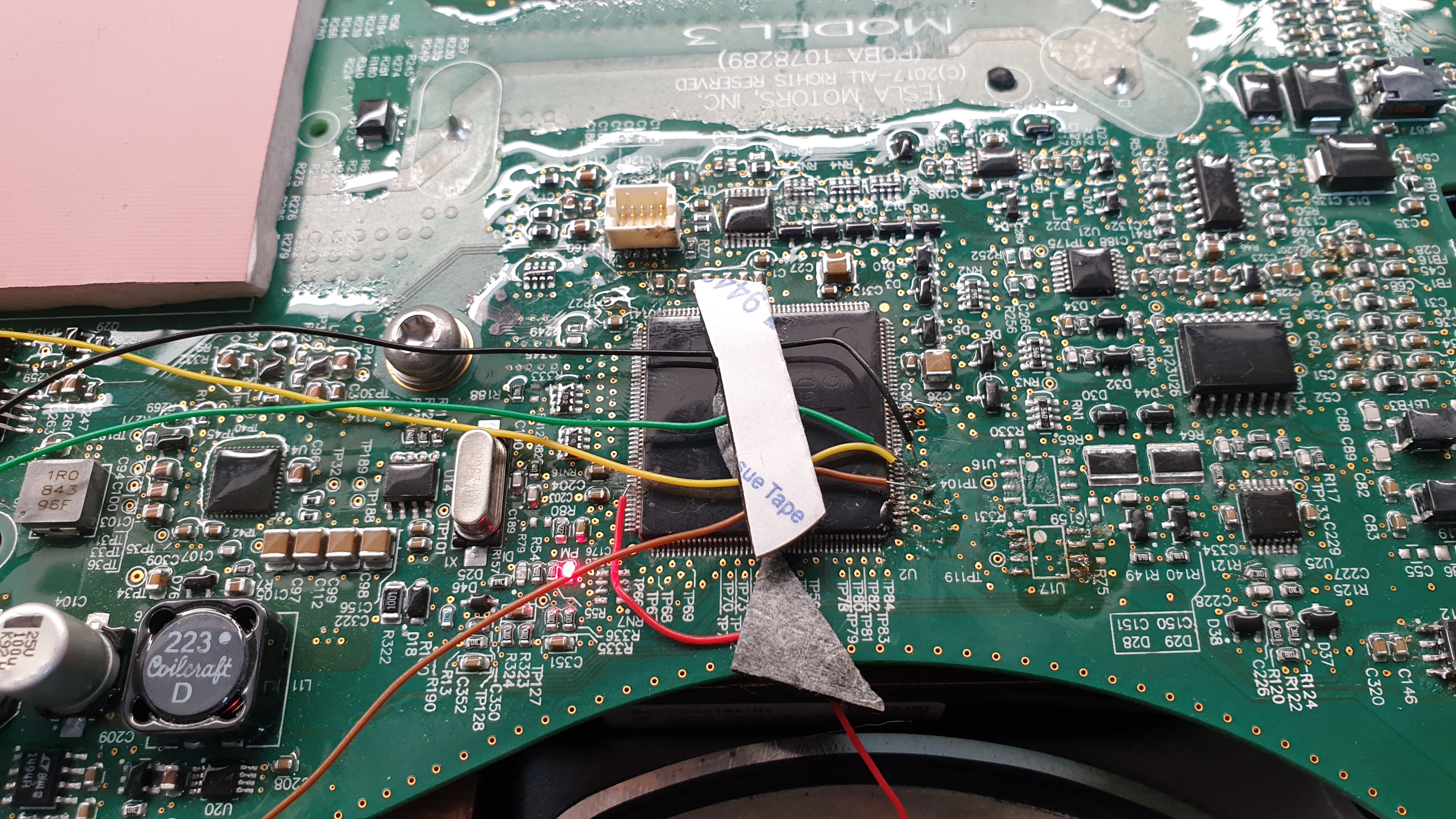

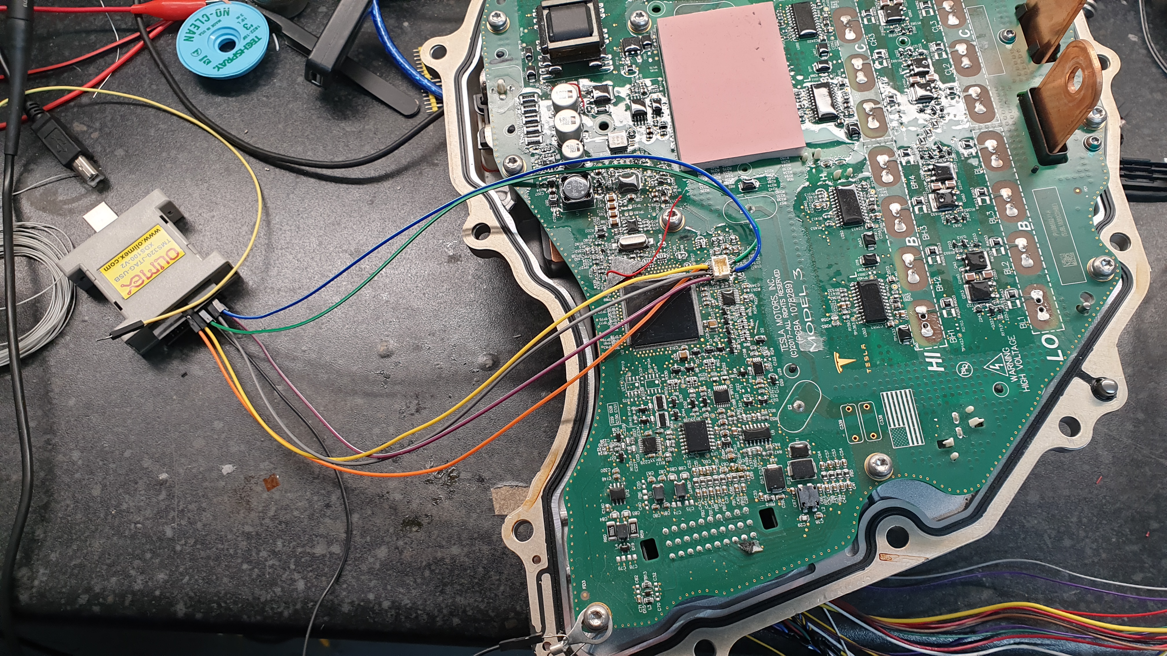

Scratched an itch and tried Jtaging the Musk brain. Imagine my surprise when it didn't work. Oh well, better give up and go home ....
Attached pinout (as best as I could make anyway) of the 10 pin Jtag port.
