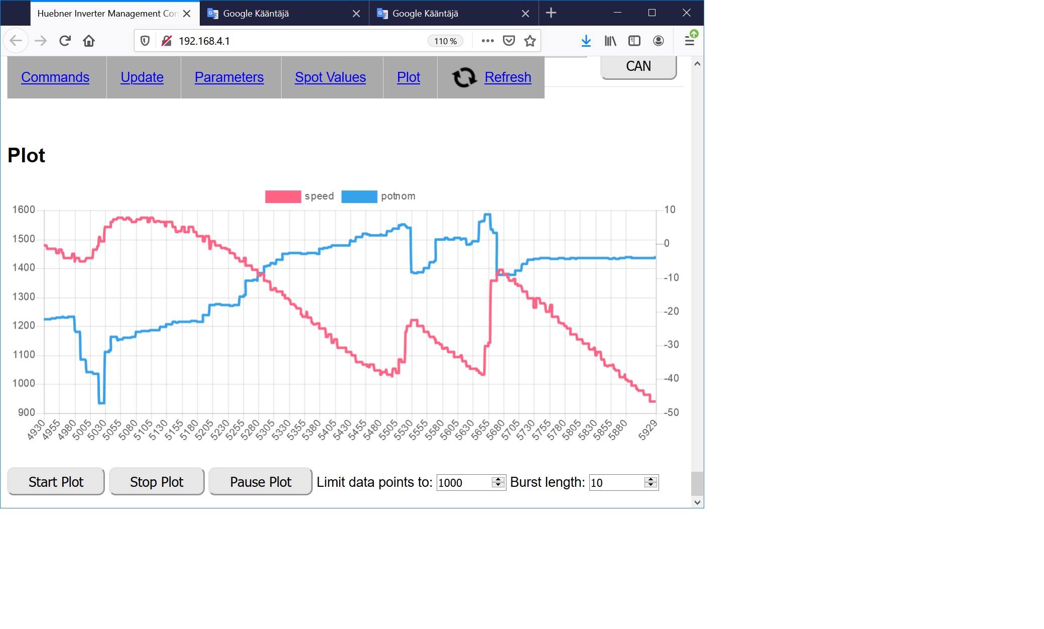

I've added some potnom/speed-plots with different param values.
In all cases, the change in speed works the opposite of what it should
at a certain braking value.
The motor starts and accelerates smoothly at the positive values but
it starts to accelerate at high braking values and even at lower values
at higher speeds.
Could you please give me a hint what to make in a different way?
Seppo

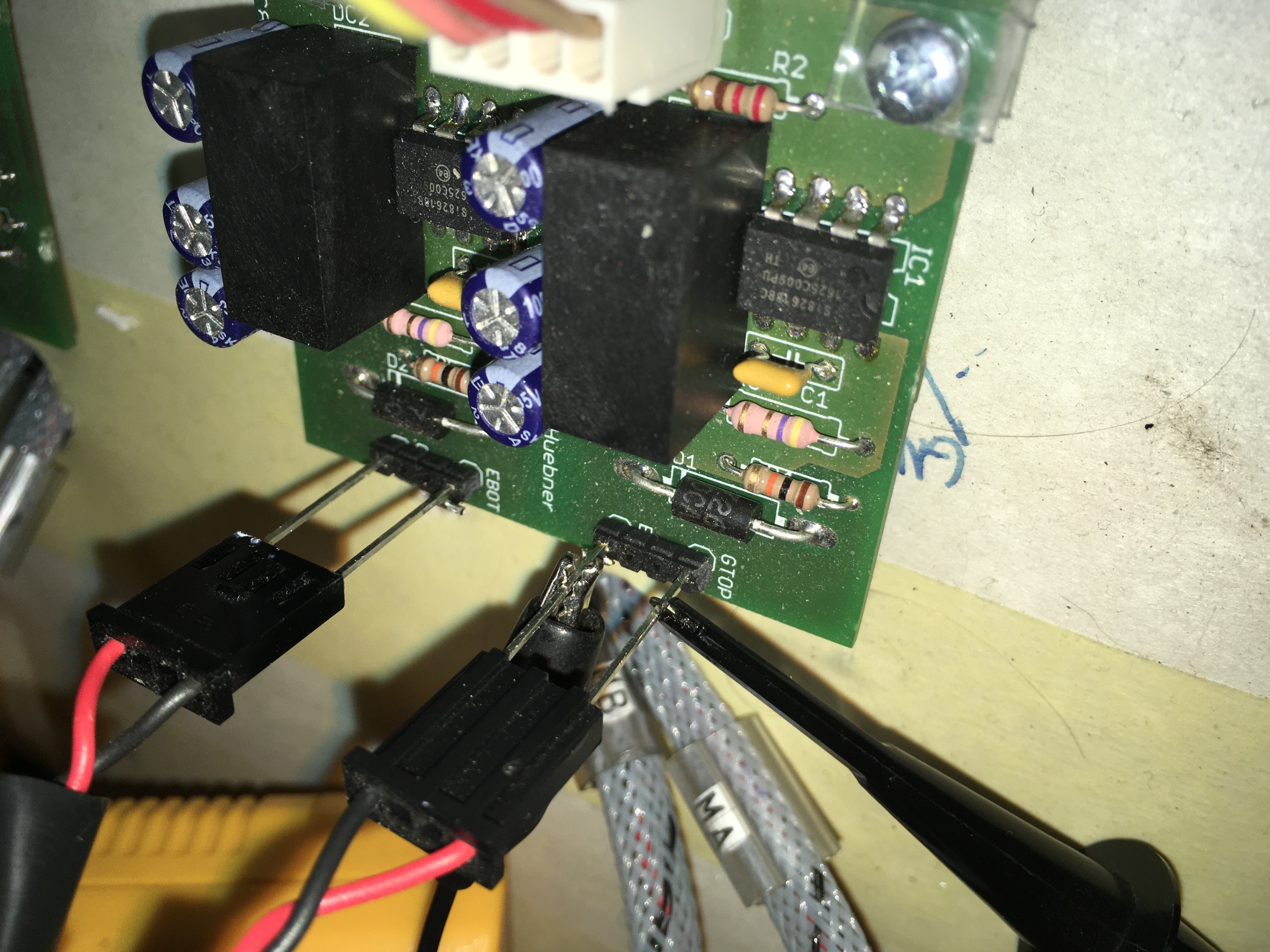

Here are the pictures of my main board and the changes of the schema.
I'm wondering if it is meant to be a short circuit between pins PA6/TIM3_CH1 and PD2/TIM3_ETR
as is seems to be in the case of a single channel encoder?

Your parts on the main board are alright. You no longer need the connection "J1" but it doesn't hurt. Something is wrong with your numimp, negative fslipspnt MUST yield regen. Please concentrate on your encoder - data sheet or scope.

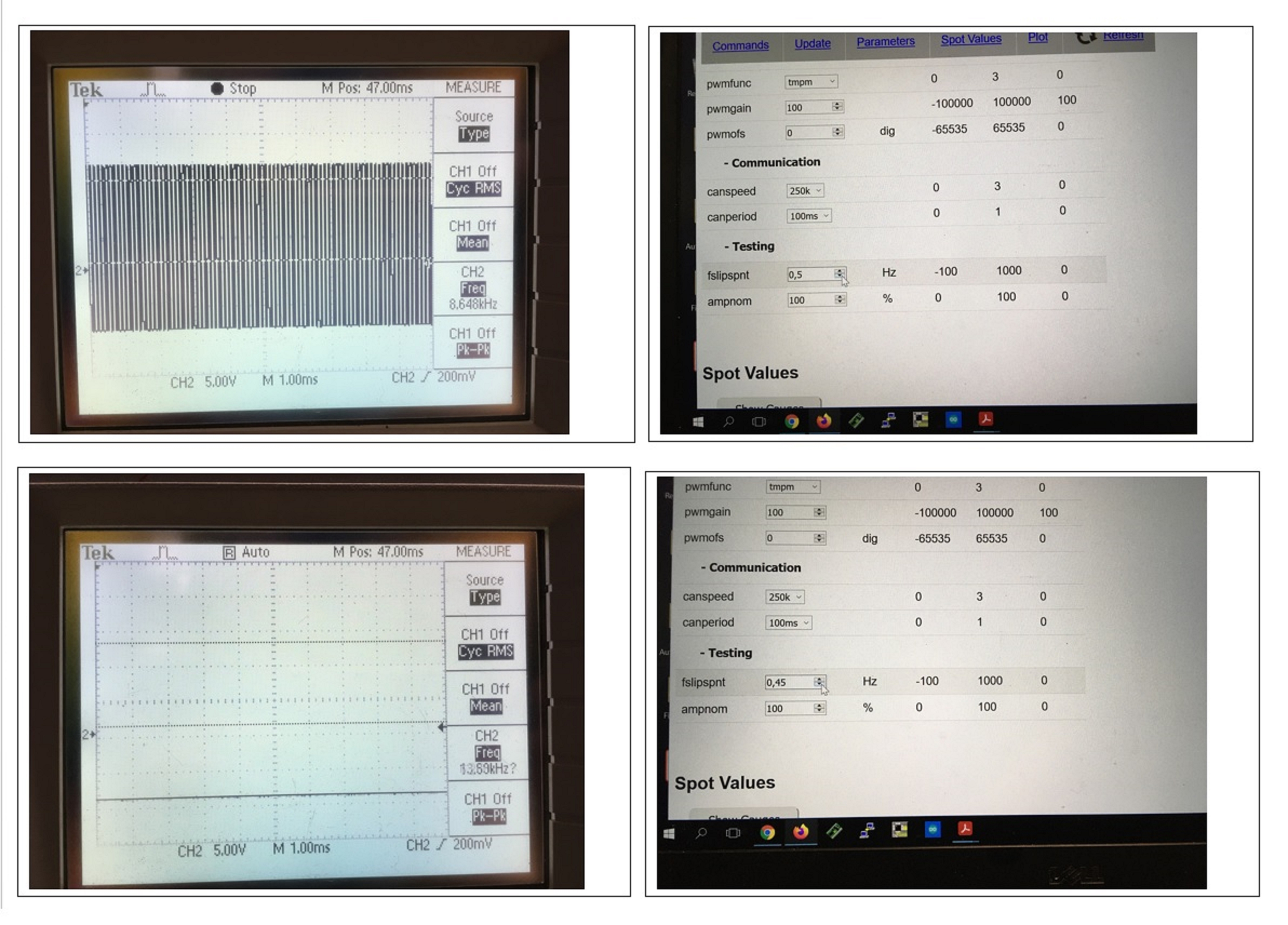

Manual mode measurements.
I tryed once again the transition from 20 to 3 and the transition from 20 to -20.
For some reason the negative values of fslipspnt don't work. The negative values act alike zero.
Then I made some measurement from the pin GTOP of the driver board.
It seems like the parameter fmin limits the function of fslipspnt. Manual mode stops working at values less than fmin.
Am I barking the wrong tree?

The fmin sets a minimum allowed frequency, so it's no surprise that fslipmin isn't allowed to go below that
Fmin should usually be as low as possible, Johannes planned to make it a hidden parameter. Leave it at 0.2 and you should be fine.
If you want to do regen in manual mode, just flip it into reverse and apply positive slip.
