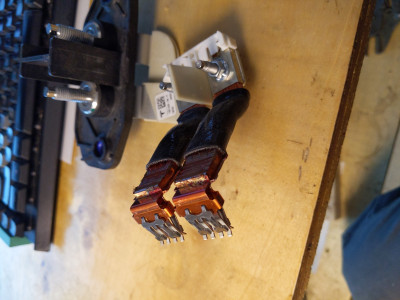

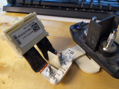

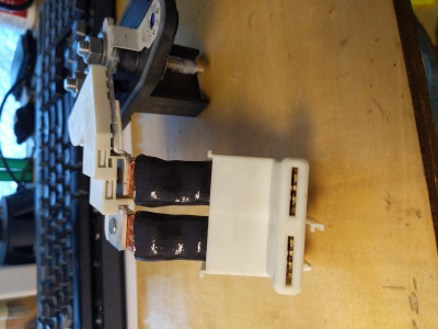

I disassembled my pack myself, so hopefully I can help here. This is the HVDC connector into the PCS.
- Exposed HVDC contacts
- HVDC connector labels
- HVDC connector plug
I think it is either made to spec for
Tesla or it is a
Tesla made part, none of the numbers turn up anything other than identical salvage parts.
EDIT: Some searching on Digikey turned up these TE contacts that look similar, and based on their drawings would fit. I choke on 14$/pc
https://www.digikey.com/en/products/det ... -2/2327759

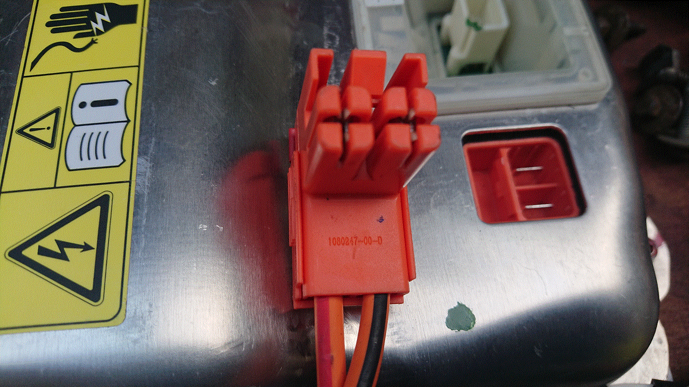

Posted: Wed May 19, 2021 7:12 pm
by nkiernan
Just checked the connectors I have and slight differences. See photos and the stamped codes on the plugs:
Posted: Wed May 19, 2021 9:50 pm
by Ken_S
Did your connector come from the factory with red and black cables?
Posted: Thu May 20, 2021 6:50 am
by nkiernan
Ken_S wrote: ↑Wed May 19, 2021 9:50 pm
Yes, came as part of the pack:
Posted: Thu May 20, 2021 7:19 am

nkiernan wrote: ↑Thu May 20, 2021 6:50 am
Very interesting. That looks considerably easier to deal with than the busbars mine came connected to. What year/region/model was your donor, if you know?
Posted: Thu May 20, 2021 6:11 pm
by nkiernan
Sourced in an Irish EV breakers, an EU 2019 car is all I have on it

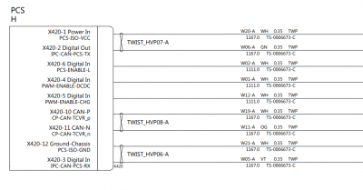

Jack Bauer wrote: ↑Mon Apr 19, 2021 8:16 am
Update : 20/04/21 : attached pinout and connector data document
Can you double check the X420 pinout in your PDF? I only ask because I am re-using the harness from my pack, and in the harness connector to X420, there are no wires in the sockets for pins 10,11, or 12, at least according to the pin numbering defined in the connector datasheet. What pin numbering are you using?
Posted: Mon May 24, 2021 9:09 am
by Jack Bauer
That's interesting. So pins 10 and 11 are cp can that is not used by the pcs anyway. Sounds like they deleted them from the loom. Pin 12 is a ground that actually needs to be connected to the case of the pcs so I would also suspect they deleted that in favor of just using the case ground. My pin numbering is as per the service manual wiring diagram. The Wxx numbers are actually printed on the wires so you could check those.
Posted: Tue May 25, 2021 7:12 am
by Ken_S
Jack Bauer wrote: ↑Mon May 24, 2021 9:09 am

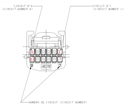

Thanks for confirming. I wasn't aware the service manual was openly available, I should have googled it a year ago:) Attaching a screenshot here for others to reference.
- LHD 2018 model 3 PCS x420 Tesla harness pinout
/wrong At a glance it does seem like
Tesla isn't using the connector manufacturers suggested pin 1, I will confirm in the morning. /wrong
EDIT: After further review,
Tesla does in fact use the manufacturers suggested pin numbering scheme in X420... I incorrecly assumed the connector used a "snake" numbering pattern, which was incorrect. Below is a clip of the connector datasheet with the suggested pin numbering schemed
Tesla uses.
- Manufacturer/Tesla X420 connector pin numbering

Attaching photos of the X420 connector I have for info, last three pins not used on this one either. Just got hold of service manual and wiring diagrams, send a PM
Posted: Tue May 25, 2021 4:23 pm
by Ken_S
nkiernan wrote: ↑Tue May 25, 2021 9:43 am
I just went though the wire labels and the connector datasheet again, turns out I was wrong.
Tesla is using the manufacturers pin numbering scheme, I just mis-identified the unused positions 7,8,9 as 10,11,12.
I edited my post above with the correct pin numbering scheme, so as to minimize future confusion.
