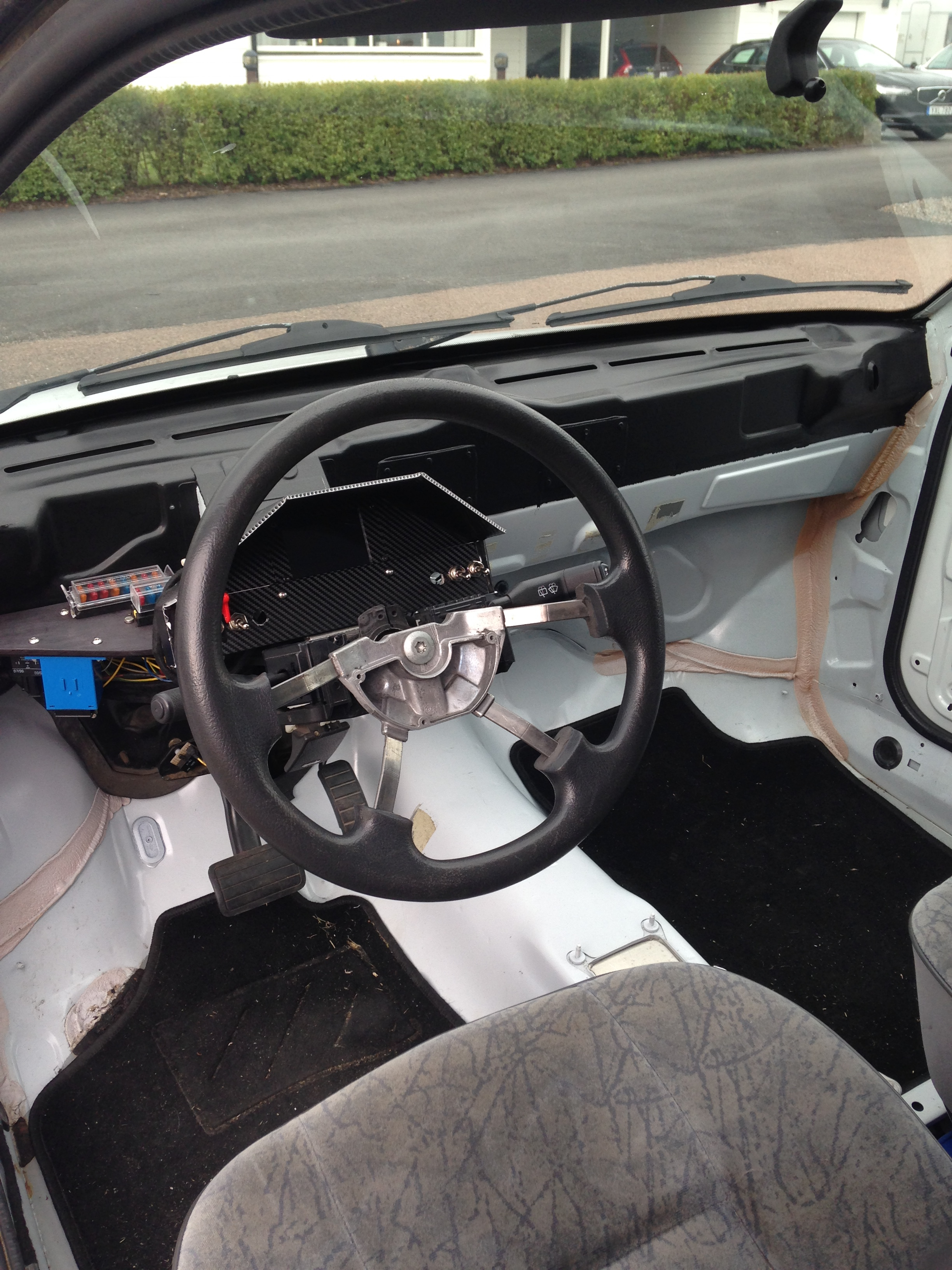

Now the madness begun. Started removing some weight and also added some small aerodynamic improvements in hopes of improving the cars overall efficiency. One thing led to another and the attached pictures show what the car looks like today. Consuming less than 1kWh/10km @70km/h from the wall power outlet (including losses in the charger) and with a cerb weight of 810kg.

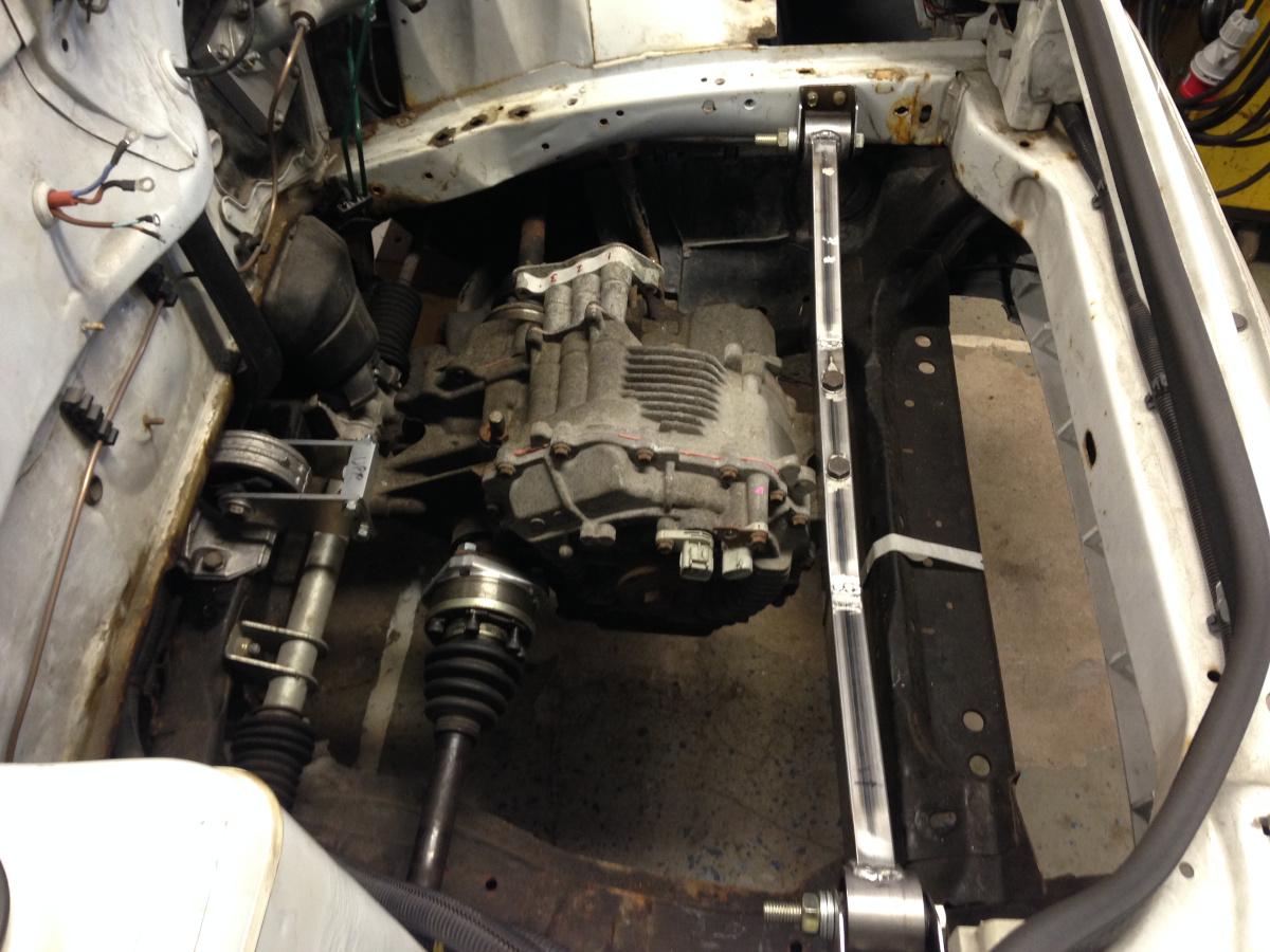

Have started the job of fitting the MGR to the car. First up is to adapt drive shafts / half axles.
My idea is to use VW drive shafts as these have bolted inner CV-joints and are available in many different lengths.
VW_drive_shaft_length.pdf
(26.82 KiB) Downloaded 500 times
To fit VW shafts in the outer end I will use Clio uprights with Clio wheel bearing and VW Lupo hubs. The diameters fits but needed some adjustment in the lathe on the inside length to allow the splined axel of the CV to slide in 1mm further. Also fitted with VW Lupo brake disc.
Should now fit with Clio calipers. Job done!
Next job is to make an adapter to fit them on the MGR output flanges.
Re: Renault Clio Electrique -97
Posted: Sat Aug 01, 2020 5:55 am
by bexander
Adapters between MGR output flanges and VW driveshaft ends done!

Have started to disassemble the car.
Out with the old...
I have also replaced the uprights to the ones with the VW hubs.
Next up is to start fitting the MGR.
Posted: Sun Sep 20, 2020 1:48 pm
by bexander
In with the new...
Next, fitting the inverter.
