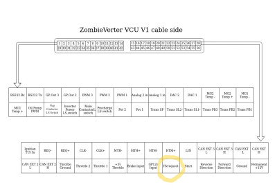

Re: Tesla charger in conjunction with Orion BMS not charging
Enable always high.
Then the HV request output can be used to put BMS and Zombie into charge mode.
Correct ways to fix:
1. Someone makes the change to the ACpresent output to function before enable needs to be present
2. Someone finishes the work on the CAN integration for the Zombie and Tesla Charger V5 boards

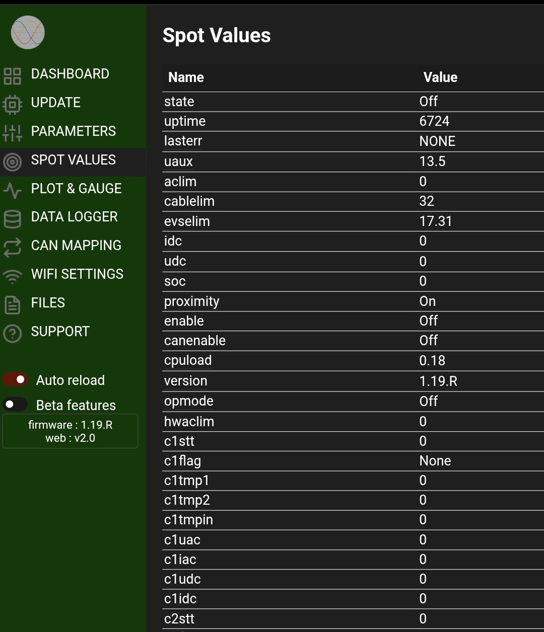

Yes, so I've now flashed the custom firmware, but as soon as I connect the charging cable, the A1 pin isn't pulled to ground. I need it to switch a relay to supply the Orion BMS2 (charge power pin), and also to activate the VCU on pin 50 GP12vin so that the pumps run.
The wiki states that this pin has no function, is that correct?
- Posts: 2963
- Has thanked: 330 times
- Been thanked: 848 times
Okay so the charger is connected to the Charge port Control Pilot and proximity, as we can see the EVSE and cable limits.
I need to review some more of the code and maybe make more changes. Made another version for you to try, as I said I have no way of testing my changes myself.

One small thing isn't working yet; I can't get a connection to the ESP32CANWeb. It was originally on Node 2. To rule out wiring errors, I flashed the old firmware, and now everything works again and I have a connection.
- Posts: 2963
No idea how that broke, likely via the library updates. Will need to see if I can flash it on a random board I have to test the esp connection.
