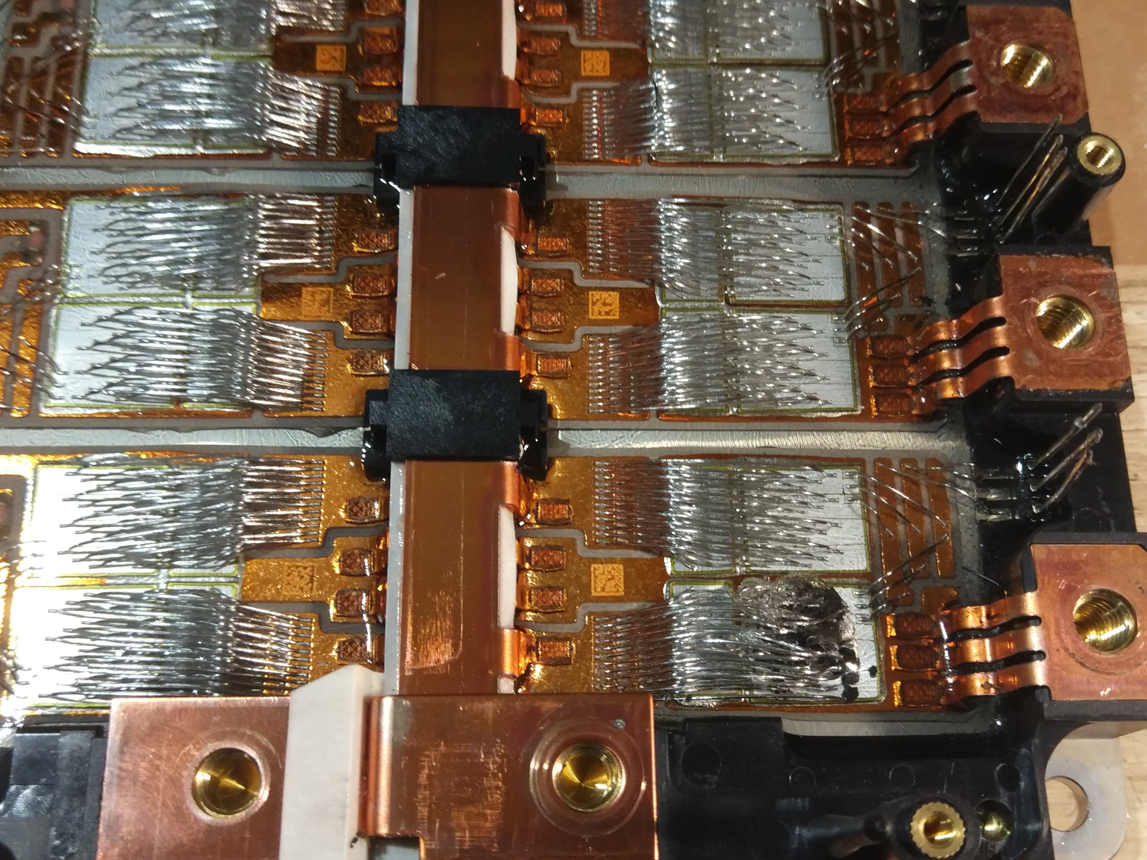

Those photos reminded me i have some faulty Volt transistors too.
If you observe the first one you see a black smudge in the bottm right corner. I believe this is toasted transistor junction. Desat certainly thinks so.
Transistors are in some sort of clear goo which trapped the burned traces in my case. Next photo is from another transistor and here it is not so obvious. A black dot... Desat still throws this one out every time.
