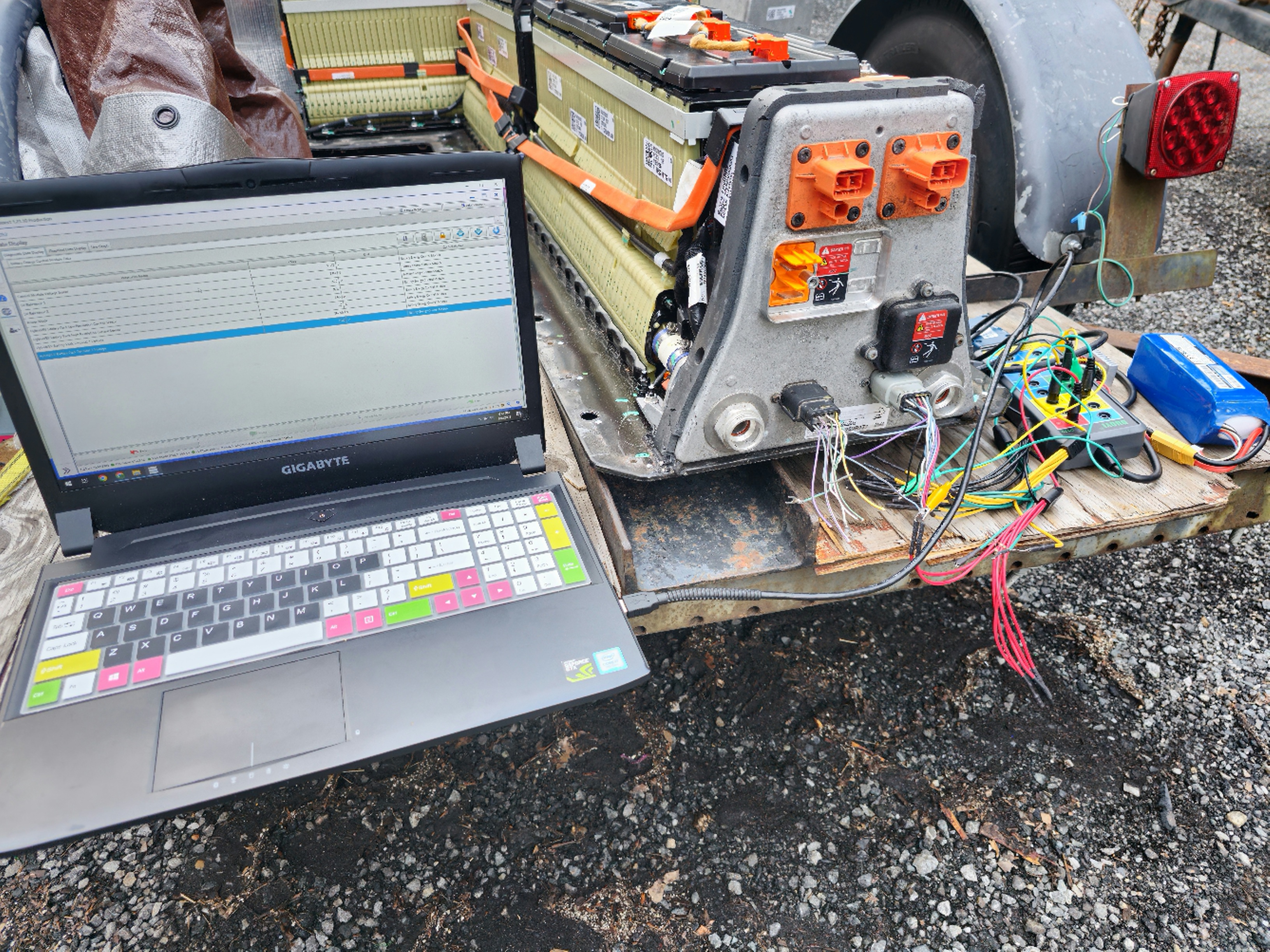

You need to externally power the becm and connect to the HS CANBUS with GDS2 it will read the Voltages.

2012 chevy volt battery test and Seller say's that it is with 93% soh.
Calendar aging would put it at somewhere like 89, no?
just seems impossible that 12 y old battery is at 93.
Resistance measurement would be good,if you have the some base data to compare it to and HV DC resistance tester
But other than that, custom hardware + software + inverter,
then a good old cycle test to see the remaining capacity on pack level, while checking cell voltages, as seen above, some bit of wiring and stuff.
Of course you can dismantle to the cell level and buy the Chinese cell cycler and cycle one by one. but such a hassle.
