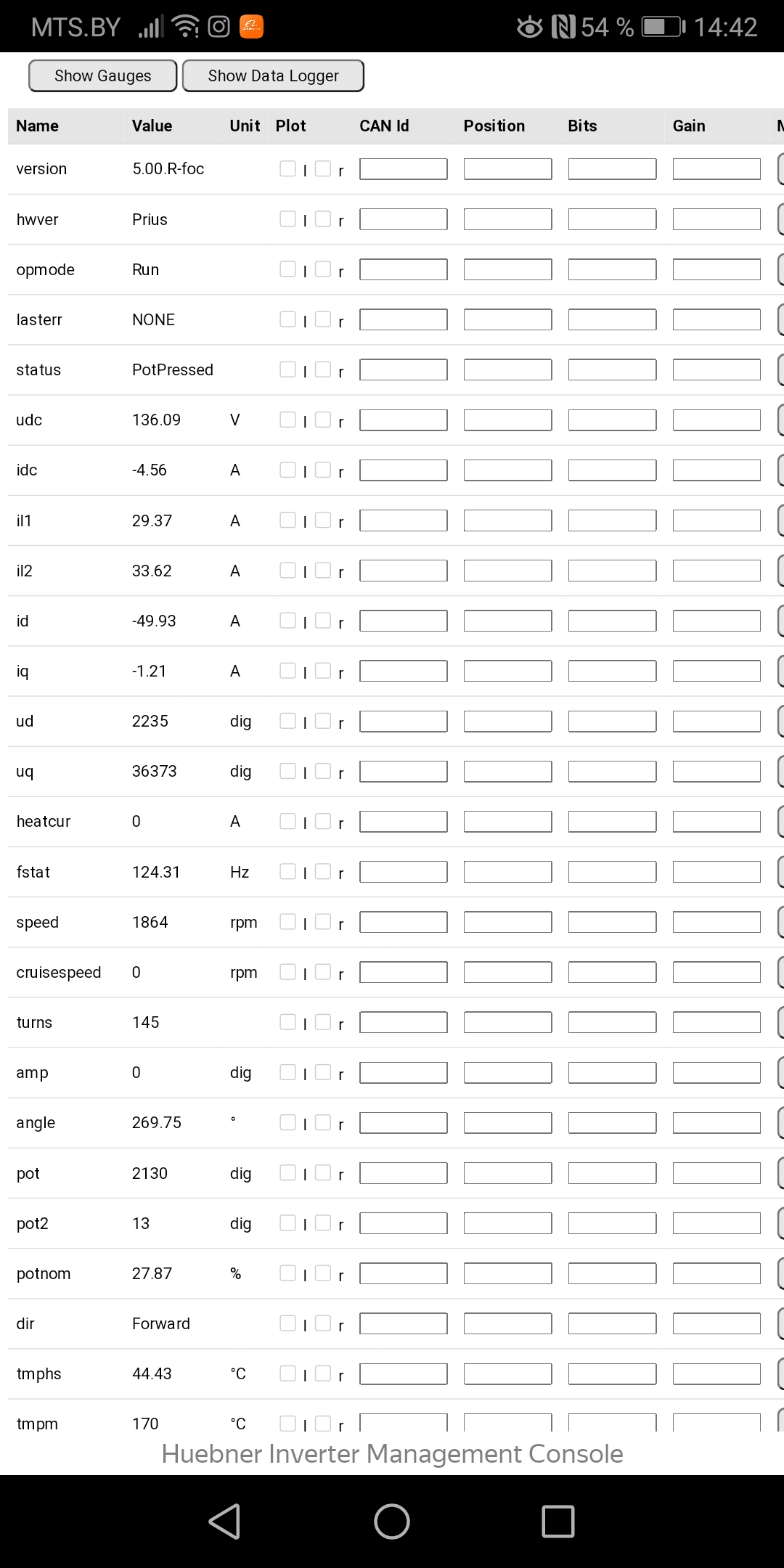

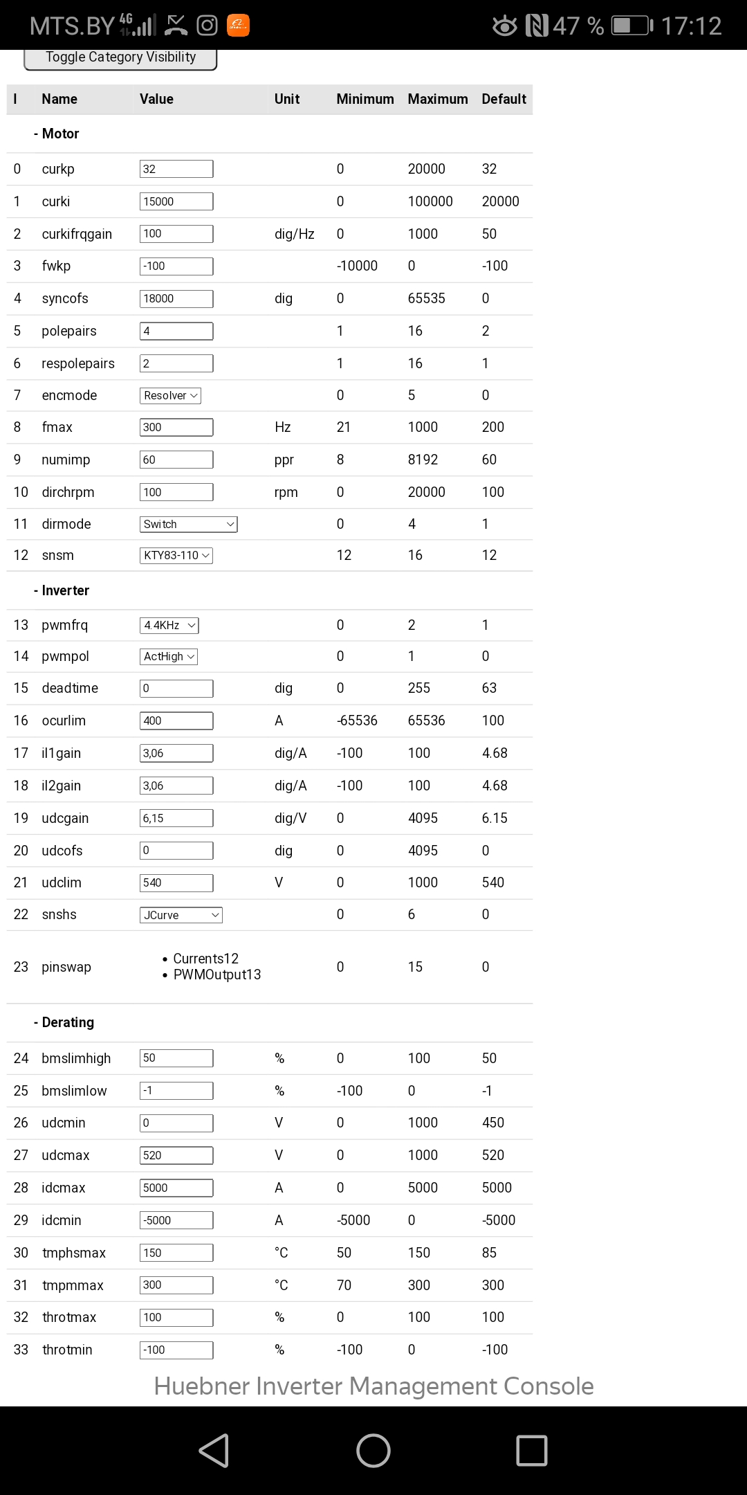

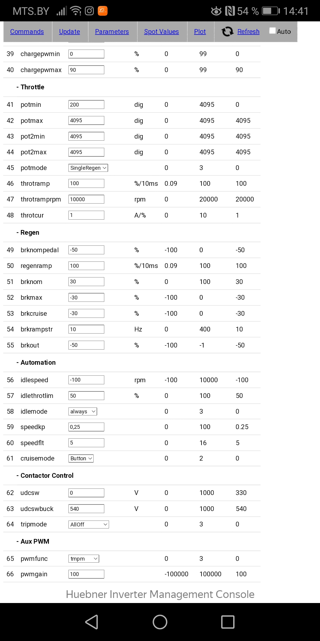

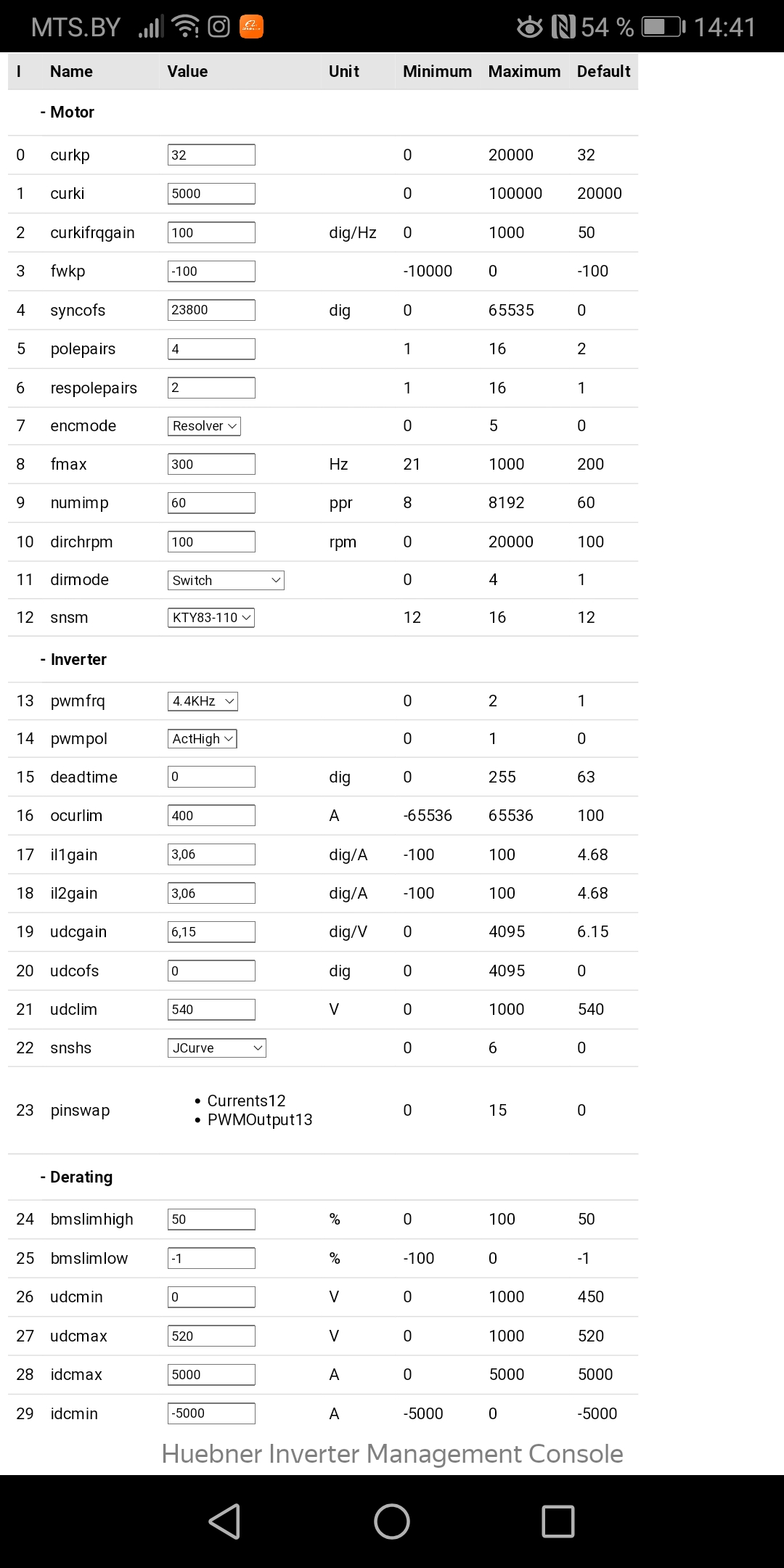

Need advice, please tell me what could be the reason for the lack of rotation of the motor rotor (MG1), it is separated from the automatic transmission GS450H? The motor is connected to the prius gene2, there is a resolver signal 0 ... 360. In the manual test mode, a PWM signal is heard and a sound similar to rotation, but the rotor is stationary, sometimes it shifts a little. I played with the parameters of the motor, but to no avail.

Has the "FOC Tuning Procedure" been completed" and have you compared your parameter values to others with the same components (Jack Bauer, etc)??

Yes, of course, I went through the entire setup process and then successfully received the rotation of the gear motor from the Lexus RX400H, but its characteristics were insufficient for my project. Now I decided to use the MG1 from the GS450H, but I can't get the rotor rotation. I changed many values for the motor, I only hear how the pwm sound changes without rotation.

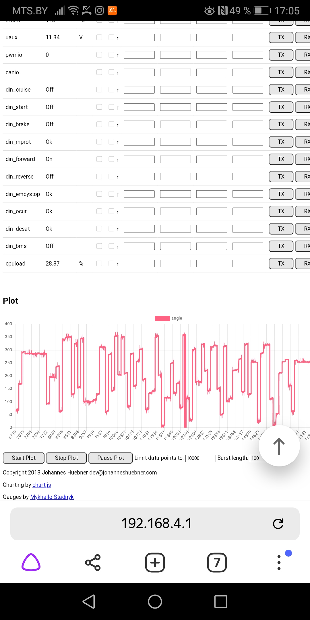

One problem has become less, the motor spun in both directions. The reason for the lack of rotation was the resolver, or rather the cos sensor. Now I cannot spin the engine, when I press on the throttle, it starts very sluggishly and then rests and does not react to gas, so in both directions. I changed many parameters and didn't get a good result. Who can help with advice?
These are spot values ​​exactly when RPM is not added and there is no throttle response.

Guys, I found the reason for my unsuccessful attempts to adjust the motor, the resolver was faulty.
