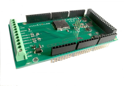

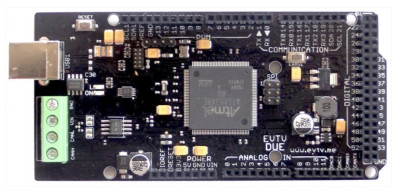

EVTVDue Microcontroller for $100 bucks, think of it as thanking them for SavvyCAN
OR, get their dual channel board
1 CANKIT - CANbus kit with Microcontroller and Cable for $150 bucks
cause you will spend that much to roll your own as this is the only decent shield like CAN adapter for the Due board COPPERHILL TECHNOLOGIES Dual CAN Bus Interface For Arduino Due With Extended Power Range and runs $50 bucks alone

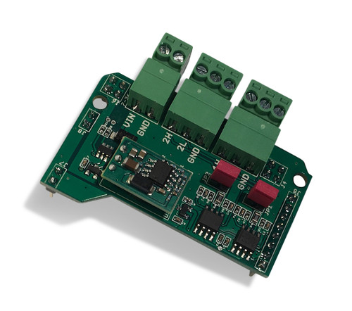

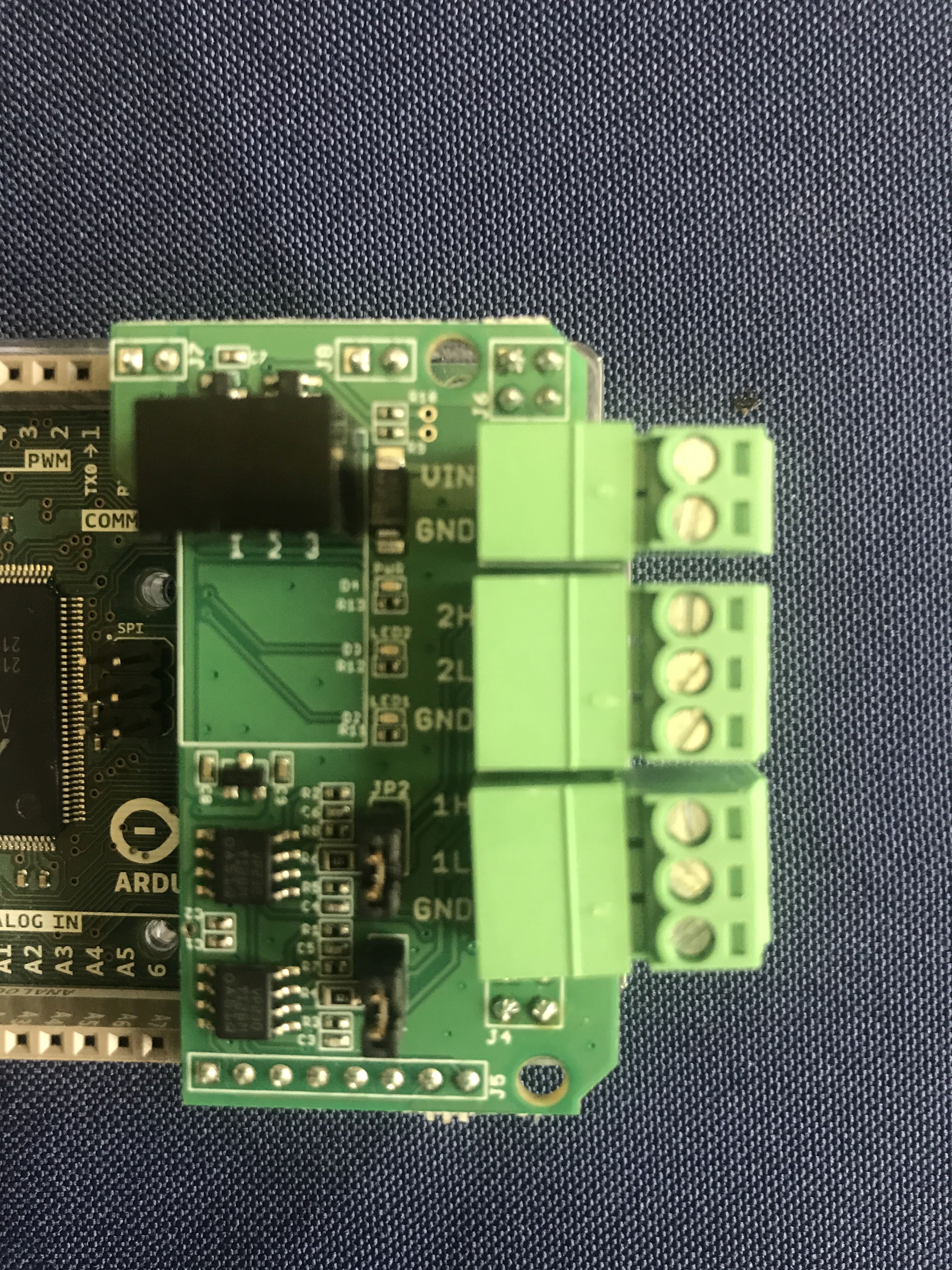

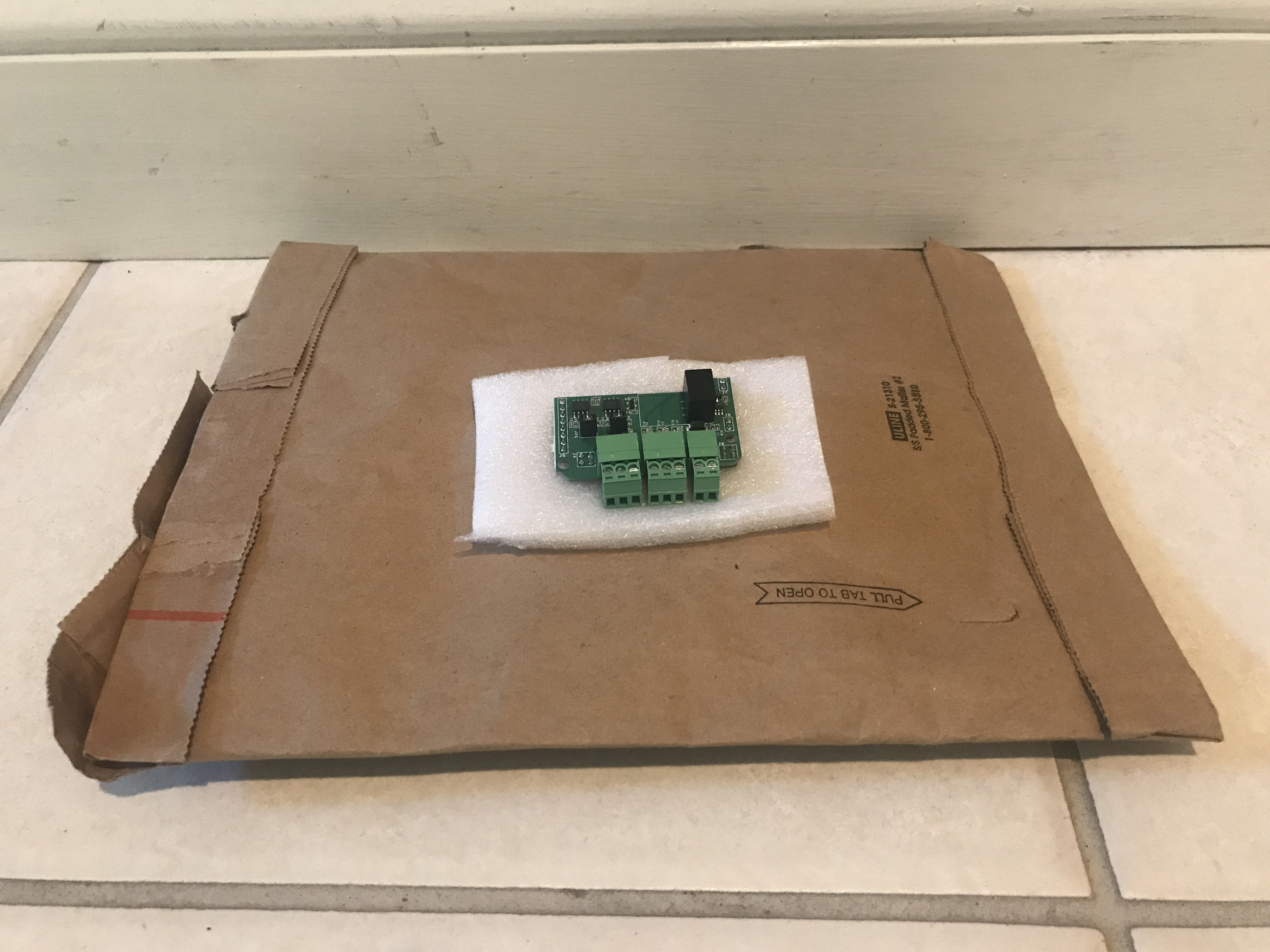

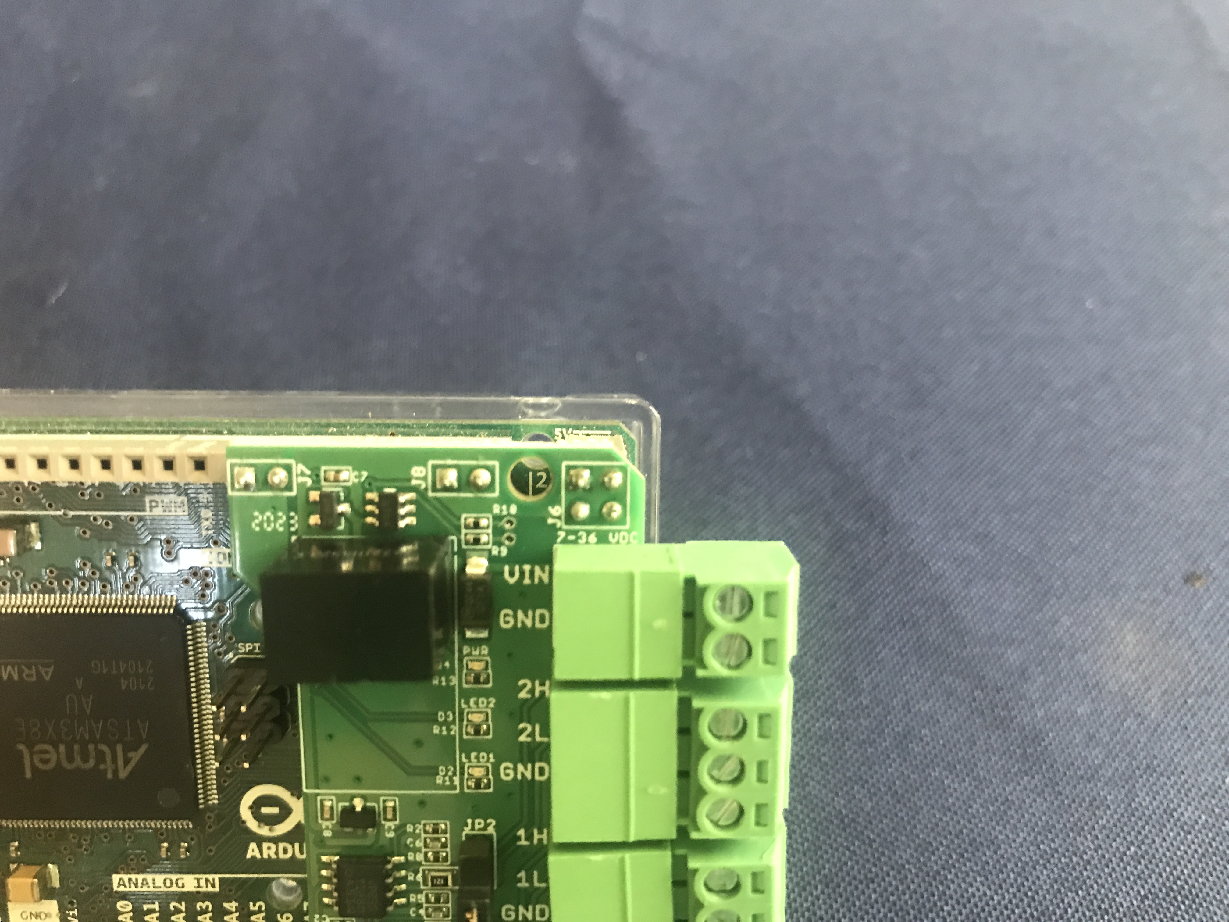

so I plan to use this COPPERHILL TECHNOLOGIES Dual CAN Bus Interface For Arduino Due With Extended Power Range doodad to control my first gen Chevy Volt onboard charger (yes the VCU can run the code to charge it but for Phase I, I prefer to have some isolation)
Initial thoughts, I know this is a dual CAN piece of machinery so I was wondering what the third smaller green connector was for and it appears as though it is for power, ie 7-36 volts DC and ground, well why didn't they just pull the power from the Arduino Due "mother board" why do I have to supply separate power to this animal?
Looks like they Uno reverse carded us:
"In order to more efficiently serve automotive and industrial applications, the JCOM.CAN.DUE-X board supports an extended input power range of 7 to 36 VDC to power the entire system, i.e. including the Arduino Due itself."

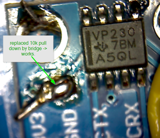

I had two surprises regarding CAN transceivers, and these are totally unexpected, so I will share here:
1. I ordered some SN65HVD234 CAN transceivers from Aliexpress, use them according to the data sheet with Enable pin connected to 3.3V. And what they are doing? They do not drive the CAN lines to a dominant level, they just mirror back on RXdata what the controller sends on TXdata. Means: Some kind of loopback mode. According to data sheet, this type should not have such a mode. The only explanation which I have, is, that they sell wrongly labeled parts. By pulling the EN pin to ground they work.
2. I ordered the cheap CAN transceiver boards from Aliexpress, they contain a SN65HVD230, and a 10k resistor between pin 5 pin 8 and ground. This looks good, it should enable the slope control. But what does the board? It routes the traffic from CAN to CANRX, the controller tries to send the ACK bit on CANTX, but the device does not send the dominant levels on CAN for the ACK. The device is in some kind of "listen only" mode. This is not according to the data sheet. I tried the "strong pull down" (grounded) on the pin5 pin8, and with this setup, the transceiver works as intended.
My conclusion: It is possible to spend a lot of time searching at the wrong place. Nothing works, and at the end it is just a wrong IC. Measuring the lines with an oscilloscope (two channels are sufficien) is from my PoV the only way to find such an issue.

That are some of the exact symptoms i have here with my boards. When i need to innitialize can bus i dont get any confirmation back and nothing moves. I will test now with enable pin to gnd and floating... will get back.uhi22 wrote: ↑Fri Aug 11, 2023 1:05 pm I had two surprises regarding CAN transceivers, and these are totally unexpected, so I will share here:
Here I found the data sheets:
https://www.ti.com/lit/ds/symlink/sn65h ... 1742624106
Re: I think I CAN, I think I CAN...
2. few years back, I had problems with those ali boards too. Ended up replacing SN65HVD230 chip with SN65HVD234 and it worked OK.

@uhi22: Did you test those faulty SN65HVD234 aliexpress chips on polarity of Enable pin? I am interested if they would work with Enable pin floating?
- uhi22
- Posts: 1116
- Has thanked: 204 times
- Been thanked: 611 times
Just tested more deeply. With unconnected enable pin, the communication works. Then connected a multimeter between enable and ground. It shows zero voltage, and still the communication works. Third test, measure the resistence between enable and ground. It is 165kOhms, no matter whether the device is powered or not.
Conclusions: it has an internal pulldown resistor and works fine when leaving the pin open.
This is the strange device: And this is the other from the transceiver boards:

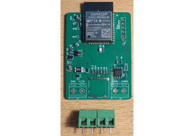

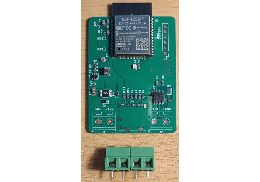

I'm on the way of sorting out the possibilities to observe and to transmit CAN message from the notebook. Is there already a wiki page regarding this? Or other threads? So far I did not find a good starting point. Maybe we should create one.
This is what I found out so far, to reach a working setup for CAN communication on the notebook:
- SavvyCAN is an open-source application with a lot of features, like recording, replaying and graphing CAN traffic. The documentation is here: https://www.savvycan.com/docs/
- We need an interface hardware to connect the CAN to the notebook. There a many solutions, and for me the search criteria was: It needs to be cheap, in best case self-made, easy to modify. I found the ESP32RET project, which is an ESP32 using the internal CAN (and external, SPI connected additional CANs if wanted), and connects via Wifi to the notebook. This sounded great, I had an ESP32 flying around and attached a 3.3V CAN transceiver. But the results were "mixed", I was not able to create a stable setup. So I used to the ESP32RET software as a basis and created a simplified version, which runs on an ESP32s3. It is maximum simplified: only one CAN, no bluetooth, no LEDs, hard-coded to use one existing Wifi network.
The hardware is quite simple: An ESP32s3 dev board and a CAN transceiver, plus power supply. Well below 20 Euros.
The project is stored here: https://github.com/uhi22/wifican
Using the combination of SavvyCAN and wifican I was able to send and observe CAN traffic with the notebook.
The big surprise of SavvyCAN for me was, that it is able to use DBC files. These are defining names, scalings and units for the signals on CAN. And the best is, SavvyCAN does not only use DBCs for graphing, it also contains an editor to create your own DBC files. Quite impressive and helpful.

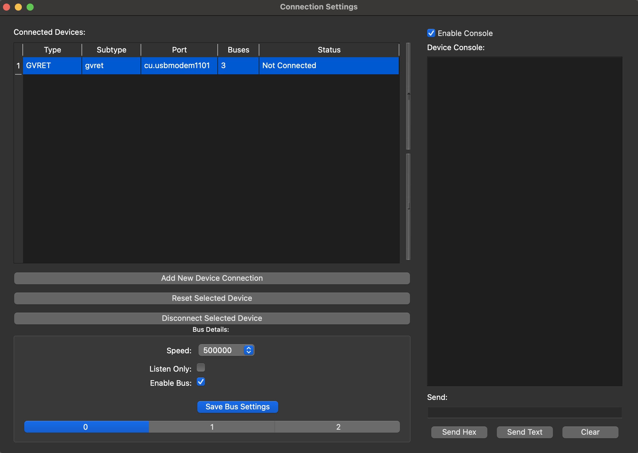

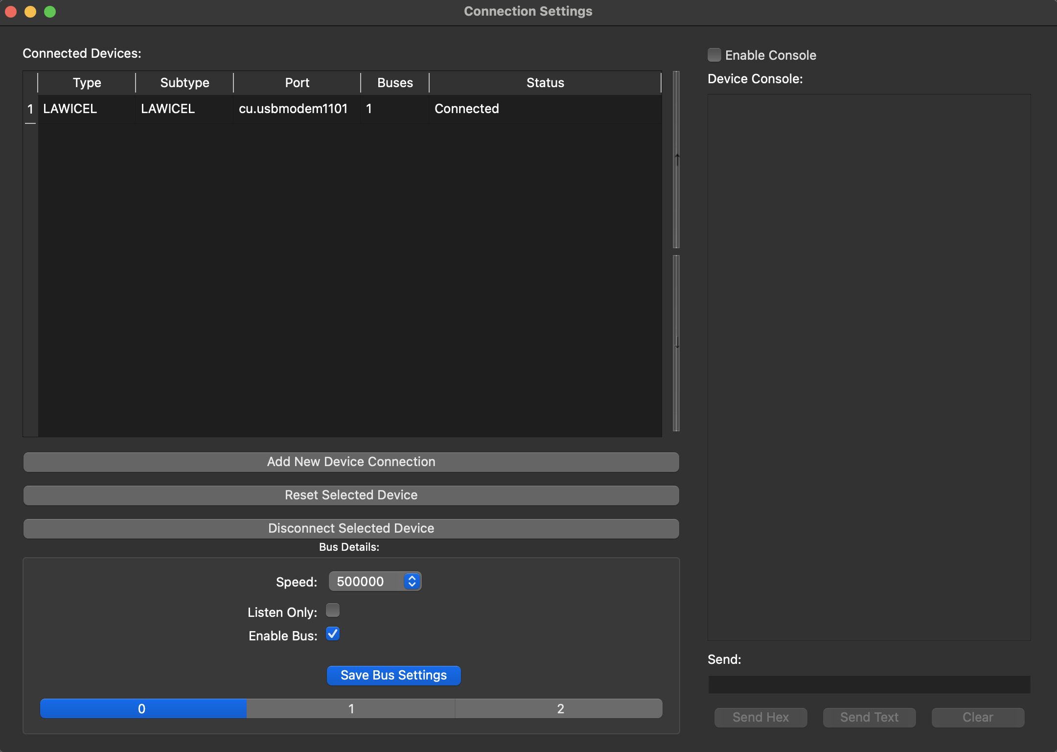

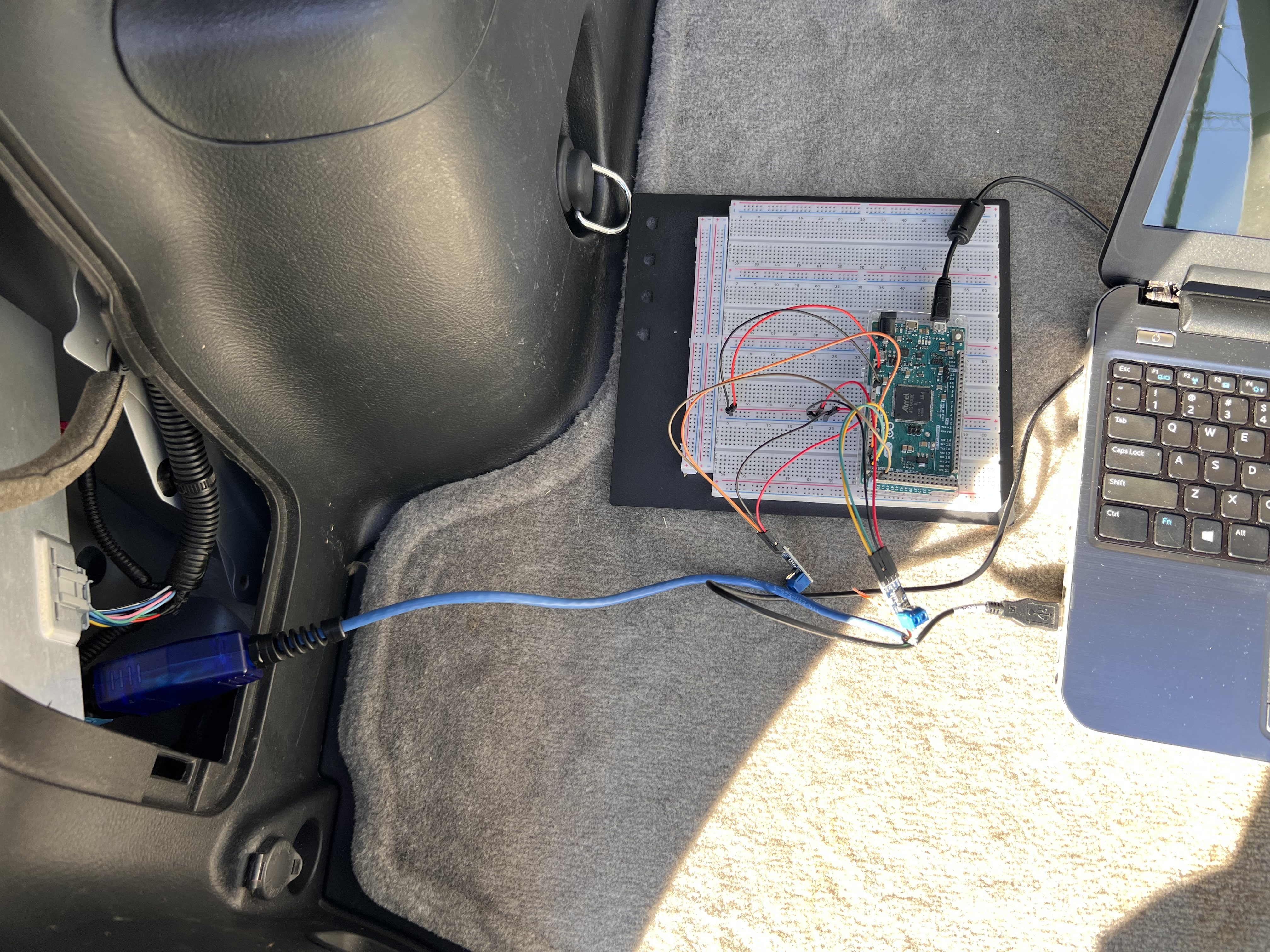

Hello all, I hope someone on this thread can help me. I am using a Mac version of SavvyCAN.collin80 wrote: ↑Wed May 11, 2022 12:03 am Sorry the EVTV board came un-programmed. They shouldn't have sent it like that. Over at savvycan.com there is a binary "updater" which actually just flashes precompiled firmware to the board -> https://www.savvycan.com/GVRETupdate.zip you can use that on basically any Arduino Due based board but as has already been mentioned, the compiled version does expect EEPROM which the Due did not have unless you got the EVTVDue that they sell which does have EEPROM on it.
And, I am aware that perhaps getting all the tools working and getting SavvyCAN connected might not all be the simplest thing ever. Compiling it all yourself is probably quite the adventure. It's tough for me to get a good baseline of where all the pinch points are because I can compile it all in my sleep at this point.But, even I get frustrated sometimes when trying to get various devices hooked up and working. I obviously have a lot of EVTV boards but I also use PeakCAN and Kvaser tools, I have the Microchip black box thing too. I have lots of CAN adapters, the PeakCAN and Kvaser are the easiest to use but the most expensive too. Really, for me the coolest one is either an EVTV ESP32 or the related Macchina A0 - both of which can connect to SavvyCAN over wifi. The A0 is especially cool in a car where you can slap it onto an OBDII port and away you go.
And, SavvyCAN is probably quite the mountain to climb because it started out as a tool for me (and a way to learn QT programming) and just kind of evolved over the course of years into having everything including the kitchen sink. There's probably like 4 ways to send CAN traffic for instance. You can use the fuzzing window, the frame sending window, you can write scripts in the script window, you can replay captured traffic. Some of them overlap but everything exists because me or someone else wanted to do something it didn't do yet. I wish I had more time to work on all the CAN tools but recently I just haven't been able to. Still, there is some progress. Be sure to check the "continuous" build if you want all the newest toys. It's automatically compiled for all three operating systems supported. Technically people compile SavvyCAN for Raspberry Pi too. But, I don't have compiled binaries for that.
I followed the directions on the OpenInverter Wiki page for CAN bus with Arduino Due (https://openinverter.org/wiki/CAN_bus_with_Arduino_Due) and have reached the final step of closing the Arduino IDE and adding the connection in SavvyCAN. However, SavvyCAN cannot recognize my GVRET-loaded Arduino Due. Interestingly, I am able to connect to the LAWICEL version. First, here is the screenshot of my GVRET (showing not connected):
Then, here is a screenshot showing that the LAWICEL version does show as connected: To get the LAWICEL to connect, though, I have to close and reopen SavvyCAN. This doesn't work with the GVRET serial connection. I should also note that SavvyCAN at least detects that the Arduino Due is connected to the USB port, as it shows up on both the Serial GVRET and Serial LAWICEL menus.
Any thoughts?
Thank you!
In response to my previous post above, I just got it working, but I had to find an older version of SavvyCAN. It works for me, and my mac, on version v199.1. However, it does not work on any of the follow-up versions I've seen on Collin's website (V208, V213, Pre-Release development build from November 2024, and QT6 Development Build from December 2024). Any thoughts as to why not? The website I accessed to retrieve the different versions of SavvyCAN is: https://github.com/collin80/SavvyCAN/releases
Not sure if Collin is still active on this forum, but if so, THANK YOU for developing and sharing this software!
