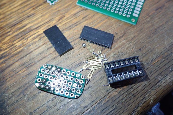

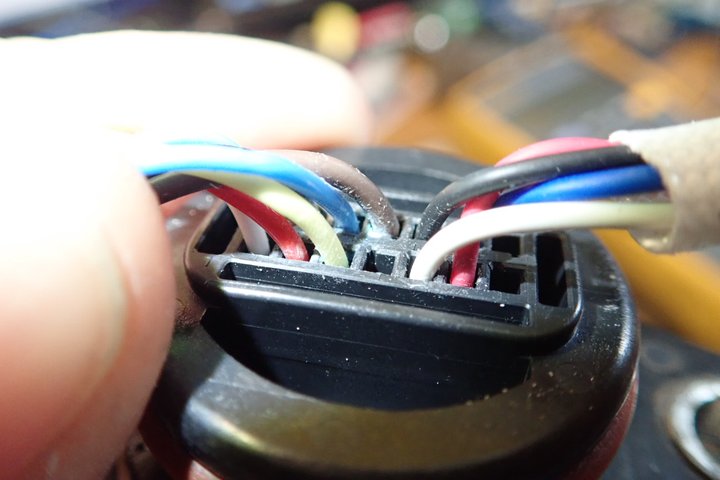

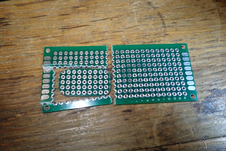

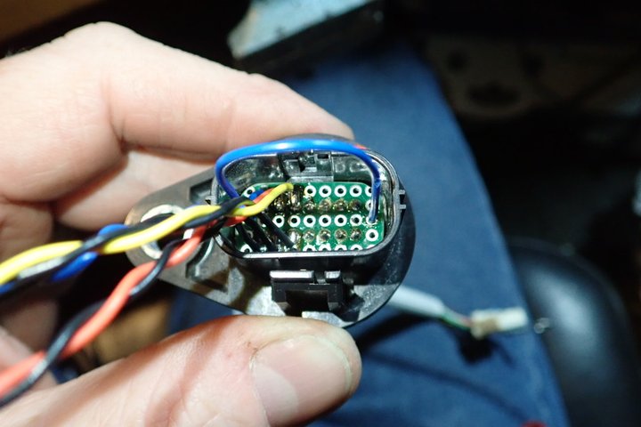

I'll add my resolver to the list,
35.7R Black, White
85.0R Green, Red
77.2R Yelow, Blue
Sadly I spotted moisture damage on the resolver connector so I'll be abandoning it for some other solution.
The photo does not show up the tell-tale blue/green powder indicating corrosion of the crimp connector. This might explain why the motor was for sale on ebay without a gearbox attached. Although I didn't spot that until after I bodged up a connector for testing and is not intended for any serious use.
I noticed the connector pitch was 2.54mm x 5.02mm which matches the holes in prototyping board and plenty of PCB connectors.
the pins are flat plate rather than a square pin so rather fragile when bodging anything to them. An IC socket grips the pins whereas the other connector of the sort you have around the edge of an Arduino did not because the pins are flat plate rather than a square section pin. I'll reinforce this is not a long term or serious solution and just for testing.
I thought I'd share this as no one has found a replacement connector yet.

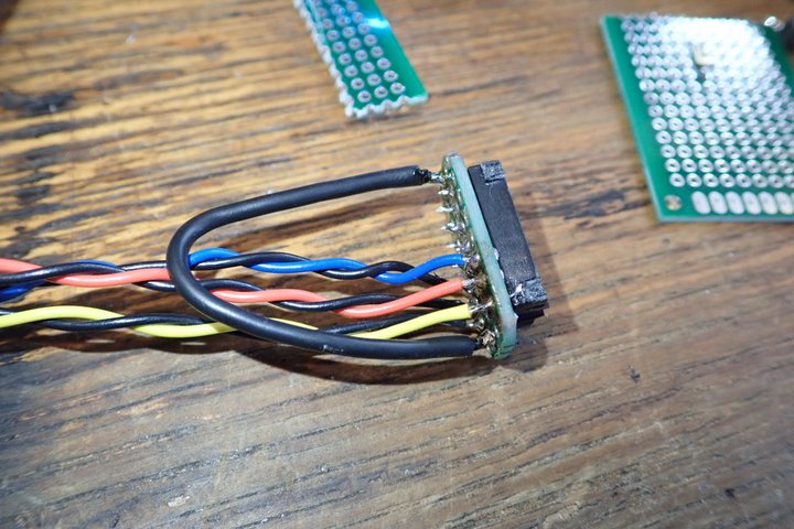

I see i could easily make a new flat plug and put 8 pin Liycy cable through it. It would work on both sides. It would require to make a circular plug on a lathe and make a groove for O ring. Then i could use a large flat washer to hold the plug down against the casing. It is the same connector on both sides so i would just use a through cable and 8pin sealed connector here.

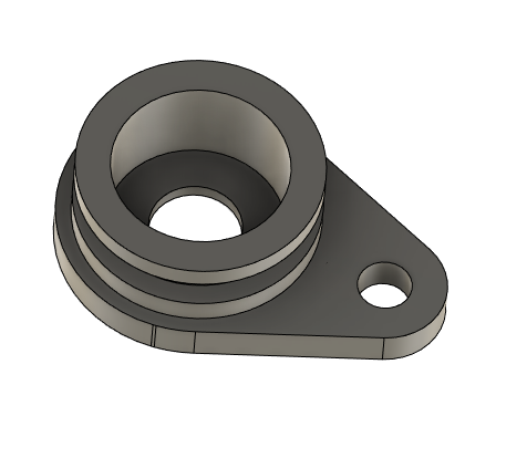

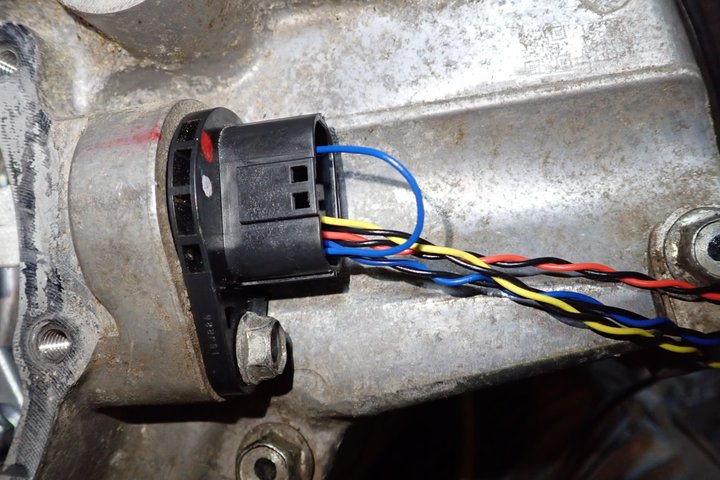

I went down the Liycy cable route in the end. Designed new cover to replace the original connector that will fit an m12 cable gland. Uses the original O ring to seal.
I'll test fit this on the weekend and update this post.
Edit: It fits really well!
STL file is here if anyone wants to try it first. https://www.thingiverse.com/thing:4557232
Also hoping to have this running from a Prius gen 2 inverter this weekend. Updates to follow...

I have the motor running on the Prius gen 2 inverter. This is just in manual mode for now. Still need to tune it all in and get the throttle plugged in.
But it seems quite smooth once it's moving.

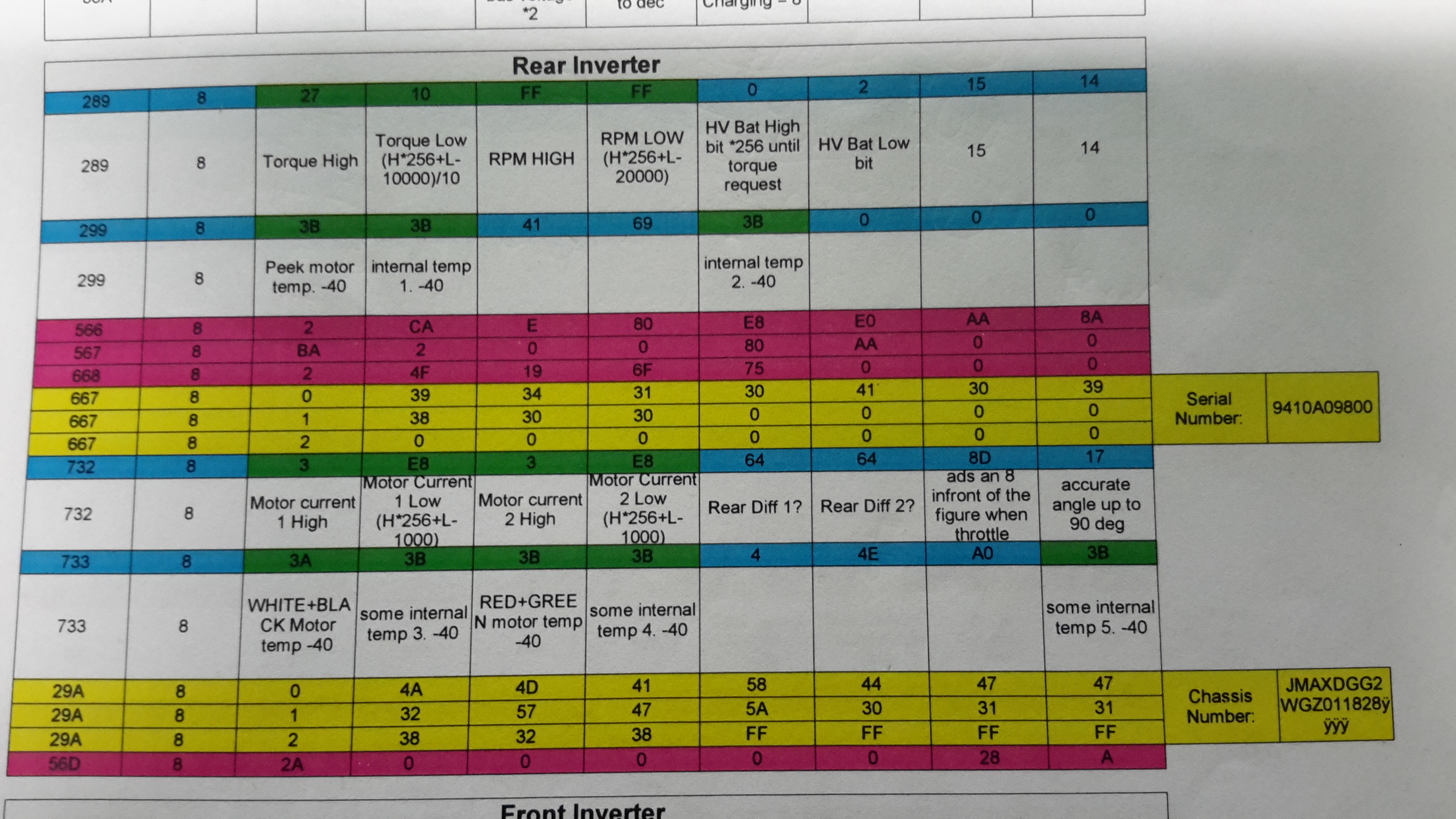

So, update on getting the Outlander inverter to drive the motor. Need to have pin 13 (IGCT) on the Grey connector (D-211) connected to +12V to wake up the inverter. Inverter also appears to monitor pin 12 (RSDN), and reports this on CAN 0x289 byte 8 (not connected is 04, connected is 00)
Have got the inverter hooked up with the motor and can see CAN messages from the inverter.
If we put HV on the inverter, can see this reported on message 0x289 byte 5&6

Re: Mitsubishi Outlander rear axle
I have done a little messing with the rear inverter here's some of the output messages I have figured and found on other places on the Web and semi comfirmed.
(I gave up typing in and just took a photo sorry for being lazy)
