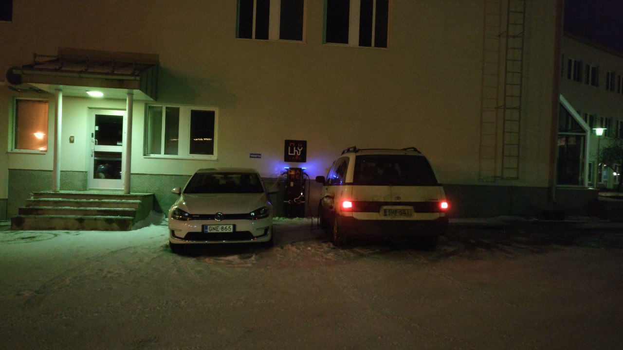

I finally converted my CHAdeMO-ish test charger to an on-board charger and installed it into my 1992 Previa. It's currently managing 16kW 24A 3 phase (that's input power, and efficiency isn't the best), but somehow stumbling at 17-22kW. 16kW is fairly fast already though, from these ubiquitous and reasonably priced Type 2 charge stations.
I tested it without coolant flow, and it could manage almost 1kWh of charging until it got too hot. My temperature sensor calibration is probably wrong, but my software limited it to what it thought was 70°C, from a starting temperature of maybe 5°C (didn't check) (very scientific, LOL).
The inside of the inverter still looks like this, just with some cables added towards the external world and with insulation added around the obvious places: viewtopic.php?p=3840#p3840
Added externally to the inverter: 32A 3 phase circuit breaker + AC RCD (the RCD part is unnecessary as you want to power this through a DC capable one externally - altough that's expensive), an overkill contactor (50A? 63A? don't remember) and precharge contactor to make sure the input terminals will not stay live after charging no matter how badly the thing explodes, an universal-ish control PCB modified for this use with two Arduino Nano clone boards (connected via SPI to each other - one does the charging algorithms, PWM and CANbus comms, the other one reads the EVSE CP PWM and PP resistance and controls two LEDs in the charging connector) and a 12V power supply tuned up to 13.5 or so volts. It connects to the rest of the car via CANbus, a 12V "ignition" signal to power up the rest of the car and 16mm² HV+ and HV- cables connected into the rest of the system via a 100A fuse.
Pros and cons of this approach compared to a Tesla OBC?
Well...
It's loud, potentially cheap, and lots of work. When I have the charger and the Eberspacher diesel heater in use at the same time, this minivan sounds like a jet engine.
Here it mounted to the Previa:
Well...
