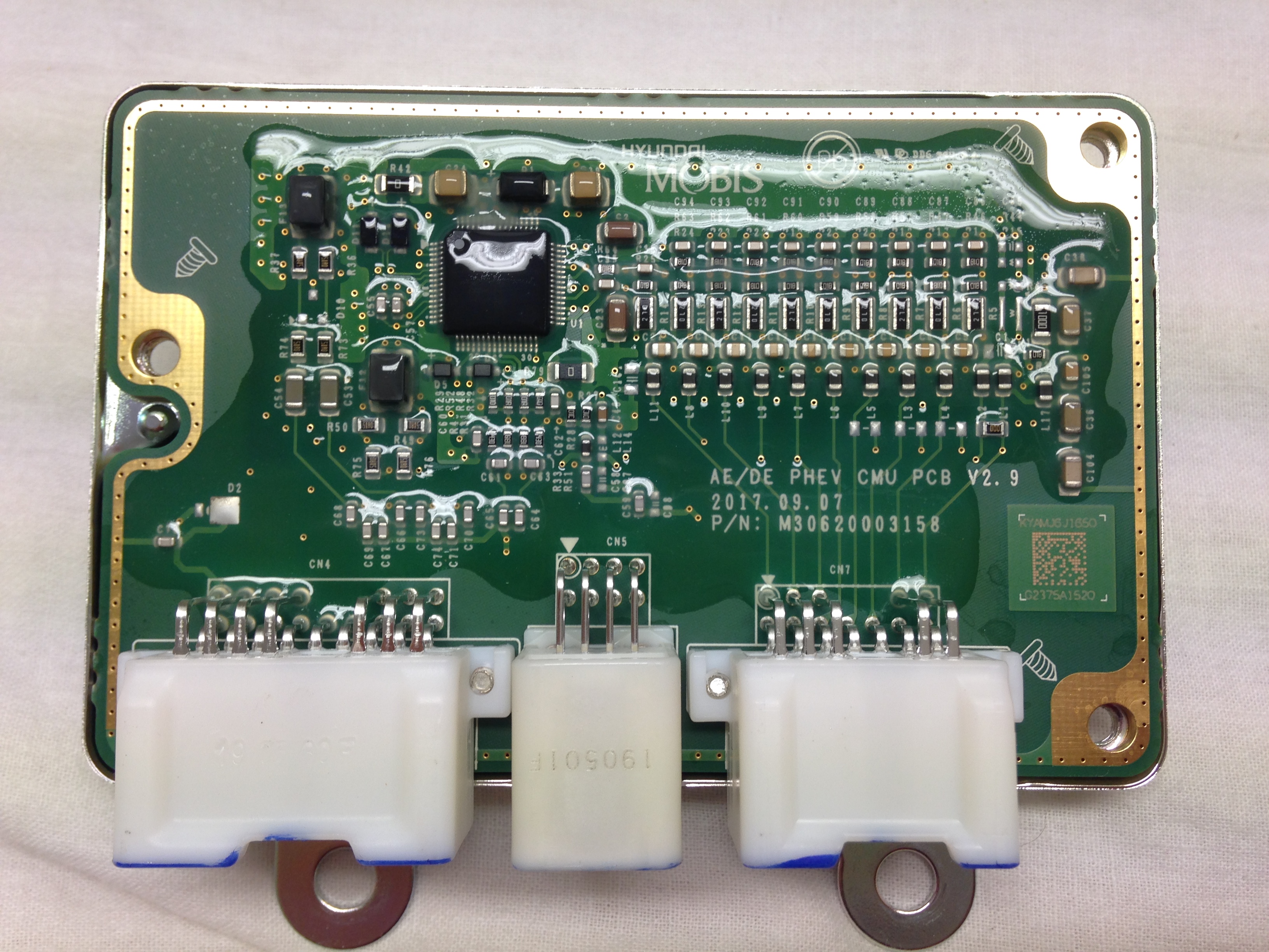

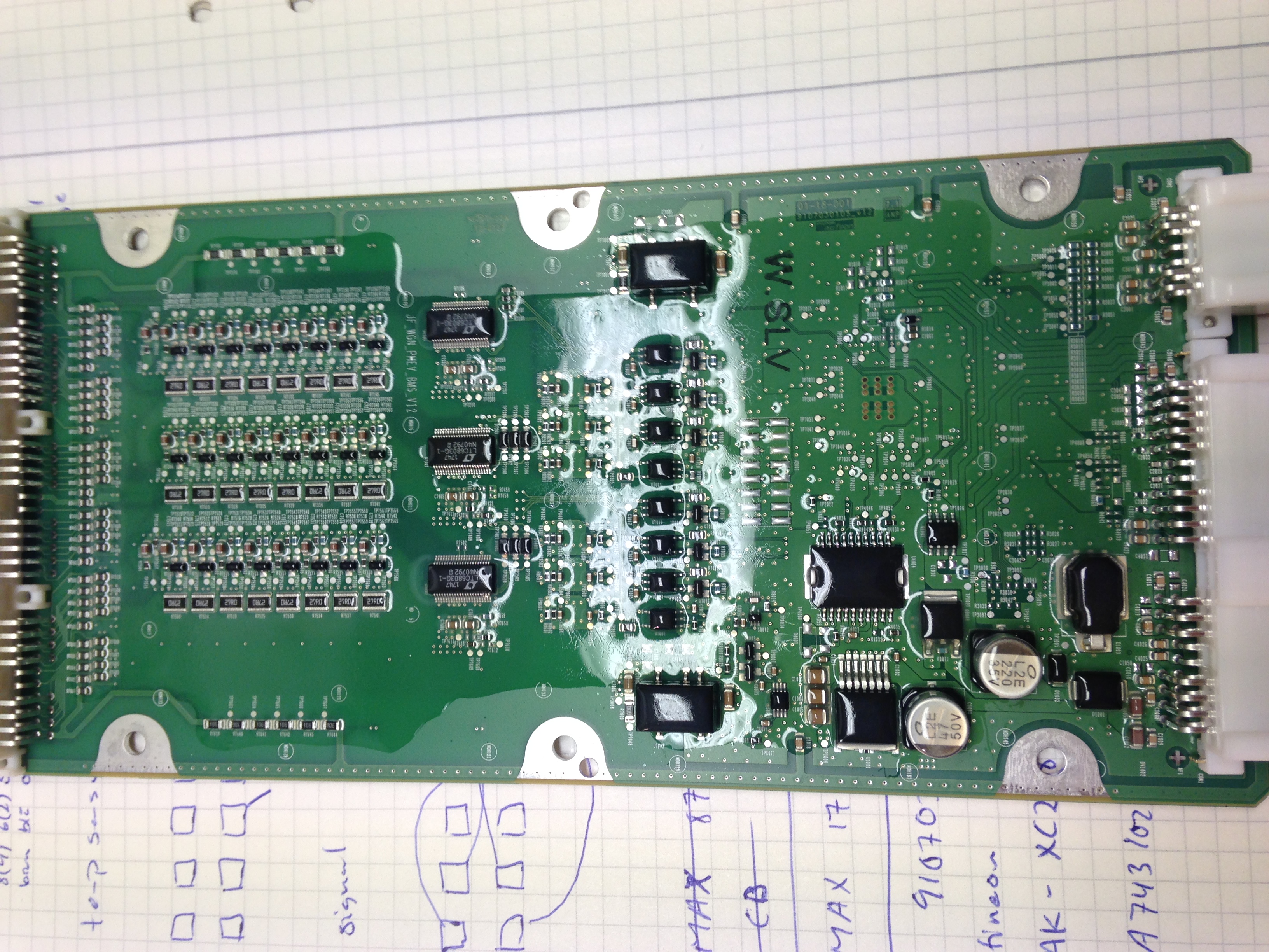

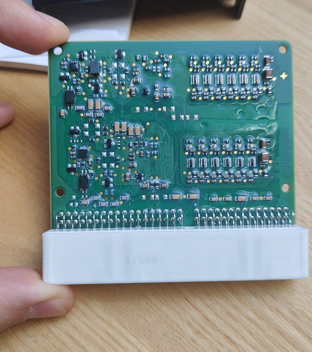

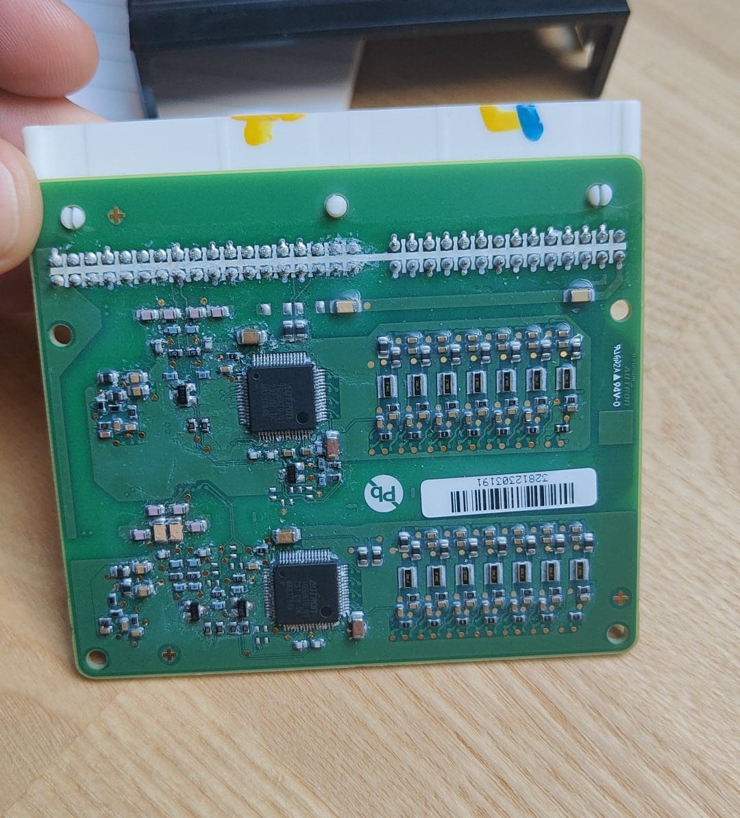

Posting some pictures of the BMS used in the Kia Niro PHEV.
Battery is 96S.
12pc of slave modules connected each to 8 cells or more specific two modules of 4 cells each.
Slaves are proably connected in daisy-chain fashion. Using MAX17823BG chips to measure cells.
Slave board, front.
Slave board, back.

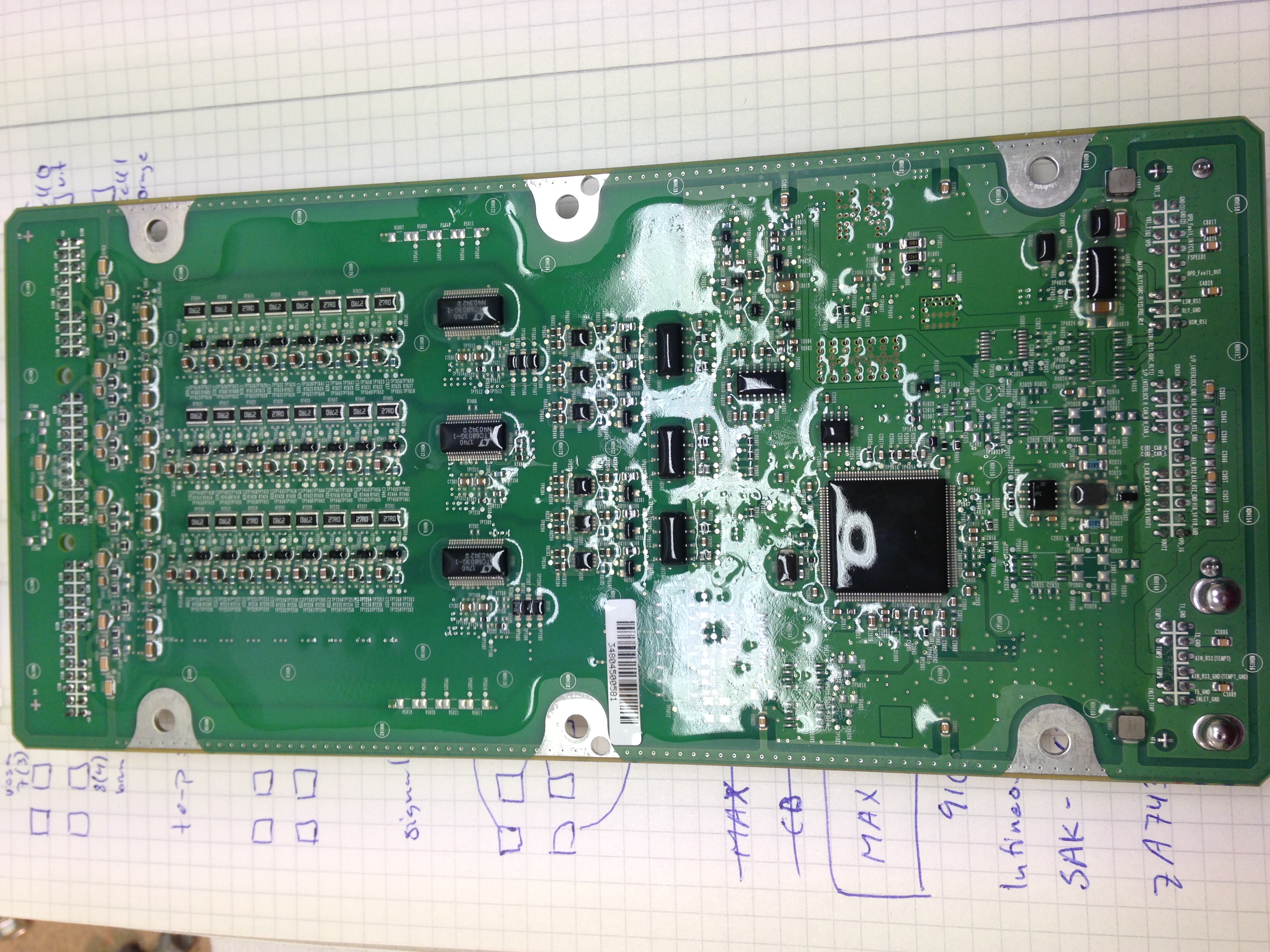

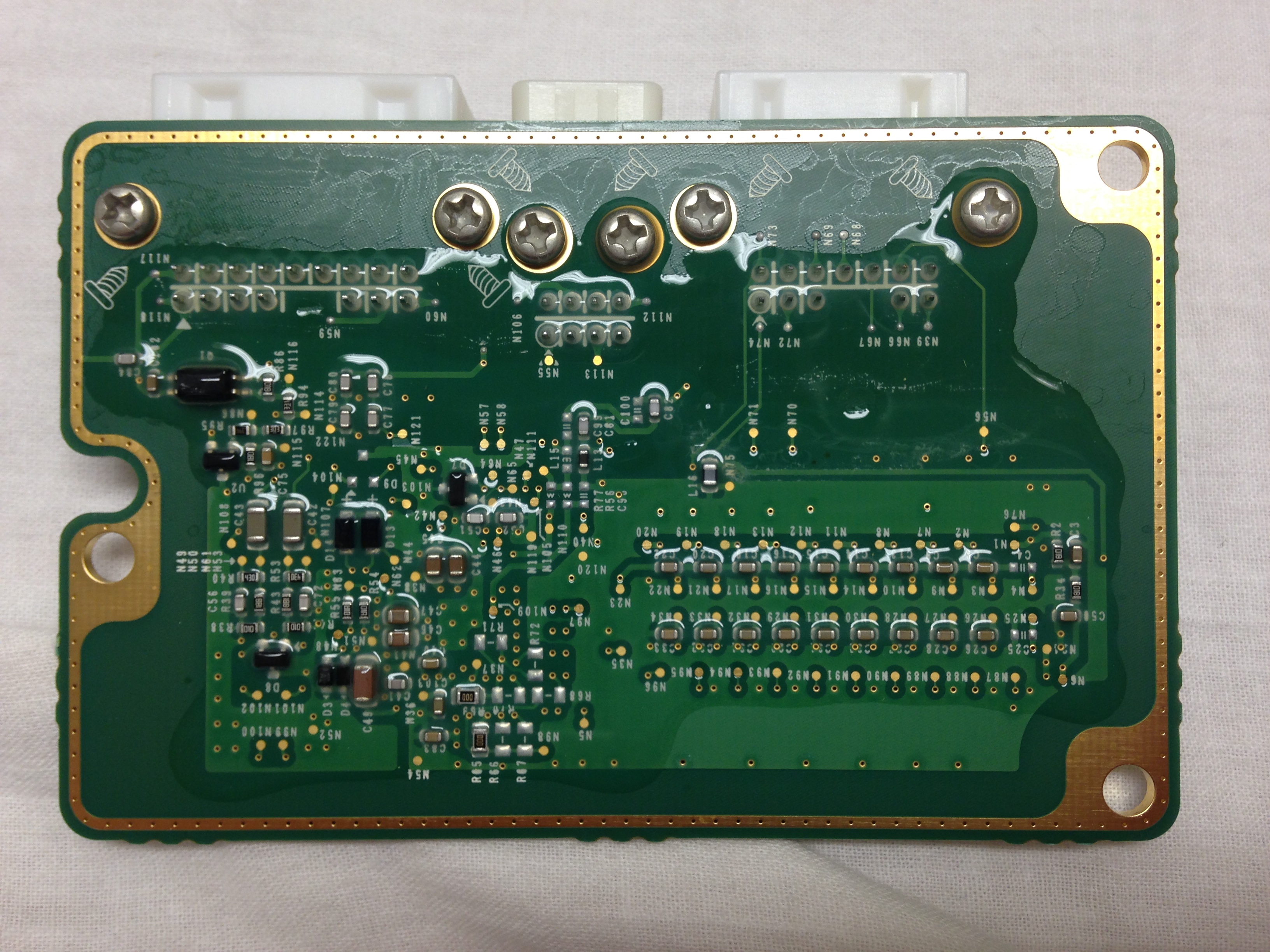

The master is a very odd one. This unit is used as stand alone in the Niro HEV and as a master in the PHEV.
It uses a Infineon SAK-XC2387A as main controller and when used in HEV 6pc of LTC6803-1 for measurement.
To my suprise these LTC6803 chips are still mounted but not used in the PHEV? These chips cost around 15€ if I bought them at low quantity. A bit of a waste to mount them and not use them...
EDIT: I have looked into this and found out that the master I have is from a Kia Optima and NOT the Niro.
Master board, front.
Master board, back.

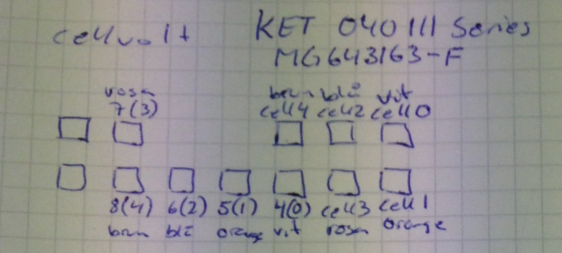

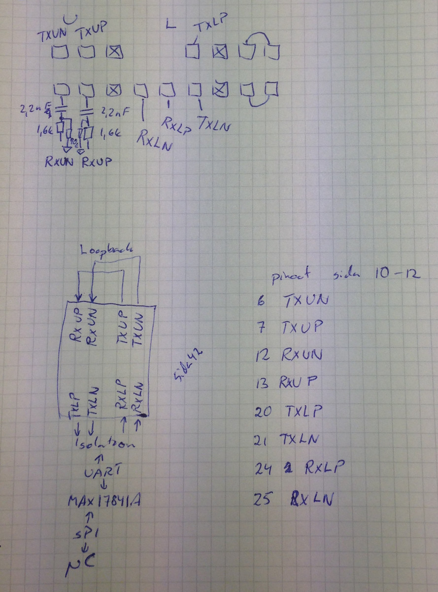

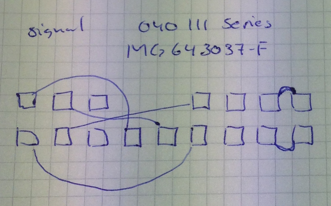

Forgot the slave connector pinouts.
Cell connector when seen from the connector side.
Communication connector when seen from the connector side. The pins with lines inbetween switches place every next module, hence my guess, daisy chain.

I have looked into this and found out that the master I have is from a Kia Optima and not the Niro. First post updated.
The Optima uses a centralized bms consisting of two "master" modules where one is master and the other is slave.
The master module for the Niro is another thing, part nr 375A0-G2610. The guy I bought the battery from don't have this one so I will have to manage without it or source a separate one. Not shure if it can be used anyway but would be good to look at for design ideas.
My plan is to use the Niro cell-modules together with a home built master. The MAX17823BG have a datasheet and is recommended to be used with a MAX17841B to translate from Maxim's Daisy-chain differential UART protocol to SPI.

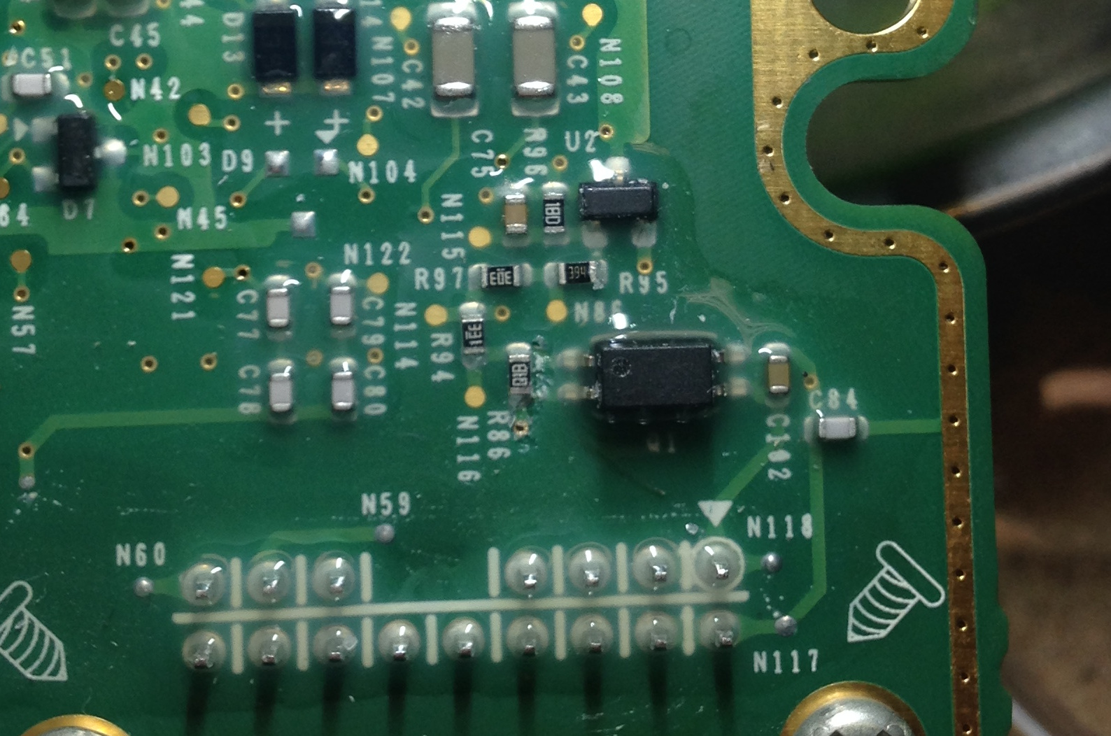

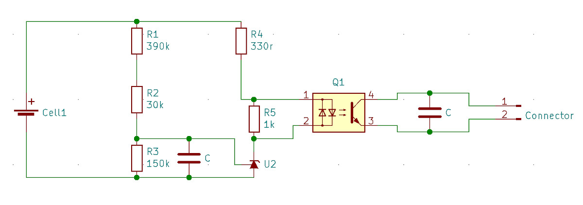

Today I did some more investigation.
Complete slave module pinouts. Note that the pins are not connected directly to the slave controller IC, there are components in between but that is how they end up.
At this point I can't find out whats exacly connected to the pins to the right in above pinout. It is a chain with all slaves connected in parallel when all slaves are connected.

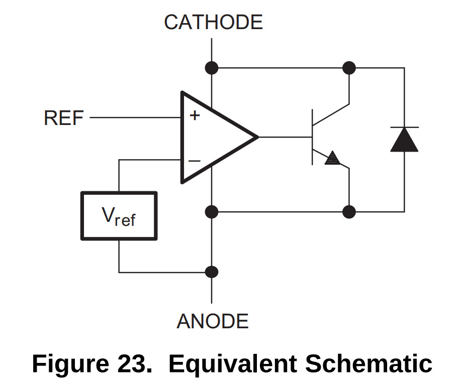

What I have found so far including my guesses on Q1 and U2.
U2 guess is based on pinout and possible usage of for example TL431 shunt reference.
Might be a voltage monitor or similar as well. I need to investigate this further.
Anyone have any guesses for Q1 and U2?

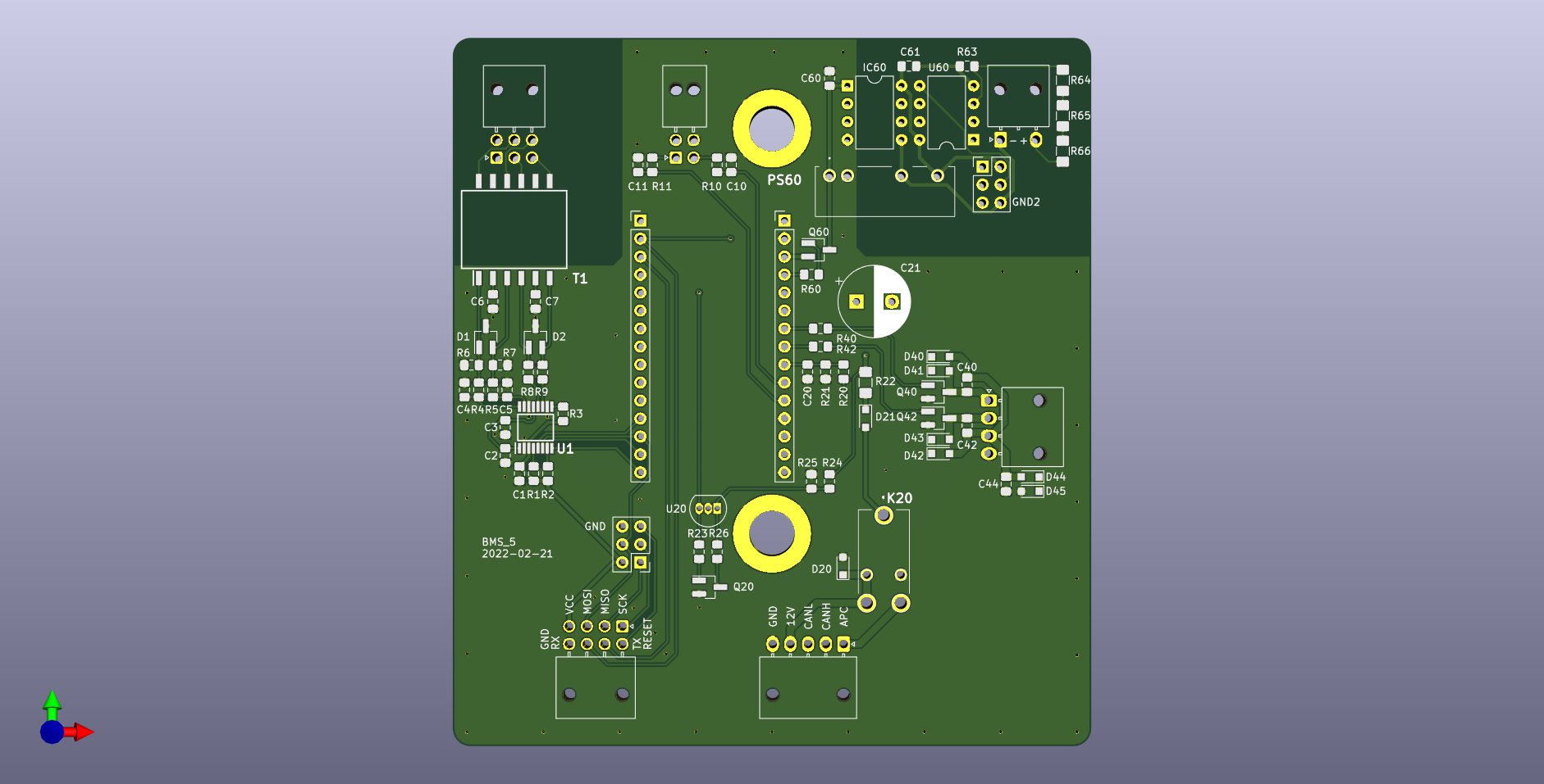

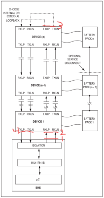

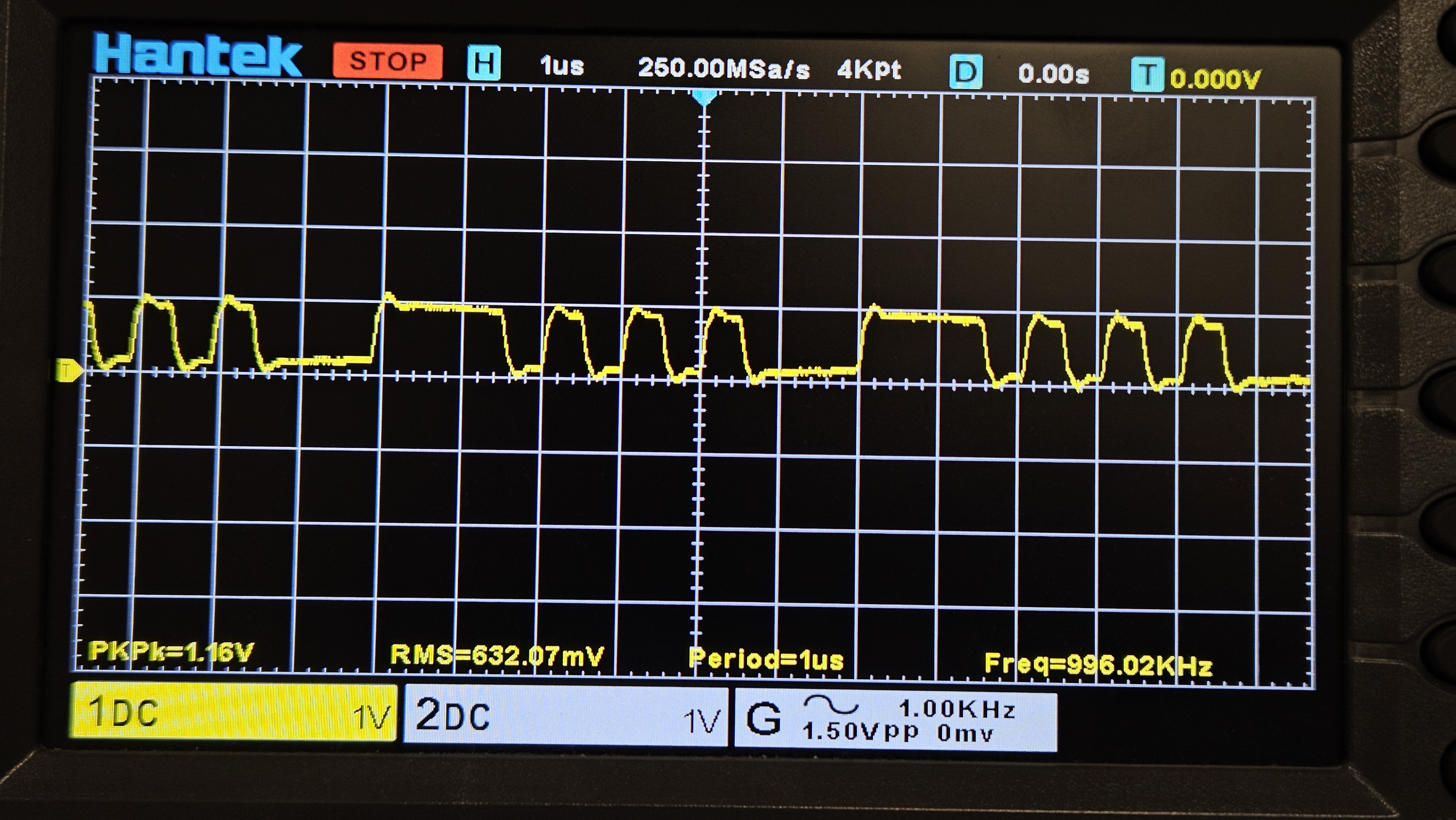

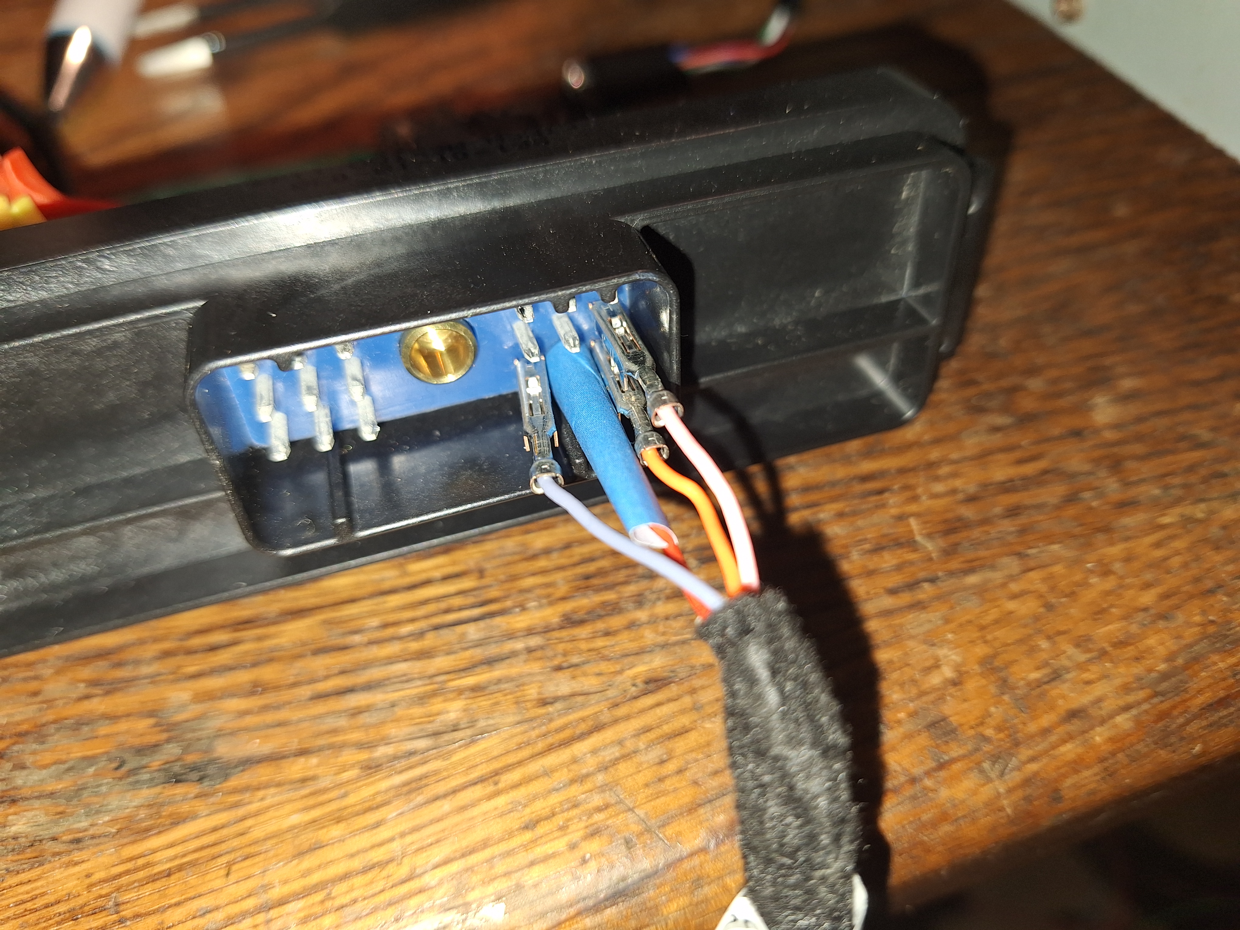

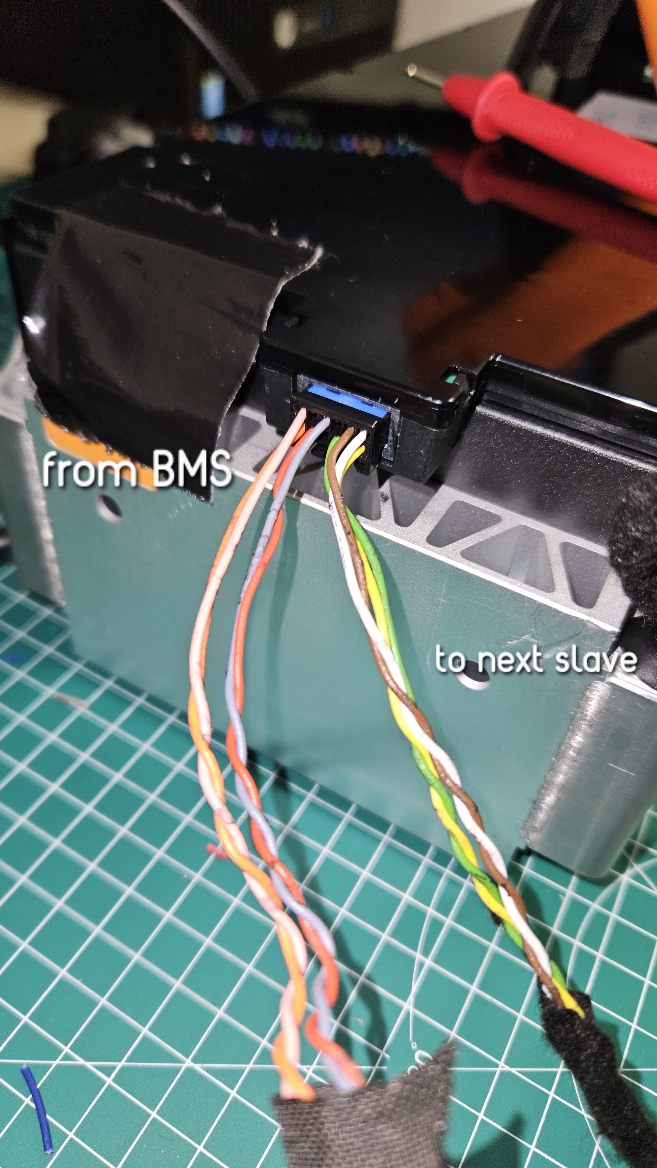

I've been able to comunicate with the cell modules using a MAX17841 between the Arduino Pro Mini and the daisy-chained slaves.
Connected as per schematic.
BMS.pdf
(34.85 KiB) Downloaded 1942 times
As of now I have only set it up and been able to read out the cell voltages.
Next is to see if I can get cell balancing to work.
There is also a lot of diagnostics available but needs more work with the code so this will have to wait.

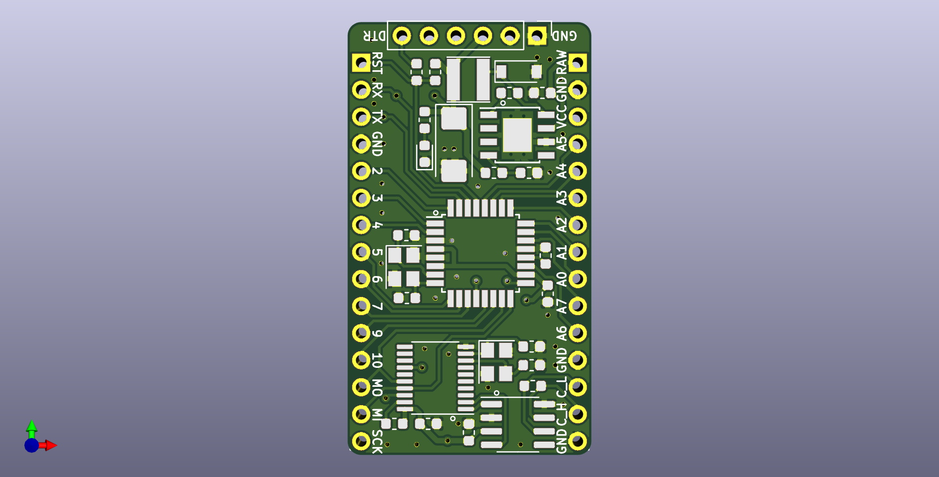

My main BMS board consists of one micro controller board (ArduinCAN) on top of the BMS_5 board.
Schematic:
ArduinoCAN.pdf
(55.16 KiB) Downloaded 1145 times
BMS_5.pdf
(73.95 KiB) Downloaded 1246 times
Pictures:
The 328P can be used with a Arduino Pro Mini bootloader. I uplod via ISP directly which gives quicker boot of the uC but needs some "FUSE" adjustment to not overwrite EEPROM when uploading this way.

bexander wrote: Mon Dec 07, 2020 3:00 pm Today I did some more investigation.
I have a Kona Slave here on the bench. How did you find the comm pins? Does the board need external supply or does it use the cell voltages directly?
The Kona slave board has 2 slave chips on one board.
But its very similar in components (which is obvious but still good to mention).
bexander
Posts: 897
Location: Gothenburg, Sweden
Has thanked: 78 times
Been thanked: 102 times
Re: Kia Niro BMS
Post by bexander »

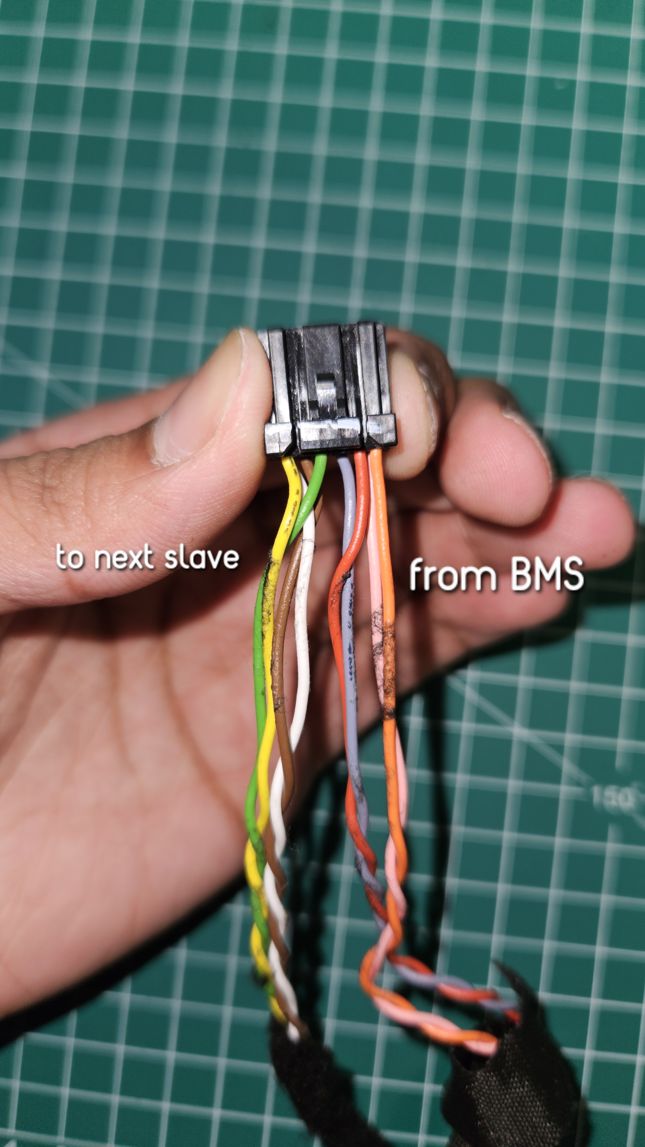

EV_Builder wrote: Fri Sep 16, 2022 11:45 am I have a Kona Slave here on the bench. How did you find the comm pins? Does the board need external supply or does it use the cell voltages directly?
Both looking at the cable harness that was used to connect the slaves together and also looking at the MA17823 pinout in the datasheet and following those on the pcb to the connector.
EV_Builder wrote: Fri Sep 16, 2022 11:45 am The Kona slave board has 2 slave chips on one board.
Two slave chips? Both MAX17823 or something else? Please, post a picture if possible.
I have examined the slaves from a Kia E-Niro (EV) and I think they use ASIC:s so not possible to find and datasheet or similar.
EDIT:
I have examined the slaves from a Kia E-Niro (EV) and they use the MAX17845 circuit.

marucha79 wrote: Sun Sep 18, 2022 3:06 pm Hello @bexander. Could You share the code for ATtiny85? And another question - what type of current sensor (for A6 and A7) do You use?
The ATtiny85 is used for HV voltage measurement. Built with parts I had at home so not required to use the specific parts. Anyway, here is the code:
BMS2_VM_2_0.ino
(487 Bytes) Downloaded 1058 times
Very advanced code... :)

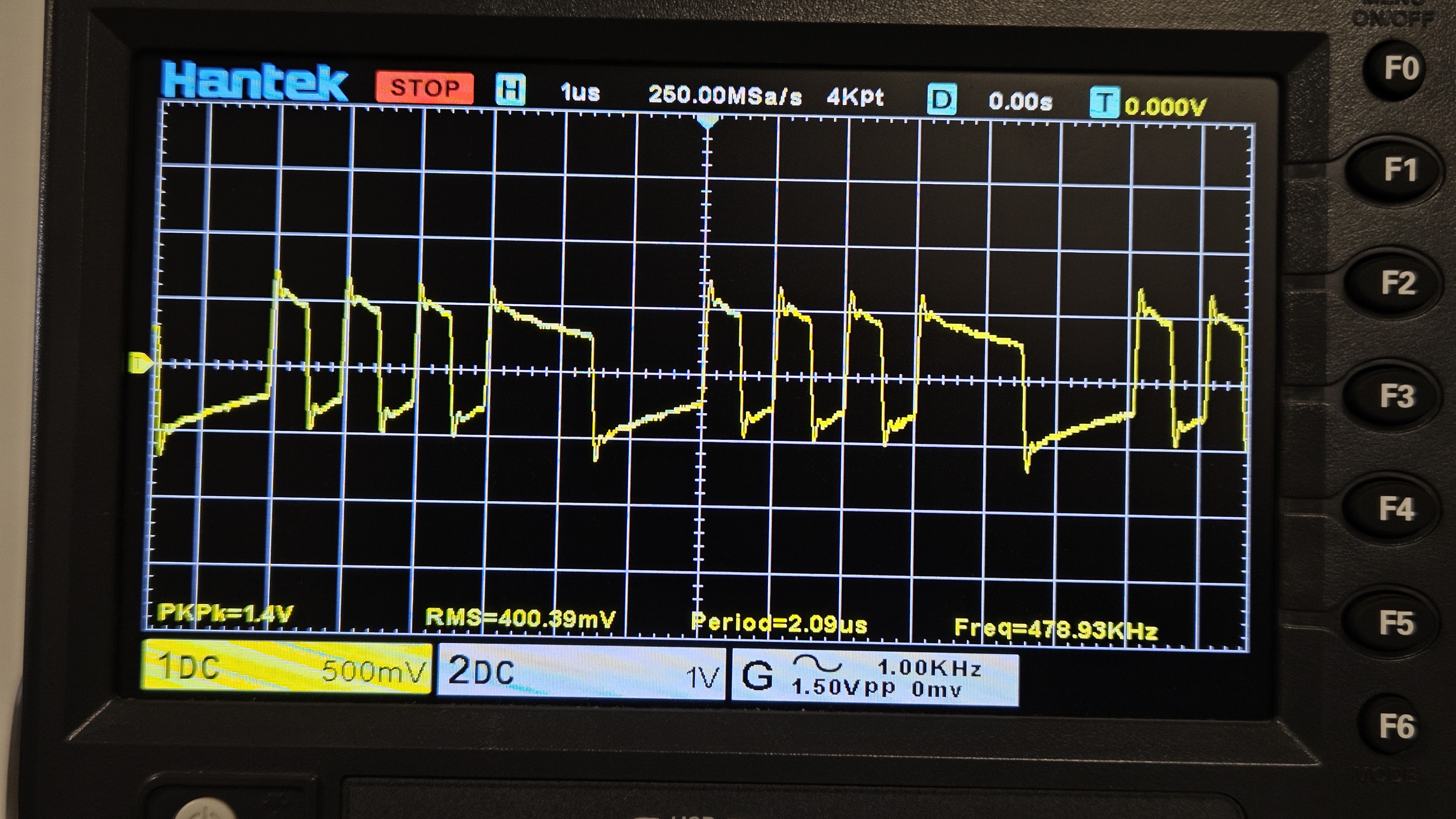

You might need to adjust osccal to get correct UART timing when using internal RC-based oscillator as clock.

EDIT:
And the osccal code:
OSCCAL.ino
(436 Bytes) Downloaded 1122 times
Measure output with a oscilloscope and adjust osccal to match set times.

bexander wrote: Fri Sep 16, 2022 4:45 pm Two slave chips? Both MAX17823 or something else? Please, post a picture if possible.
These are marked: MAX17845

Very interesting. Could not find the datasheet for this 17845 but found one for the 17843. Seem to communicate using the same interface as the 17823.
If it is the same as for 17845 I would try to locate pin 6, 7, 12, 13, 20, 21, 24 and 25. Those are the communications pins. See if you can trace them to the connector?
