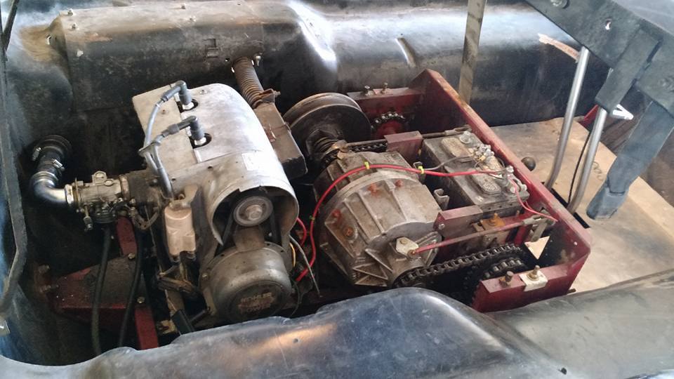

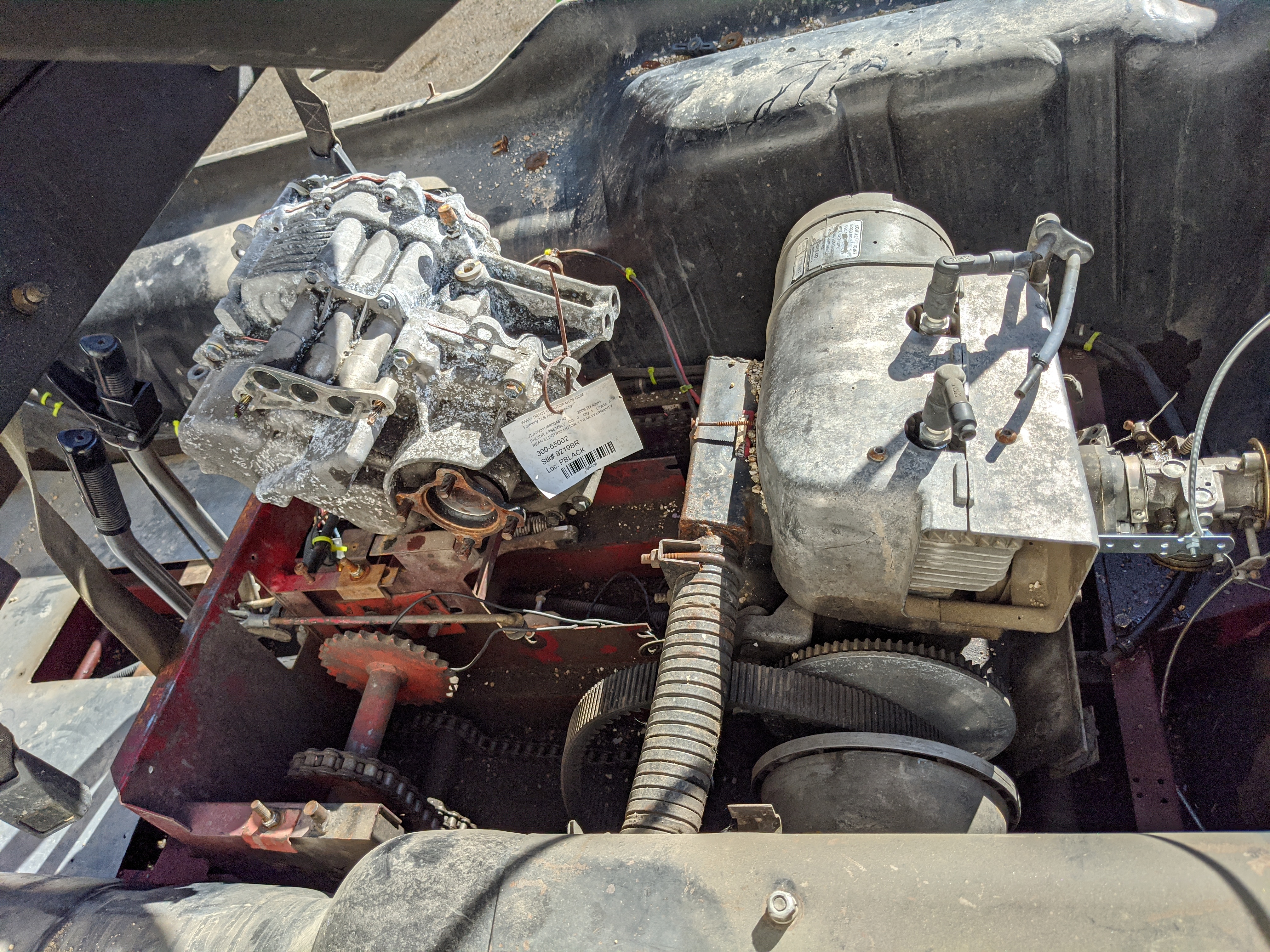

For reference, here is the engine/transmission bay. The engine, transmission and 12v battery be taken out and its pretty much an open area I can install a platform on to make a battery box how ever tall it needs to be. Set the MGR on top and run a chain down to the axle chain drives. Or reverse, put the MGR under a battery box, but would need to watch the temperature. I would probably put the inverter and other controls around where the 12v battery is, which is under the seat. There is also a sizeable fuel tank in the nose that would be worth while putting some weight in to help balance it out some.
The point of the MGR is to use a single AC motor and have an open differential powering each side, and then use disc braking controlled from the levers to force power to one side or the other as needed.

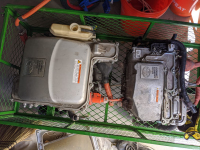

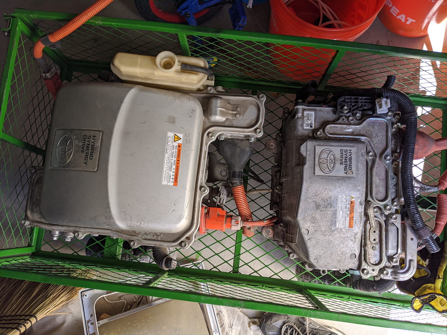

Went to the local salvage yard and for $110 plus tax and environmental fee I picked up a Gen 2 and Gen 3 Prius inverters. Now to figure out which to use. I'm inclined for this ATV to start with the cheapest option to run the MGR, which is Damien's solder together board... but the new Johannes board is tempting. The idea of possibly being able to convert the ATV to electric for less than $500 +batteries is tempting, and the solder together board would make that budget target easier. There is an ebay seller with a couple of the Lexus MGR's for $150 +shipping, but are located 2 hours away so could probably take my electric car to get one without shipping cost). Then the miscellaneous sprockets, chains, brake assemblies, and wiring...then battery...
I need to look in the software, if there are differences in the programming software between Damien's and Johannes' boards. I see Damien recommends Johannes' board, which certainly means something!

Software is the same for both boards, AFAIK the Damien one needs current sensor scaling (that is included in Johannes' solution).
Of course soldering up your own board is tempting. But price is never the same as cost. Chances are you'll get the wrong components or solder something backwards, et cetera, and end up spending more on replacement parts than a fully assembled solution costs. (No reflection on your abilities, just my experience and that of others. DIY gets messy.)

Picked up a Lexus/Toyota MGR for $100 today. Was supposed to be a 2012 unit, but when they brought it out it was missing the axle shafts that were in the advertisement, so they went back and found a less pretty 2006 one. At least the copper connectors are clear of corrosion and there is a 1 year warranty on it.
It definitely weighs less than the transmission I currently have removed and the potential ~68Hp should be nicer than the maybe peaky 20HP of the 2-stroke engine. At some point I'll need to start a project thread. $50 inverter, $100 MGR. Working on getting a through hole Damien board.

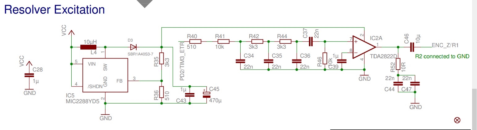

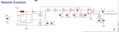

Continuing on with my basic questions. I have an old evbmw.com Prius Gen2 inverter through hole control board on its way, and reading through the forum and wiki to see how to wire in the toyota MGR, I'm seeing two complications, one maybe a hangup?
The Toyota MGR uses a resolver, but from what I can tell the board itself does not have a resolver exciter on it? The wiki says "Functionality of the existing resolver is integrated as well." which I assume is the encoder inputs? But still requires something external to excite the resolver? Would this be a show stopper for using this basic board for this motor?
The other question is, under the FOC controls, it references current feed back as required for control, but the wiki shows the current inputs as "optional", which I'm sure it is for certain motors, but I am thinking for the Toyota MGR unit it would be required. Is this the circuit that needs to go from 5v down to 3.3v using a simple voltage divider circuit?
Thanks!
Thanks!

AFAIK STM32 chip of Blue Pill is not sutible for FOC control, it lacks some pins. However there is an option, I can offer. Damien mistakenly(or not ) sent me new unused Auris/Yaris board, and Auris/Yaris is "no go" here in Belarus, only one inverter is being sold online and it costs 400 euro I'm definitely not going to buy it. It would be a shame if board will just lie on the shelf. Can send it to you, but all shipment expenses are on you.TheSilverBuick wrote: ↑Sat Jul 18, 2020 11:39 pm Continuing on with my basic questions. I have an old evbmw.com Prius Gen2 inverter through hole control board on its way, and reading through the forum and wiki to see how to wire in the toyota MGR, I'm seeing two complications, one maybe a hangup?
Thanks!
Re: Introduction and a few basic questions.
According to:konstantin8818 wrote: ↑Sun Jul 19, 2020 7:13 am
viewtopic.php?f=3&t=220&start=20#p2623
viewtopic.php?f=14&t=228#p2664
Exciter pin exists on blue pill but the circuit is lacking from JB´s board? Shouldn't you be able to copy the circuit from github to a breadboard?
For the current sensor inputs a level shifter schematic was posted by SciroccoEV:
viewtopic.php?f=14&t=228&start=160#p9043
See kiwifiat´s remarks on resistor values and vref:
viewtopic.php?f=14&t=228&start=170#p9049
At least those two circuits need to be added for using FOC. I don´t have the board myself but do have MGR + Gen2 inverter combo.

Thank you for the responses, I've been looking it over and reading more. I've read through those before and its a case of "I didn't know what I was looking at" so didn't stick with me.
Two questions on the circuit posted by kiwifiat, what is the part number for U1? And what wattages are recommended? I would think lower if fine in this application, but not certain. It is also referenced later that C1's rating needs to go from 1nF to 100nF.
I'm not discouraged yet, but feeling daunted =P Now to find the information needed to make the exciter circuit.....kiwifiat wrote: ↑Thu Apr 16, 2020 4:16 pm The Prius Gen2 current sensors are bipolar 15Vp-p, not 10V or 7.1V. Use whatever you like as the 1.65V reference, what is critical is the OP amp output does not saturate as in the case of FOC accuracy of the current input is important to the control algorithm :
Sorry, can't help with component values, but here is the schematic from johu's github:
Doesn't seem to be connected to any STM pin, wonder what that pin marked as "exciter" does on blue pill.. Anyway, maybe these posts would be better of under the appropriate thread.

The circuit TheSilverBuick posted is for level shifting the Prius current sensors so they are compatible with the ADC converters on the STM32.jap wrote: ↑Mon Jul 20, 2020 2:33 pm Sorry, can't help with component values, but here is the schematic from johu's github:
TheSilverBuick can you please clarify if you are trying to build a current sensor conditioner or a resolver driver?

The answer is both.
The obsolete Damien blue pill board for the Gen2 Prius inverter did not have a resolver exciter circuit, and the two current inputs cannot take the Toyota outputs directly, so need to be conditioned.
The voltage divider circuit looks straight forward enough, but the resolver exciter/driver schematic looks daunting for my skill level. I'm mulling over attempting it versus simply purchasing a Yaris board for my other inverter.
- Posts: 99
- Location: Vancouver, Canada
- Been thanked: 10 times
Re: 6x6 Max
Contact Arber333, he designed a board for the resolver exciter/driver and he may still have some bare boards for sale. Johu posted an updated variation that eliminated the voltage reference I used in my design for the current sensor conditioning. I would use his schematic.TheSilverBuick wrote: ↑Thu Jul 23, 2020 5:06 am The answer is both.

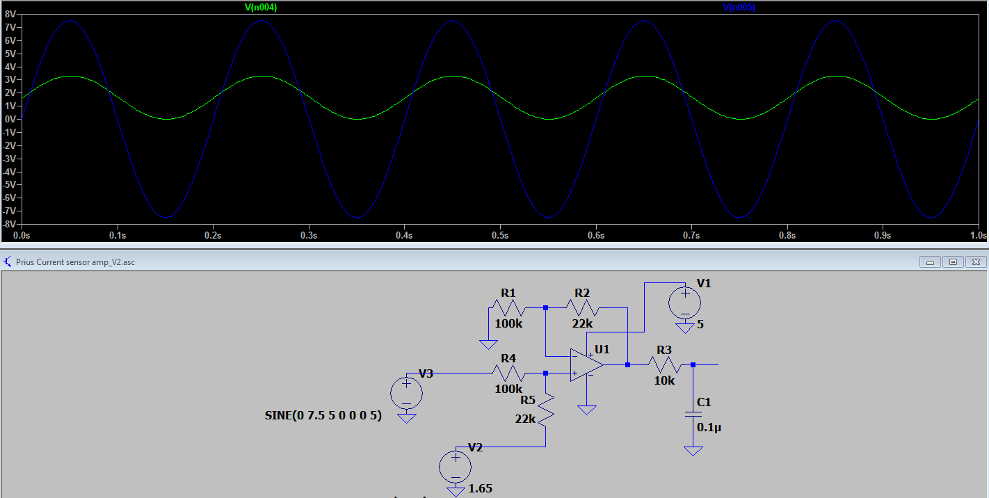

So after some thought and more reading, I'm still going to try my hand at the blue pill board with the Gen2 prius inverter and toyota MGR.
I've made the order to Digikey for the parts, have an STM32 chip and programmer on the way. I got the Wifi chip a while back. Arber333 says he has one more exciter board, so working on getting it.
Now the remaining questions on the voltage divider for the two current sensors that I've bolded below. Thanks!
Side note, I've picked up a 30v PSU and dug out an old oscilloscope that I had stuck in a closet for ever. Waiting on some new leads to see if it still works.TheSilverBuick wrote: ↑Mon Jul 20, 2020 12:04 pm Two questions on the circuit posted by kiwifiat, what is the part number for U1? And what wattages are recommended? I would think lower if fine in this application, but not certain. It is also referenced later that C1's rating needs to go from 1nF to 100nF.
