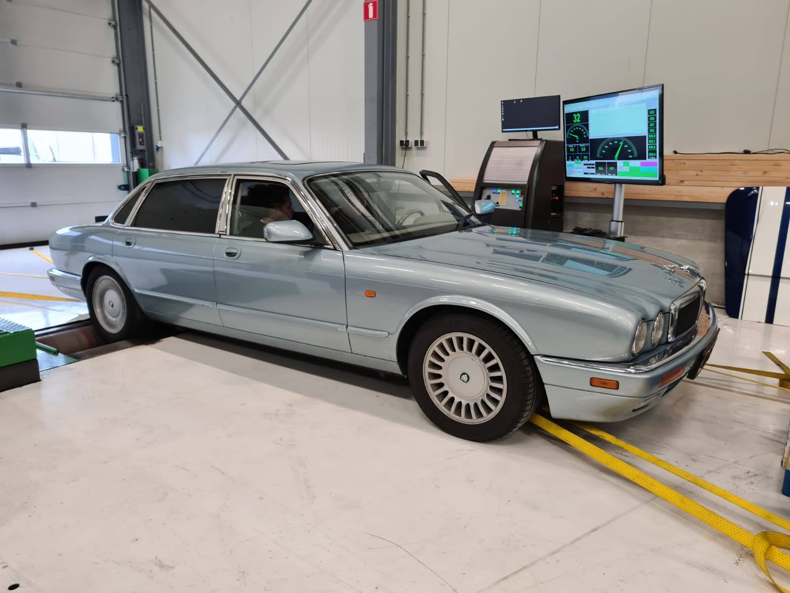

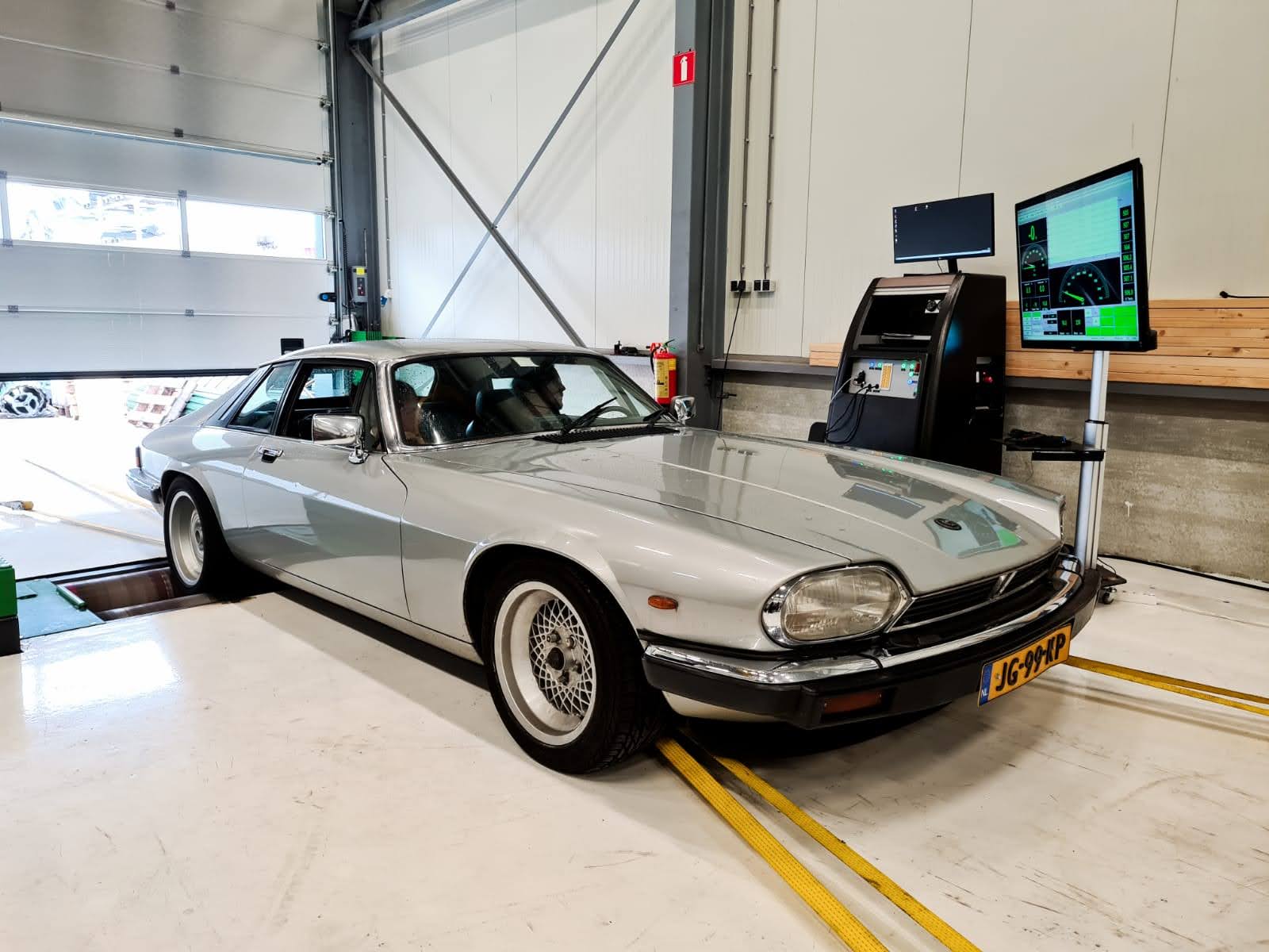

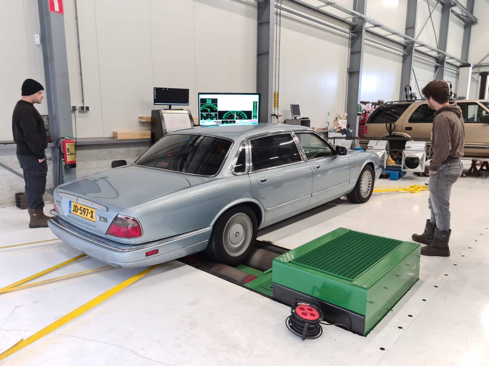

We've converted many vehicles with automatic gearboxes including Jags (see photos). We don't recommend it for DIY because you need considerable expertise and a dyno to tune the motor/gearbox for efficency.

Can you do meaningful regen on an auto gearbox? Will it stay in one fixed gear or actually shift?
- New Electric Ireland
- Posts: 172
- Joined: Sun May 31, 2020 12:22 pm
Re: Jaguar ... Why Not?
Yes
It shifts. We do a lot of work measuring ICE systems on the dyno and then use that as a model for our EV systems. Most commercial systems are automatic and this approach allows us to use multiple motors to emulate a large diesel without replacing the gearbox.
