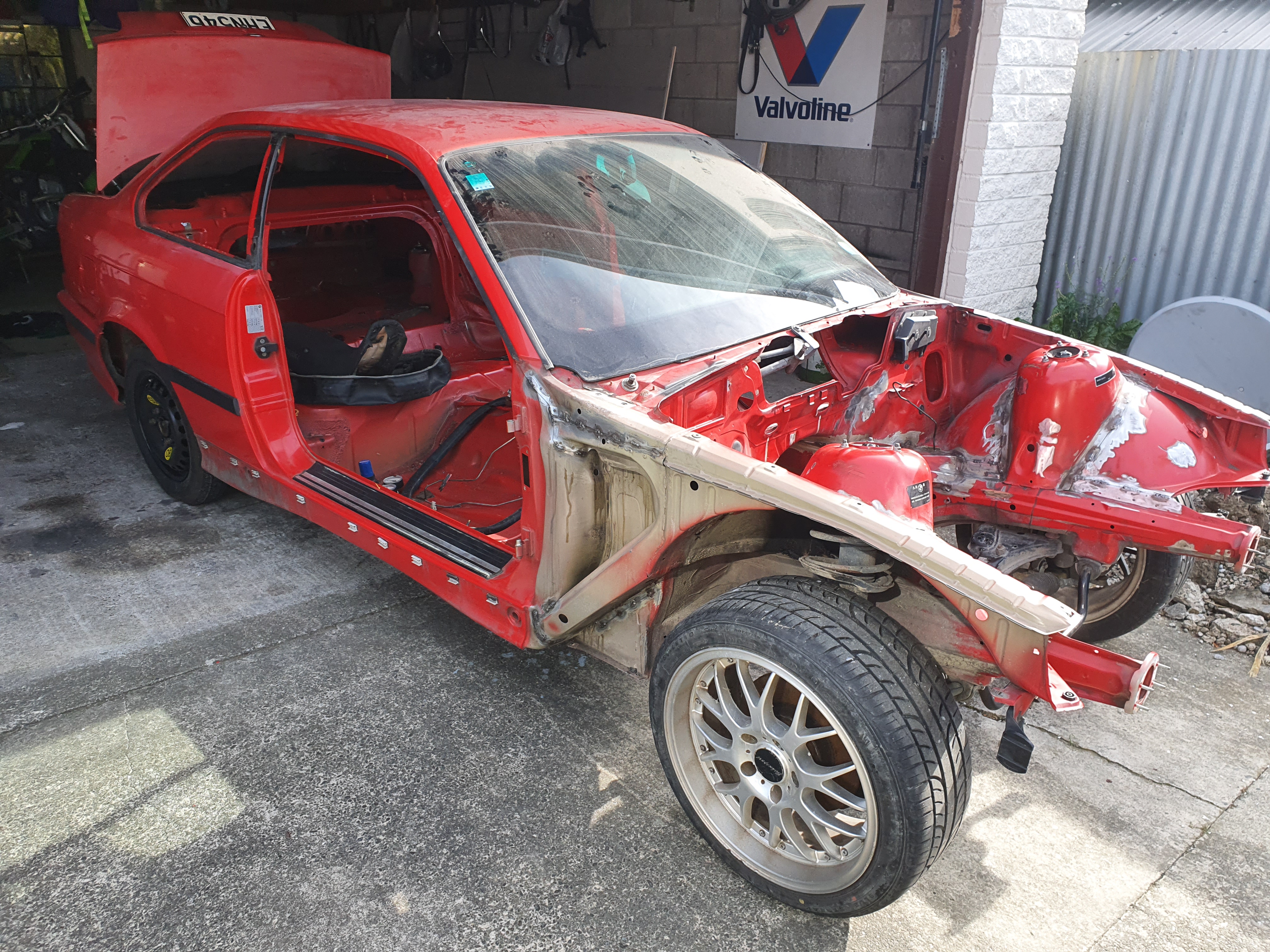

Going to be doing something a little different to a daily road car but im always up for a challenge and have a record for taking on projects others cringe at lol.
I have / started with a 1997 BMW E36 coupe as a base for my second rally car, have stripped it down now and selling the V8 petrol stuff i did have planned for it and going to go EV because i only want to do this once and i work on vehicles at a Auto Electrical shop during the day and wire up rally cars for my old work with aftermarket ECUs and custom looms so wires make more sense than a big oil leaking lazy petrol engine.
So i will be fitting a full roll cage, race brakes, suspension and a rewire with aftermarket PDM setup fitted into it also.
I had planned to run a tesla LDU in the back similar to the evwest setup but would need to be mounted slightly higher up so easier to protect from gravel, loose stuff that may hit the gaurd around it. Should be OK with cooling as rally cars not as stressed as track stuff like the cobra has been, less grip etc. Also 320 HP would be heaps so wouldnt be working as hard and have head it is possible to seperate motor and invertor cooling loops with a internal modification.
Have also considered a tesla SDU as its a lot lighter 50 kg ish, smaller so easier to mount and protect. Not sure about HP output, no room for more HP in future if i get bored of it or go to a track day.
The other options being pointed out are lexus, would still need a diff, driveshaft and big mounting brackets to handle the driving. Heavier final setup than LDU and may need gearbox tunnel remodeling also?
Nissan leaf, would still need gearbox, driveshaft, diff which would reduce battery mounting space in engine bay area and be heavy in final package? Also not sure about pushing one for a time at high HP output?
So thats about where im at so far. Feel free to add any info ive missed out or options that are out there. Almost anything would have to imported from overseas so not a good cheap option here other than a leaf but still quite high priced due to limited supply here.

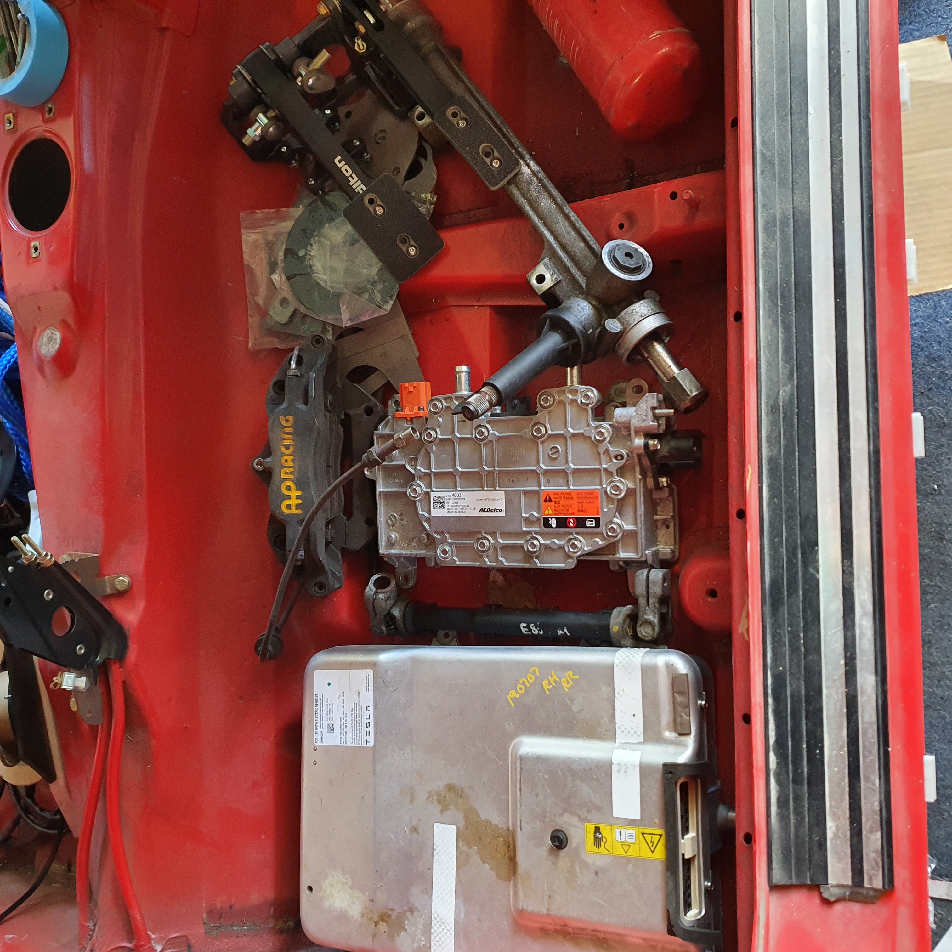

Been a while but have been doing lots of research and reading through posts all the time. Am getting closer to finally starting more on this project, so to date I have brought and had delivered
Gen 2 Tesla charger with EVBMW board fitted
Chevy DCDC charger
Kilovac EV200 contractors with econimizers built in
New set of brakes for the front
BMW Z4 manual rack
Tilton pedal box
Strengthening plates for weak parts of the car
IVT-S current sensor

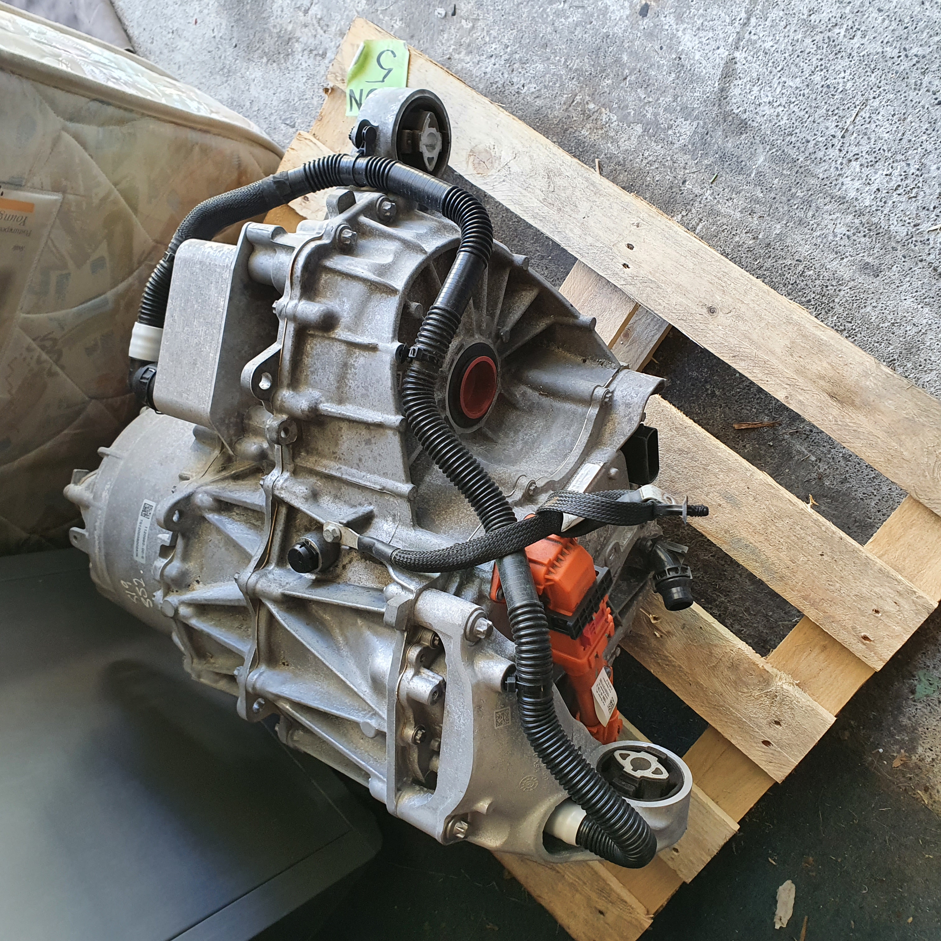

And lastly a Tesla M3 rear drive unit
Have also ordered most of the connectors and terminals to suit the chargers, bit still on back order so just waiting there. Still to order and sort out the PDM so the cat can be rewired to get rid of all the original heavy BMW wiring.
If anyone could help out I am still looking for rear CV joints or whole axles to suit the M3 drive unit and also plug part numbers for the drive unit so I can order those and get them on the way as well.
Will hopefully be putting more time into this once I get some axles so I can mount the motor in the back end and remount the rear suspension at the same time.

Re: Another BMW E36
I don’t suggest you need to be cutting big holes in the car. Use the drive shaft and mount the Tesla motor side ways
- Posts: 656
Re: Another BMW E36
This can work but it comes with tradeoffs. First, you gain the weight of the whole diff.
Second, your gear ratios become extremely messed up.
Do you hook the Tesla diff output to the BMW diff? That won't break 60mph and you'll need to lock the diff.
Do you hook the Tesla motor output to BMW diff? You'll have 1/3 the torque and need a custom case for the motor.

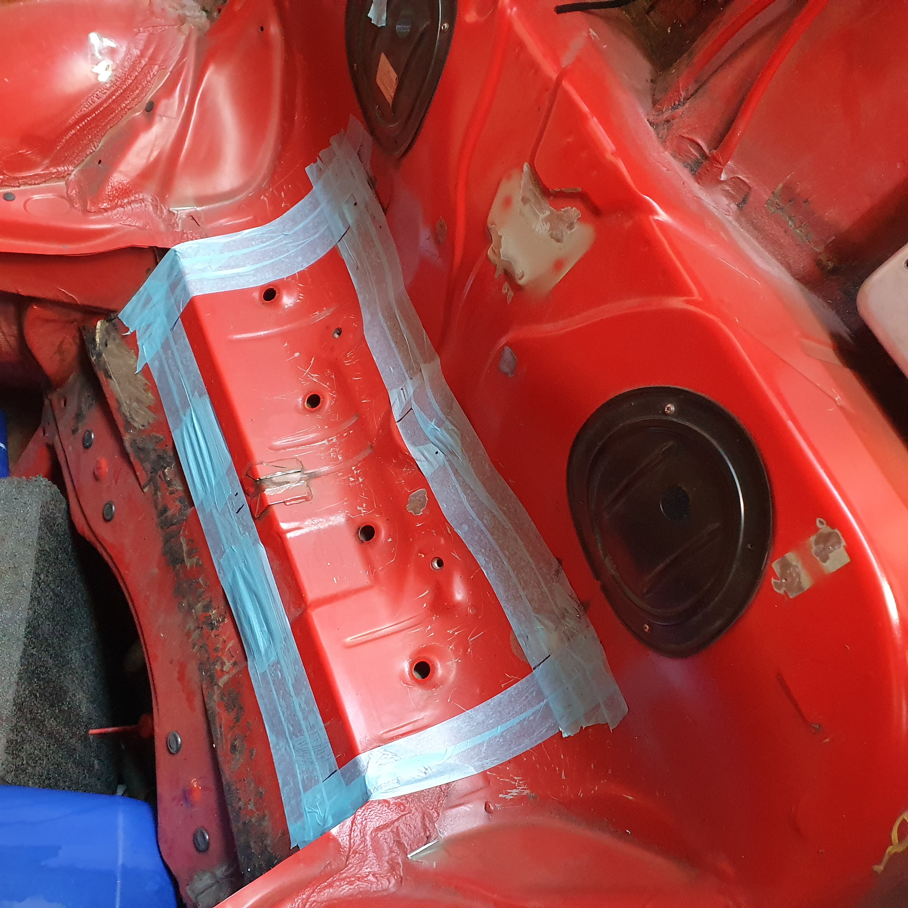

Re: Another BMW E36
Well hopefully in the next few months I'll have some more photos to share, I have the tesla axles and the rear motor loom so just need time to get it into the workshop to get rid of some of the rear floor and subframe to mount the engine.
Because it's being used for motorsport mainly I thought it made a lot more sense to remove all the weight that's not required and tie the roll cage into the new motor mounting points. Also by the time the motors in the back the rear of the car should be about original weight.
