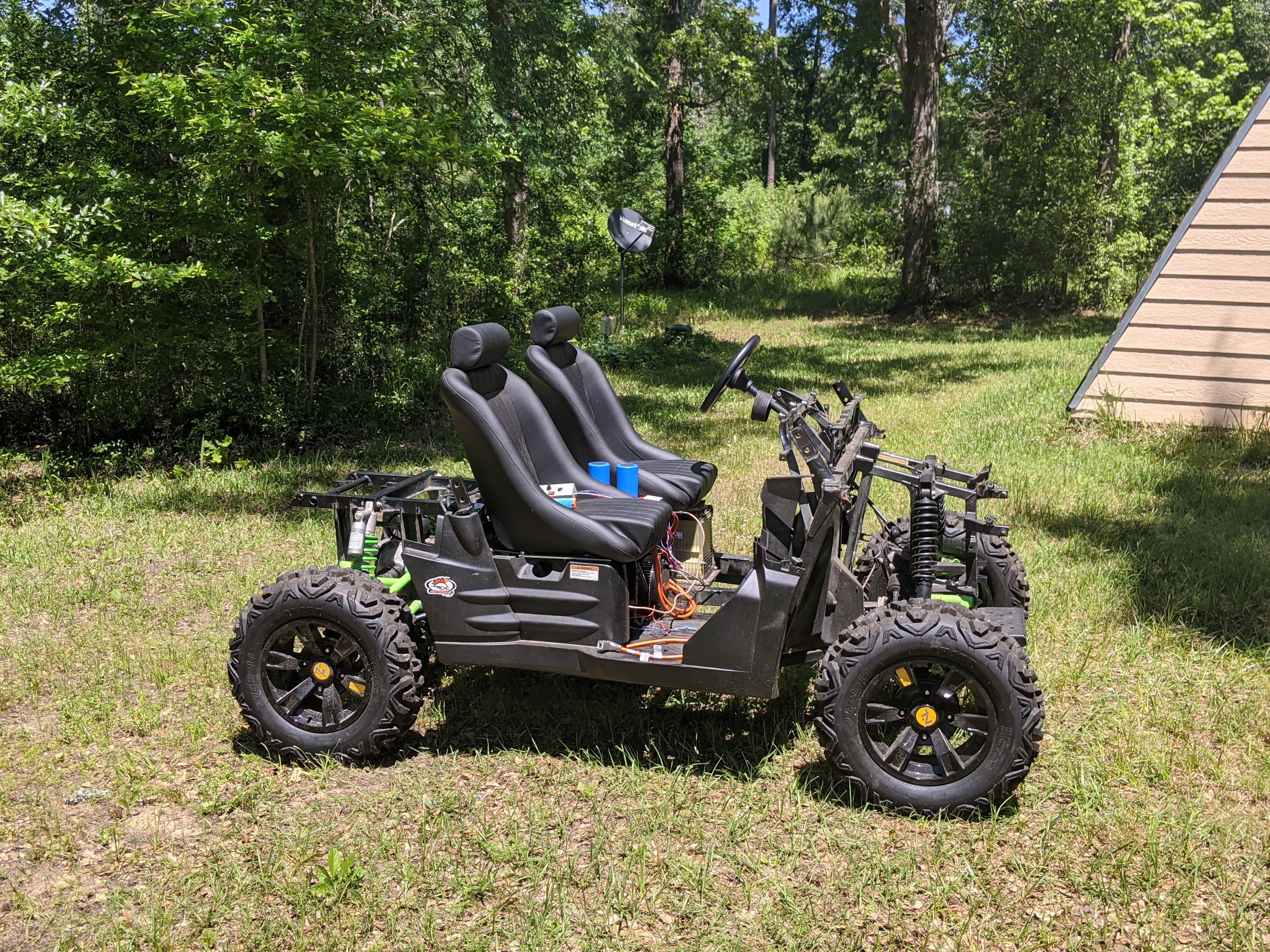

I wanted to post my progress converting a Kawasaki Teryx 750 to all electric. Still have some work to do but I have the wheels spinning and Rev2 tuned....some what :) Driving the rear wheels but hope to in the near future add a front motor and have 4 wheels spinning.
My set up
Batteries- LG Chevy Volt cells/ 200 volts
Powerstage-PM600DSA IGBT...working on the liquid cooling
Motor- Azure Dynamics AC24LS
Charger- Brusa NLG 513
Good luck to all!

That's so cool! How's this coming along? I have an AC24LS myself. It's exciting you have the wheels moving!

Thanks man! Sorry bout the late response. The build went well.I got busy with other projects, but when I had it dialed in I raced it around! You got plans for your AC24? Thanks for your interest take care.
