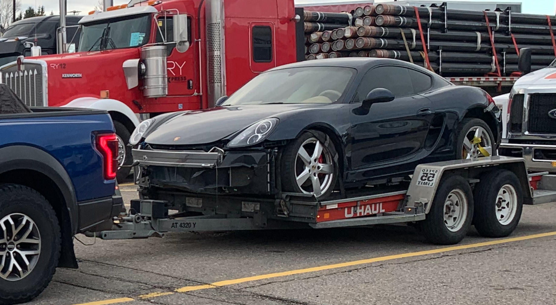

A few weeks back I purchased a 981 Cayman with slight accident damage. Less engine/trans
Overall the body appears straight, no major issues in getting it back operational.

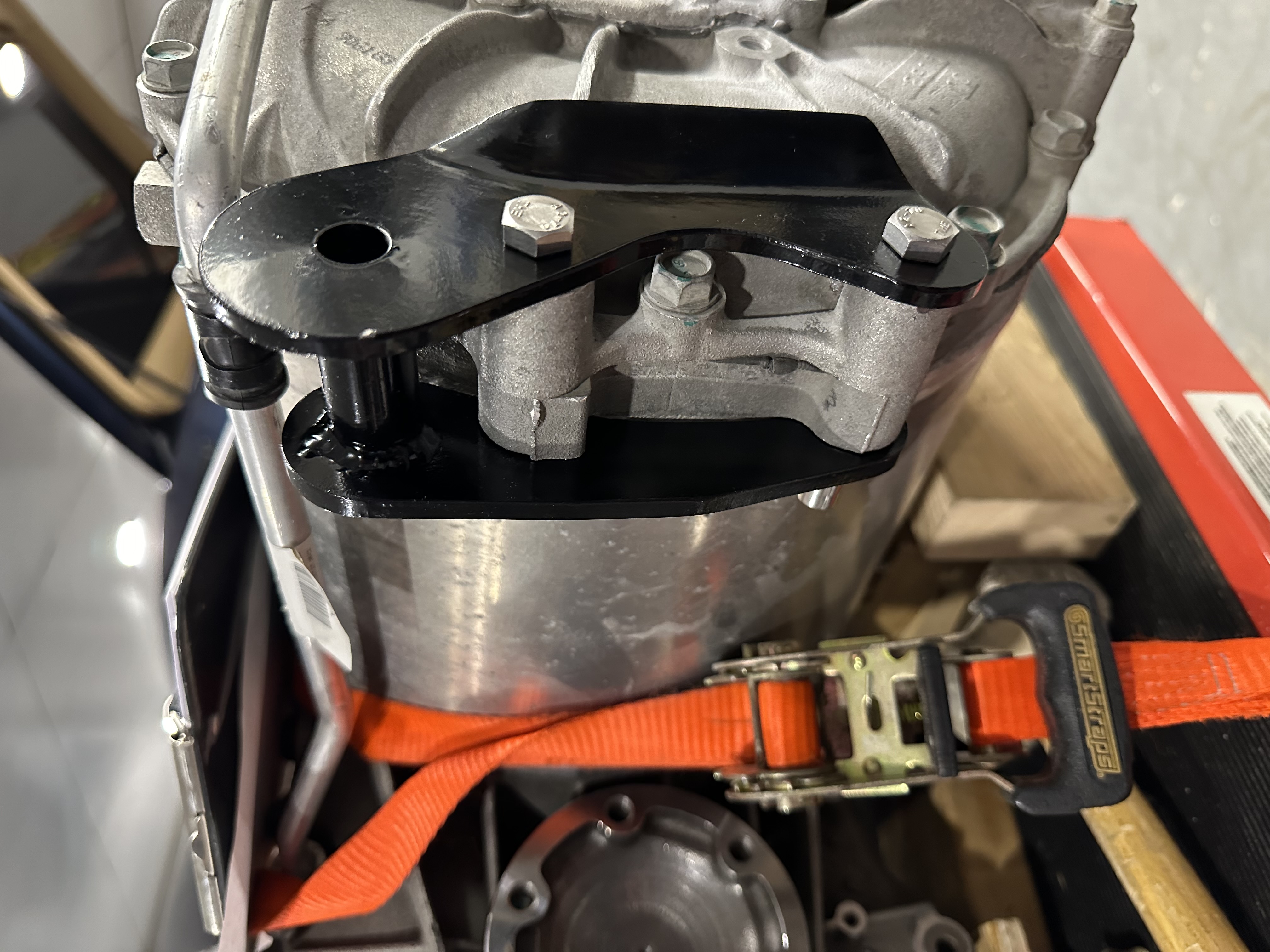

  • Tesla 'Sport' LDU

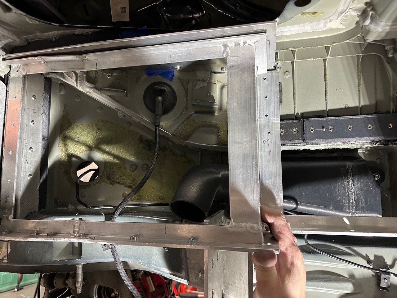

Future hopes may be to use a Front Drive Unit and convert to AWD pending battery space and discharge current.
Those that know the 981/991 chassis will know that with the Gas Tank removed, the front space is a rather large void. So Base plan is battery storage if needed. The 981 can use the front subframe and hubs from the 991 4S/Turbo 🙂

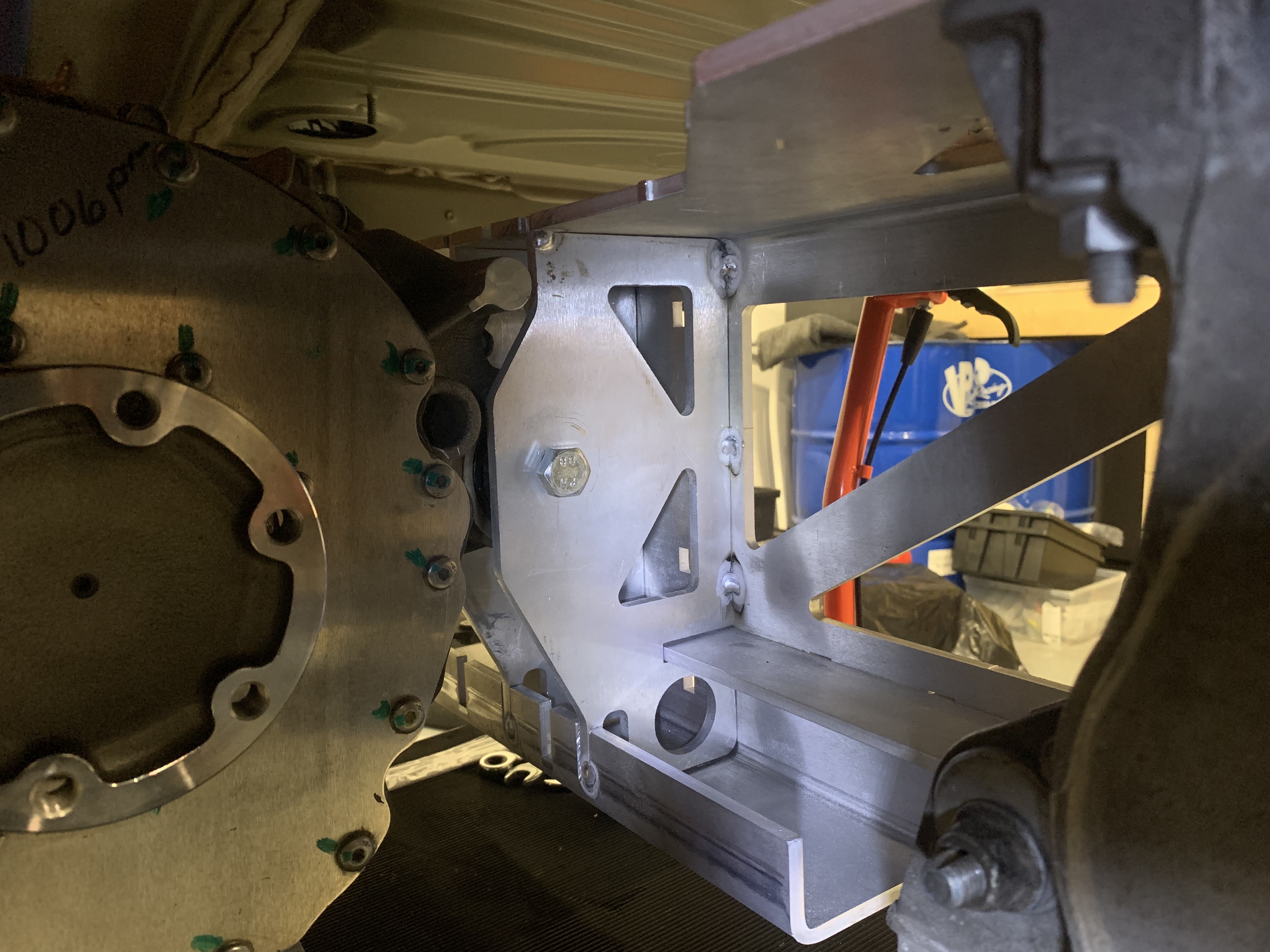

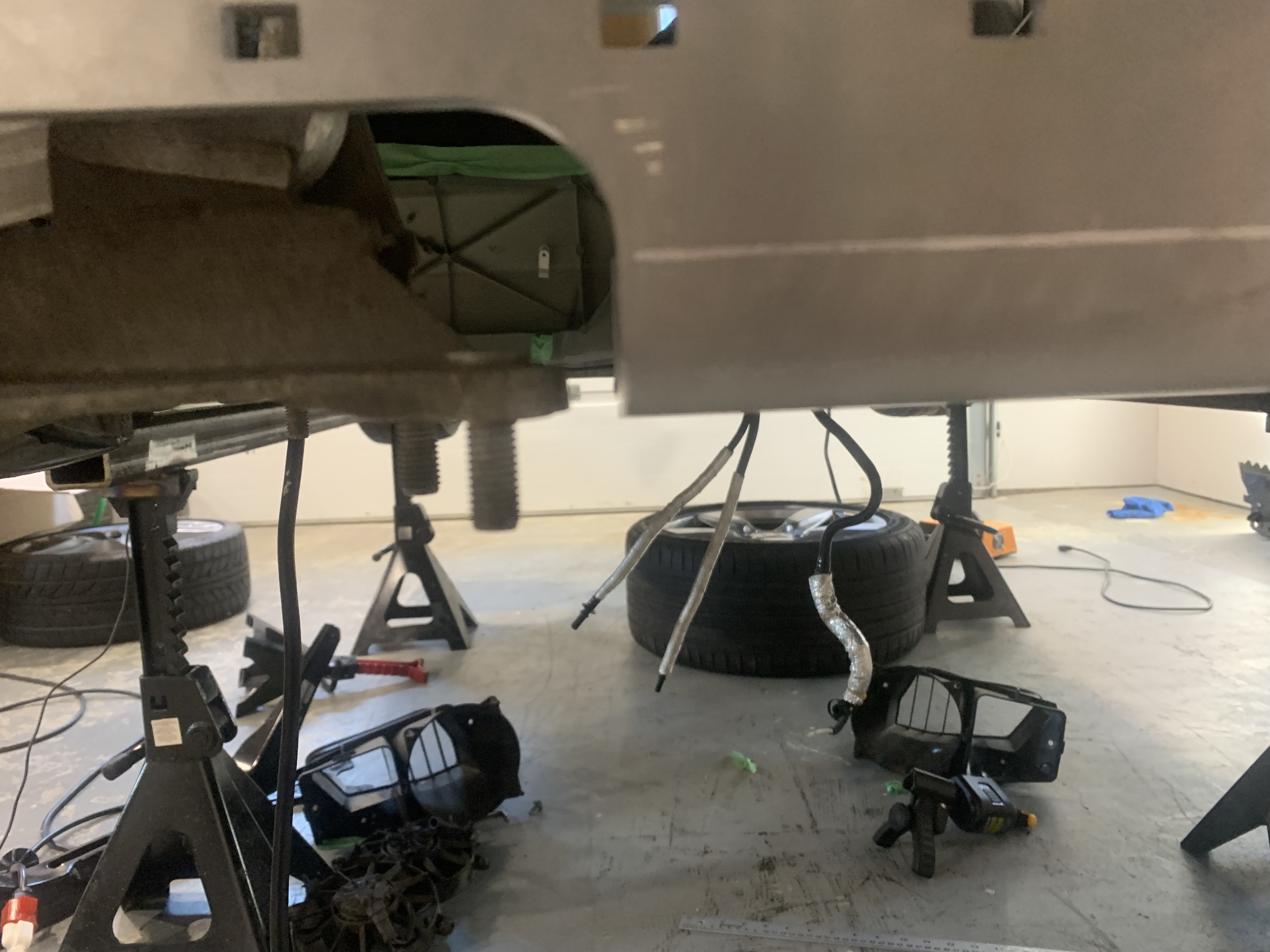

Just a quick status update, as I've been lacking for the last few months.
I've been working on my garage and getting the space ready for the conversion.

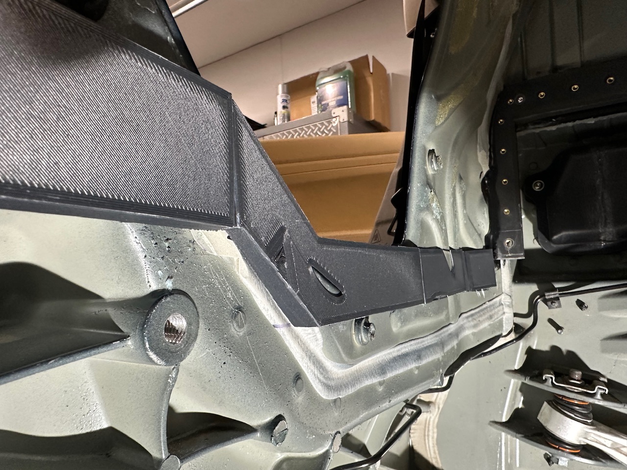

The car does have some front accident damage that will need to be fixed, so once that is taken care of I'm hoping to jump into the conversion.

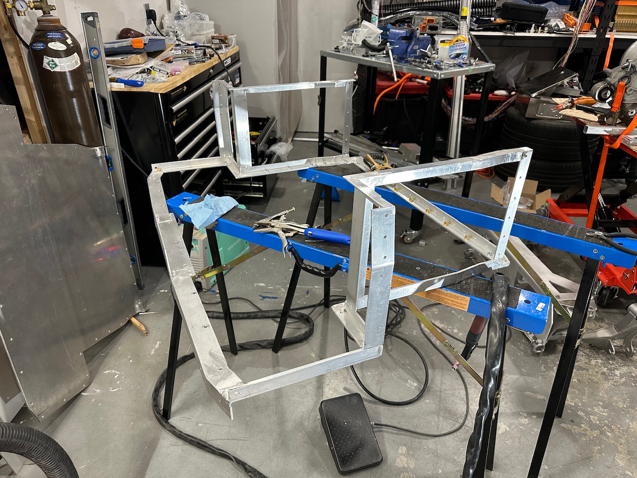

Thus far I've purged everything of the ICE ancillaries, Been sizing up for battery packs, ect.

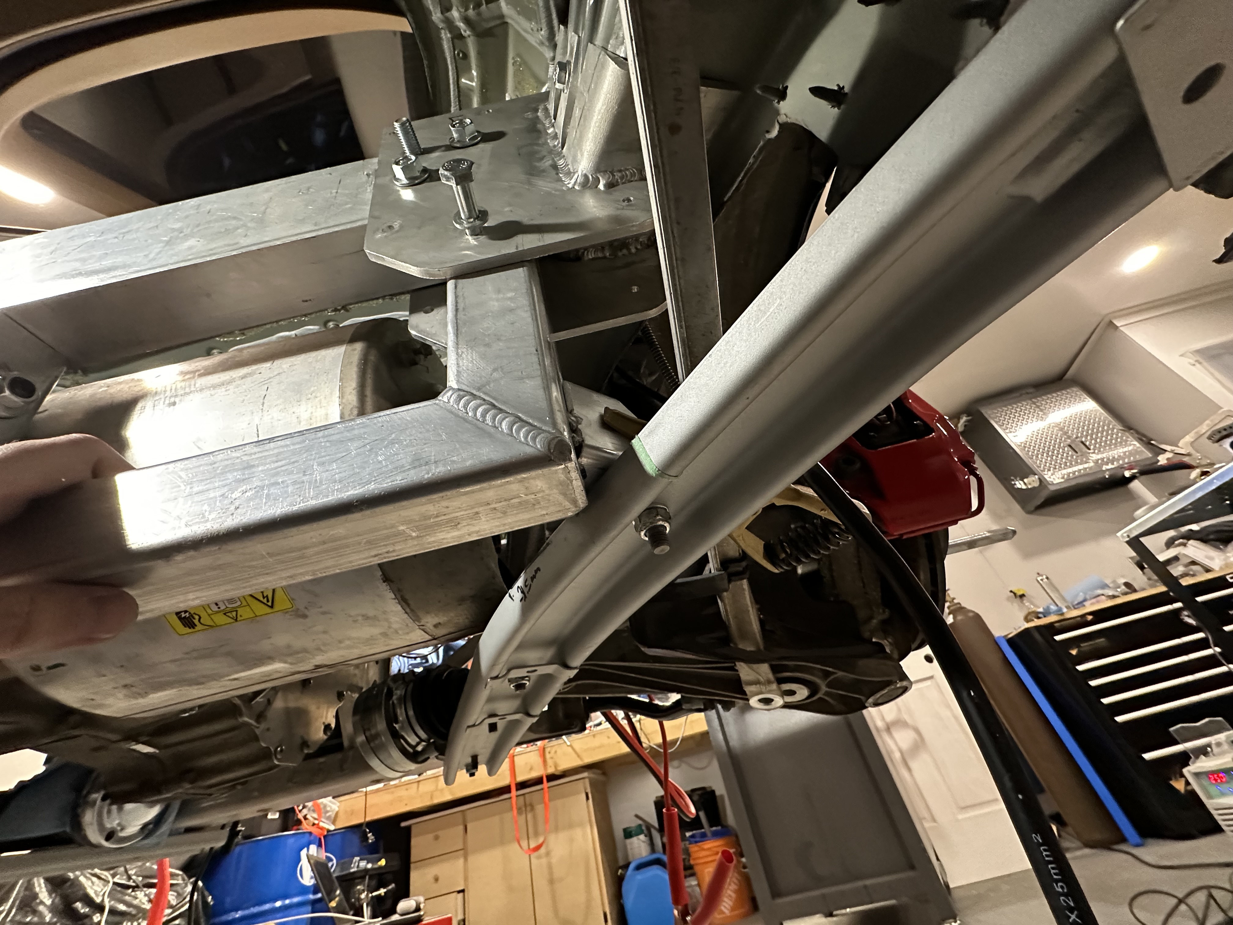

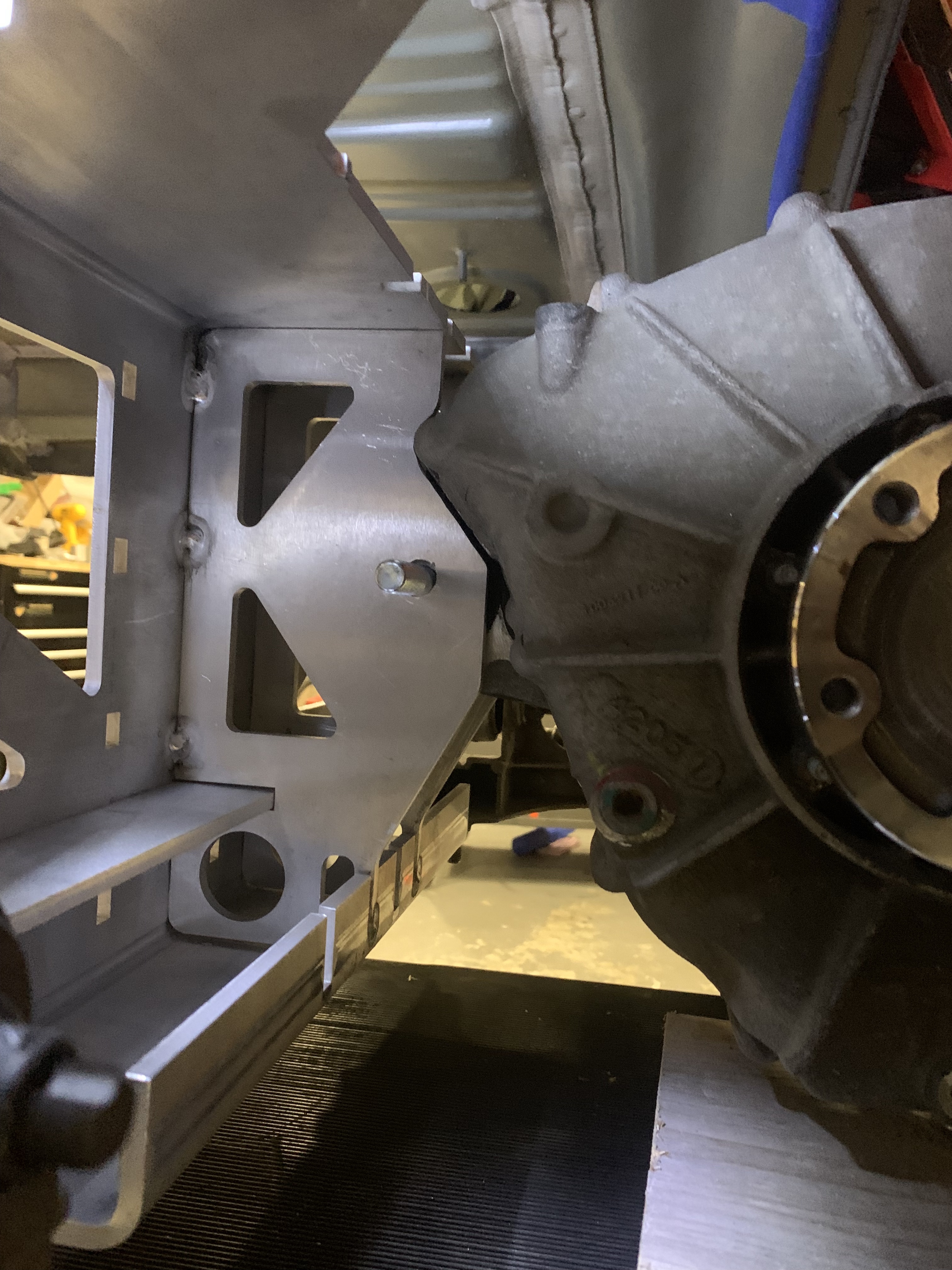

The plan so far is to mimic the Tesla LDU installation much like the setup BoxsterEV has (981 subframe is different than the 986)
I may try to source a ID3/4 VDU590 sized battery, My mockups seem to allow me to place the full 82kw battery in a 96s3p config.
with the LG e78 cells.
Hoping they can offer up a short term C-Rate of 5-8C to get me to my power goals.
Will attach some pictures shortly of the De-ICEd chassis.

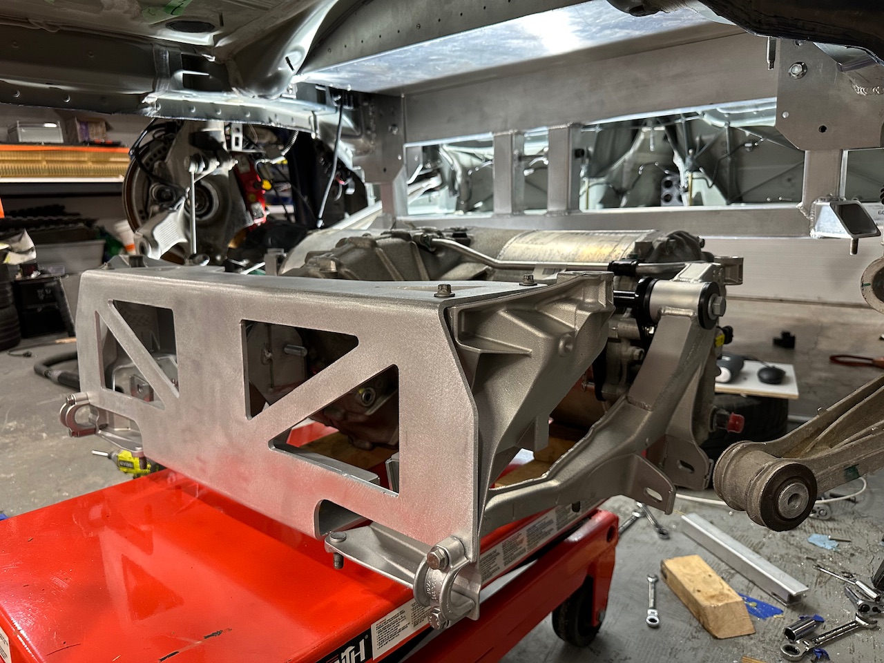

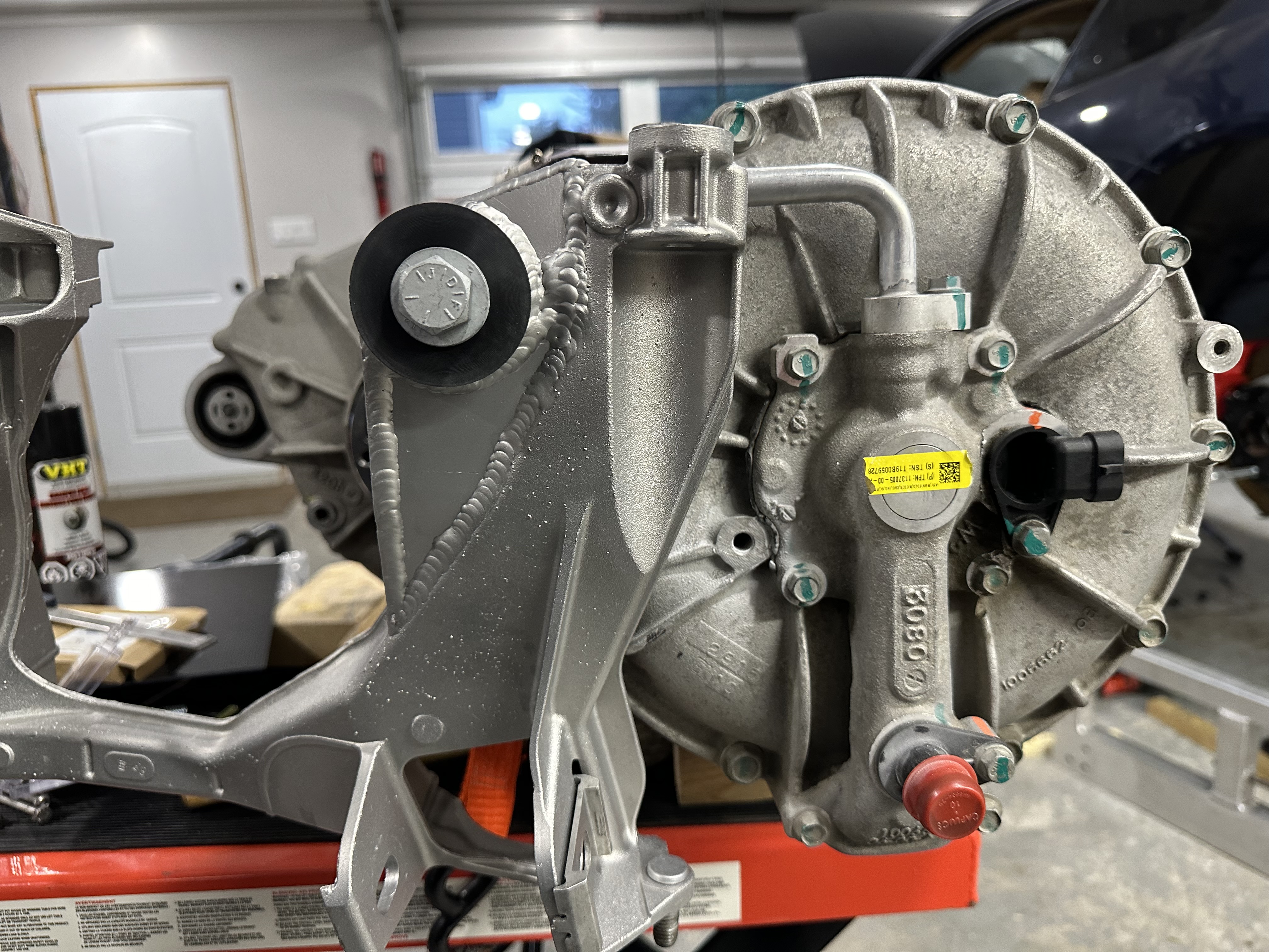

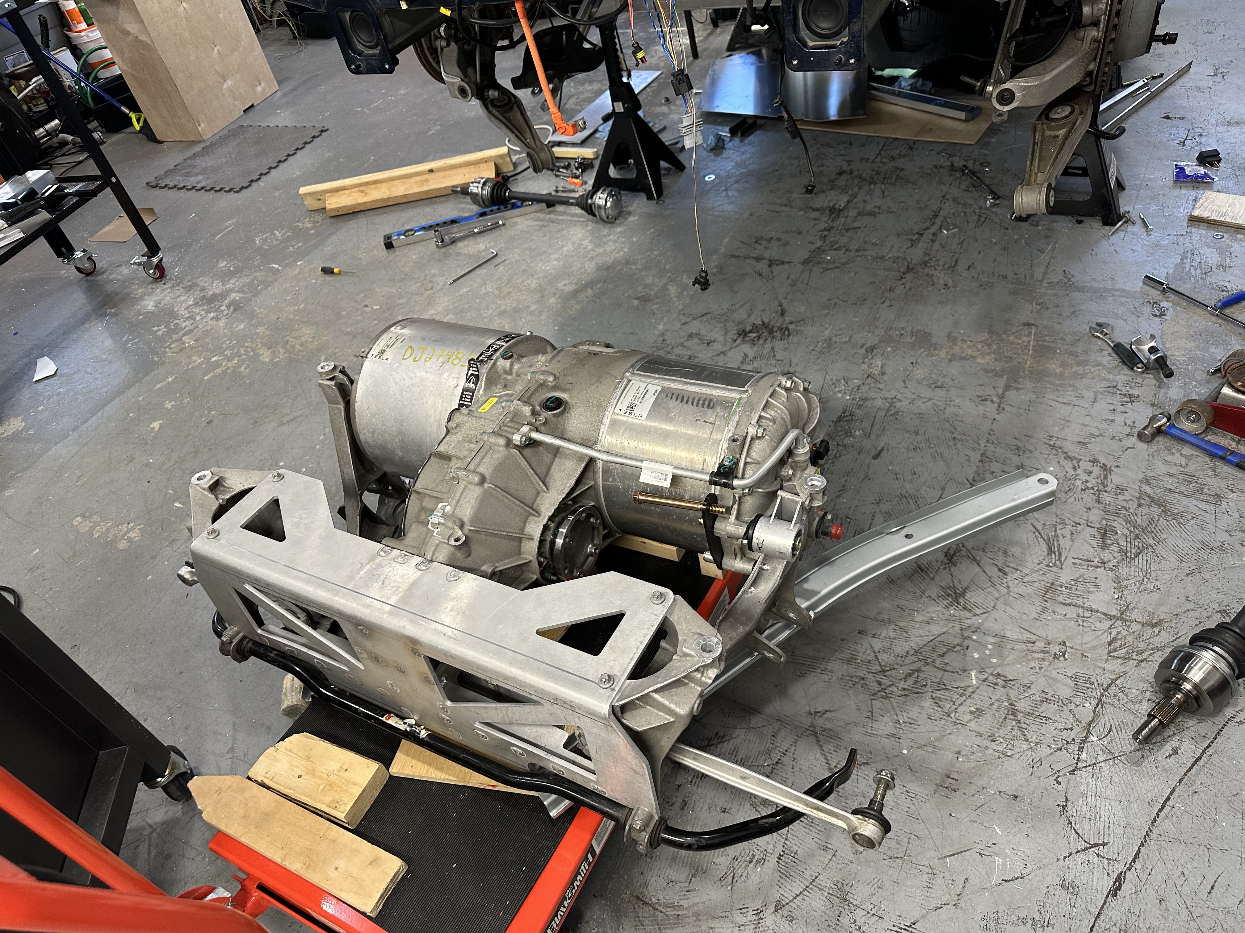

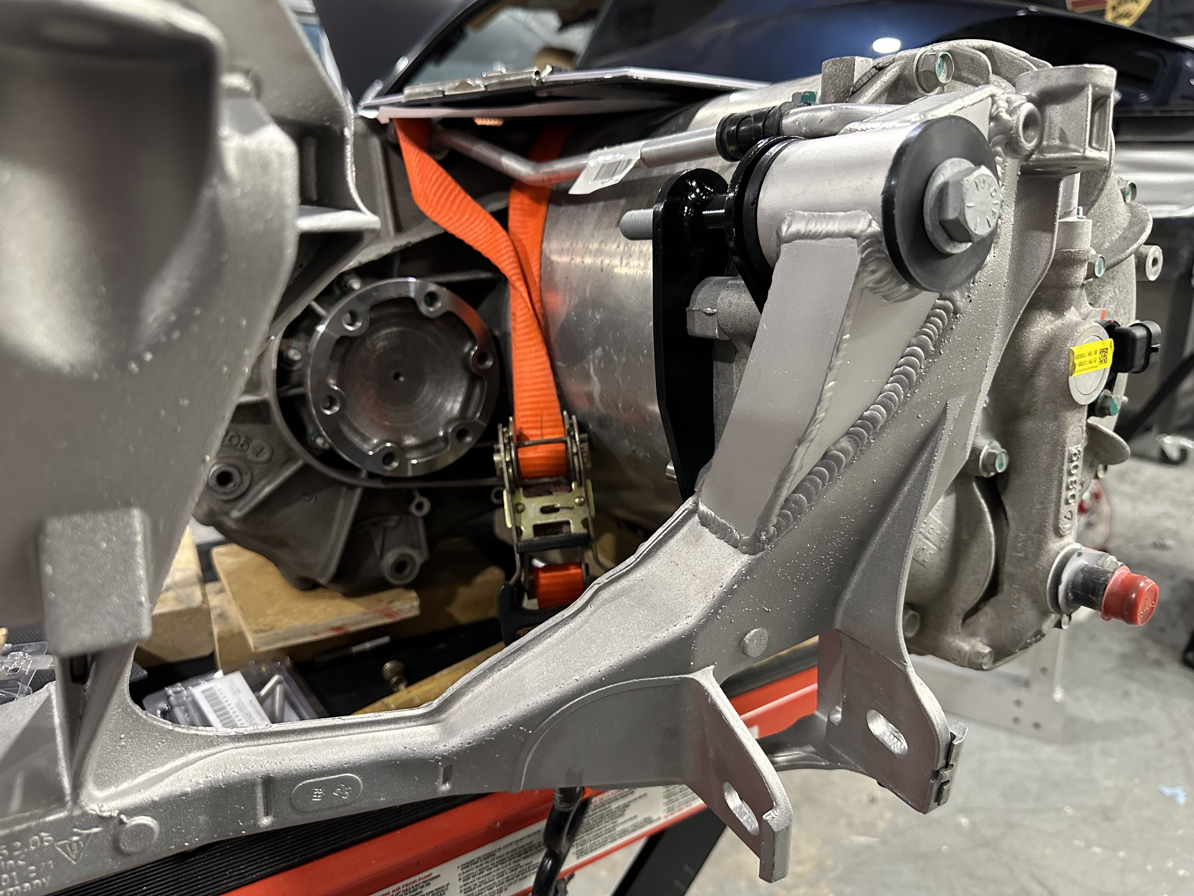

Just received the Sport LDU, so I'll be hoping to mock it up in the coming weeks.

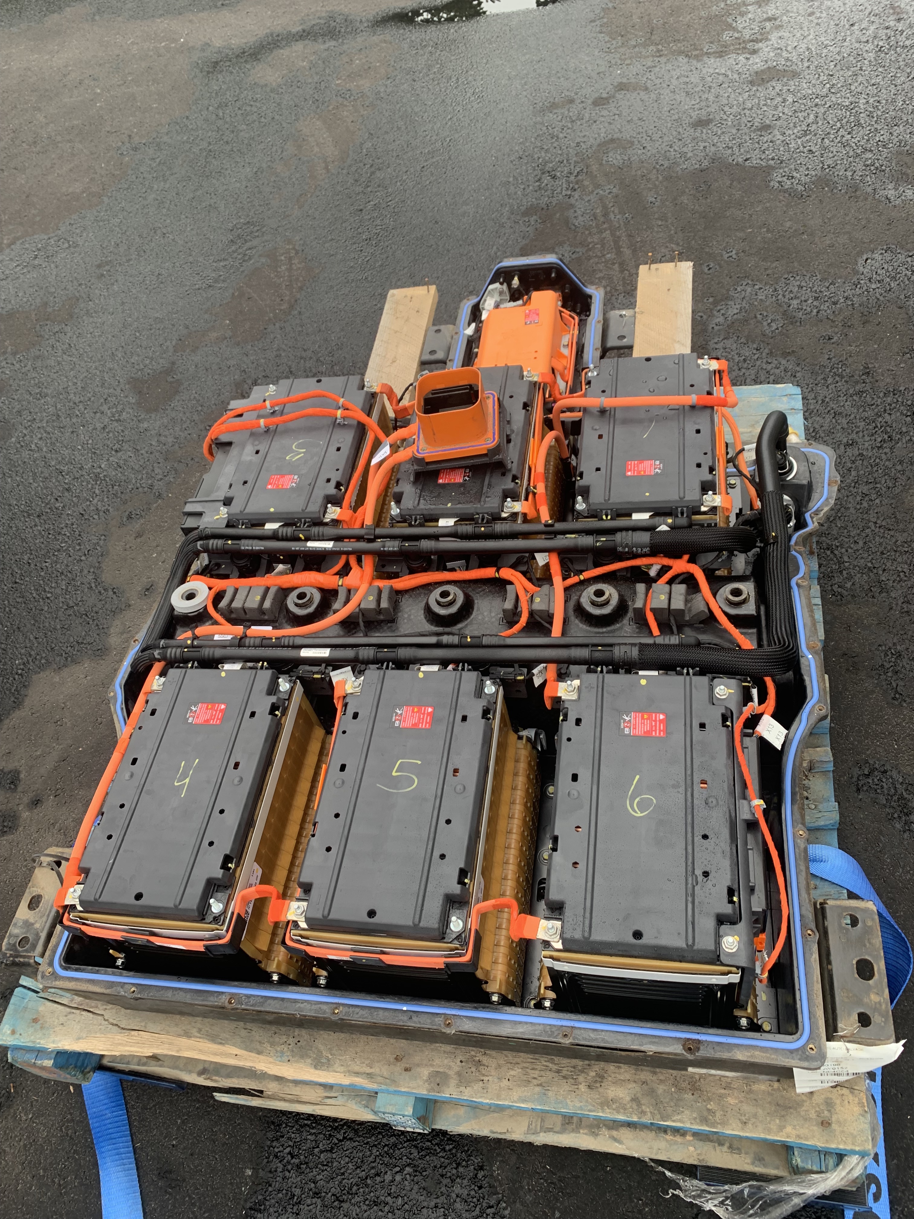

I settled and went the Volt Gen 2 battery route. Right now I've sourced two packs, with a potential to see if I can fit a 3rd, but I suspect that's very optimistic.
Was very mixed on the battery choice. The use case is general city/fun, so range is secondary; newer cell chemistries seem aimed at energy vs power. Felt that the Volt batteries was the easy way out... The biggest reason is I could source them within a few nearby provinces for ~$2000 each, so my investment is minimal to get things running.
There is room in the front tank area for a Front Drive Unit; it'll just need to be clocked 15* farther upright.

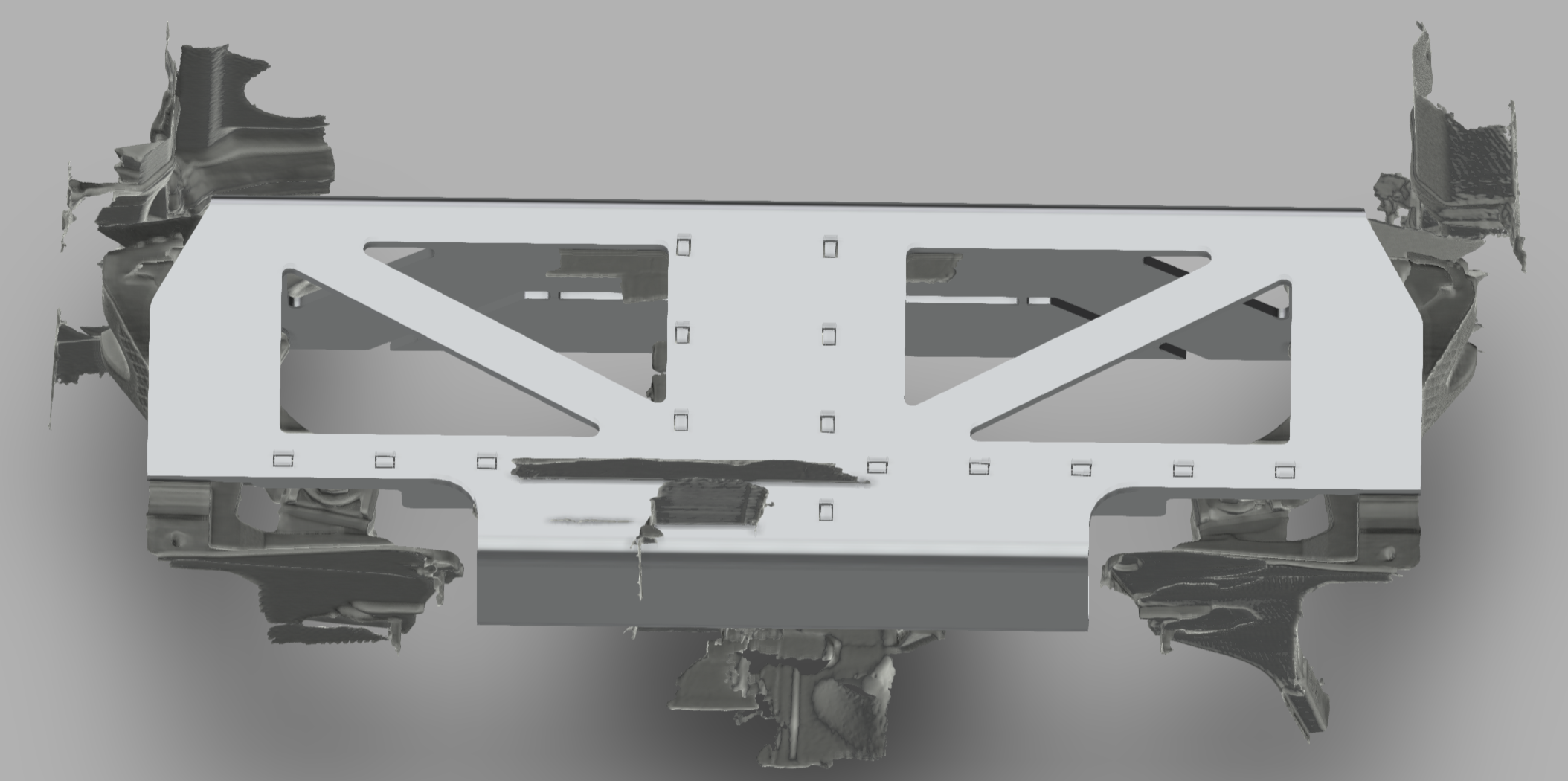

I'm planning to post any of the CAD files I ultimately use, so it should be pretty much the same for the 718.

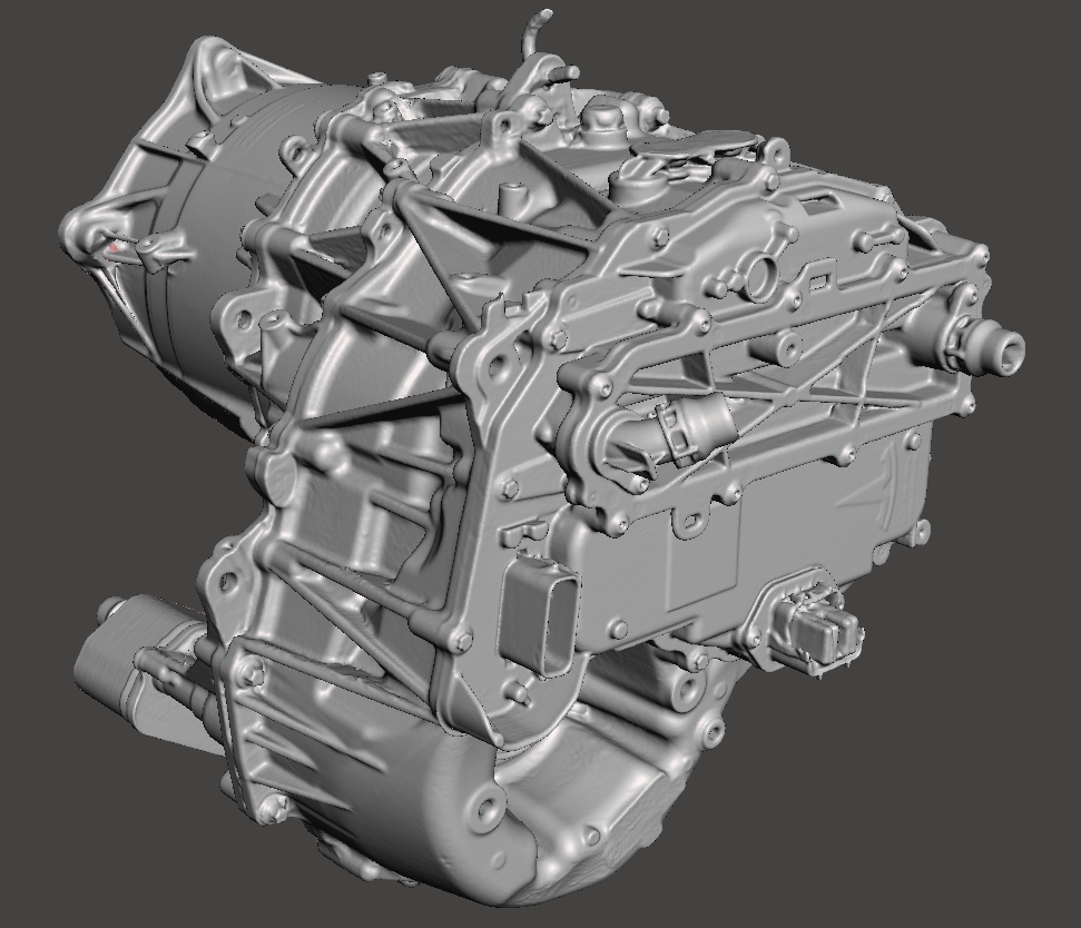

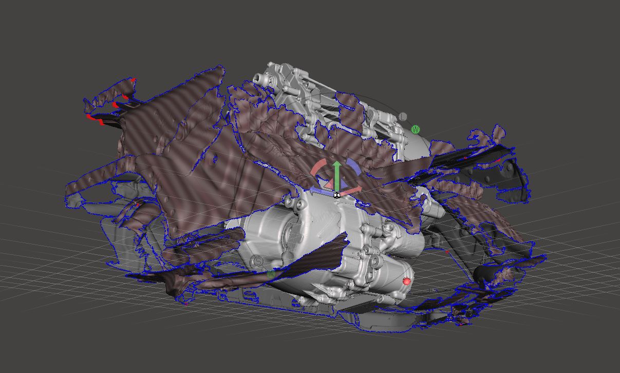

I've also ordered a CR-Lizard 3d scanner... So pending how well it works, I'll post my scans. So far I've just been using a photogrammetry scan I did, came out surprisingly well, +/- 1mm in most of my spot check dimensions;

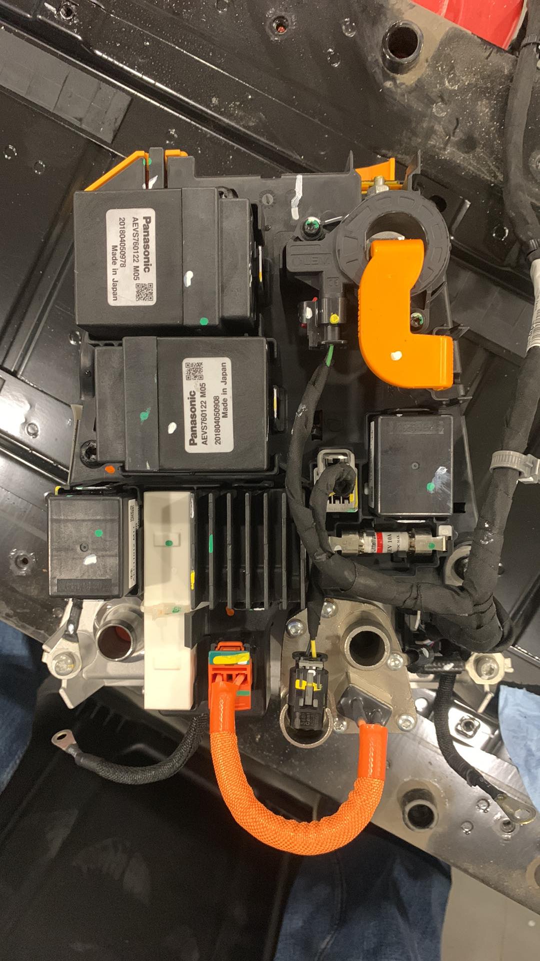

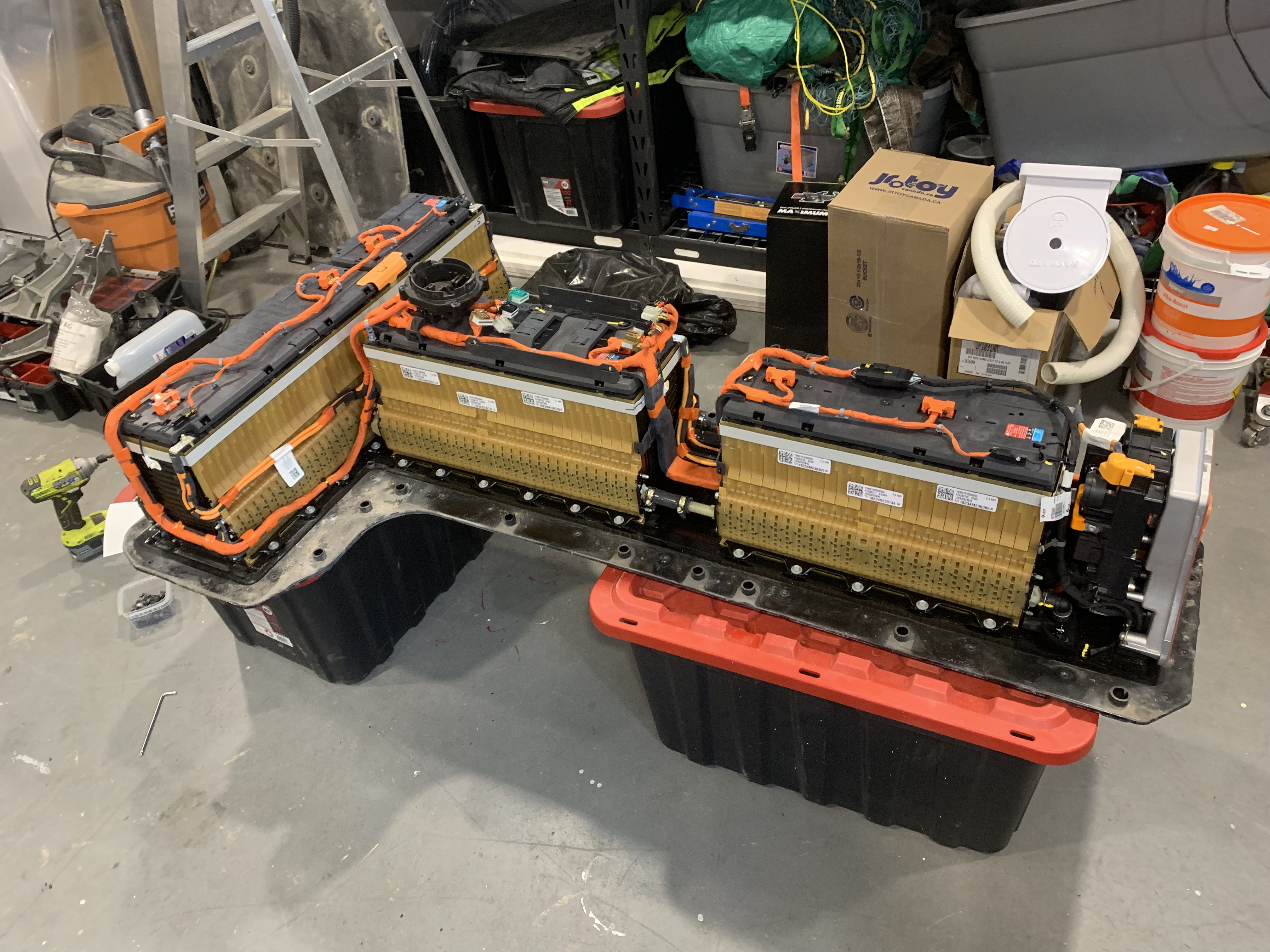

Project Update 1:

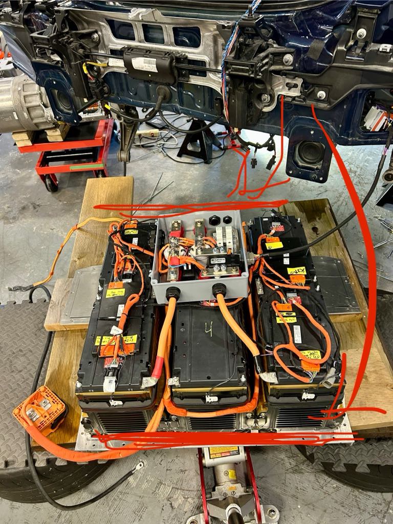

  • Batteries: Chevy Volt Gen 2 & Chevy Spark Modules - 2x 18.4 kWh = ~36.8 kWh

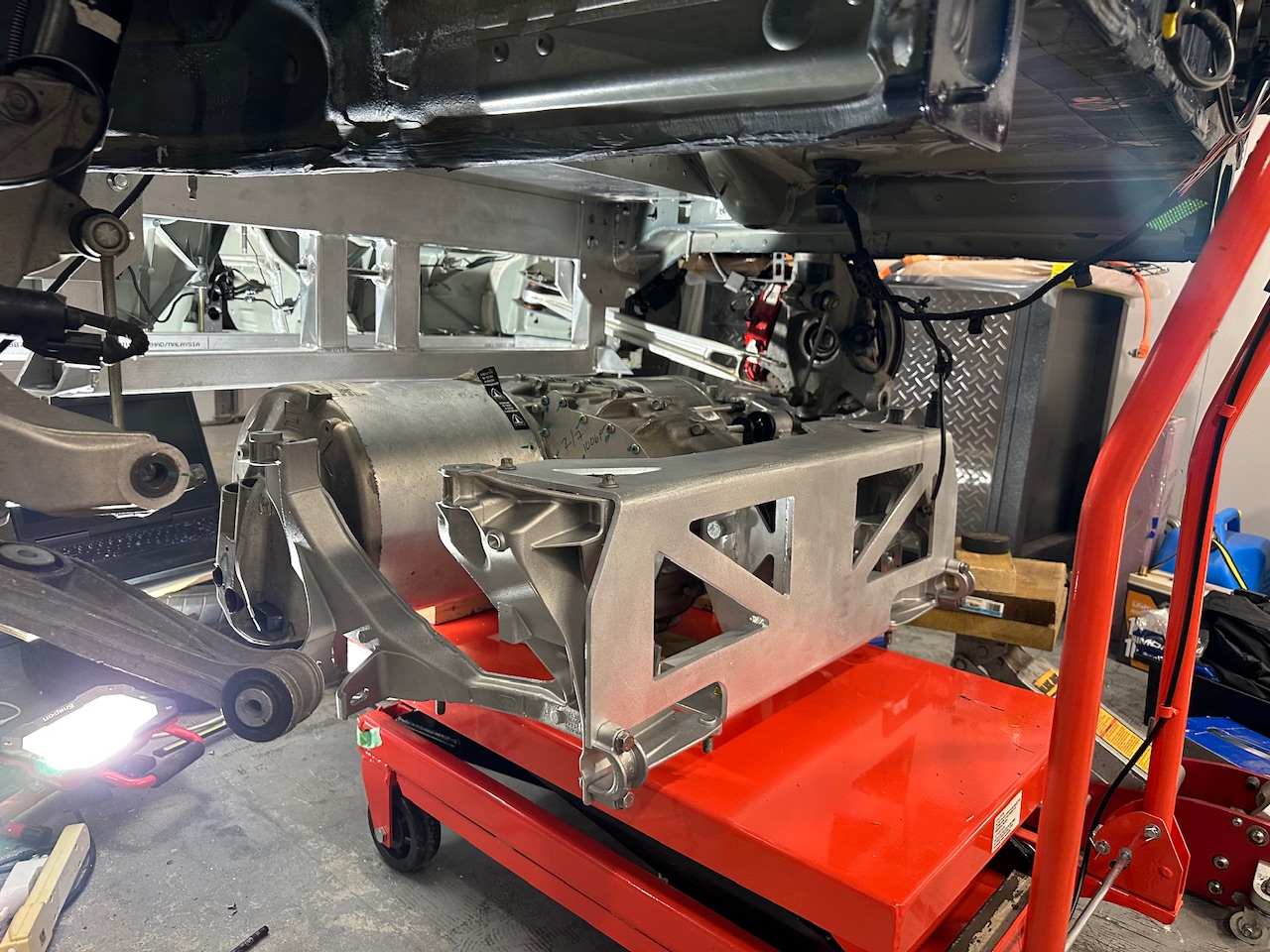

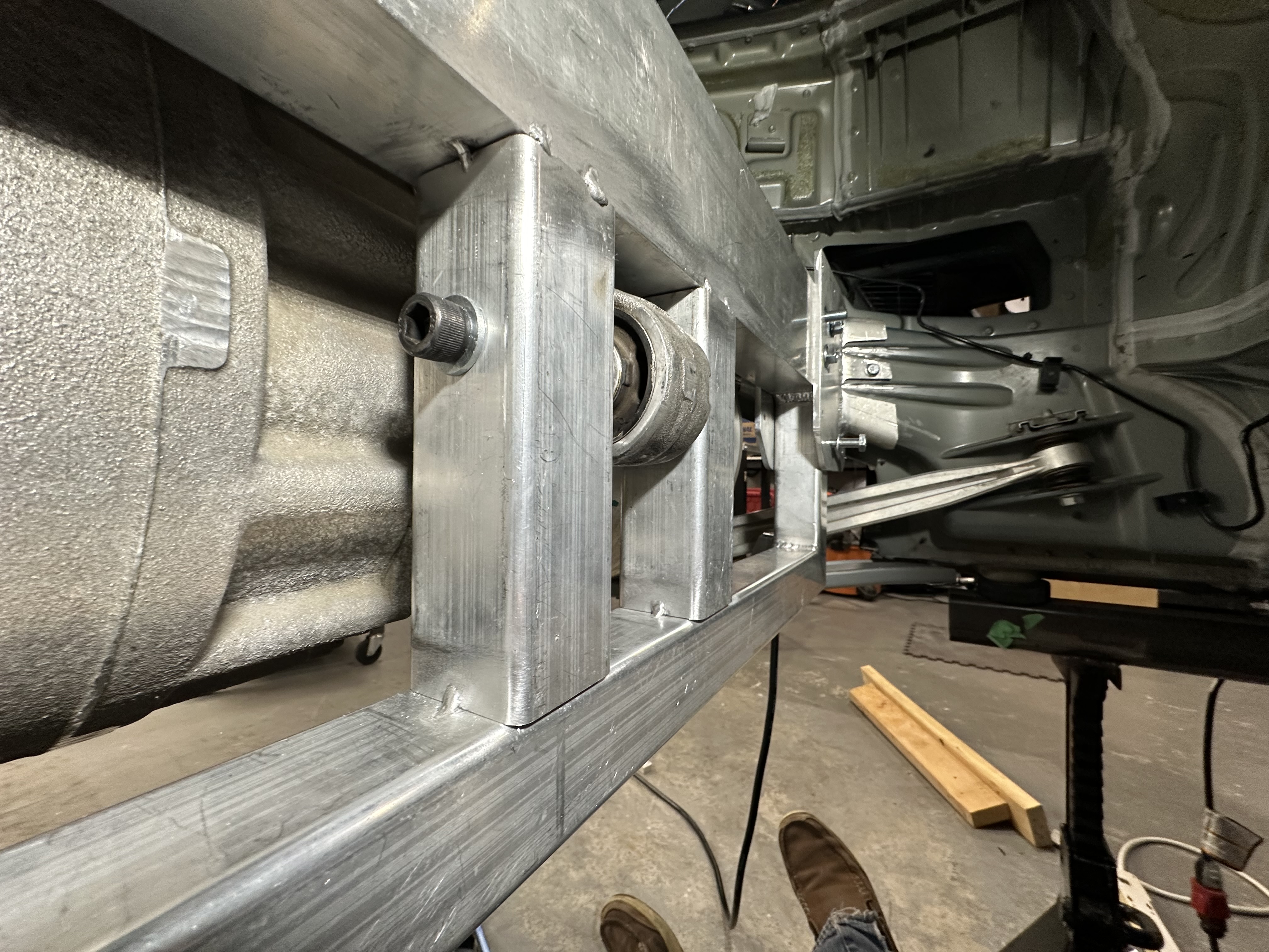

  • LDU Sport Drive has arrived!
  • OpenInverter Board in hand (Not yet assembed)

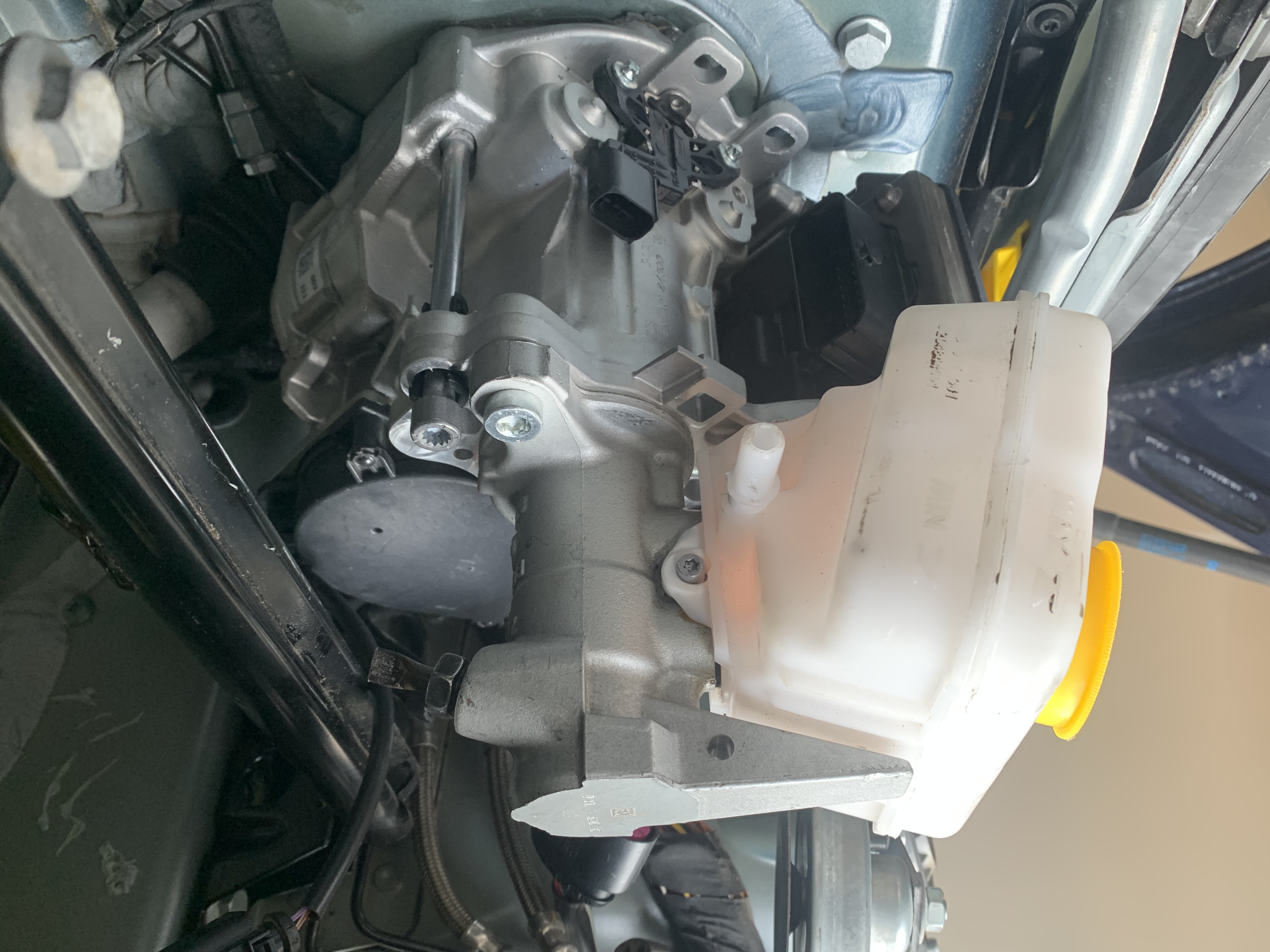

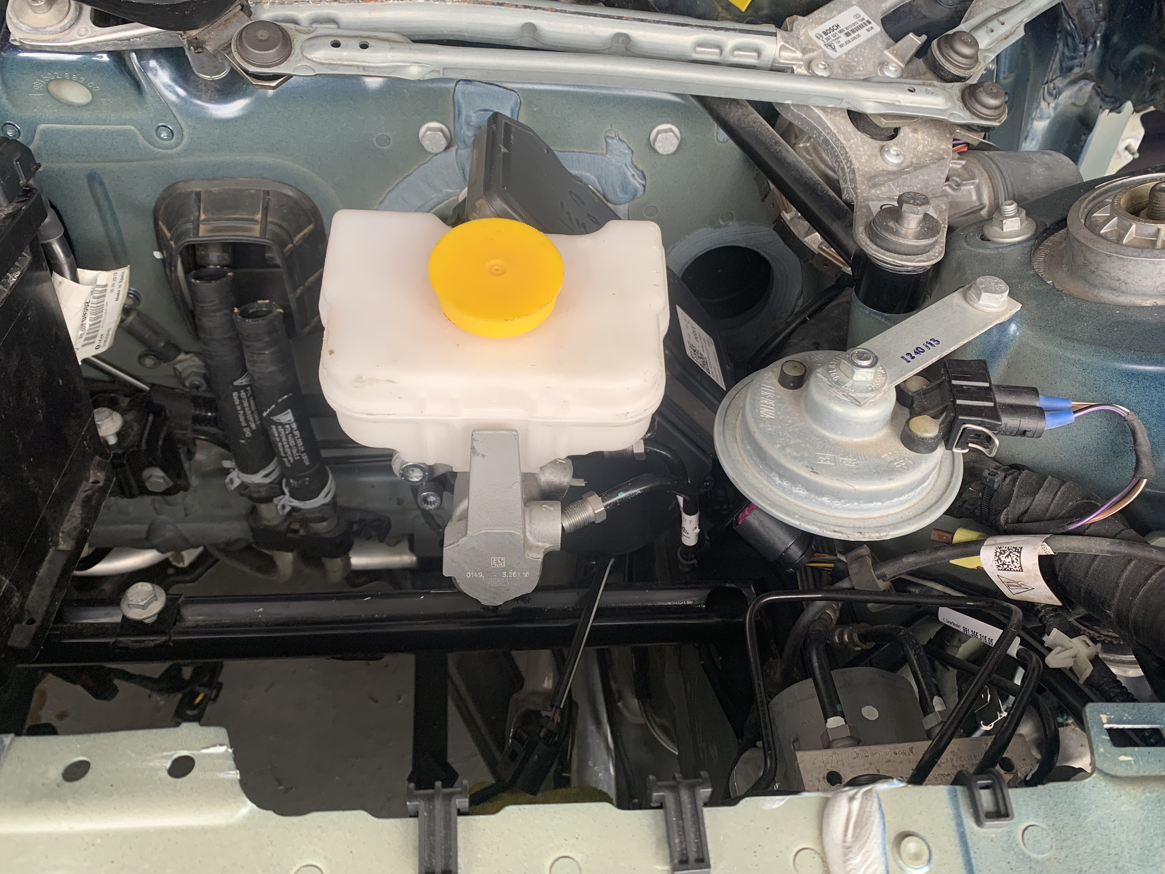

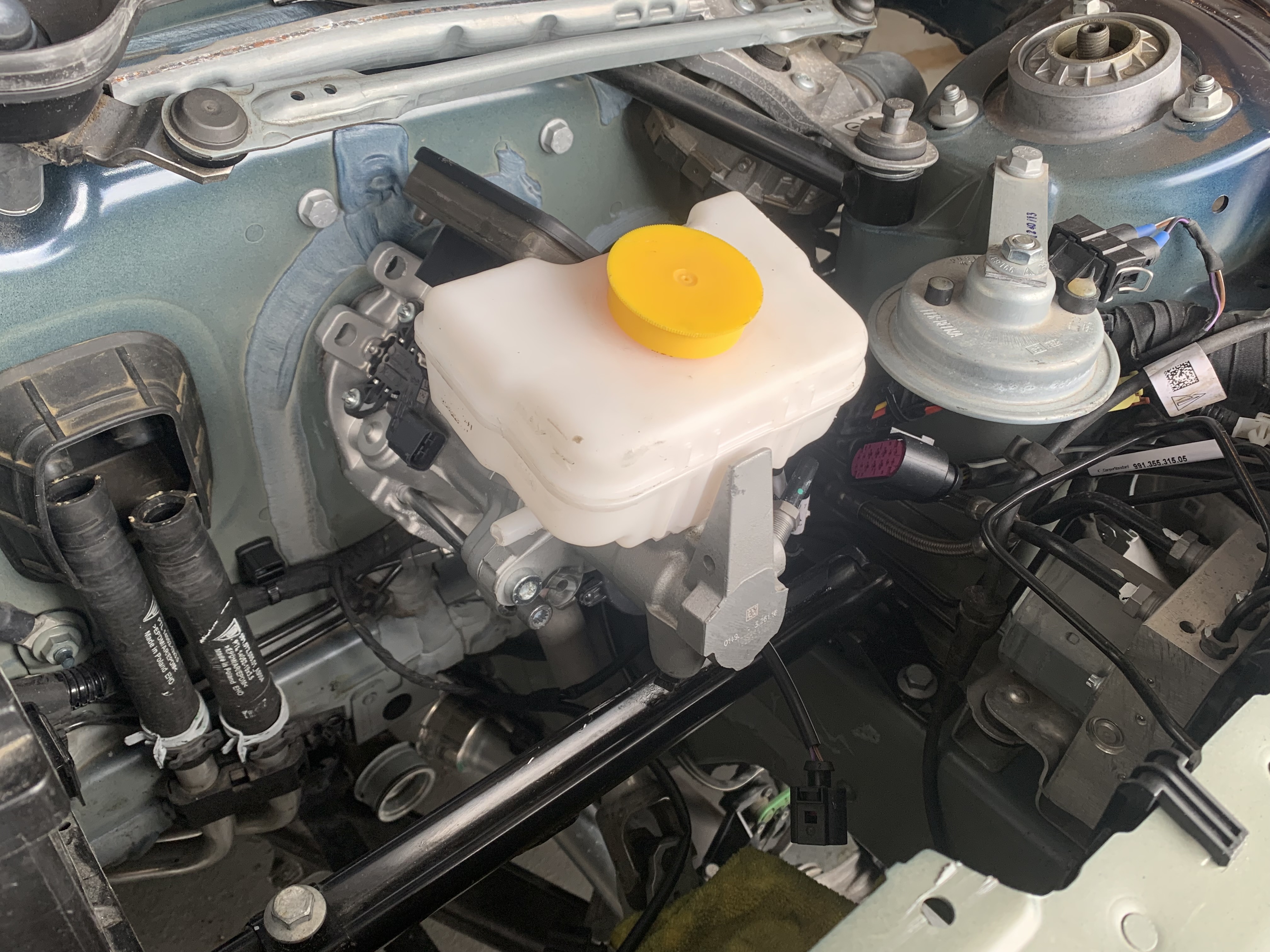

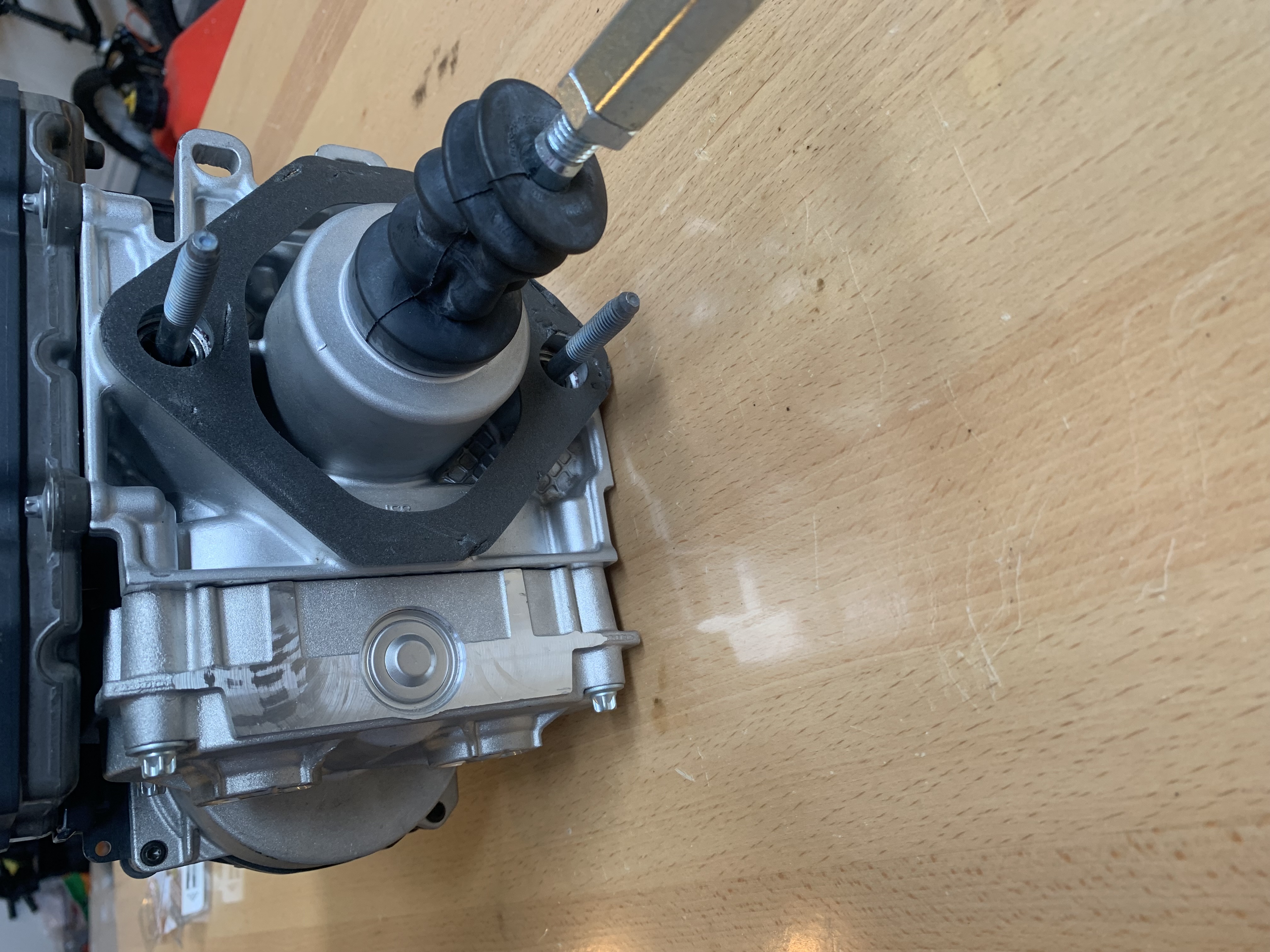

  • I-Booster arrived and mocked up for fitment. Minor adaption required.

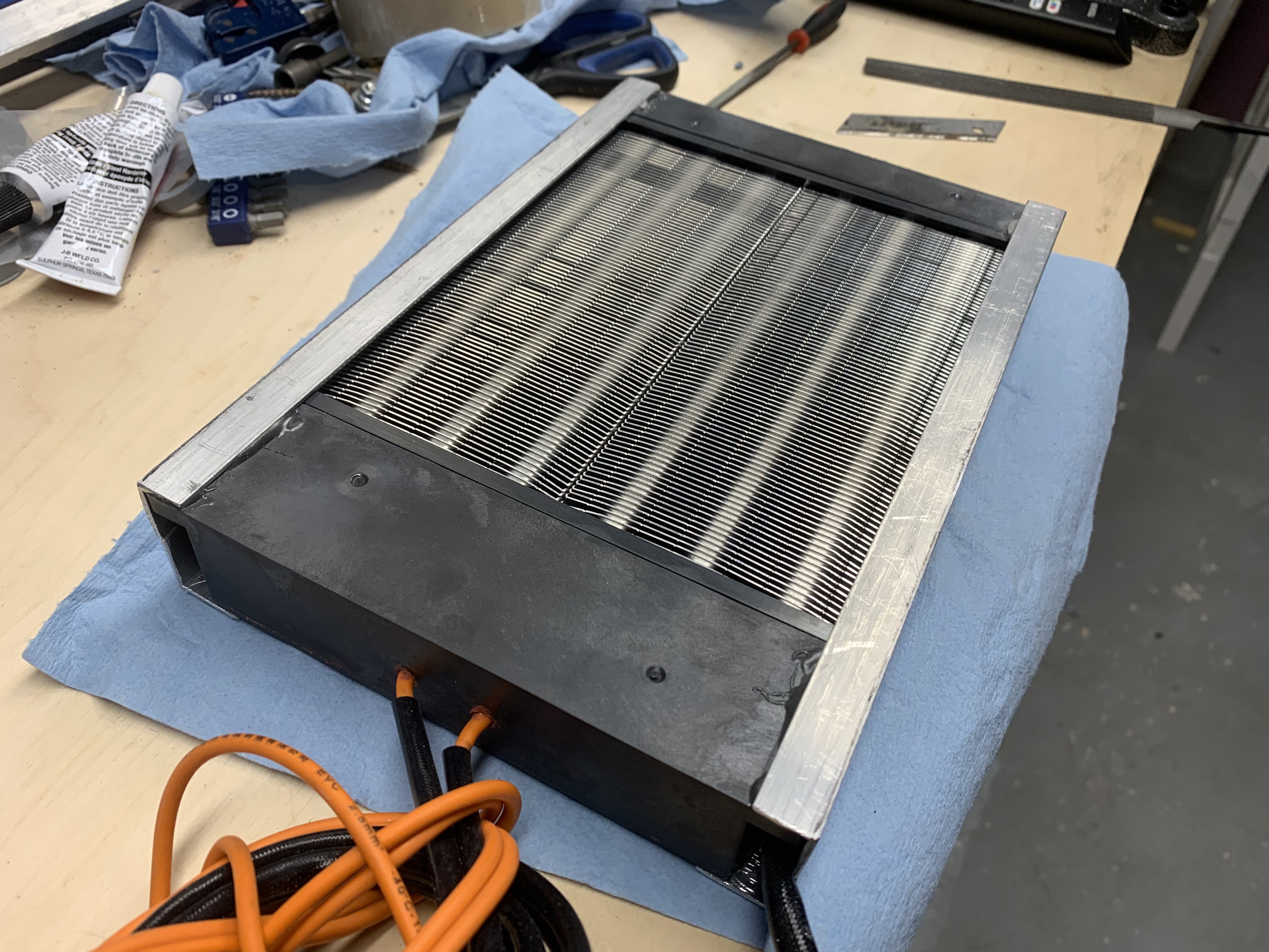

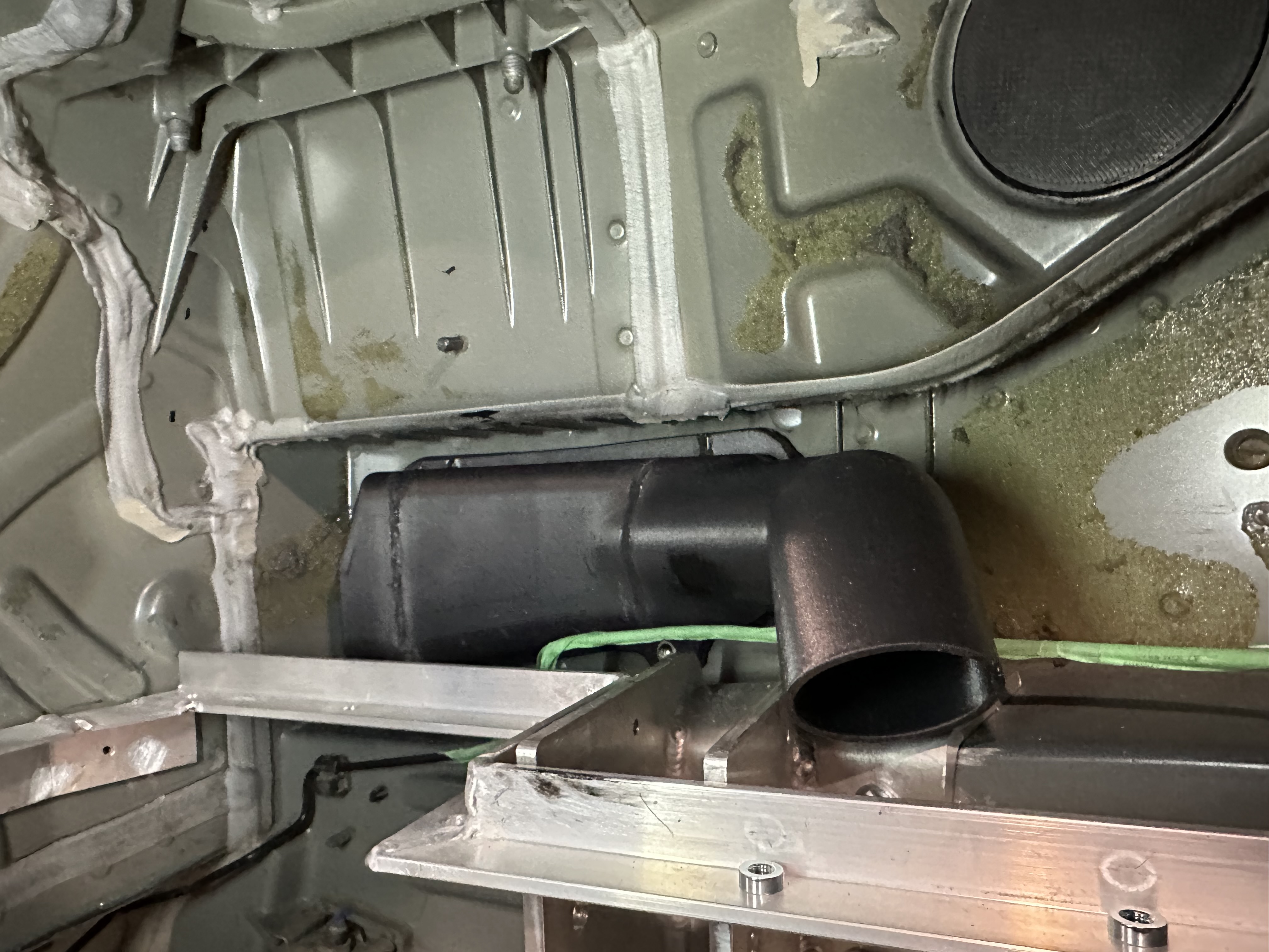

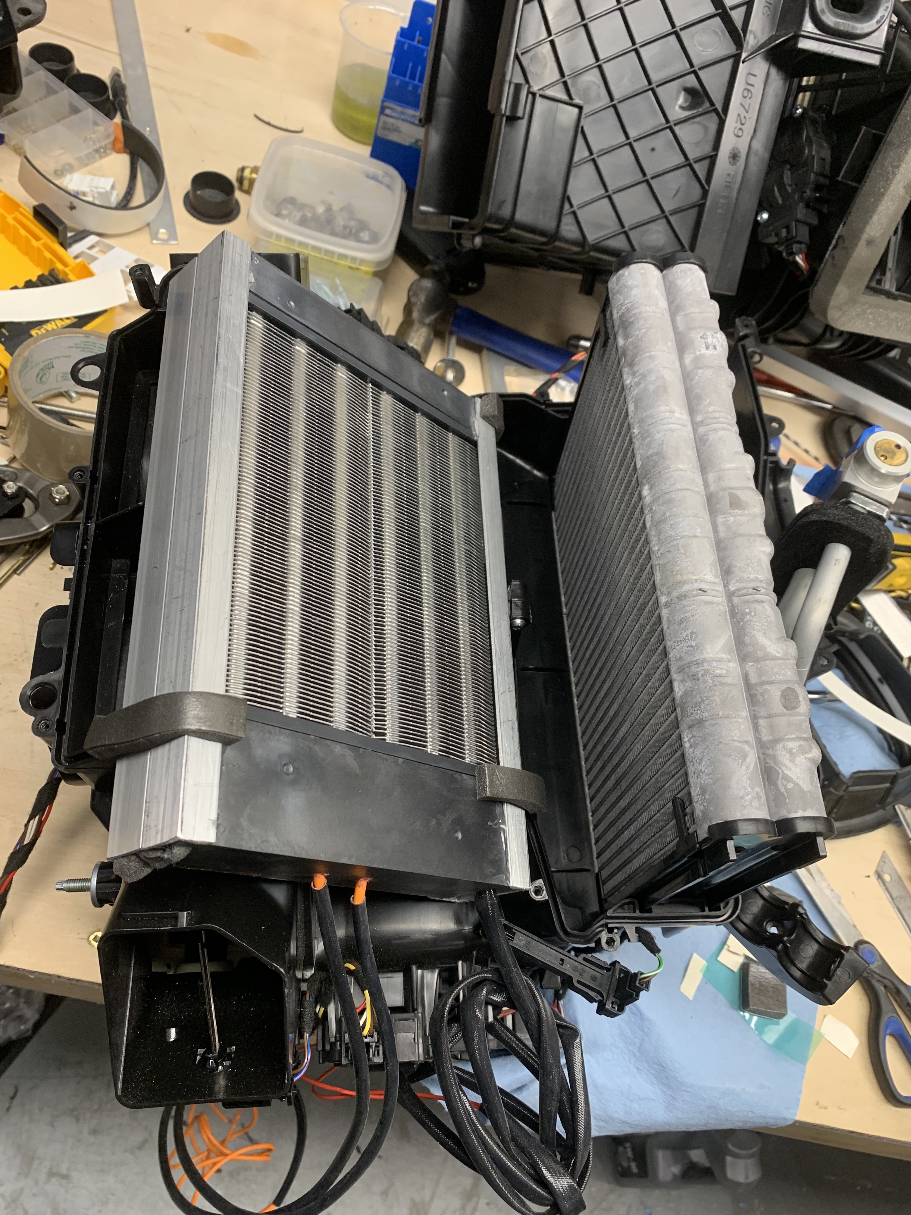

  • PTC Heater from ZeroEV arrived, Mocked up, Awaiting install in Heater core

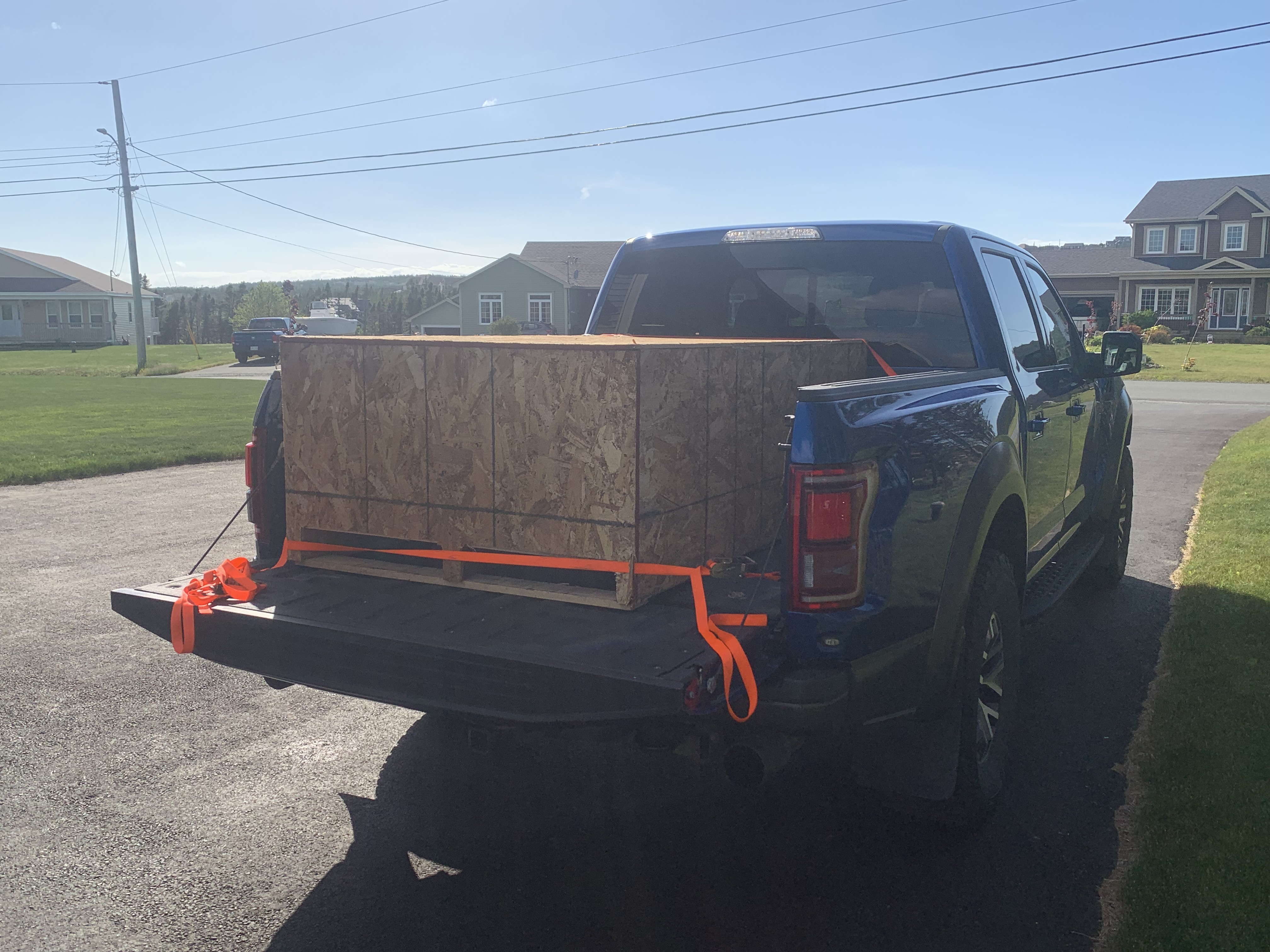

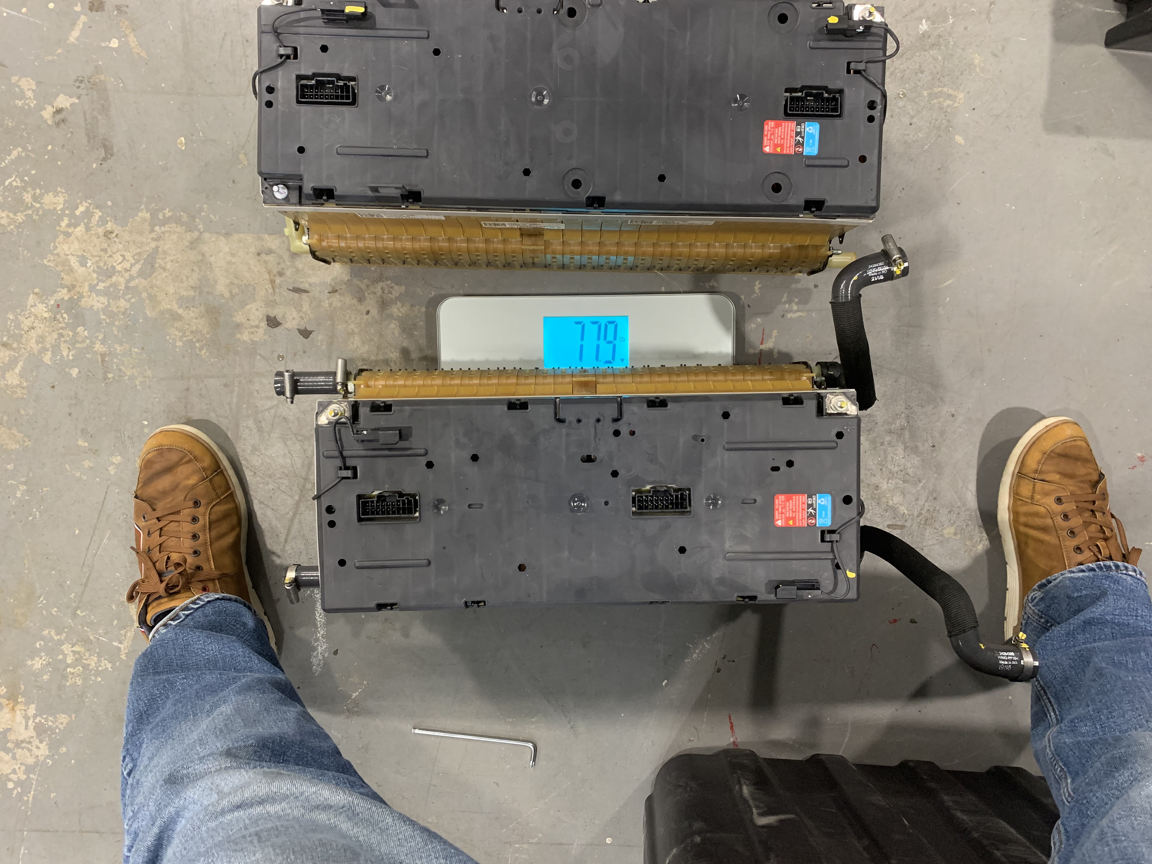

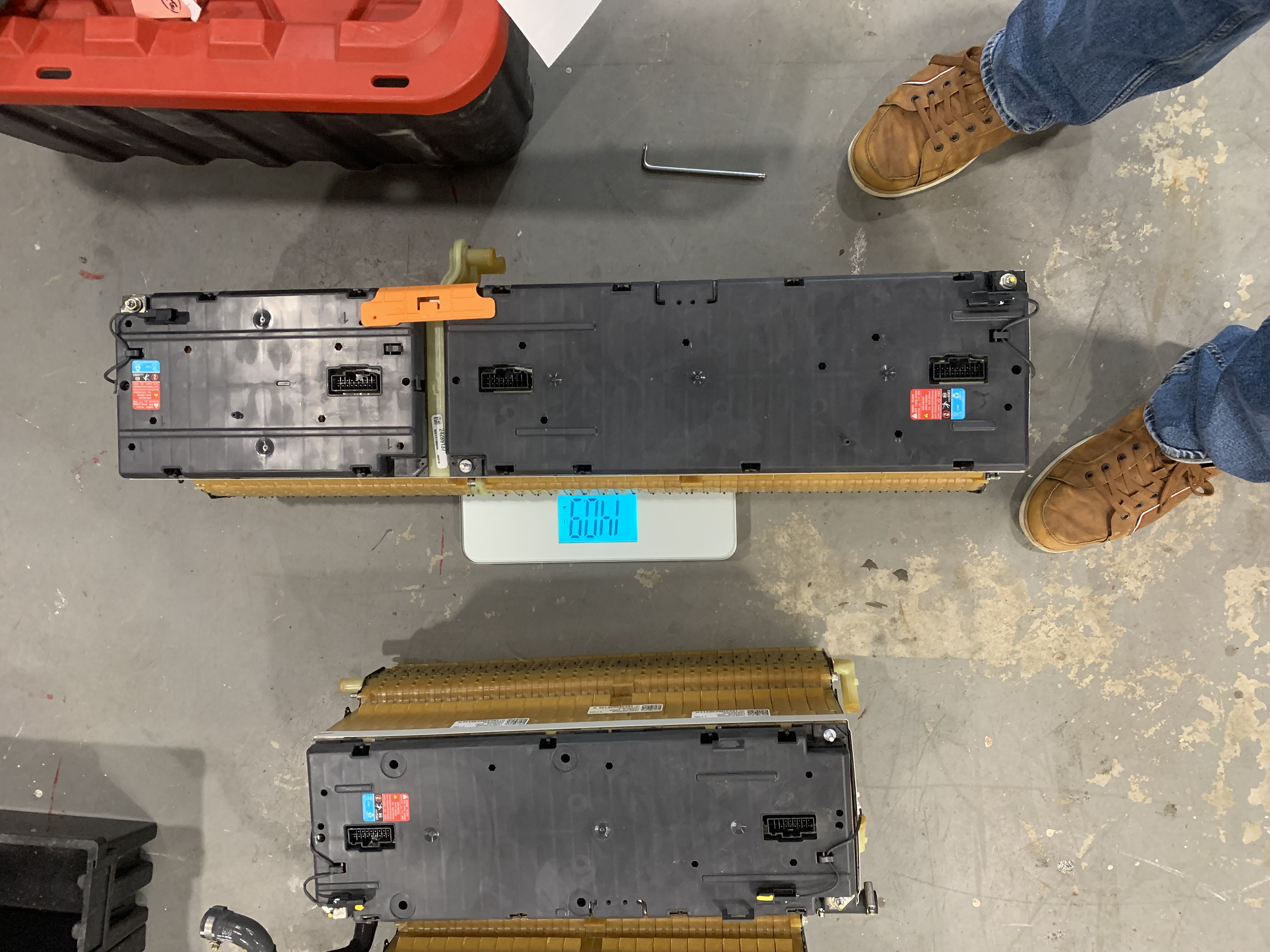

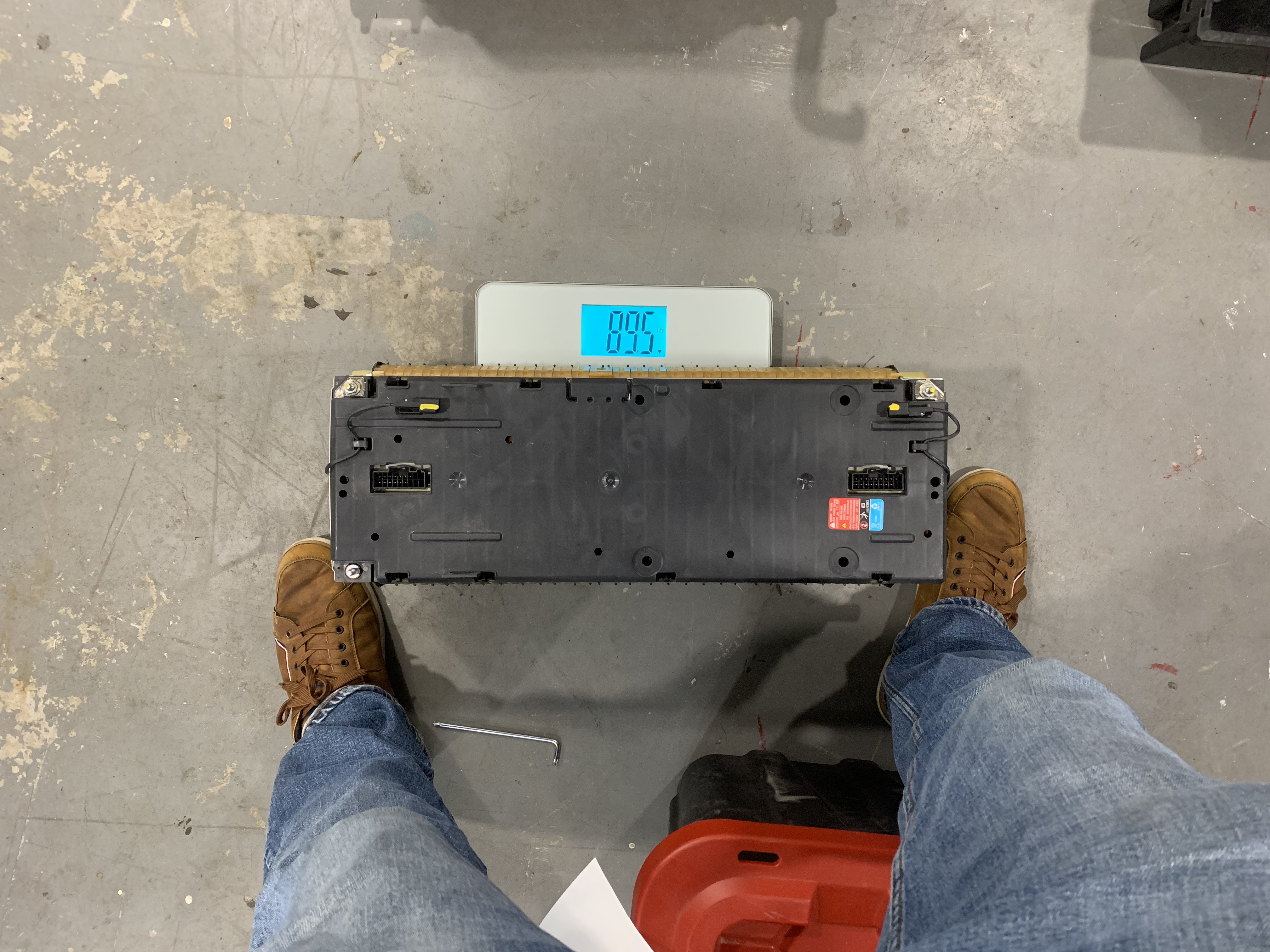

- Volt battery has arrived, The shop that sent it crated it amazingly! The volt battery assembly weights ~200kg.
Broken down the battery subassemblies weigh:
2x12S = 77.9 lbs / 35.3 kg
12S & 16S = 89.5 lbs / 40.6 kg
12S & 2x16S = 140.9 lbs / 63.9 kg
1 Pack total weight = 308.3 lbs / 139.8 kg
The Spark battery is comprised of 6-16s modules. I went this route as the battery was amazingly cheap and since each battery is separate I get multiple end caps. I intend to combine the modules into different blocks, but having extra quick connect fittings will make life easier.

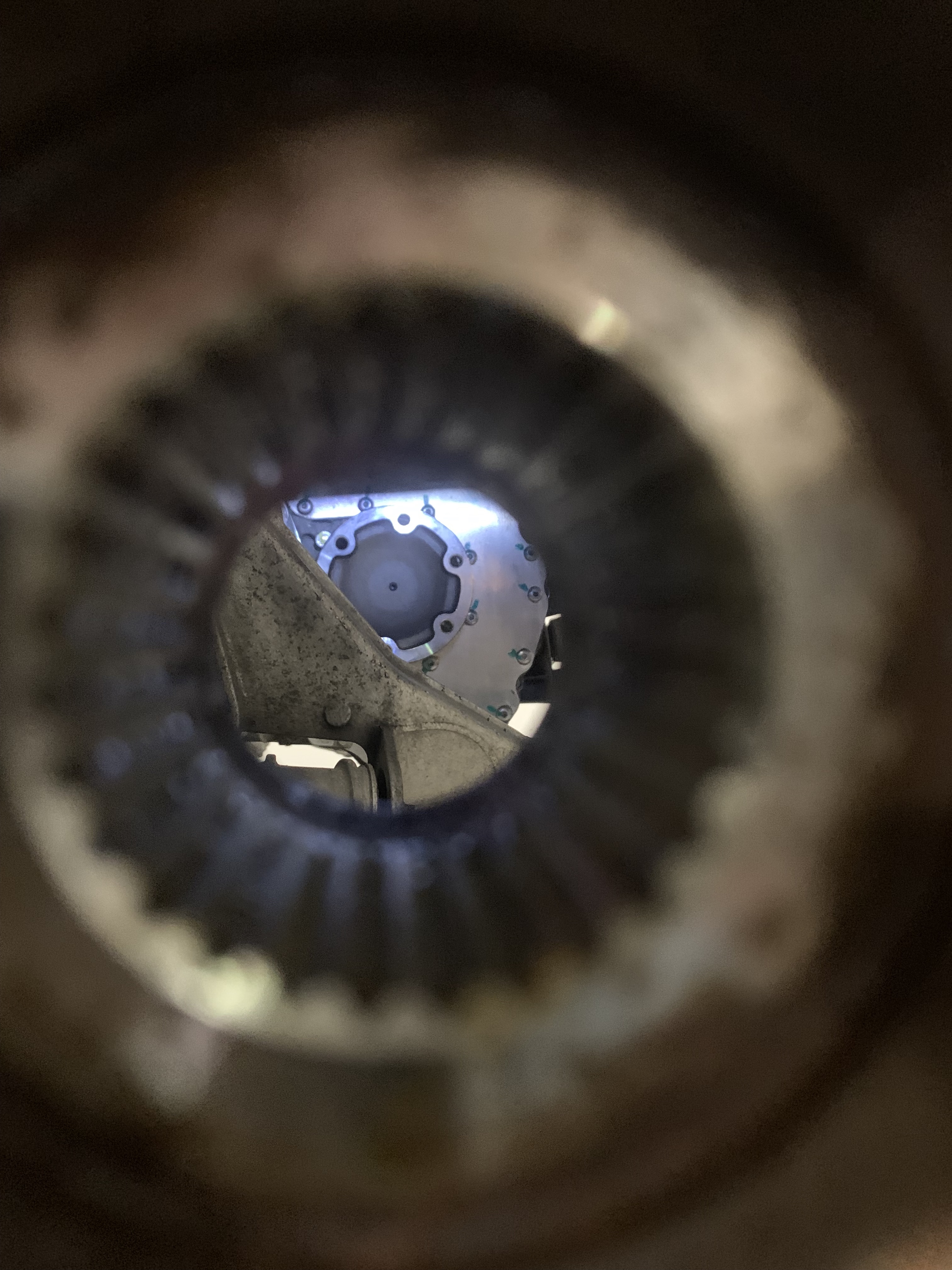

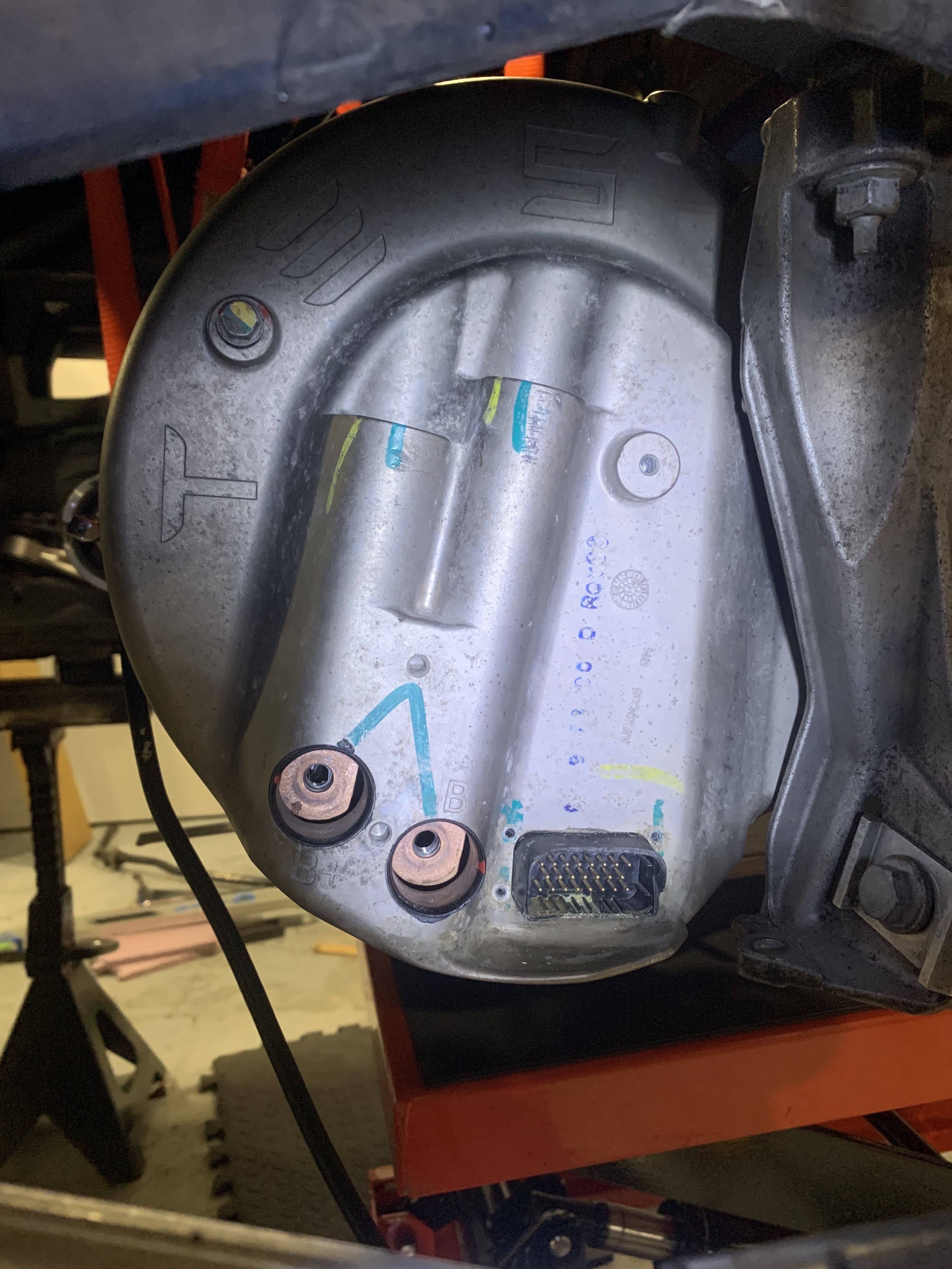

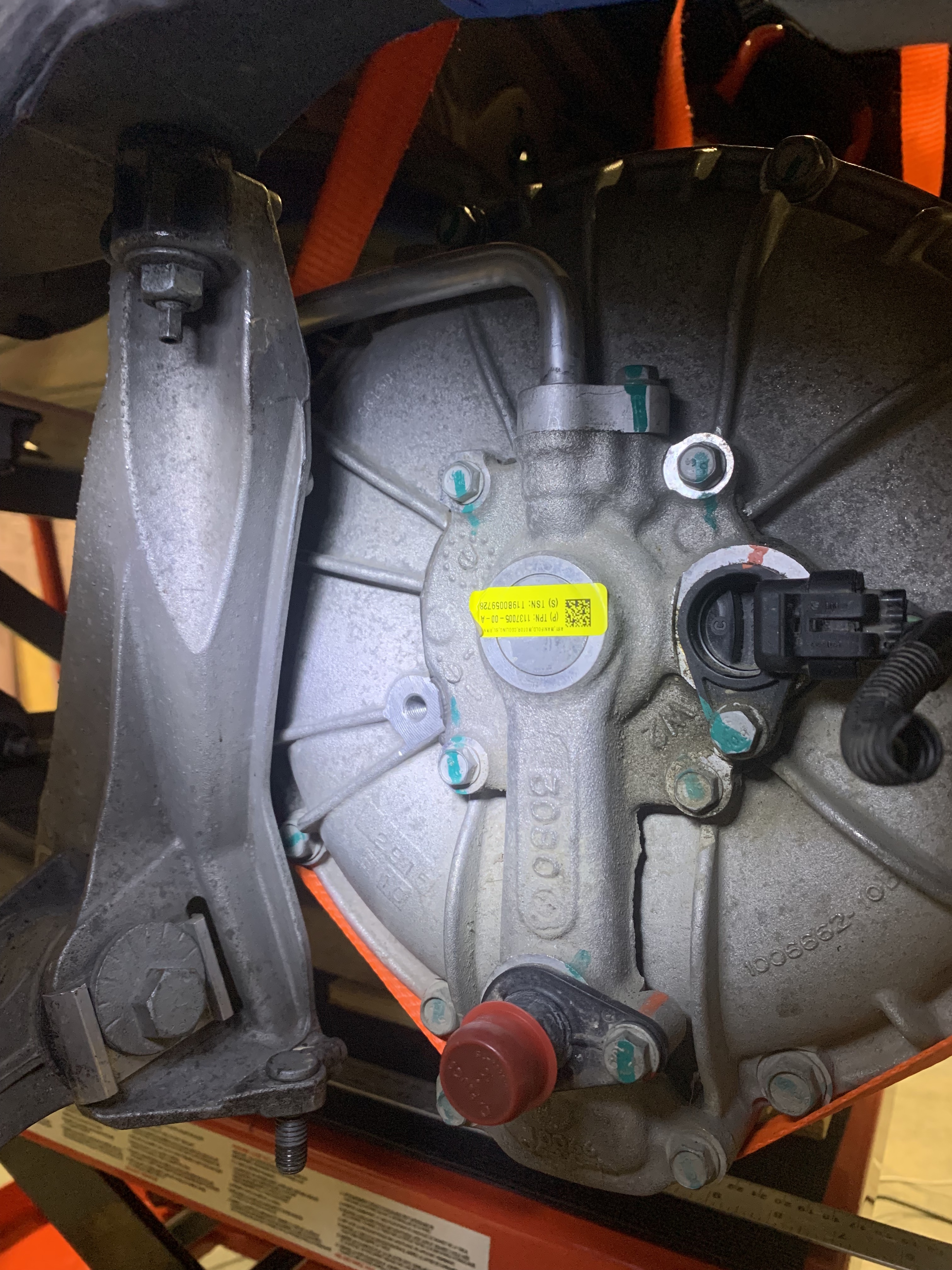

- LDU unit seems to be in great shape. I was a bit concerned with reading the forum, as well as the long documented issues with LDU replacements.
The unit I purchased came from a 2013; as such it was a gamble that it was a early revision... The yard was unable to give me any details about the rev model, so I ordered hoping it was a reman unit. Thankfully it's a -P revision which puts the replacement at 2018.
The donor only had 40,000km so either way it's had an easy life.
- Thanks to Johannes I just received the OI board. All looks great and well packaged! Will prep to install over the weekend and hopefully spin the motor for the first time soon. I opted to pay extra as DHL packages to Canada all default to Ocean Freight now it seems; As my I-booster took 3 months to arrive!

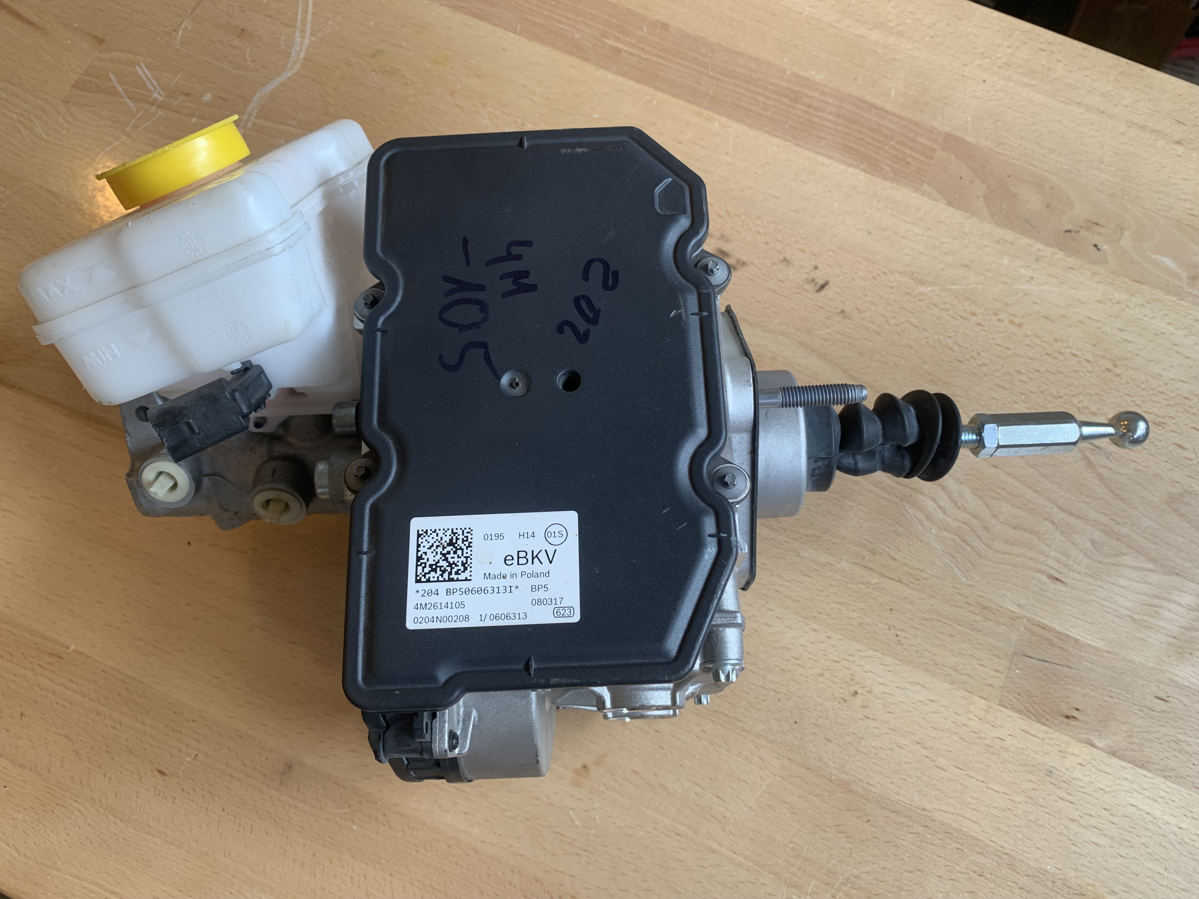

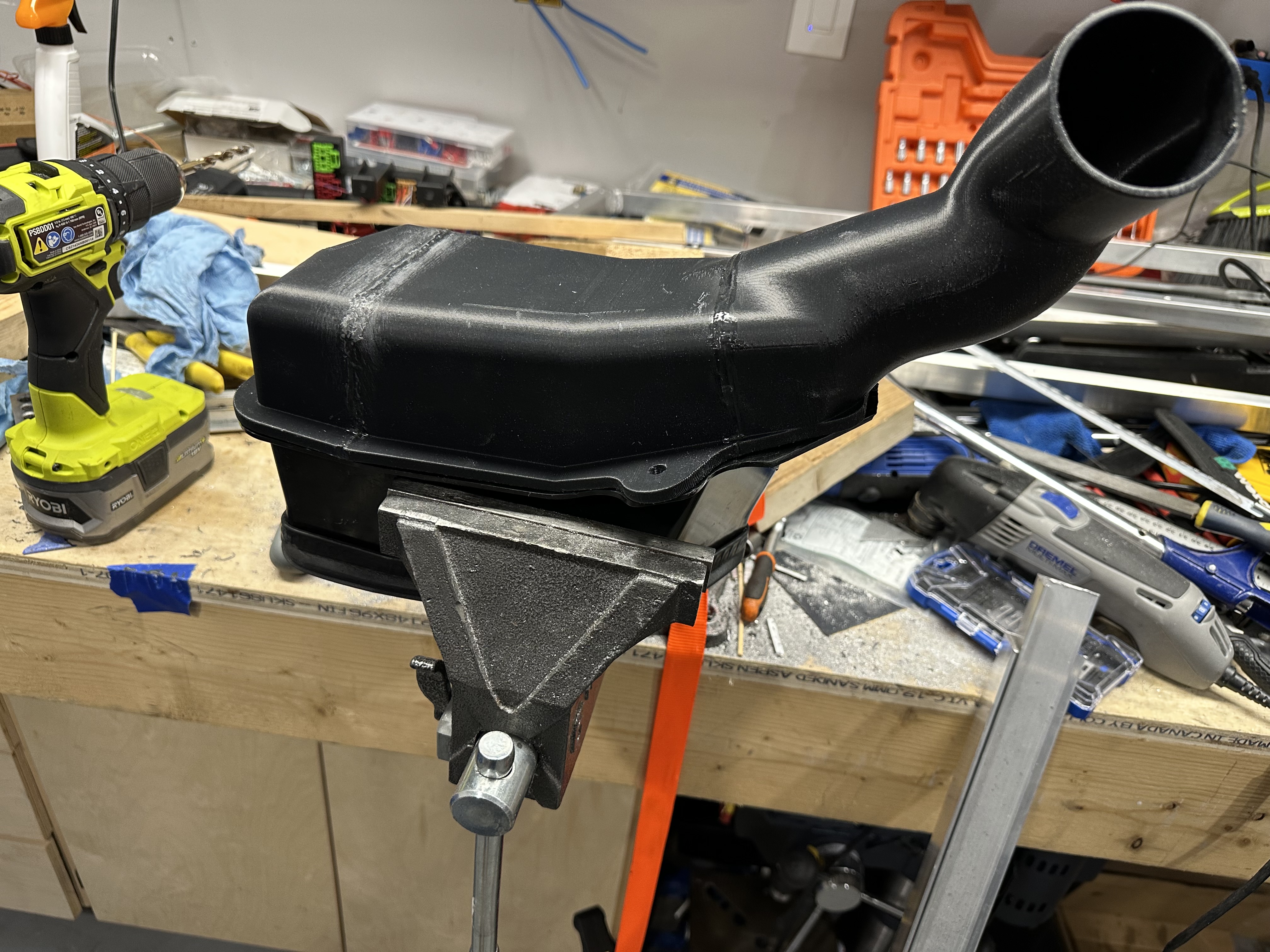

- I-Booster - After many parts bin investigations, It appears that many of the recent Audi Hybrids use the same form factor I-Booster as the existing Vac boosters. That being 2 diagonal bolts (rather that the more common 4 bolt pattern).
The I-Booster PN is: 4M2614105 from a 4M Audi Q7 - This booster primarily has Flexray, but I'm hoping it's failsafe action is similar to the other canbus boosters.
Currently in the process of fitting the booster, It'll require a slight lengthening of the ball end, as well as shortening the threads on the existing bolts; as the 981 has a blind hole where the new bolt bottoms out on.

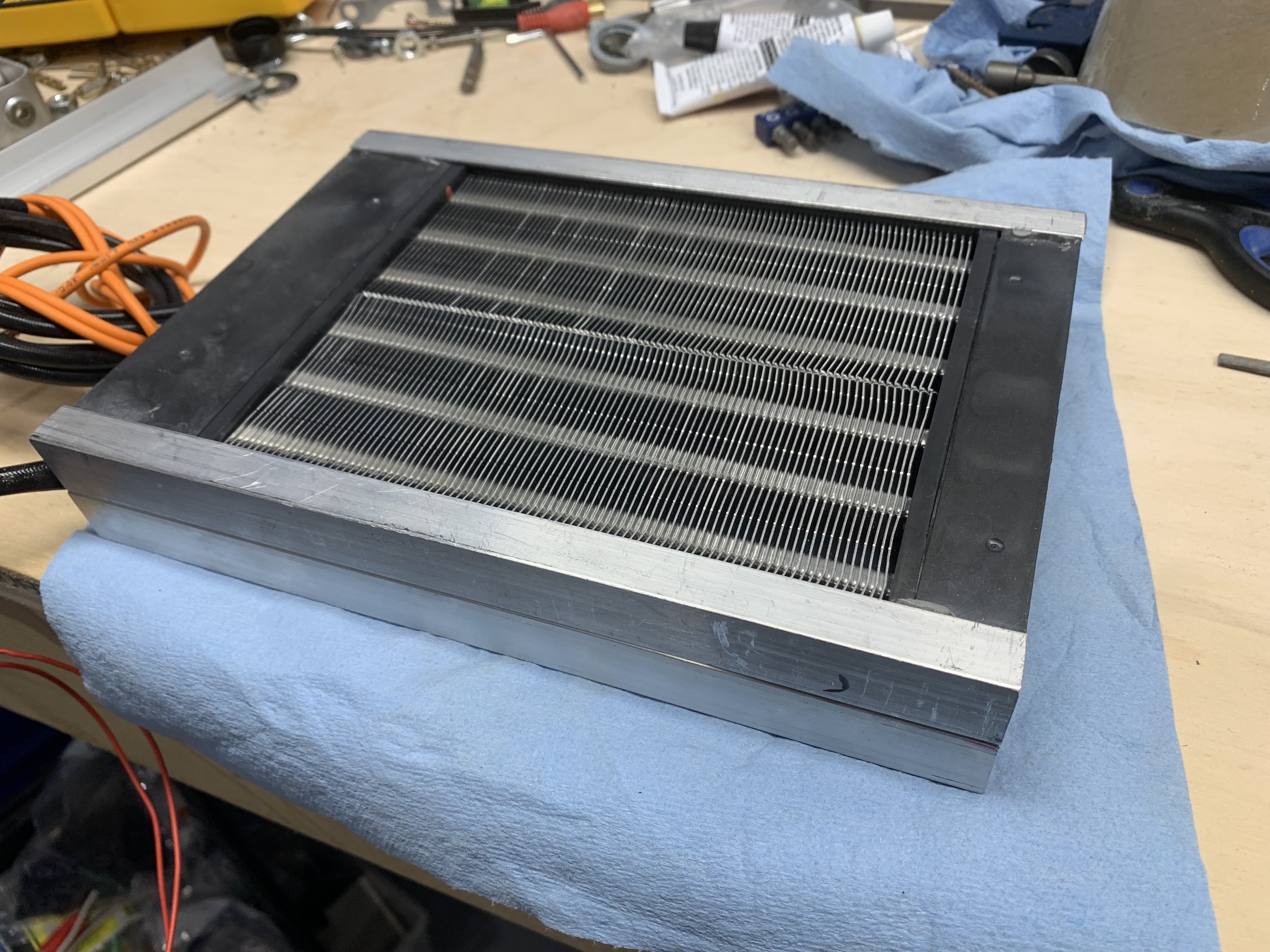

- PTC Heater is ready to install.

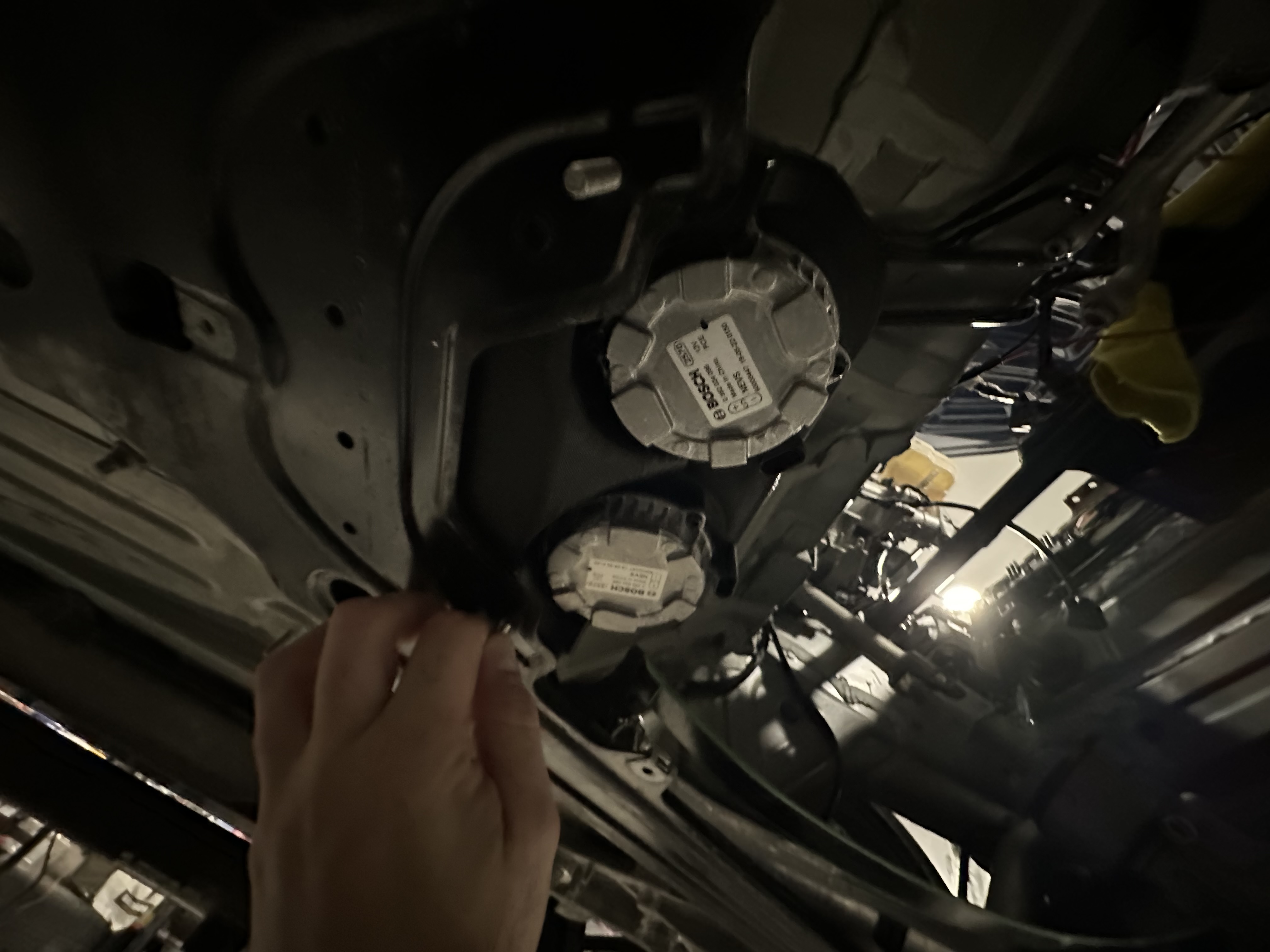

Brake Booster:
The Audi 4M2 brake booster has been mounted, this wasn't too difficult but needed about 8mm trimmed from the bolts and an M10 extension placed on the rod to correctly use the existing Porsche ball mount
The Porsche booster is basically identical to all VAG parts from 97 Jettas onward.
The Audi Master Cyl was re-used, but the aux port for the pressure accumulator was plugged. this is a 2nd line off of the rear brake port.
I've confirmed that the existing Master Cyl is a 26.5mm unit and similarly sized to the GT3 booster upgrade that is common (27mm I believe)
If i was to re-do this, I'd suggest just getting an aluminum spacer fabricated to space it slightly from the firewall. This also would address an issue with the brake lines which are routed behind the booster unit being a bit too close for comfort, I solved this by bending them slightly, but to keep the lines totally factory, a 1/4" spacer would be perfect.

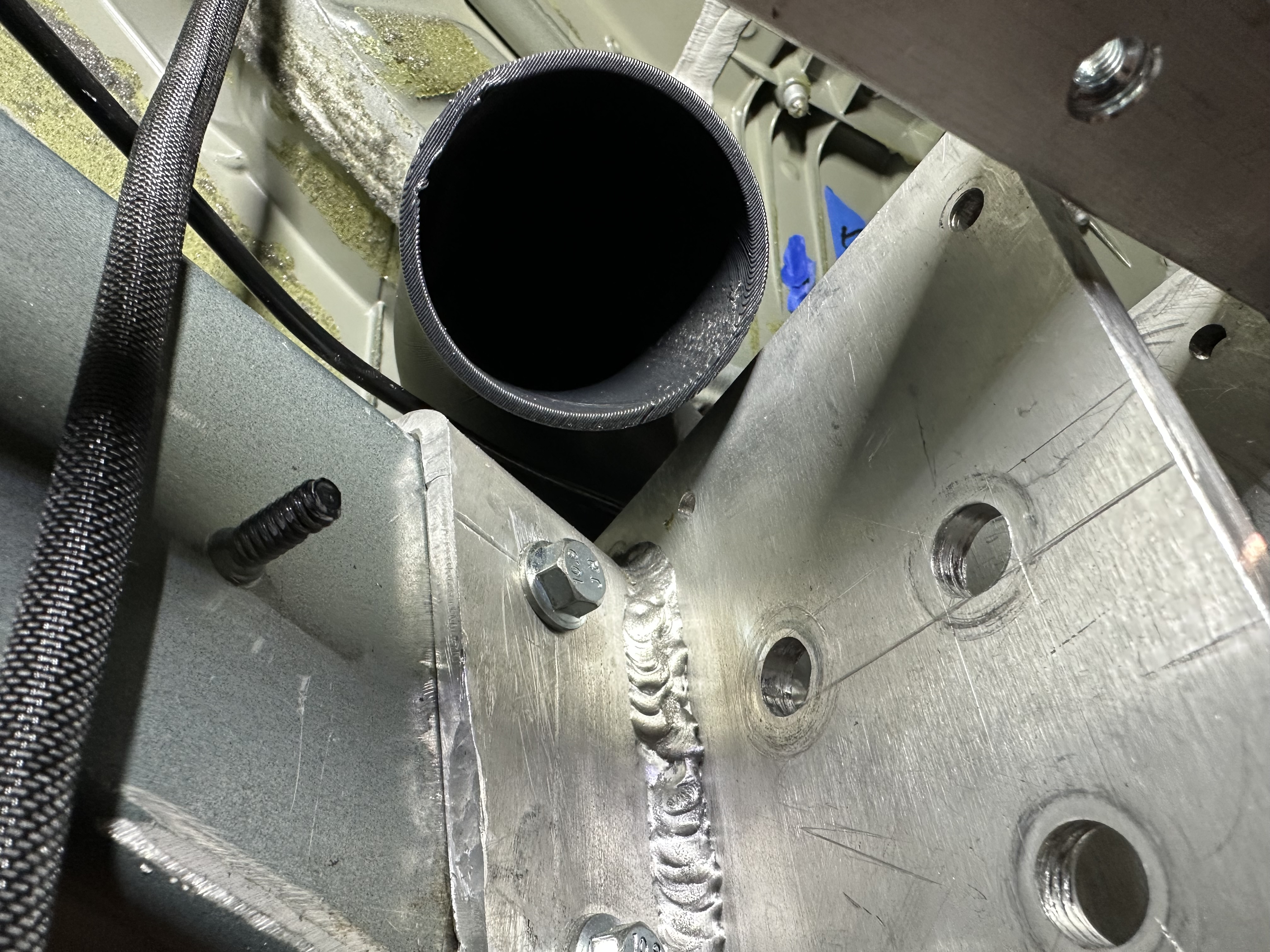

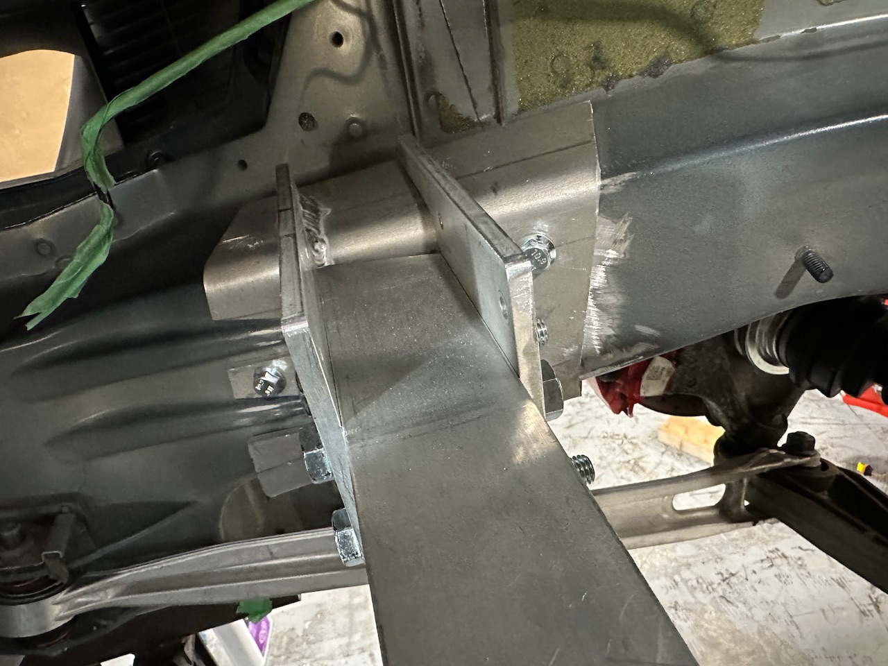

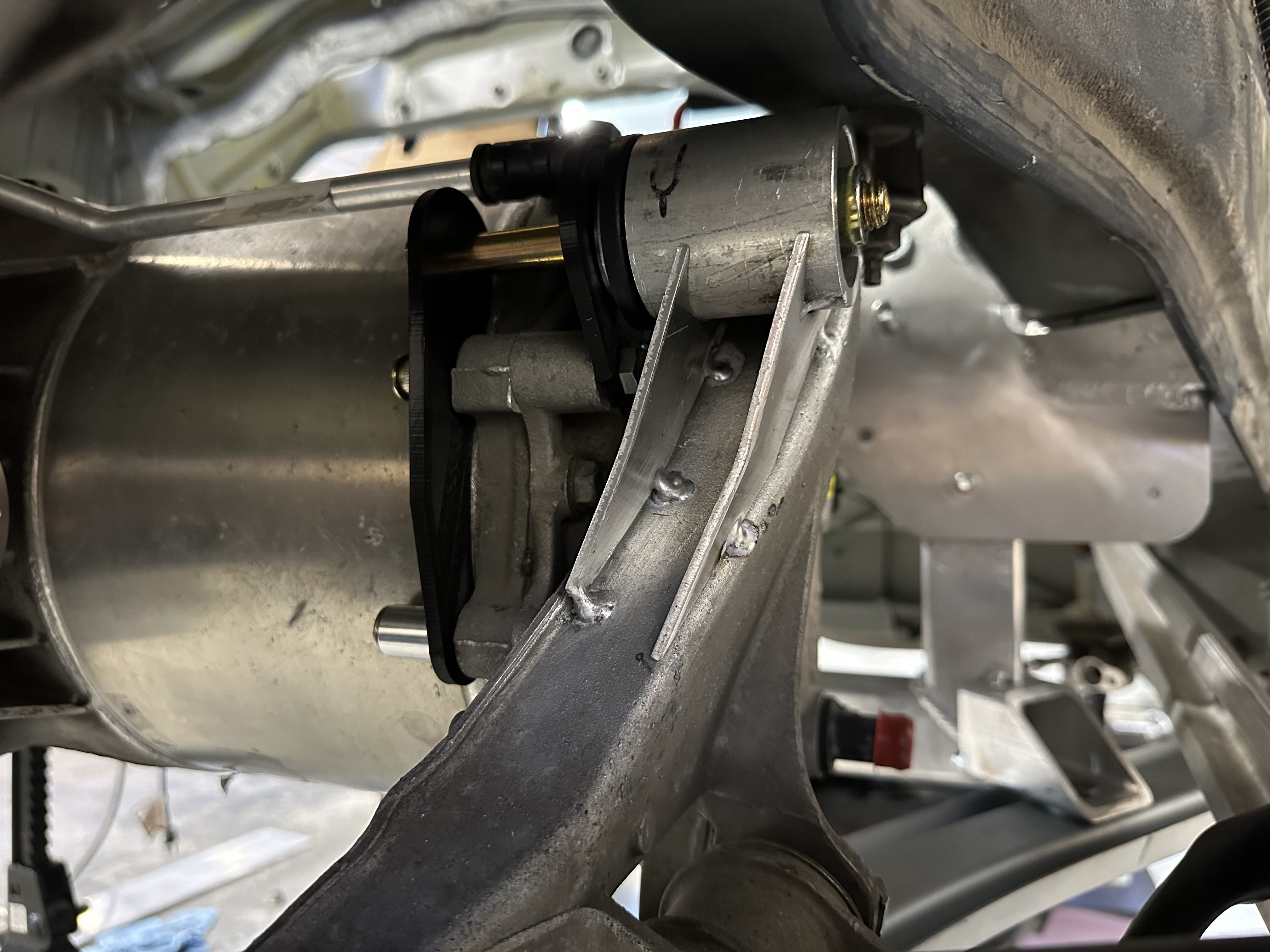

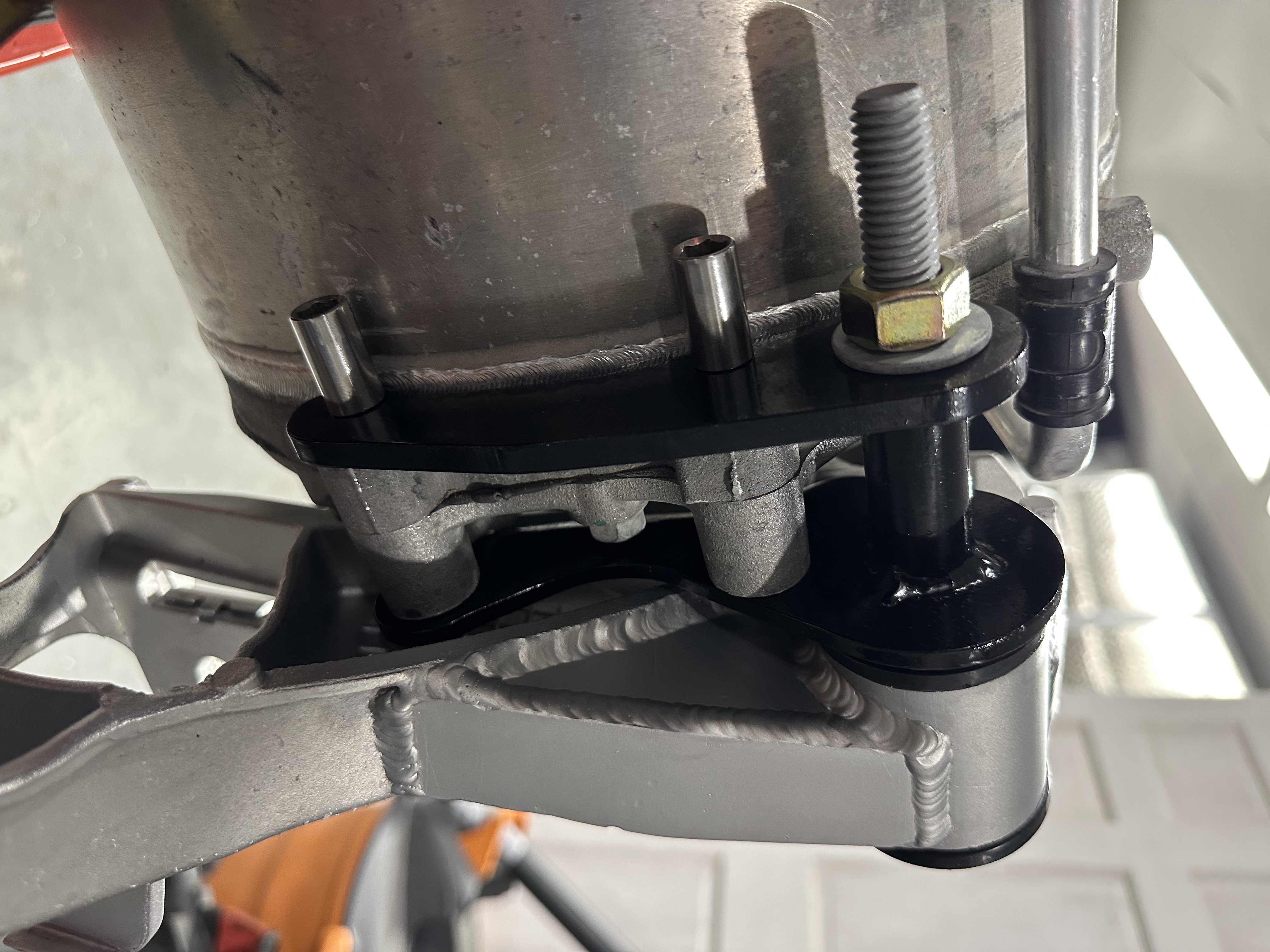

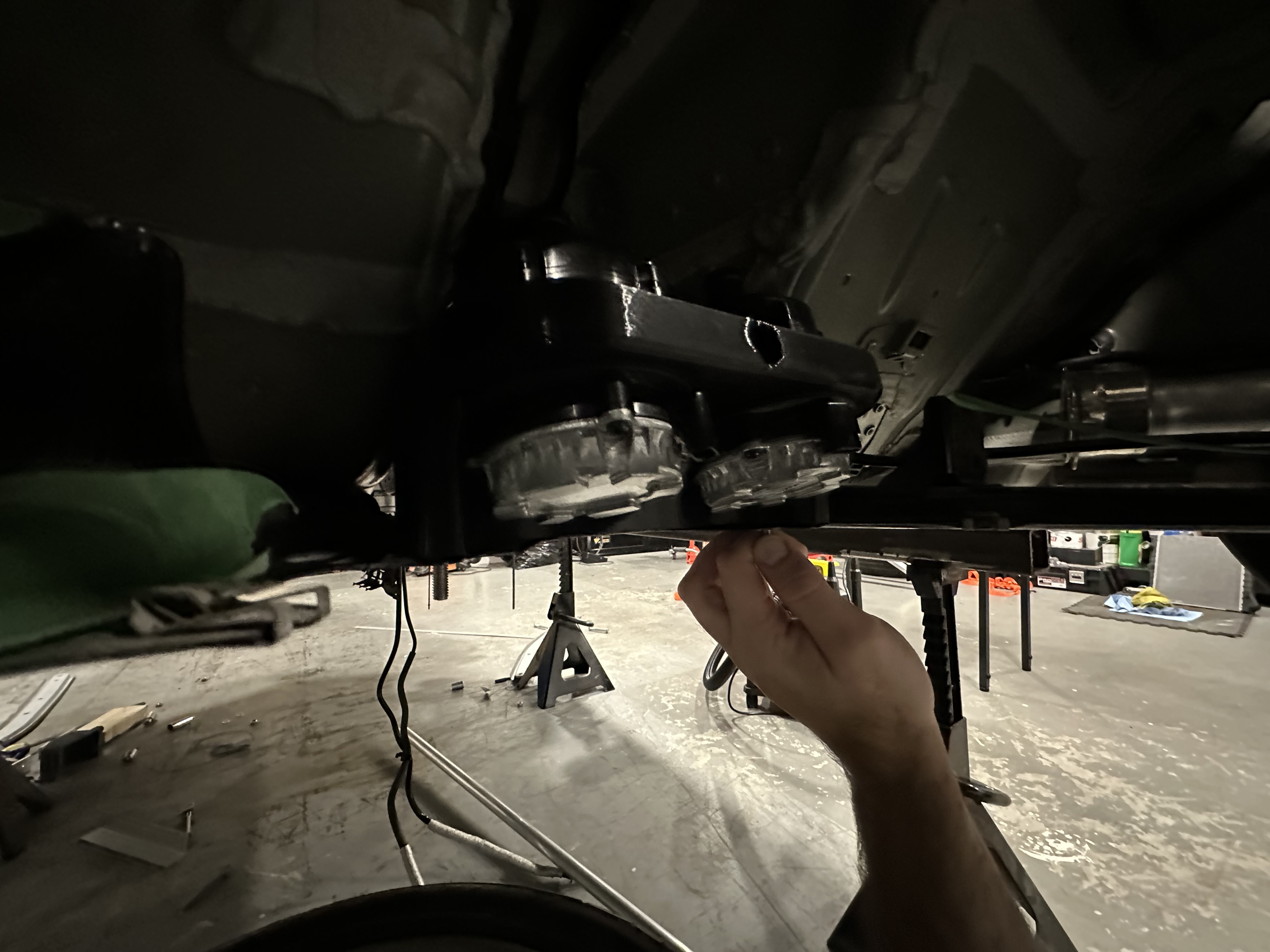

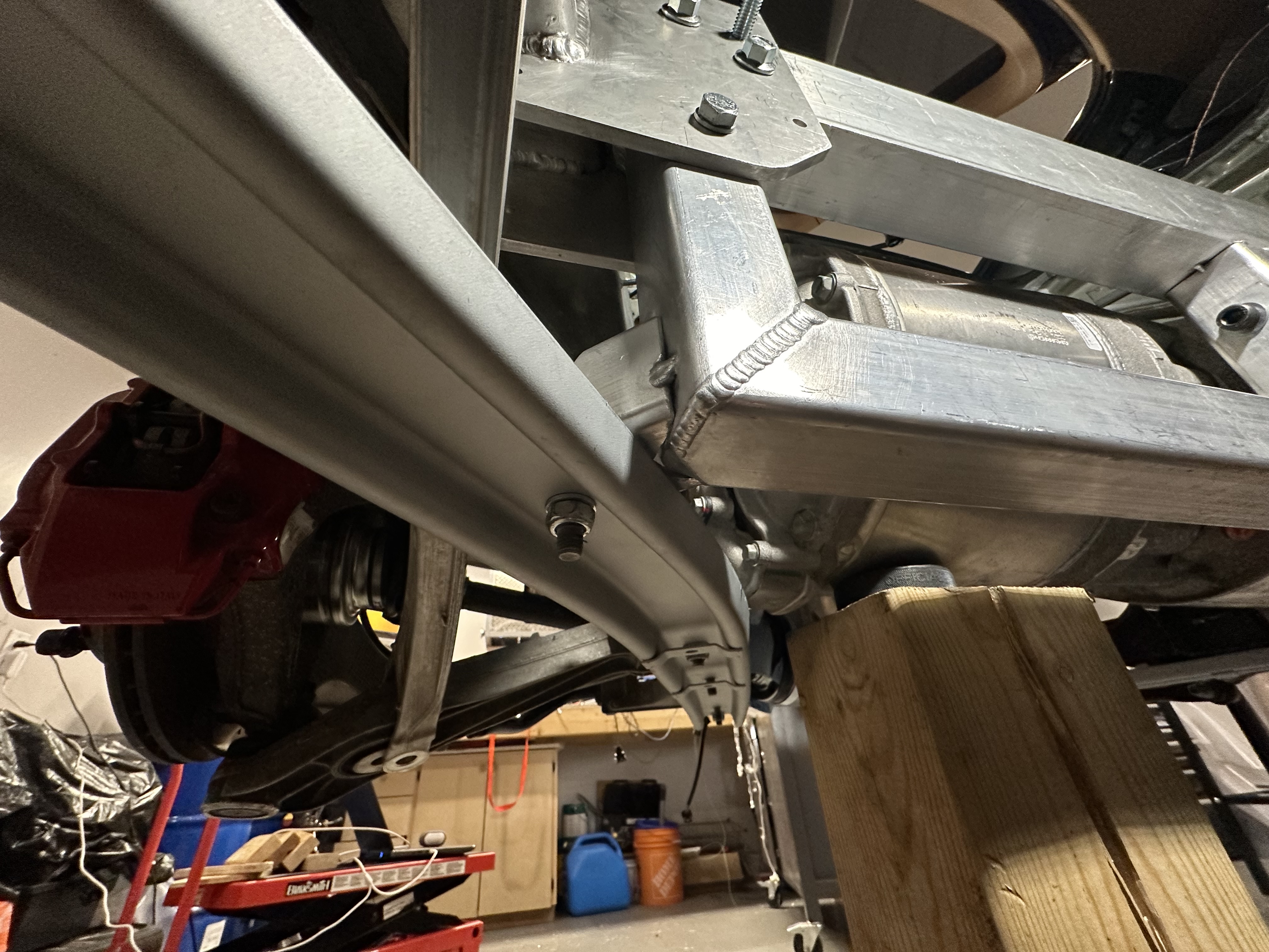

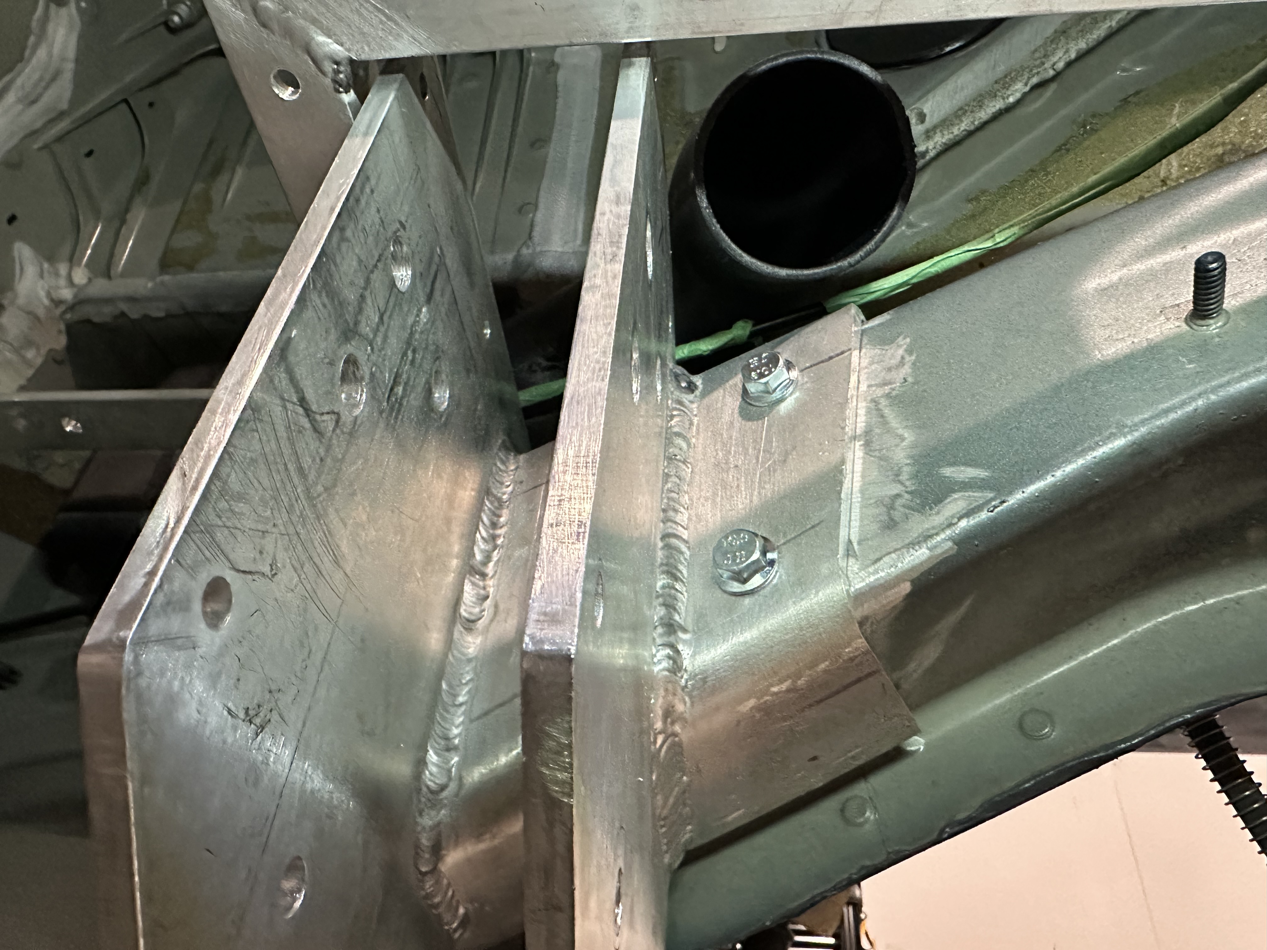

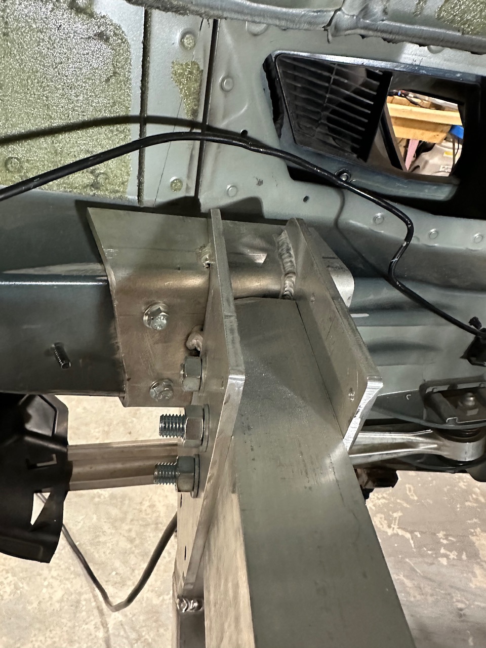

Motor mounting:
Rear mount is fabricated with the help of SendCutSend, It mounts onto the transmission mounts of the rear subframe.
I plan to release my mount for anyone who wishes to use it.
Fabricated out of 1/4" aluminum
*Sharp eyed people may find the mistake I made... The mount is symmetrical... except the offset motor mount. When I imported it into SendCutSend, I mistook the back face for the front, thus all my bends were incorrect, resulting in the offset moving the wrong location*
Bolts into the existing mounts on each of the subframe pieces:

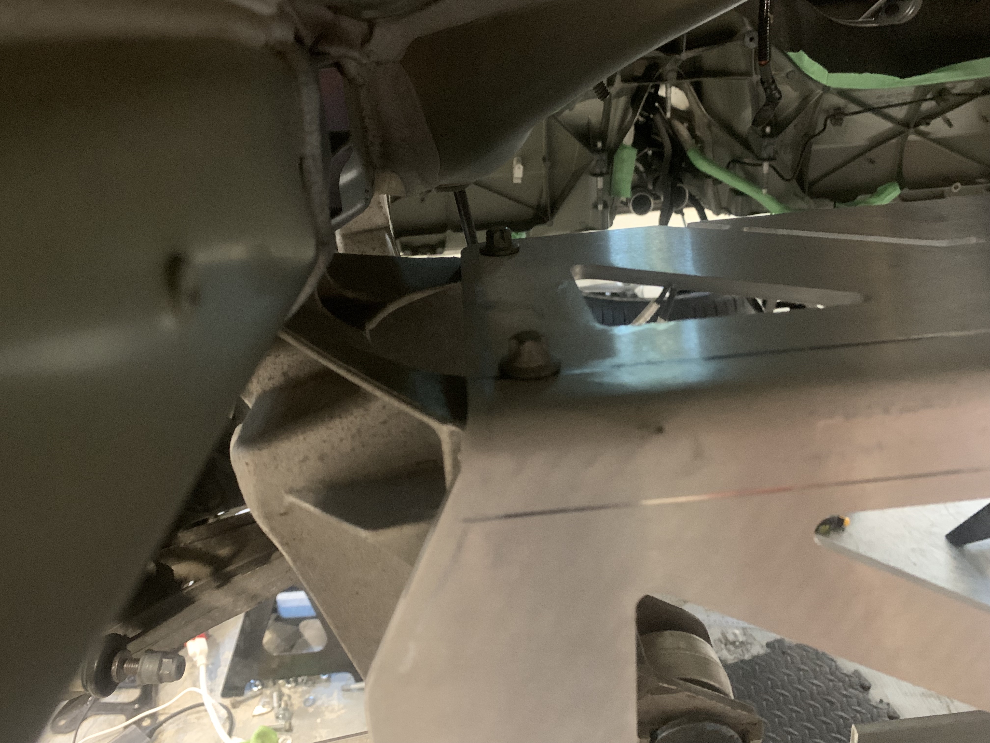

Bottom flange for bottom skidplate/reinforcement:
Motor/Inverter Placement:
Right-
Left-

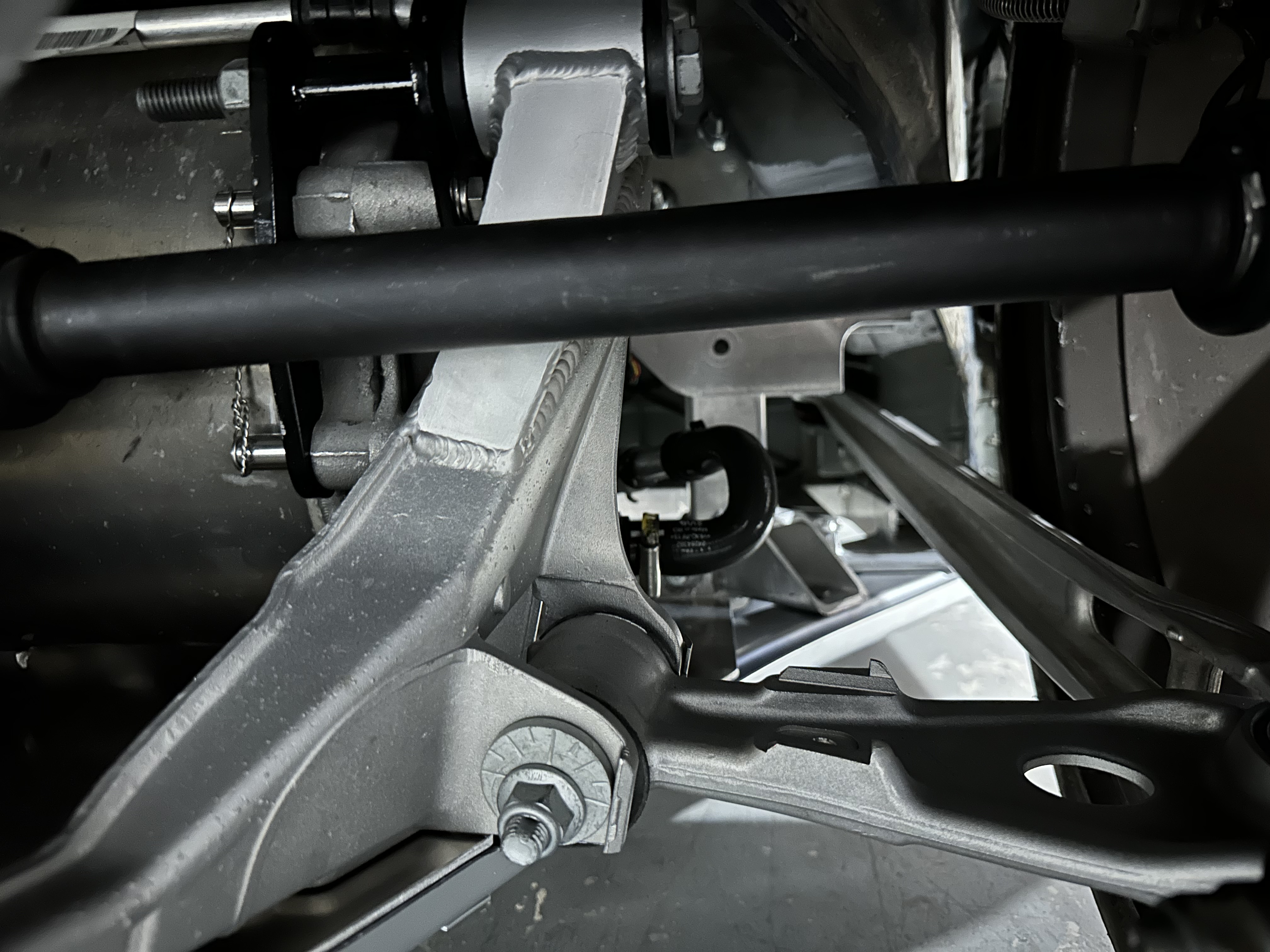

CV Placement:
Right (Full Droop)-
Left (Full Droop)-

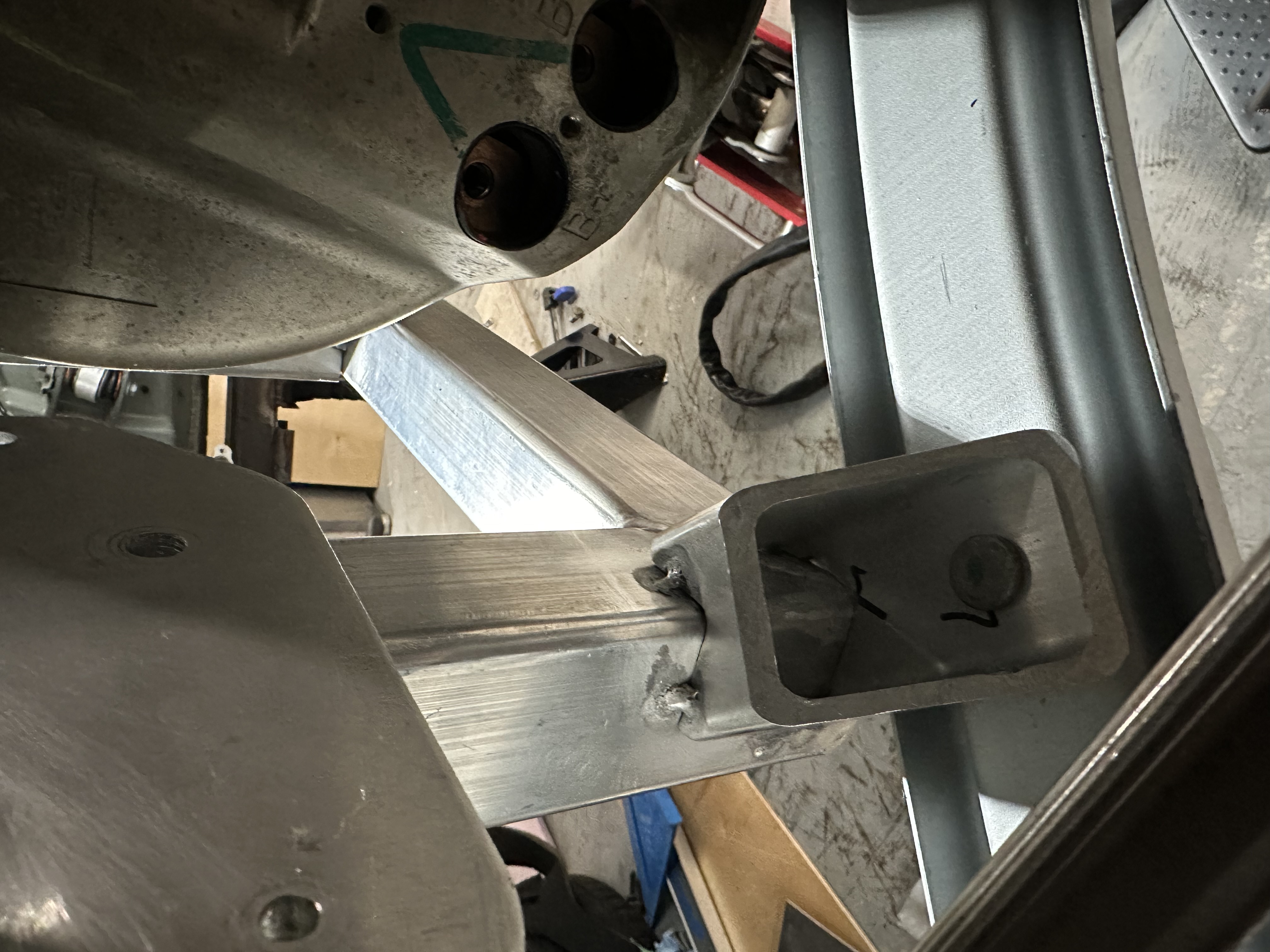

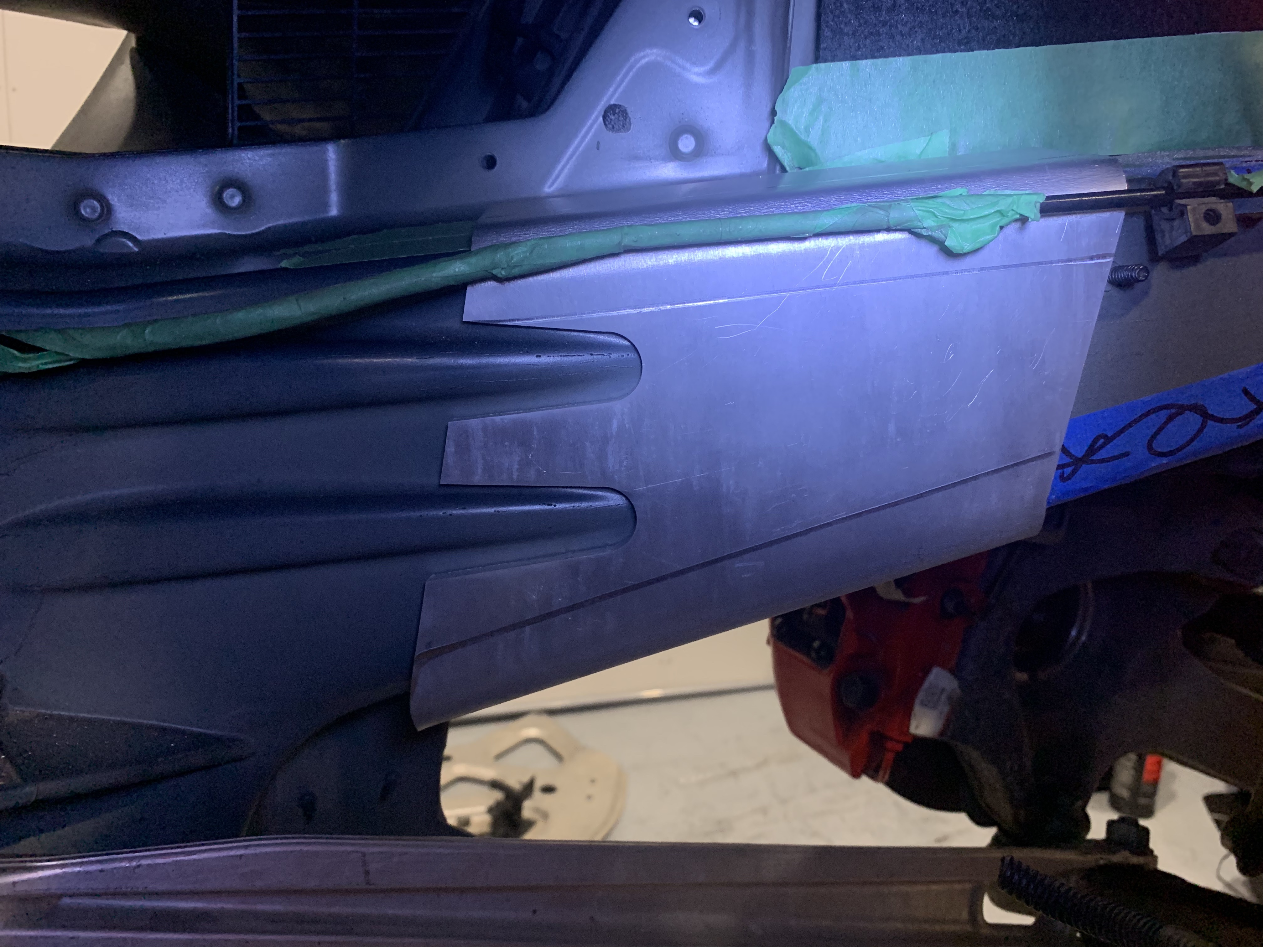

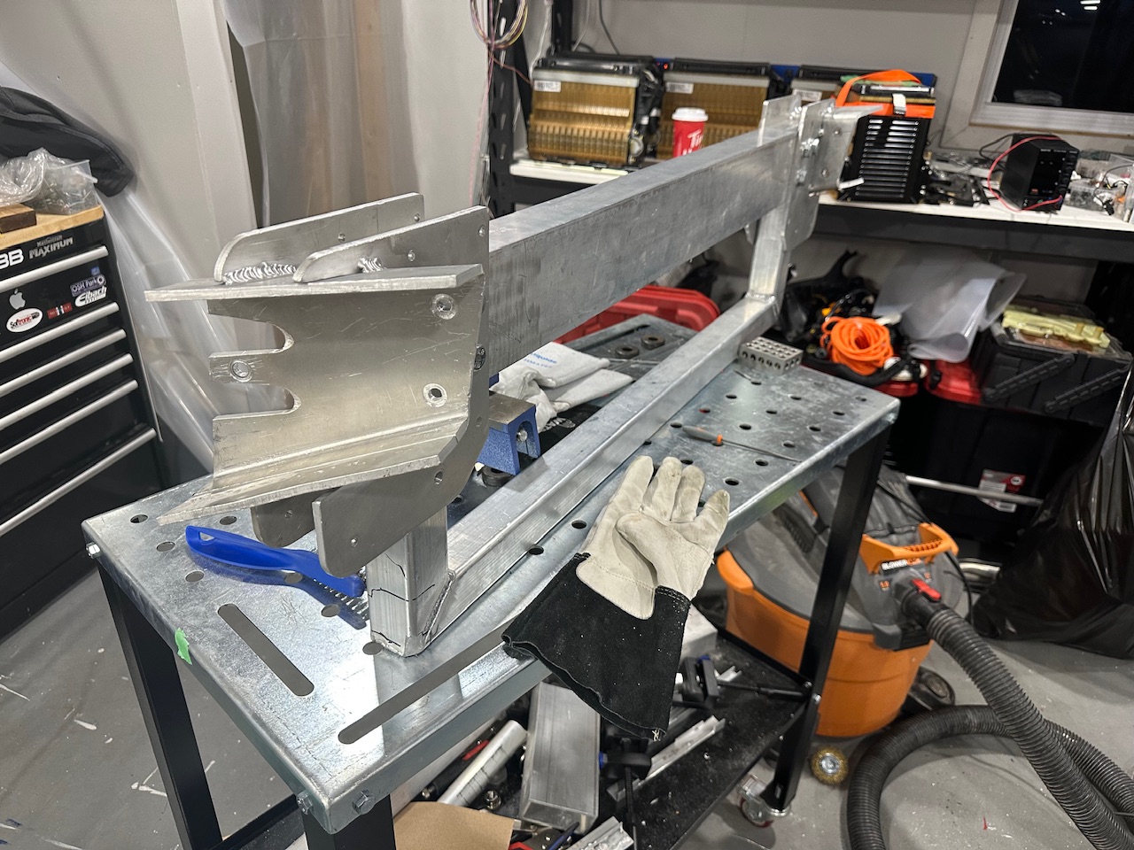

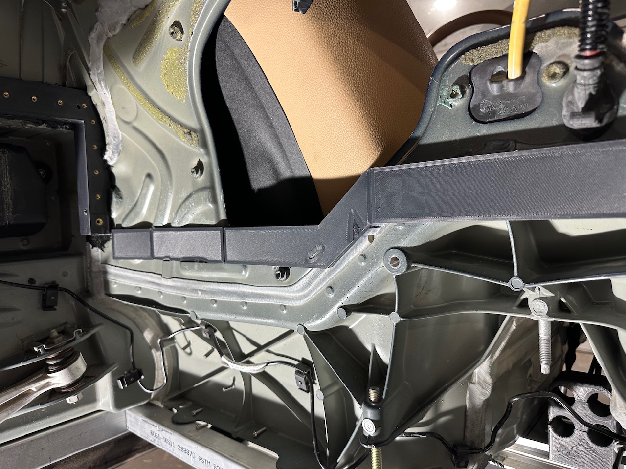

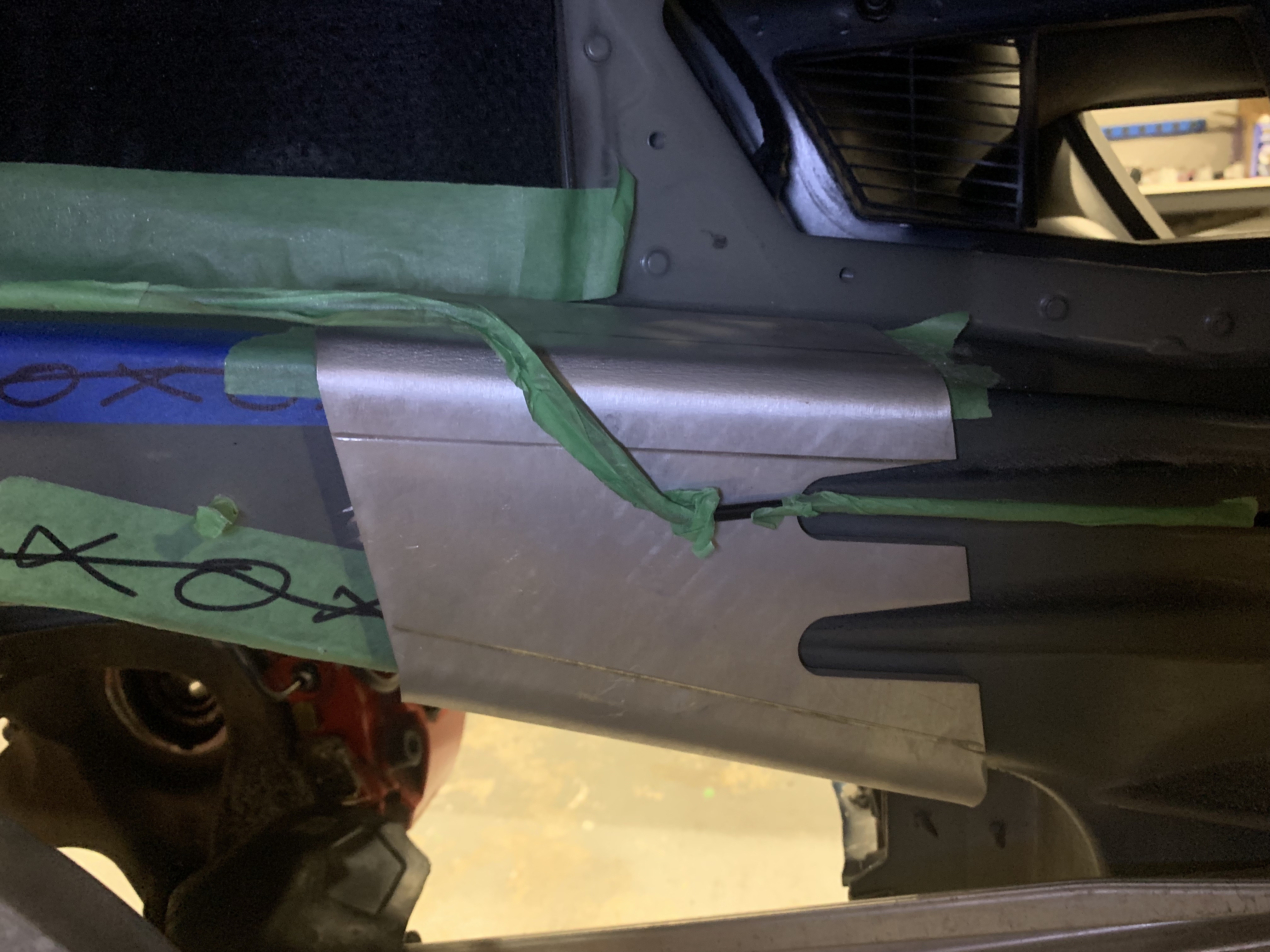

Motor Mounting

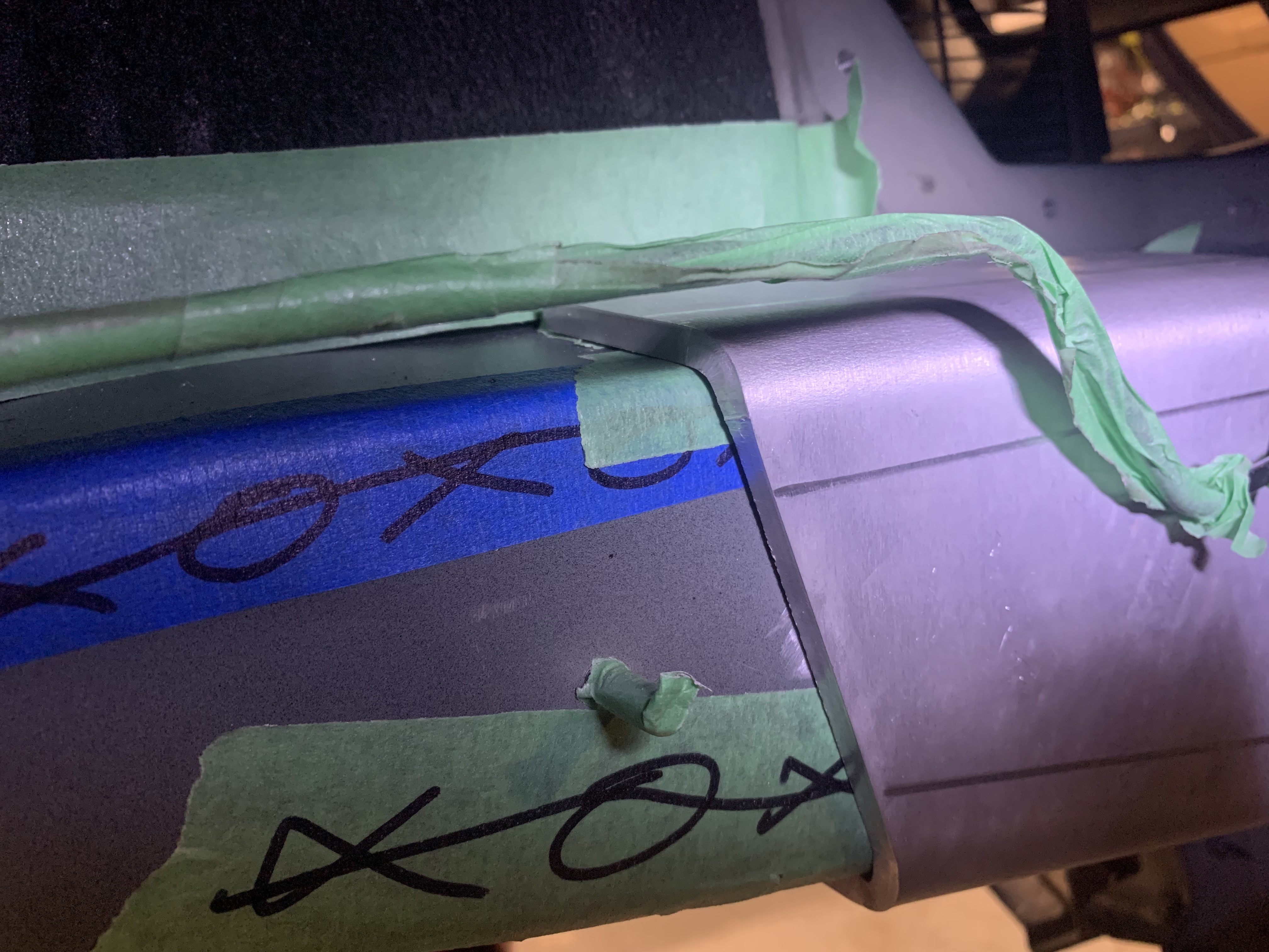

I've also created 2 clamshell mounts that fit over the existing chassis rails. From this I'll use a 1.5x3" Aluminum Rectangular Tube and have it bolt onto these mounts, welding flanges onto them to cradle the cross brace with thru bolts.
Since the chassis is aluminum, for these clamshell mounts I'll use structural adhesive and rivet.
Off of this cross brace, another structure will be built to mount the motor on its front mount, and then extend down and be triangulated as I need to restore some bracing to the rear subframe from the removal of the factory stamped steel cross-brace.
Scan from CRScan Lizard:
Right Rail Clamshell Piece:
Left Rail:

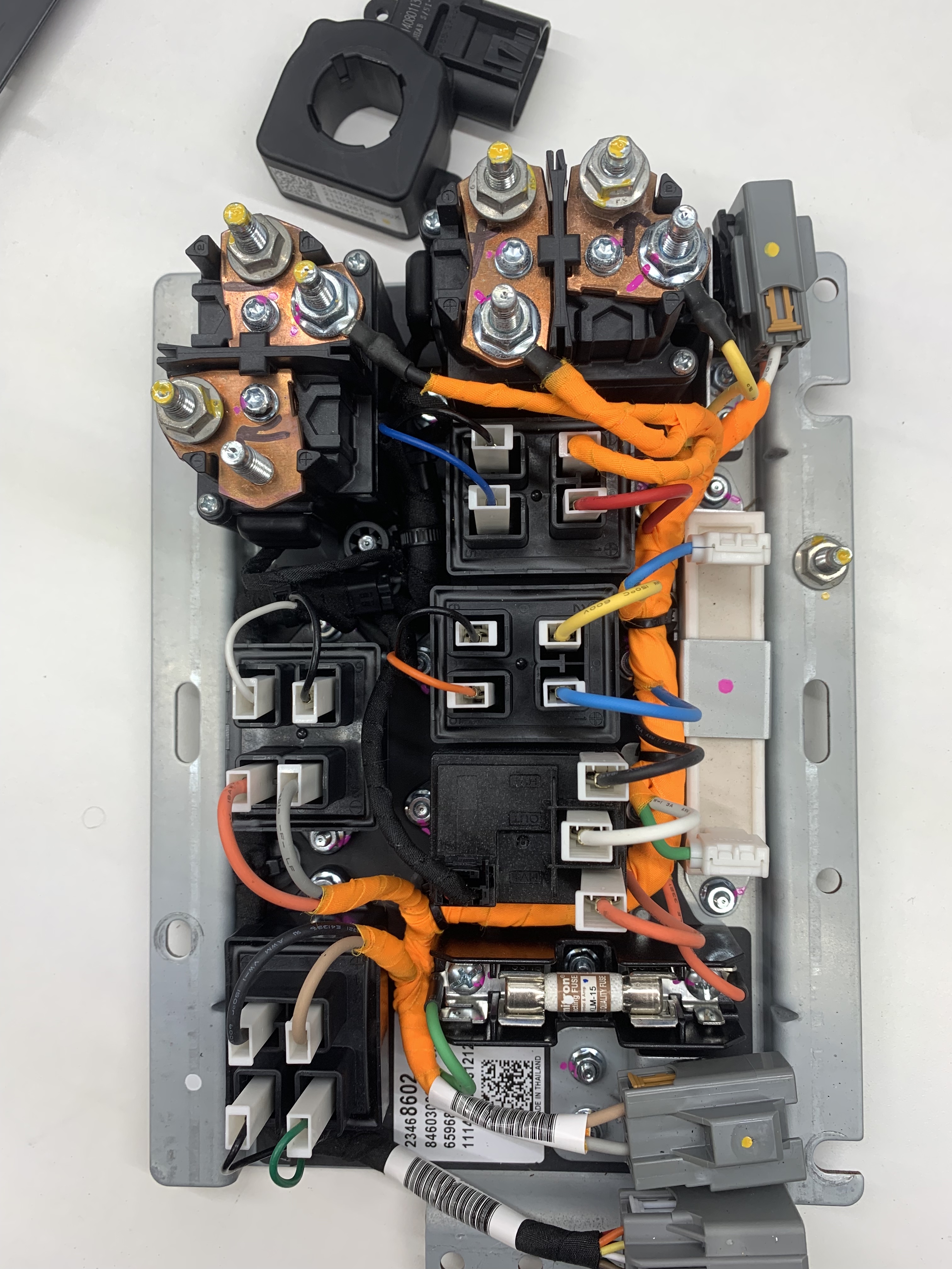

HV Circuits
Purchased 5 of the cheap Kilovac contactors from Batteryhookup, This should get me started and hopefully let me get started on designing the HV Junction box.
The harvested Panasonic relays/contactors from the Chevy spark battery pack I have will be used for the various heaters and precharge circuits. With the main contactors being used for the charging circuitry.
My cells are from the Chevy Volt Gen 2, as well as the 2016 Chevy Spark
Volt:
Spark:
The two packs are great for spare parts!

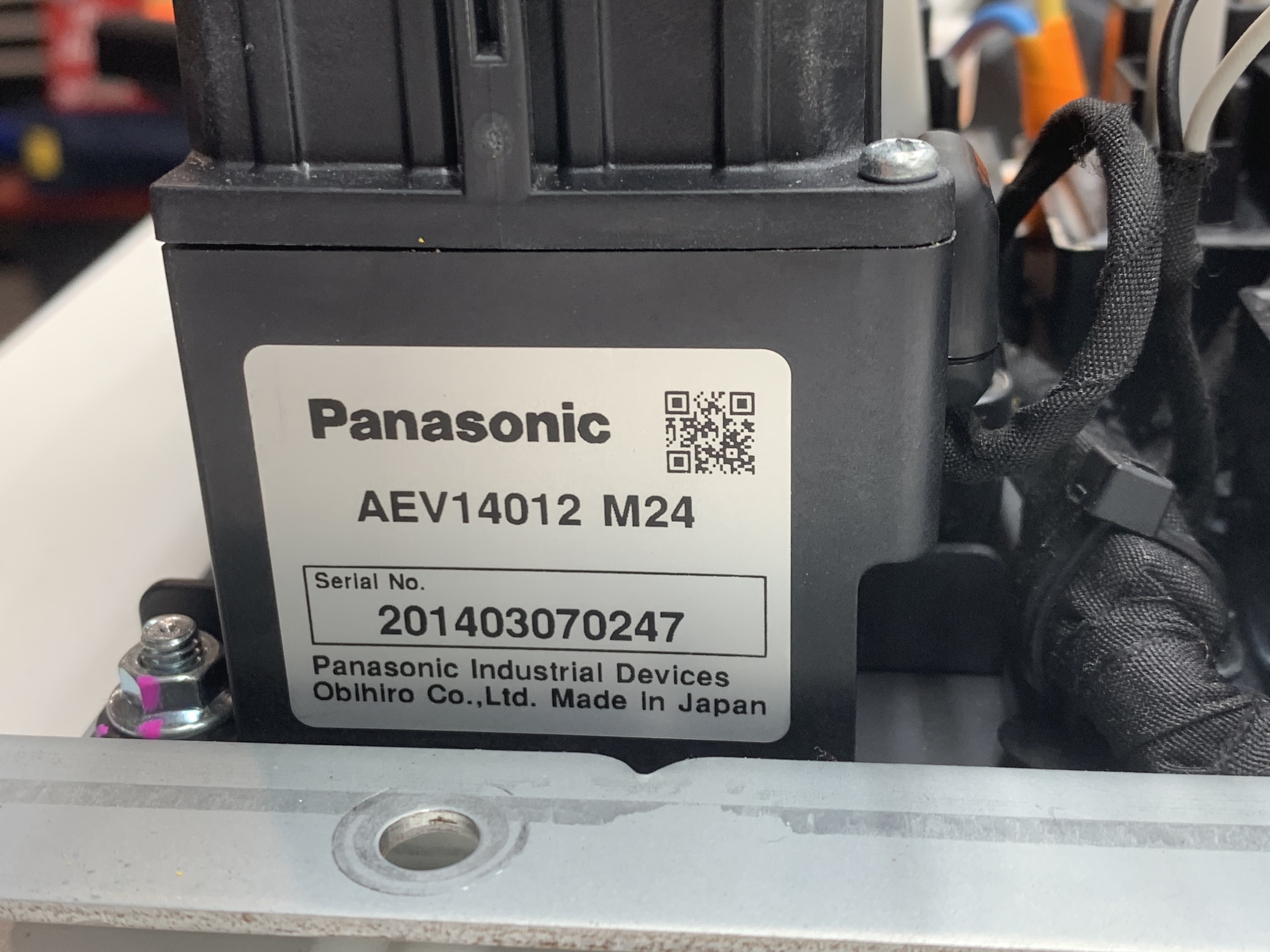

Volt Contactor Module:
Spark Contactor Module:

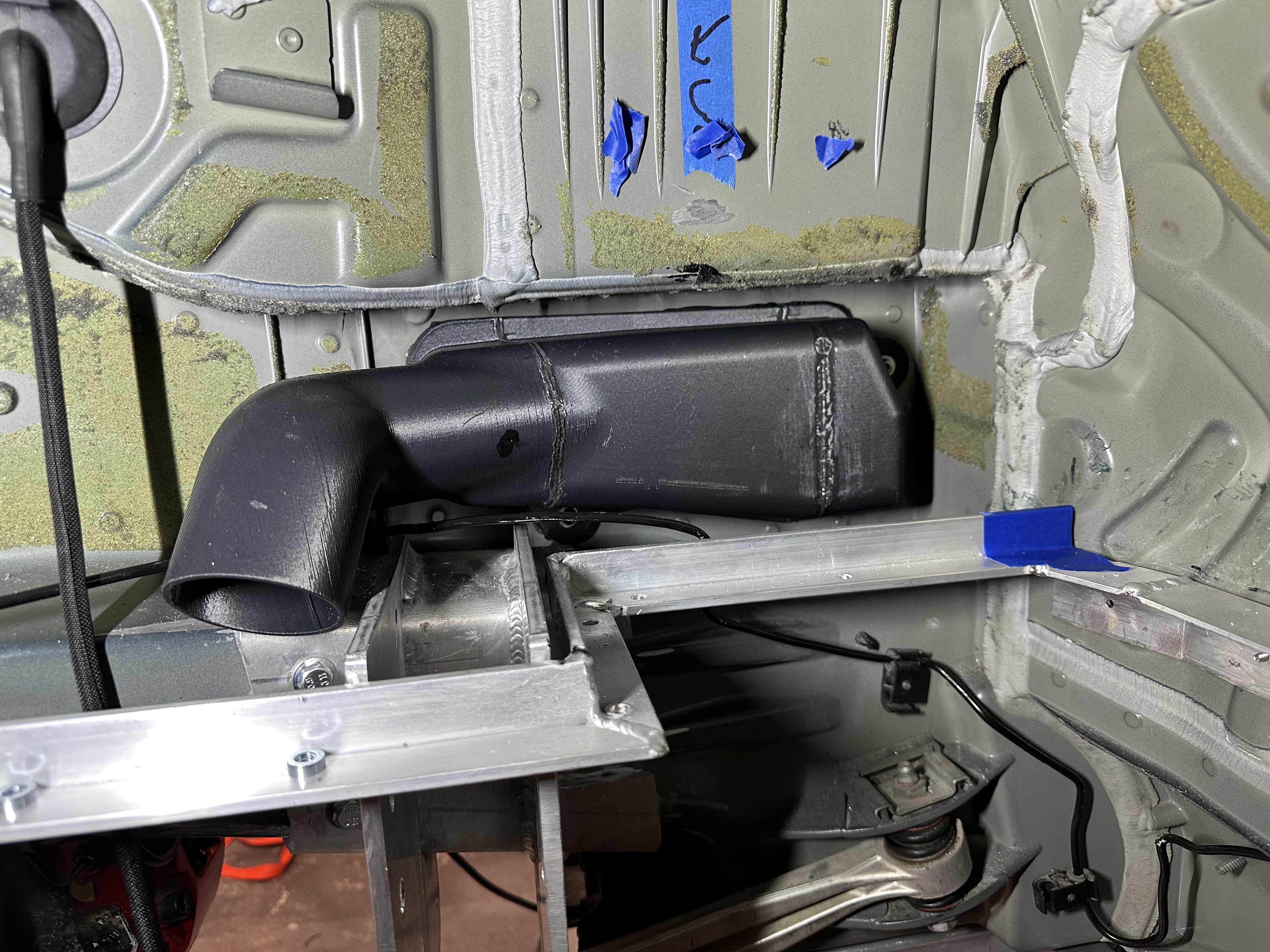

HV HVAC heater
The 3kw PTC heater has been fitted to the HVAC box.
This task went pretty straightforward once I settled the fact that it'll require some cutting and adjustment of the plastic of the factory box. Some heat and the plastic was easily formed to allow the heater core to be retrofitted.
The PTC heater was sourced from ZeroEV and then aluminum was epoxied onto the outer edges to allow for a foam seal.
I'm not overly worried about the aluminum casing heating up, it's spaced a decent distance from the PTC element and also encases the HighTemp cutout module.

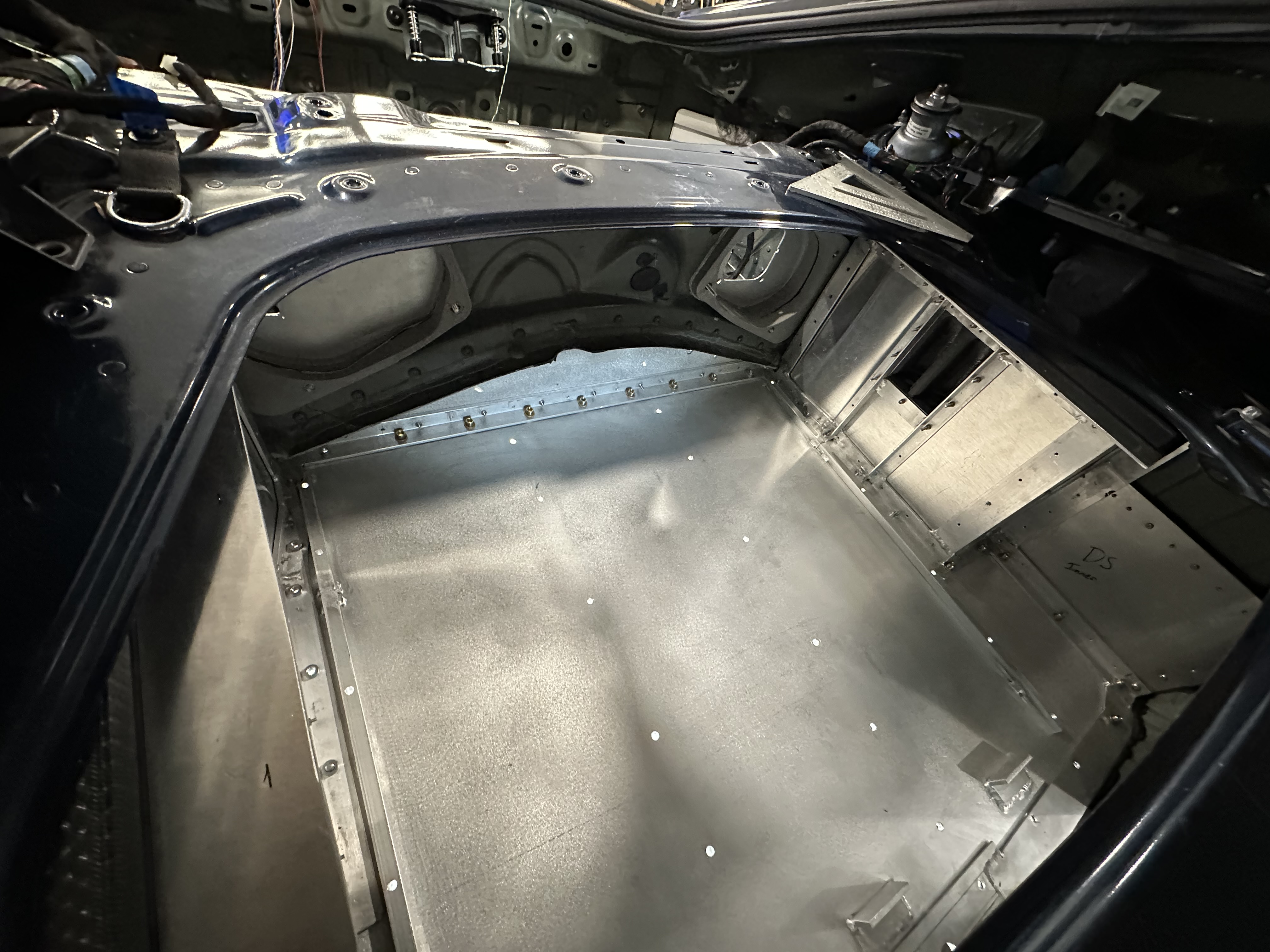

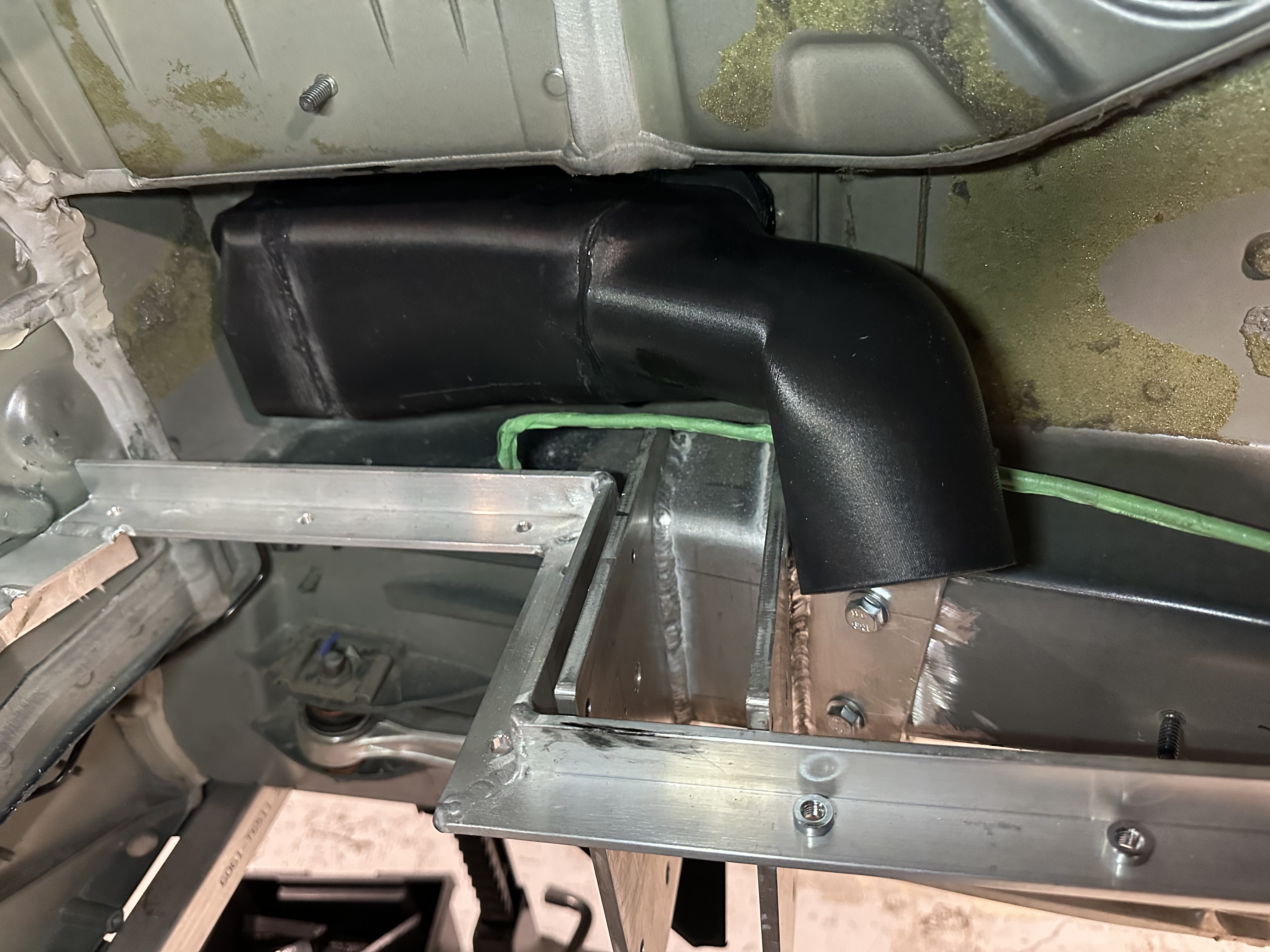

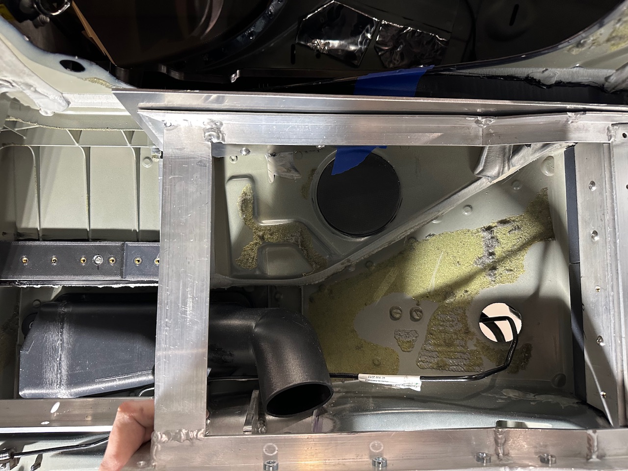

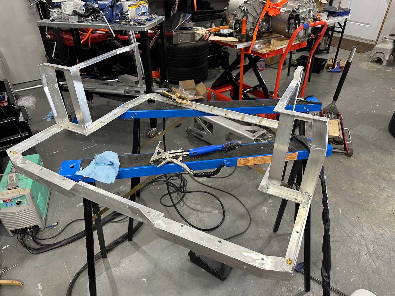

Battery Mounting
Much more work to be done for this task, Once I have the front mount fabricated I'll be able to design the battery tray mounting points.

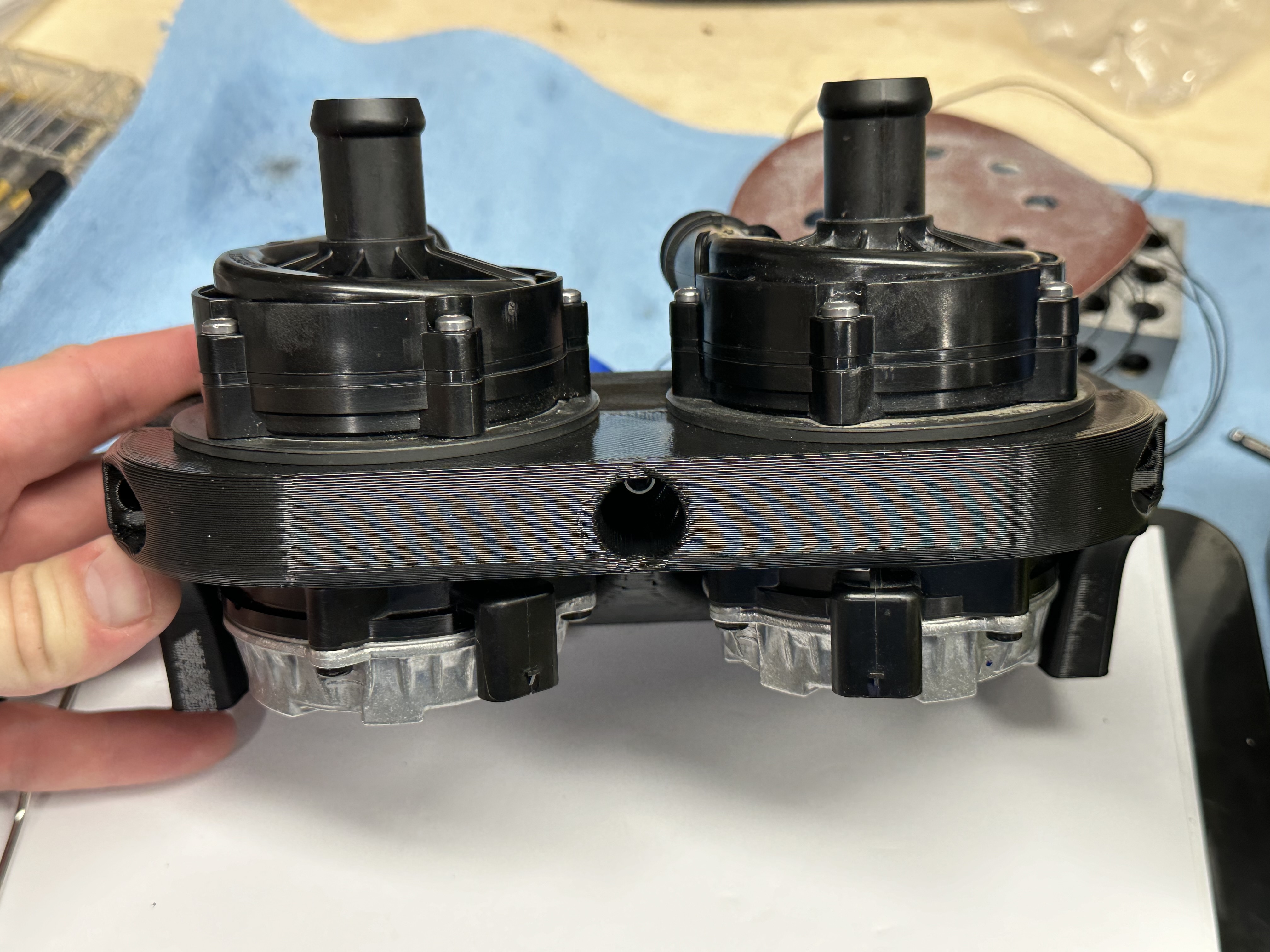

There is enough places to make a box which can be mounted directly to the chassis points using factory threaded points.
I've started mapping this out and will add some CAD dwgs as I go.
