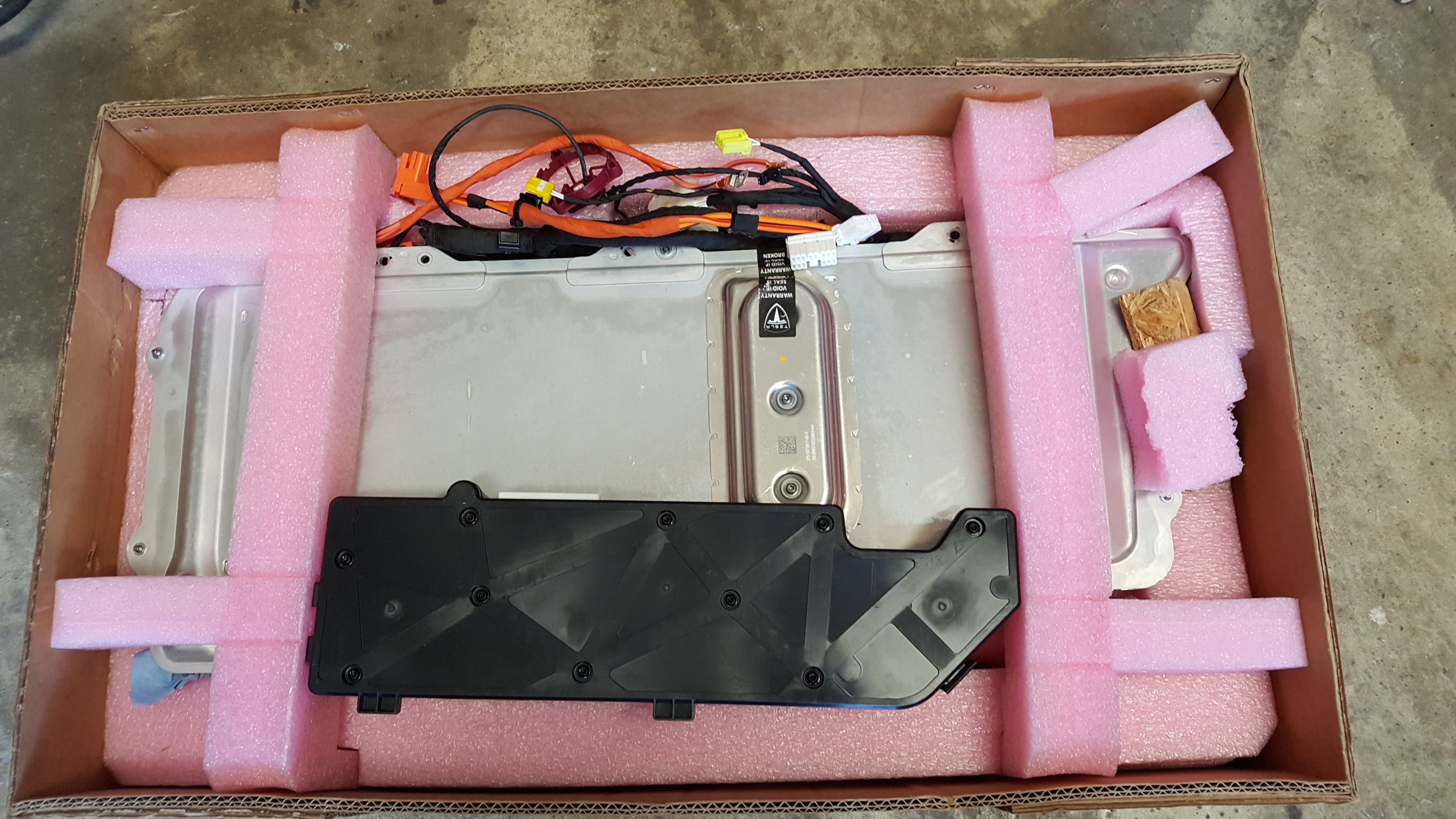

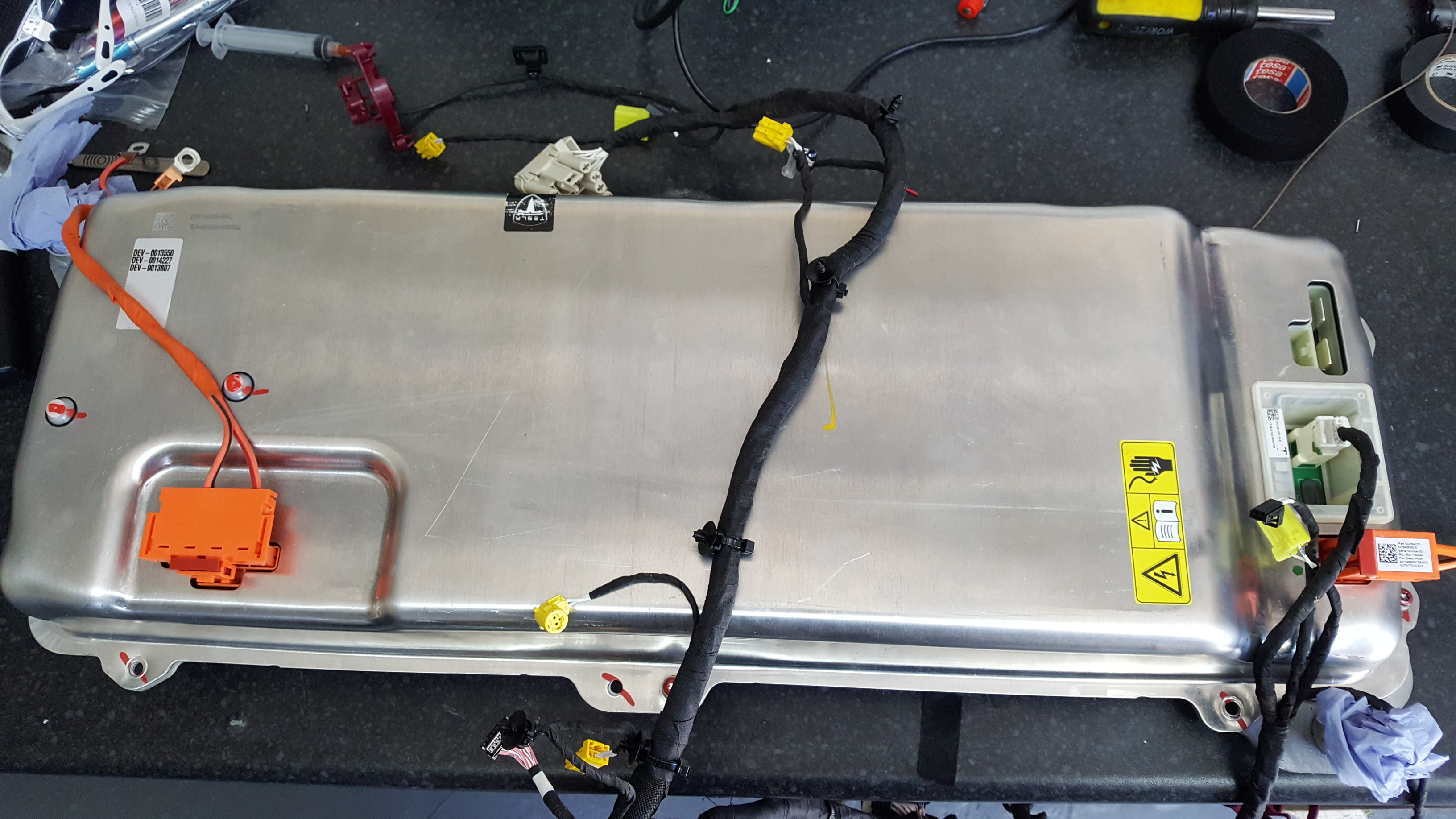

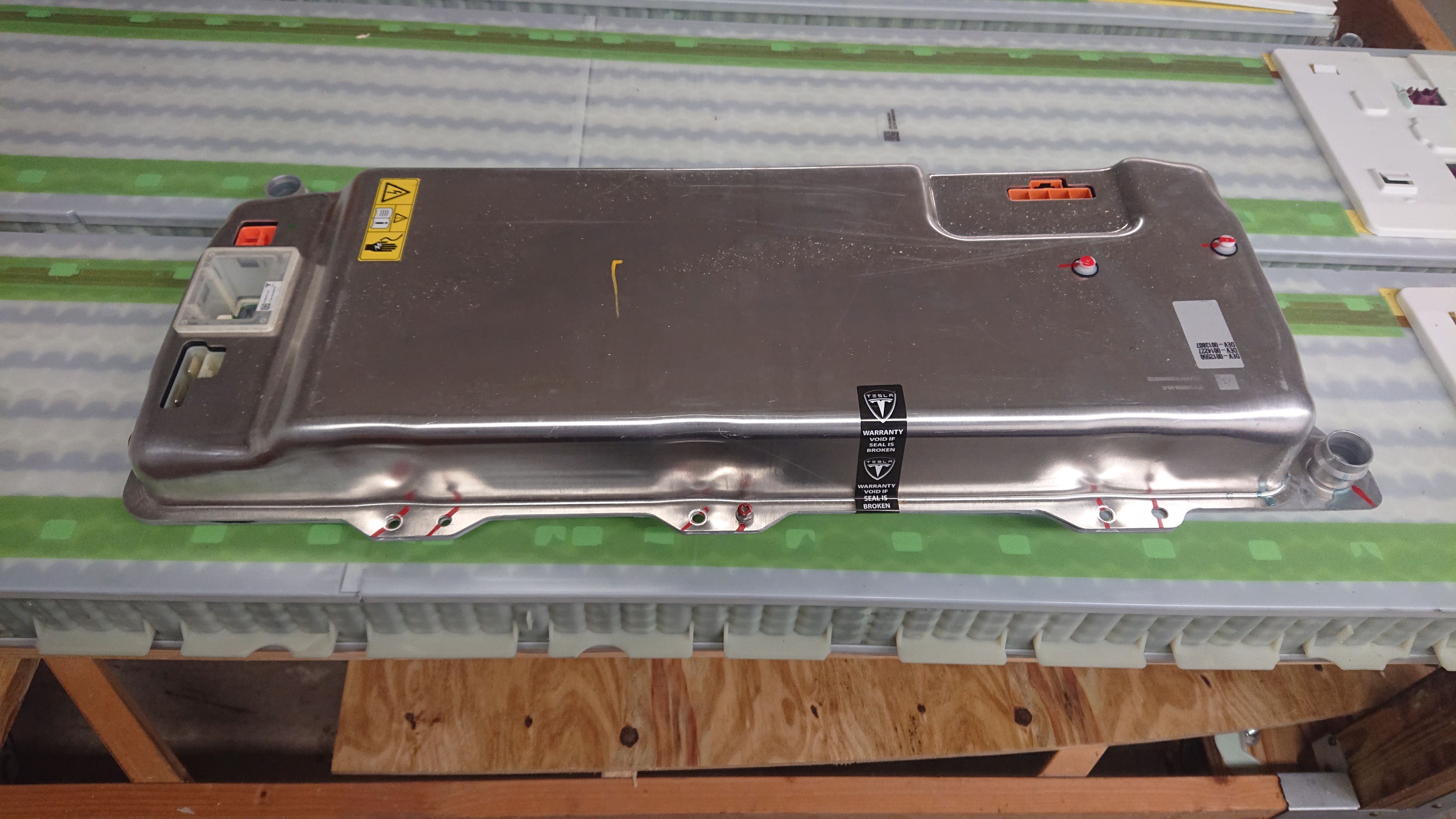

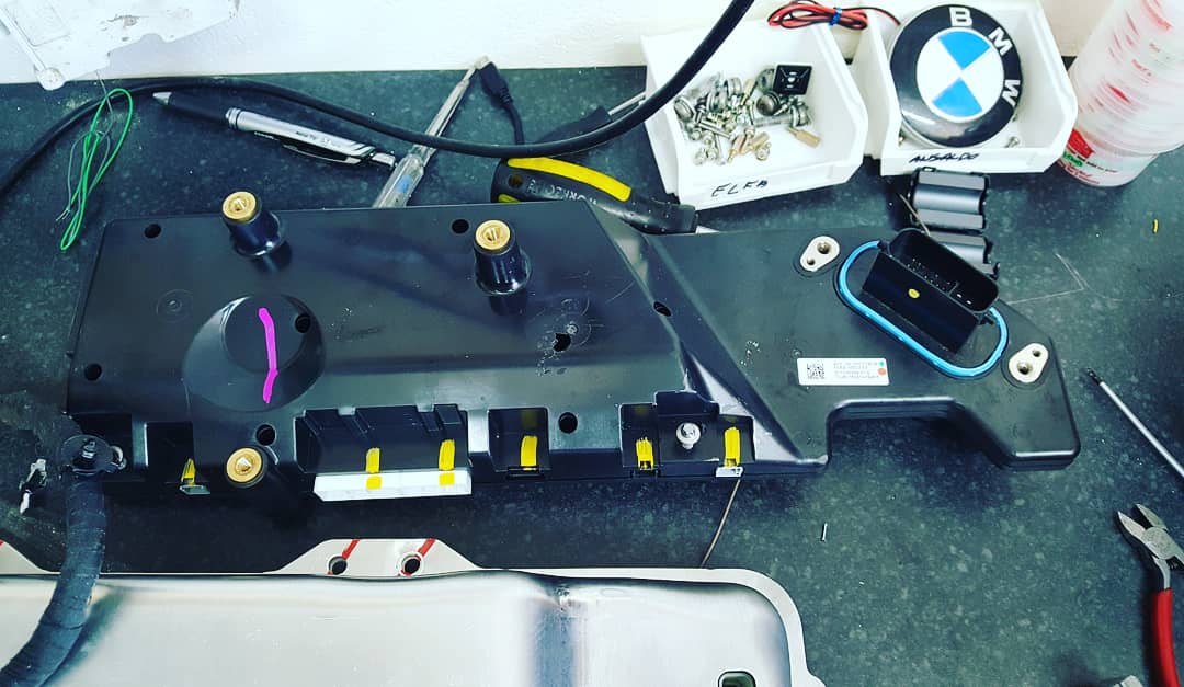

Thanks to a kind donation from a customer I have a Tesla Model 3 battery charger on the way. Setting up a thread for reverse engineering and control system design. More detail once it lands.

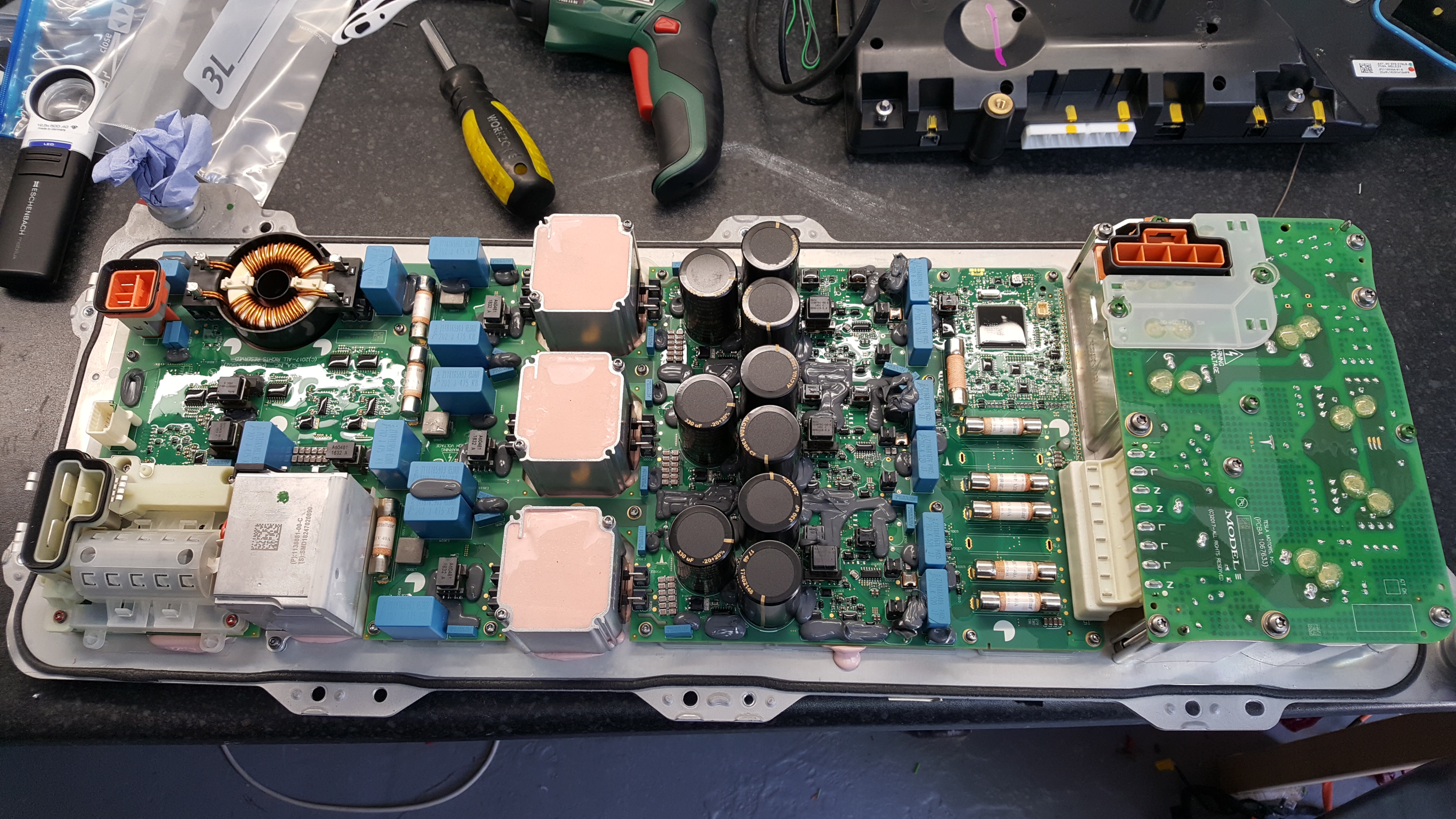

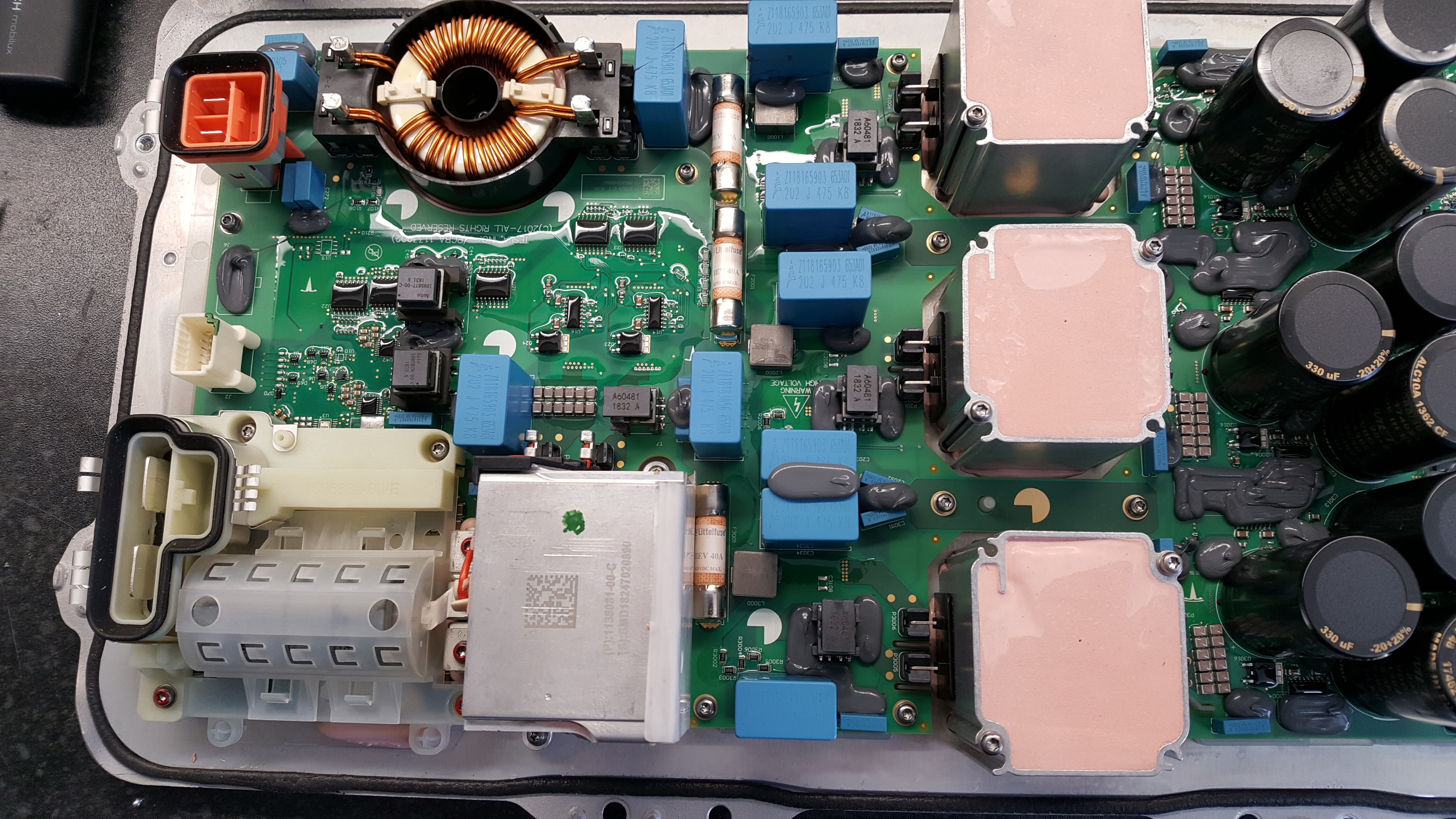

Sadly no can captures but I did also get the wiring harnesses and a weird looking black box called the "Assy HV Controller" that plugs into the charger so will see what that does. What is interesting is that from what I can see the charger no longer handles the control pilot and signals from the charge port in the Model 3.
I also have a sneaky suspicion that the DC DC part will just work with an enable signal.

Re: Tesla Model 3 Charger
come on Damien, you have her open but not crocodile clips on the hv and lv wiring to prove you theory.
Apply some of that rectified mains on her, or maybe she is picky and only likes a tight voltage range. Only one way to find out.
I'll get there. Have the variac all set:)

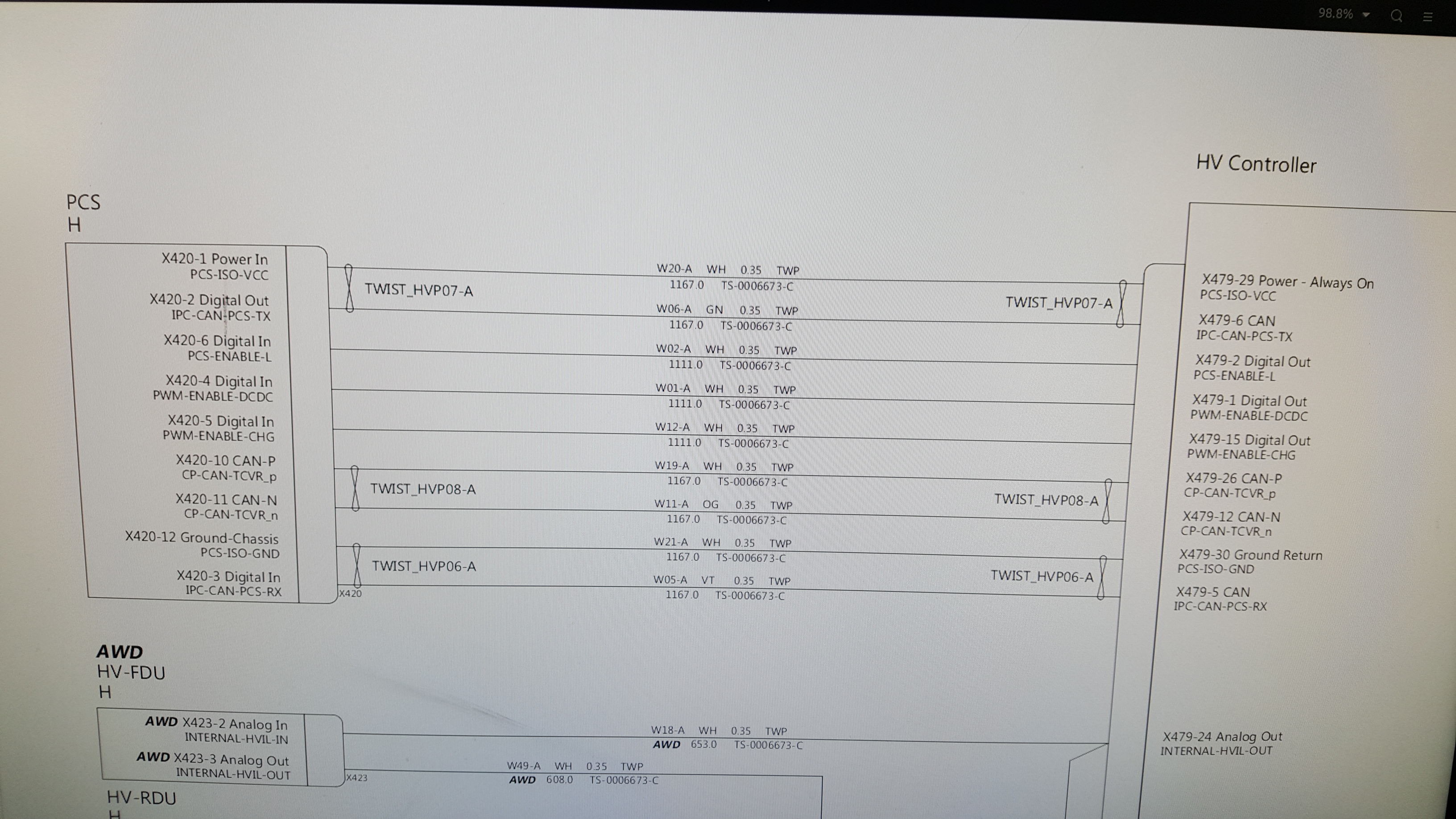

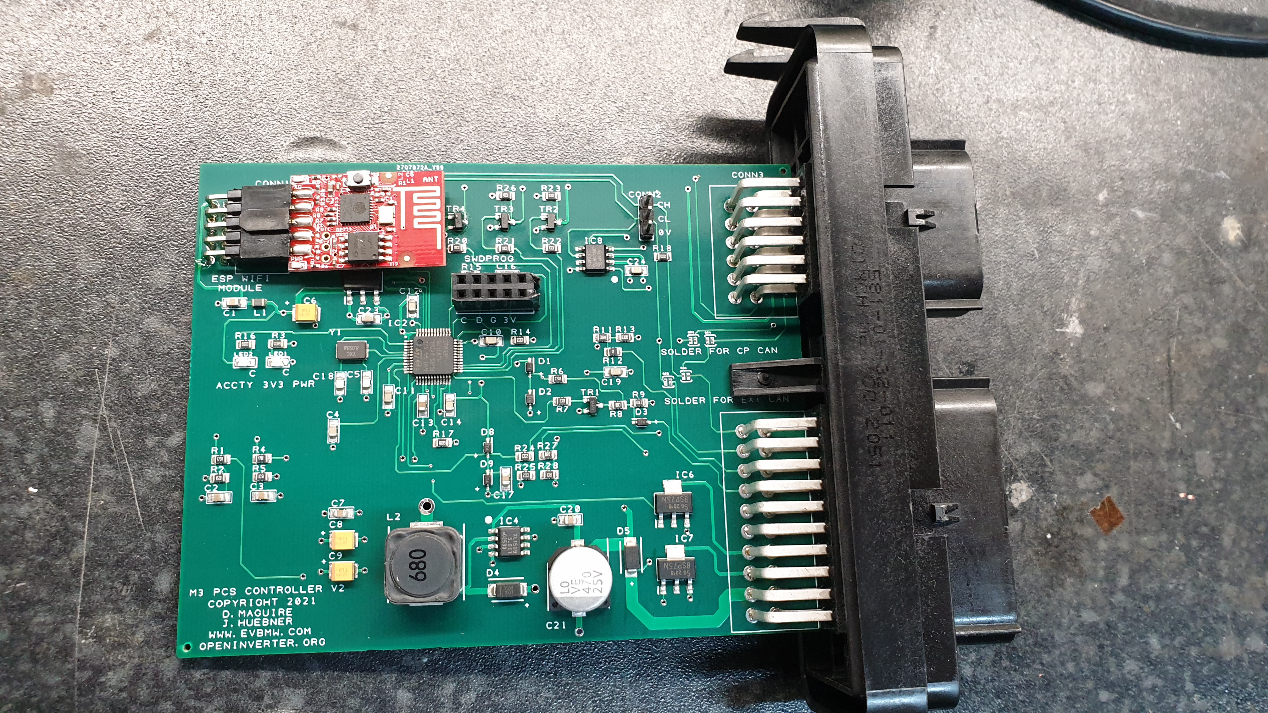

From what I can make out this is the wiring connector from the PCS to the HV Controller. Signal descriptions are quite useful.

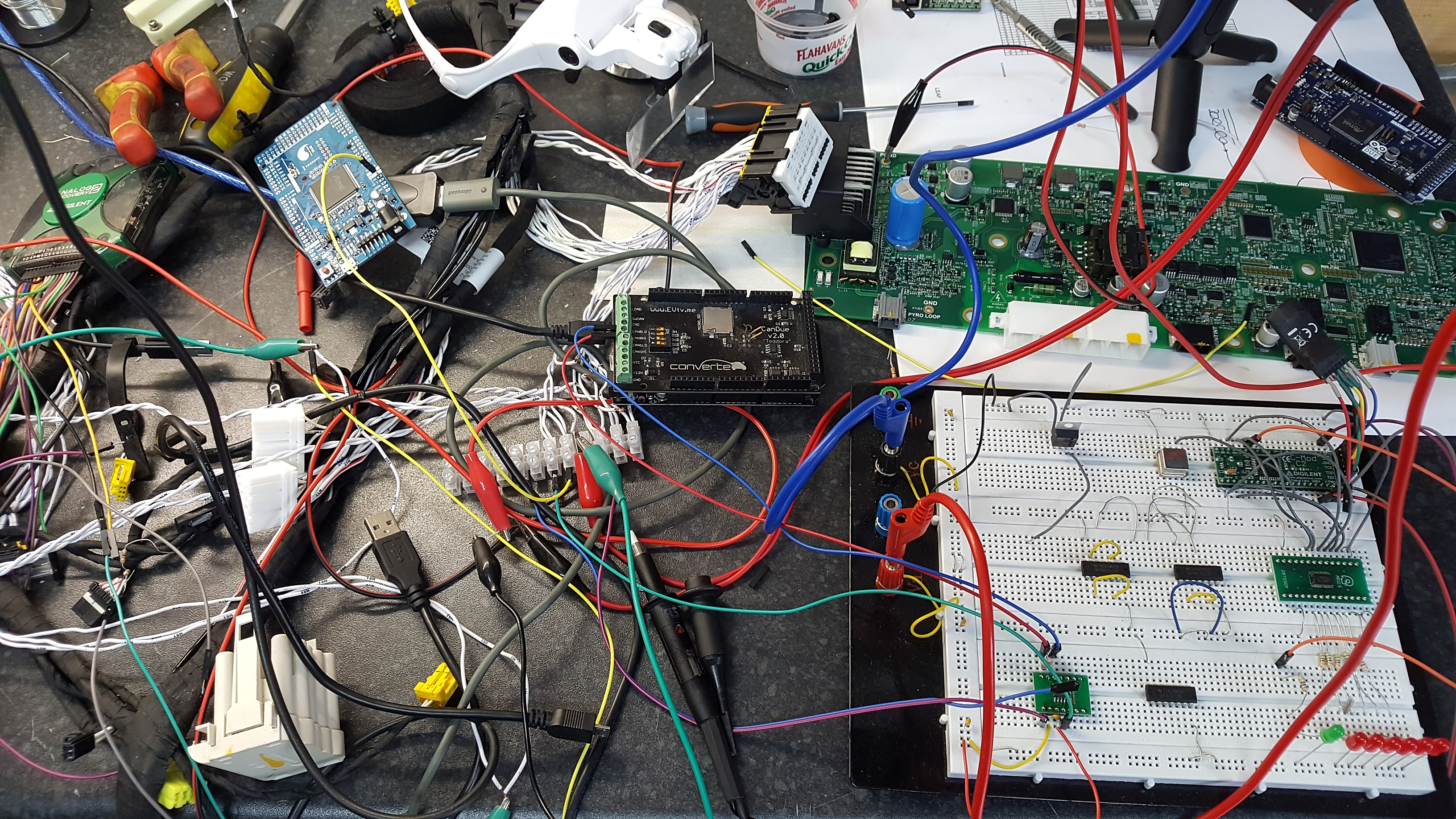

Ok update from yesterday. PCS is now awake. turns out I was wrong about the low voltage lines being derived from the HV. They are derived from the 12v connector via 3 L7987 devices. Enable is achieved by grounding wire W02 to the 12v battery ground NOT the ISO Gnd. All the power supplies wake up and the TMS320 boots and starts flashing some nice leds:) Once I get a new ISO7741 to replace the one I blew we should be able to start some propper testing. Uploaded 2 can captures to github. One with just the HV controller (pumps out over 2k frames per sec!) and one with just the pcs.

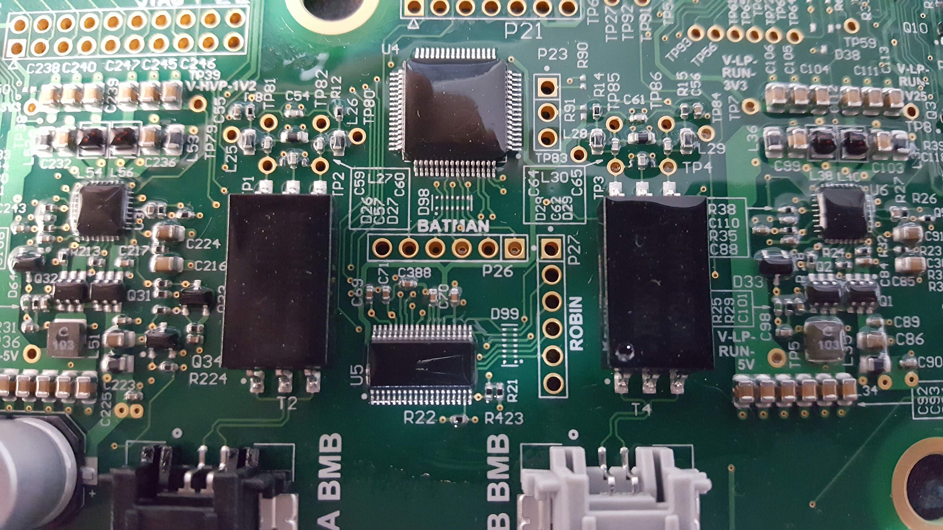

Also worth noting there are two can channels between the HV controller and PCS. One, called CP CAN is normal levels at 500k. The second, called IPC-CAN is created using two ISO7741 digital isolators and transmitted as a 0-5v signal also at 500k baud.

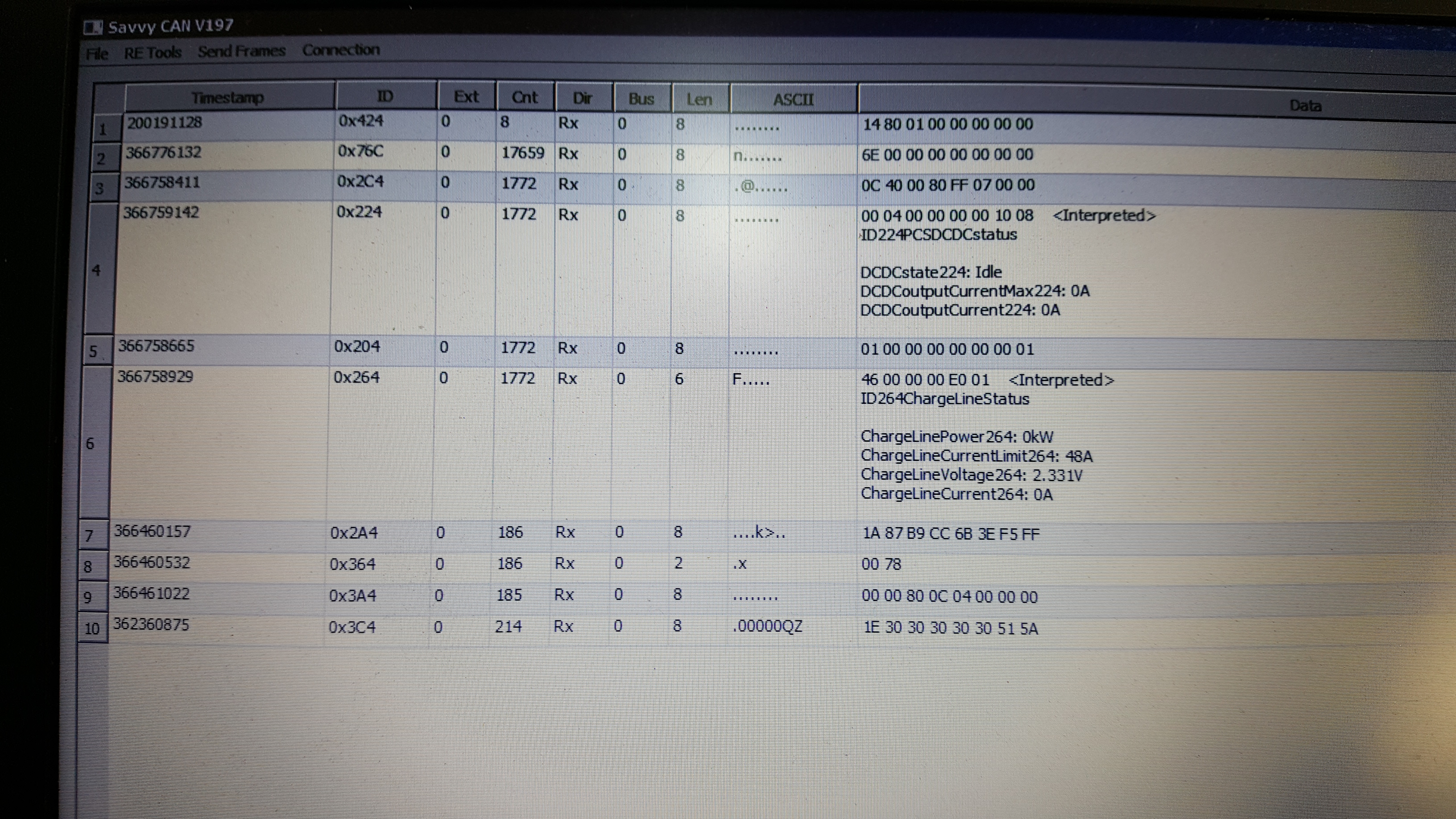

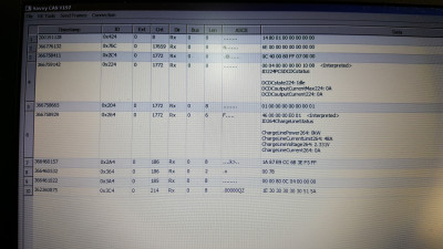

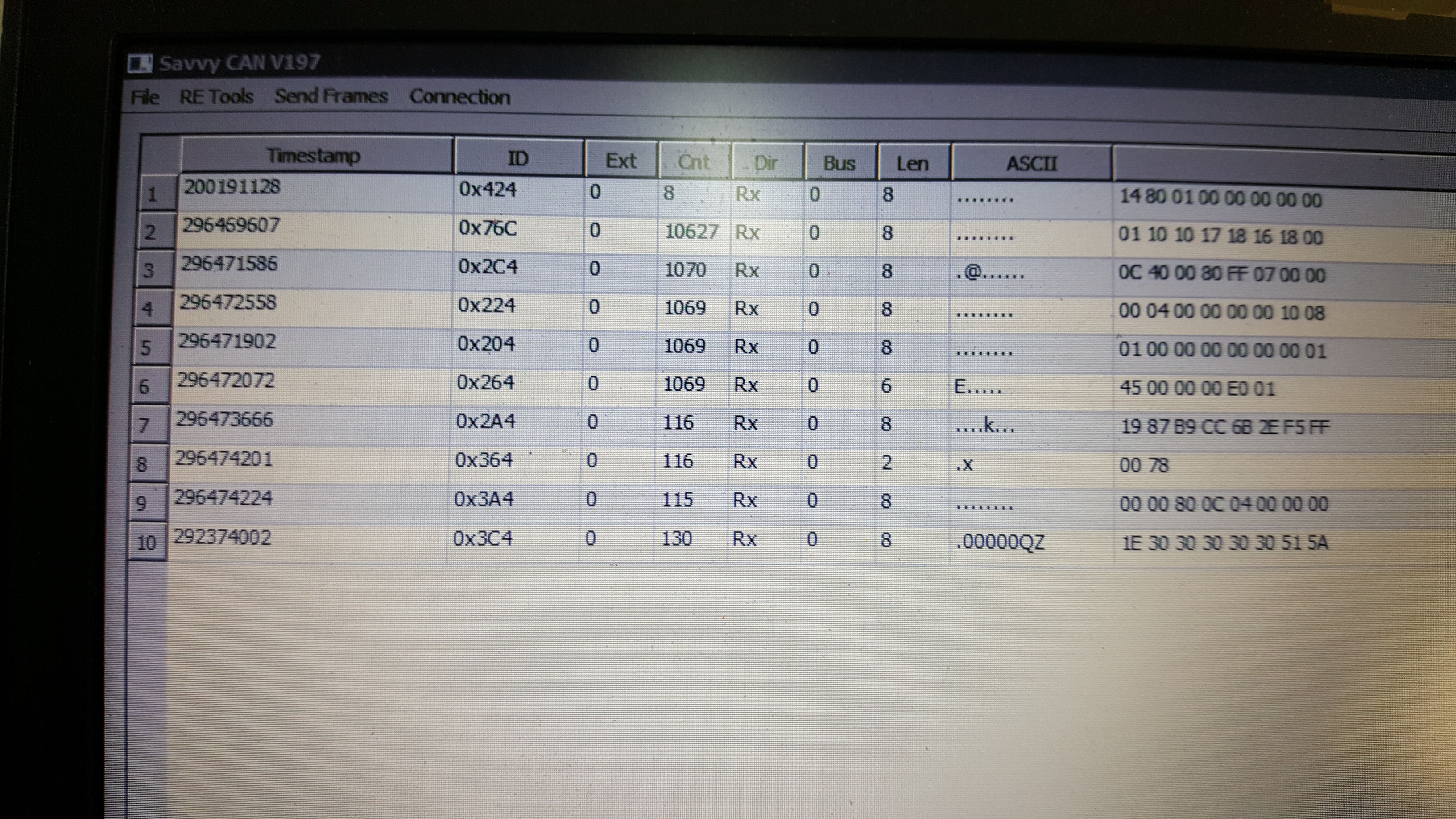

Ok some actual progress. I'm slowly getting to grips with the IPC CAN. The PCS sends 5 ids:
0x76C,0x2C4,0x204,0x264,0x224.
Message 0x264 reports the AC voltage applied to the modules. Not worked out how but here is a capture doing a sweep from 0 to 240v and back to 0.
https://github.com/damienmaguire/Tesla- ... 0_240v.csv
0x224 and 0x204 bytes 6 and 7 respectively respond to the state of the PWM DCDC or PWM CHG enable lines. Going from 0 to 1 when 5v is applied.
So I got a neat tip. It seems the messages BACK from the PCS to the HVController are can ACKs.

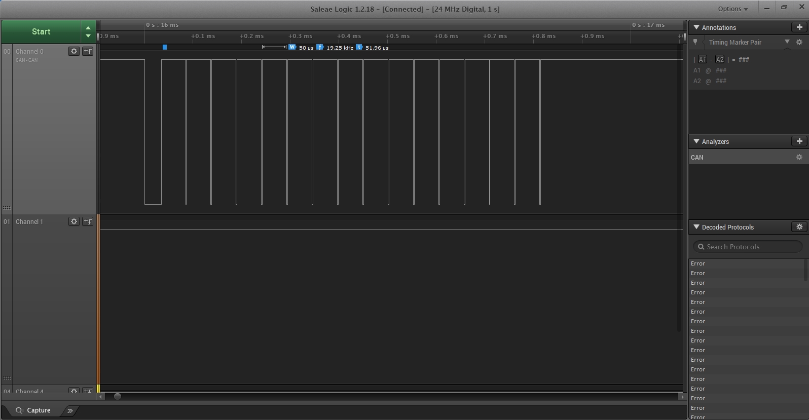

It seems the PCS does indeed transmit something on powerup. If connected to a powered off HVcontroller however it forces the line to 5v and you don't see anything. Disconnect the hvcon and viola. It's not can according to the analyser so what is it ....

Log uploaded to github using a Salea Logic analyser. Free software available here : https://www.saleae.com/downloads/
IPC can Tx with just the PCS powered up and HVCon disconnected :
https://github.com/damienmaguire/Tesla- ... .logicdata
IPC can Tx with PCS and HVCon connected and powered :
IPC can Tx on chan0 and Rx on chan1 :
Any guesses?

Some good progress this evening. Worked back through the hv controller to find where the ipc can terminates. A real tour de force but it seems to end up in several places one of which is a qfp device with a weird part number. Decided to try something. Rigged up a 65HVD255 CAN transciever on a breadboard with Tx and Rx connected to the PCS and a short can line connecting it to the candue. Fired up the PCS and bingo. With the transciever handling the bus arbitration the pcs puts out messages from power on.

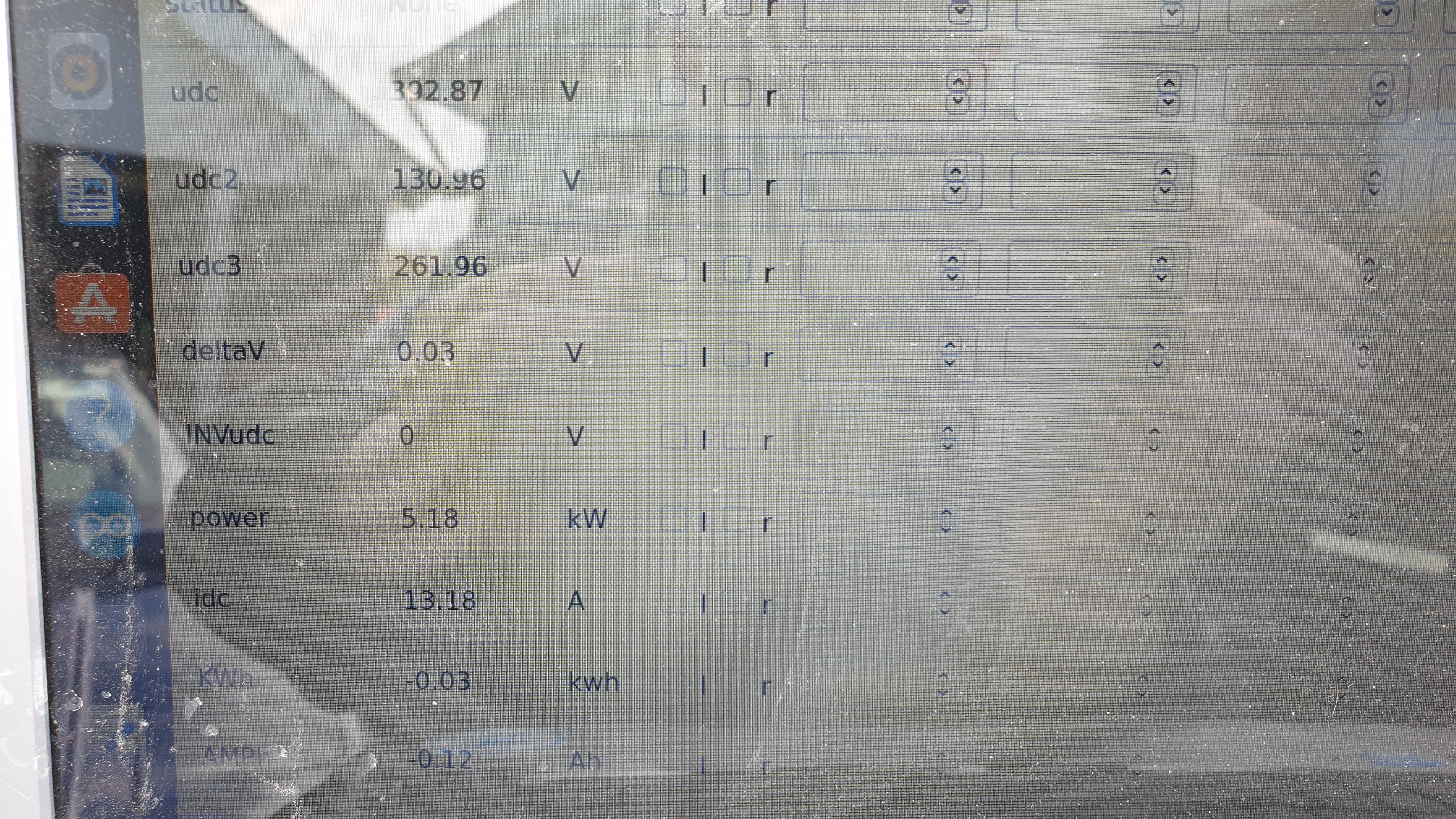

Major progress made:) Video and info on the way.
