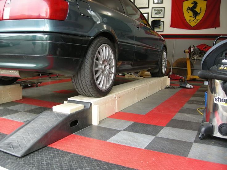

In a similar line to your current setup, these additions can be handy. Diy ramp and removable centre section so can can be driven onto the four wheel stands...then remove the ramp and mid section.

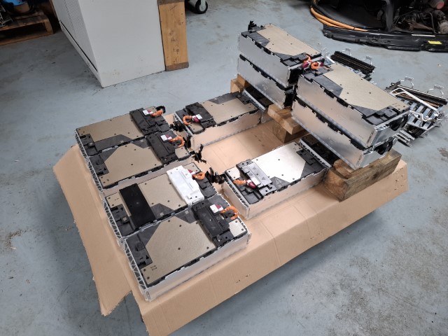

I'll be reorginising the order of the modules compared to the original X5 pack layout, which means the original BMS slave connectors don't reach or are in different order.
Anyone know if the BMS loom needs to retain the order of modules or if its ok to connect them to the closest modules regardles ...
