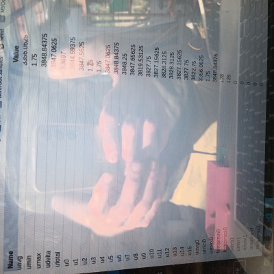

Following this approach I found that using testchan 11 on a good BMS I get around 3.7V between connector pin V10 and then probing along V11 I get around 6.6V at Q77 onwards.
I guess this shows a failed fet at Q77 (rather than Q81) which is the next fet along and also gives 6.6V.

So I had some more time on this. Looking at BMS7 I get erroneous values for U10 and U11 (-1.15625mV and 1.15625mV respectively).
Firstly I took a BMS giving good results (BMS3) set testchan to 1 and took readings across every fet terminal from V0-V16.
I then swapped the board for the above BMS7 and ...

So something that might be considered progress...
I connected a working BMS (BMS1) up to 16 cells, set testchan to 1 and measured voltages between V0 and the bottom row of the fet line starting with Q5. Voltage patterns made sense.
I then connected a non-working BMS (BMS4), this board usually gives ...

I did some probing with one of the BMS units hooked up to 16 cells and can verify voltage was getting to the FETs and noticed slightly different voltage readings across legs of the fets. Could this be a tell tale sign? Is it worth checking voltage at each Fet leg for signs of issues?

So I psyched myself up to try and identify the issue again this evening, given the rain....
I jumped directly from the connector pin for U2 and U3 to the resistor for the relevant channel but it made no difference to the voltage readings on the webUI....
Any other suggestions on how to test this ...
