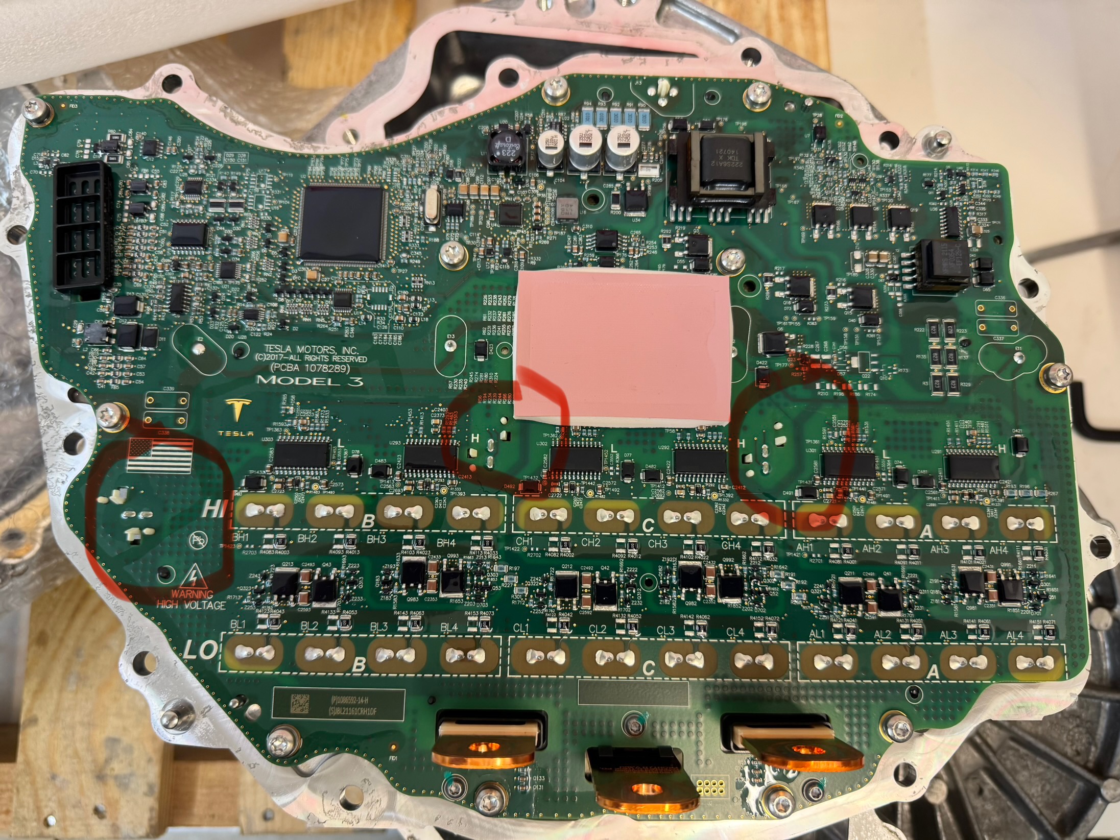

ok, issue was me. After unscrewing plastic shrouds around 3 phase and using some force to move board to correct place i succeeded and all bolts are in place. Some are still bit miss aligned but bolts can be screwed in without chewing board.
My invertor has extra white plastic around 2/3 phases ...

Shouldn't be a problem. My apologies for the hole misalignment. Its really frustrating but I am reducing the error with each revision.
No apologies needed at all, one of first version available for public so any errors are expected. There is also good chance that i messed up something.

Have you tried loosening all the fasteners and giving everything a bit of a gentle jiggle from side to side and back to front? Th
Thanks.
My board doesnt have room to wiggle (maybe 0,2mm), board is pretty much hold still by top right locating pin and HW loop.

All so far went well.
Regarding TDK power supply (should be on future boards) i decided to order new, mine us covered by coating on one site.
Issue i faced are:
Hole H10 mentioned that being slightly off is expected and it is not issue, mentioned in video.
I have issue with H7 where i can start ...
Issue i faced are:

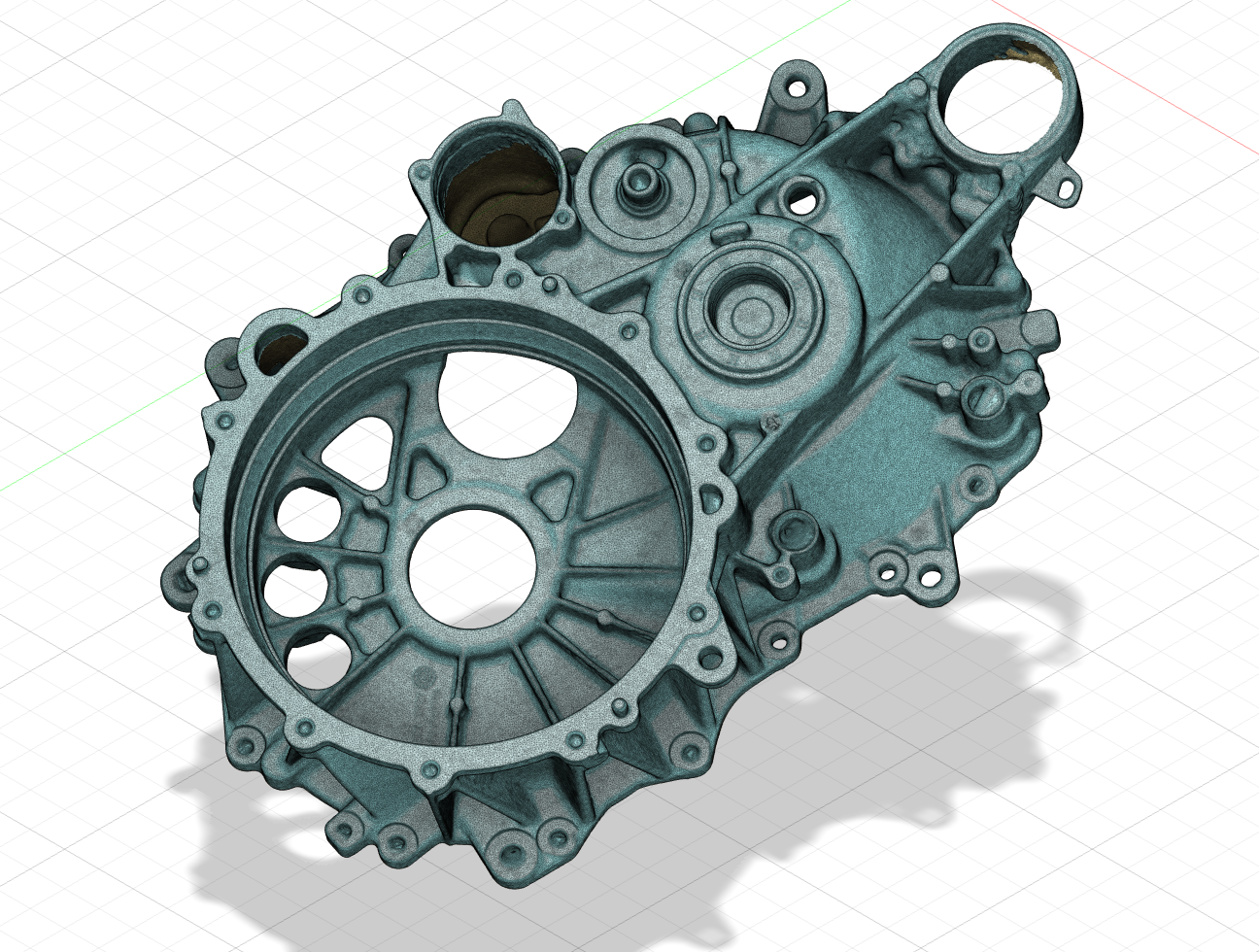

3D scan of casting (stator side) created today. Feel free to use them, precision should be 0.05mm.
https://drive.google.com/drive/folders/ ... sp=sharing

Because I desoldered my board i will post few notes for future adventurers:
1. To remove board you need to desolder all joints marked in green, total of 51 solder joints. I used just solder iron and solder wick.
2. You need to desolder High Voltage interlock loop marked in orange ...

Dont you miss holes for white plastic stands next to ST1/2/3?
Not sure what is under as i did not desolder my board yet.
